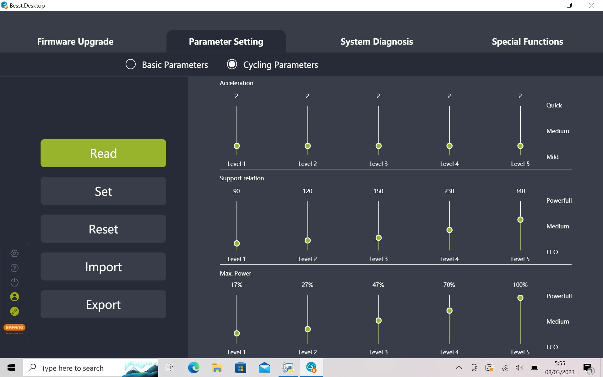

Firmware upgrade was successful. Did You ever play with the Besst Pro parameters? What Did You change? I see multiple options, but I have no idea on what to change / what will be the effect of startup angle / acceleration etc. Some advice?
this is my setting
If you do some trial things, such as jumping on the spot with the brakes applied, it might be worth increasing the startup angle so as not to put too much strain on the motor and brakes.
