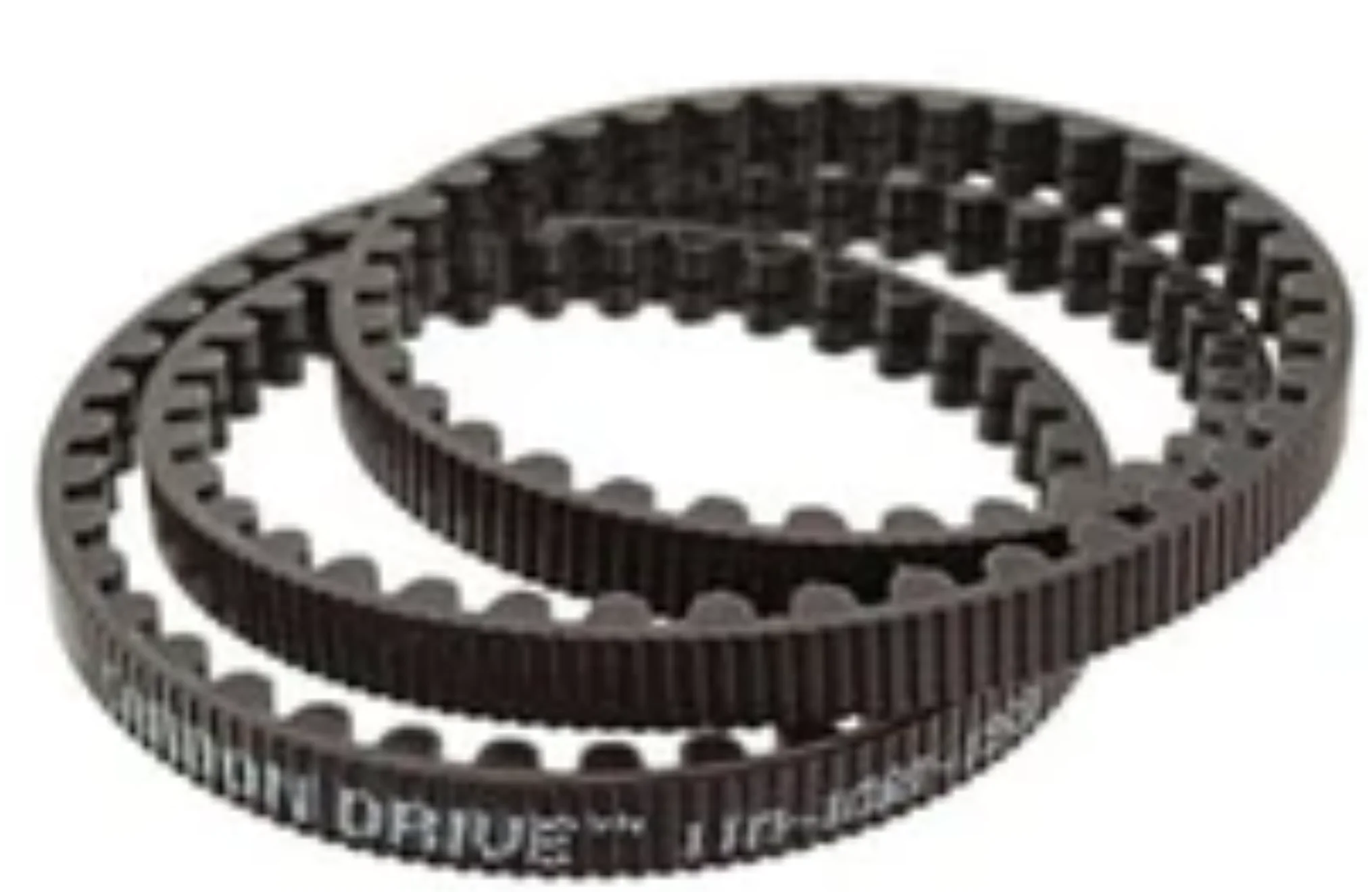

and where do you store this 2nd belt during your ride? in a huge ass backpack?
I mean even for you Seth, that's not very well thought out. 😅 It's a rubber belt, fold it up & stick it in your pocket!
you are not supposed to bend them, hence the huge ass packaging they come in.
and no, not made out of rubber:
The belts consist of a continuous loop of polymer with moulded nylon teeth, reinforced by multiple carbon fibre tensile cords.
have you even had one in your hands before? doesn't sound like it...
🤔 uh huh. I guess that means you can't ever fit them to a bike in case they might go round sprockets & pulleys in a bending pattern. I am aware Seth that you live for the fight but my guy, you've jumped the shark here in a truly spectacular fashion.
i meant twisting. 2nd language. same meaning in german. my point still stands. you can't fit them in a pocket. nor putting it in a backpack without a chance of damaging it.
Yeah that isn't true at all but if it's a hill you wish to die on, then sure, go nuts.
