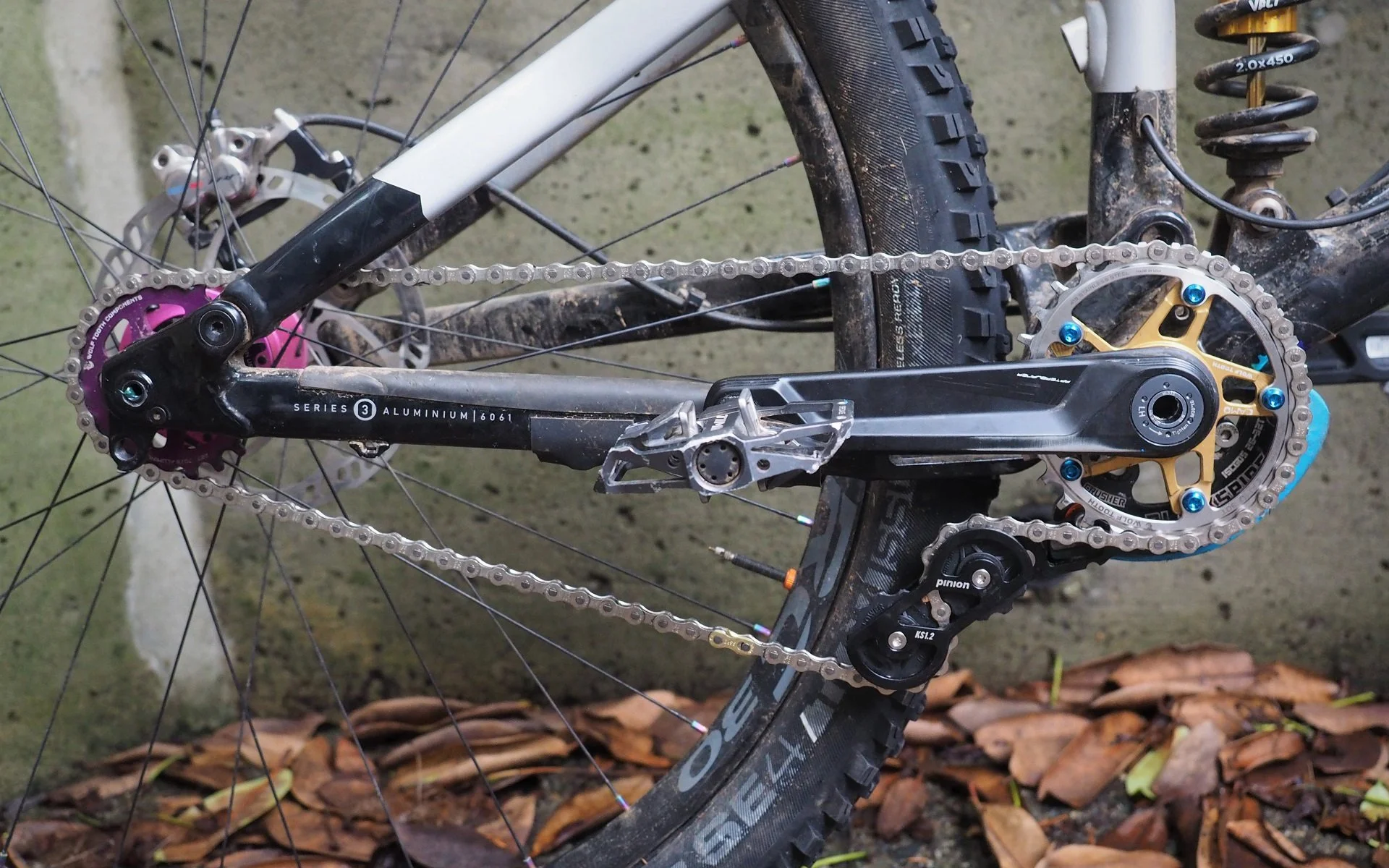

or use a chain and just carry a spare multilink and be done with it

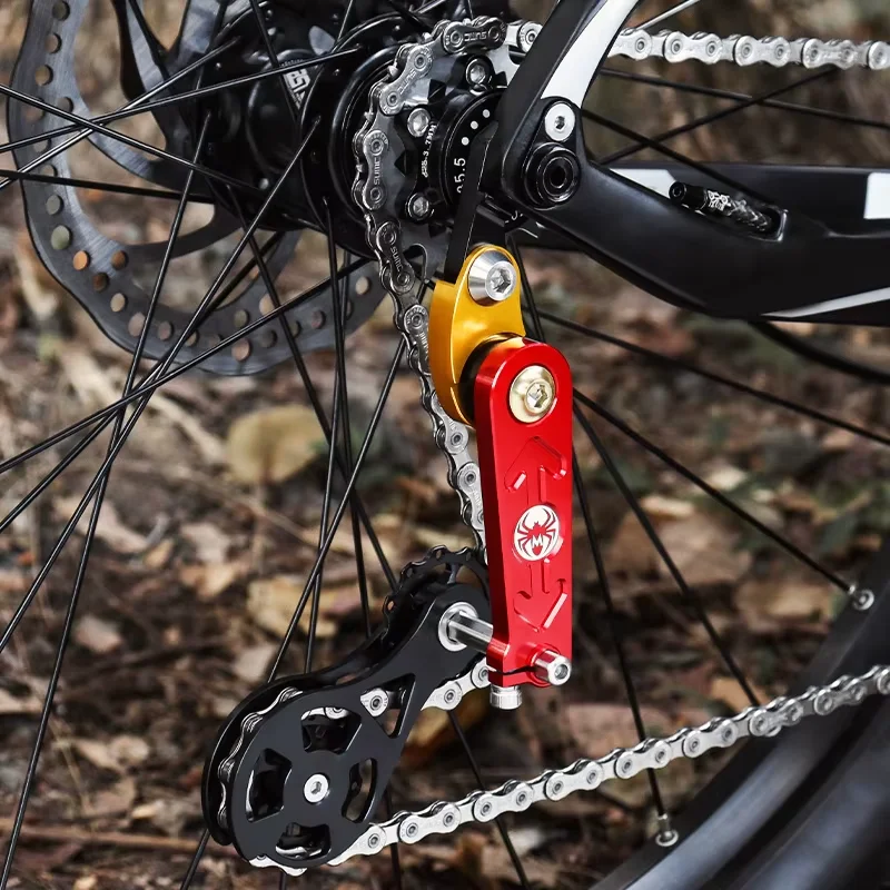

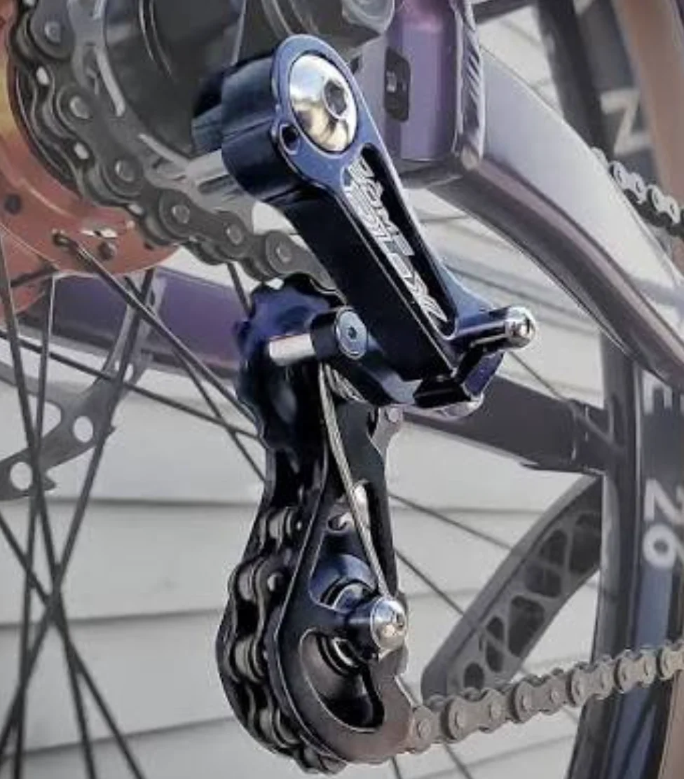

Yep. You can always do the simple, expedient, and reliable thing, that has worked for over a century. Of course, the requisite chain tensioners required look an awful lot like derailleurs; the very aesthetic you not want to not be reminded of with your new ECVT bike.
But why bother when you can take the plunge and proudly show off your belt drive on your MGU/ECVT bike because no derailleur bike can, creating caste like the Star-Belly Sneeches. Just a glimpse of a belt on your EMTB means you are in an elevated class ;)

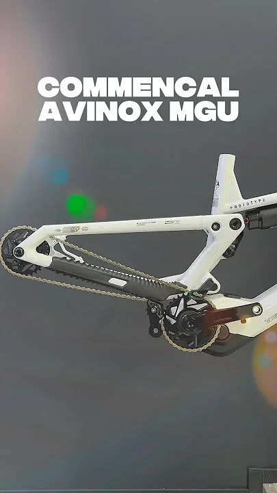

Maybe you missed the already displayed chain mgu Avinox photo one page before this one…
I'm well aware and in the end chains will probably be the more prevalent choice for MGU EMTBs. The operative word here is choice, because with derailleur bikes you don't have one. They don't get to put "Stars Upon Thars" ;)

are you dumb? both need a tensioner…

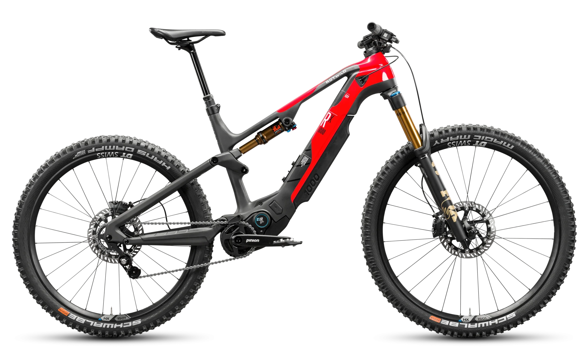

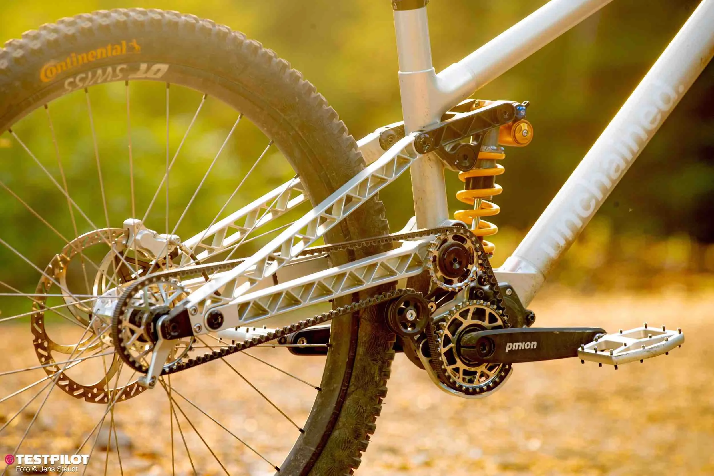

I have Pinion MGU with chain.
My friend has Pinion MGU with belt.
Both are full suspension with tensioner. Belt feels a tiny bit spongier, but there is no real difference. We note no difference in efficiency. Belt is lower maintenance, but a big ass chain that doesn't need to flex sideways has also a lot of durability.
