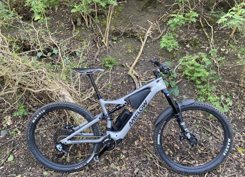

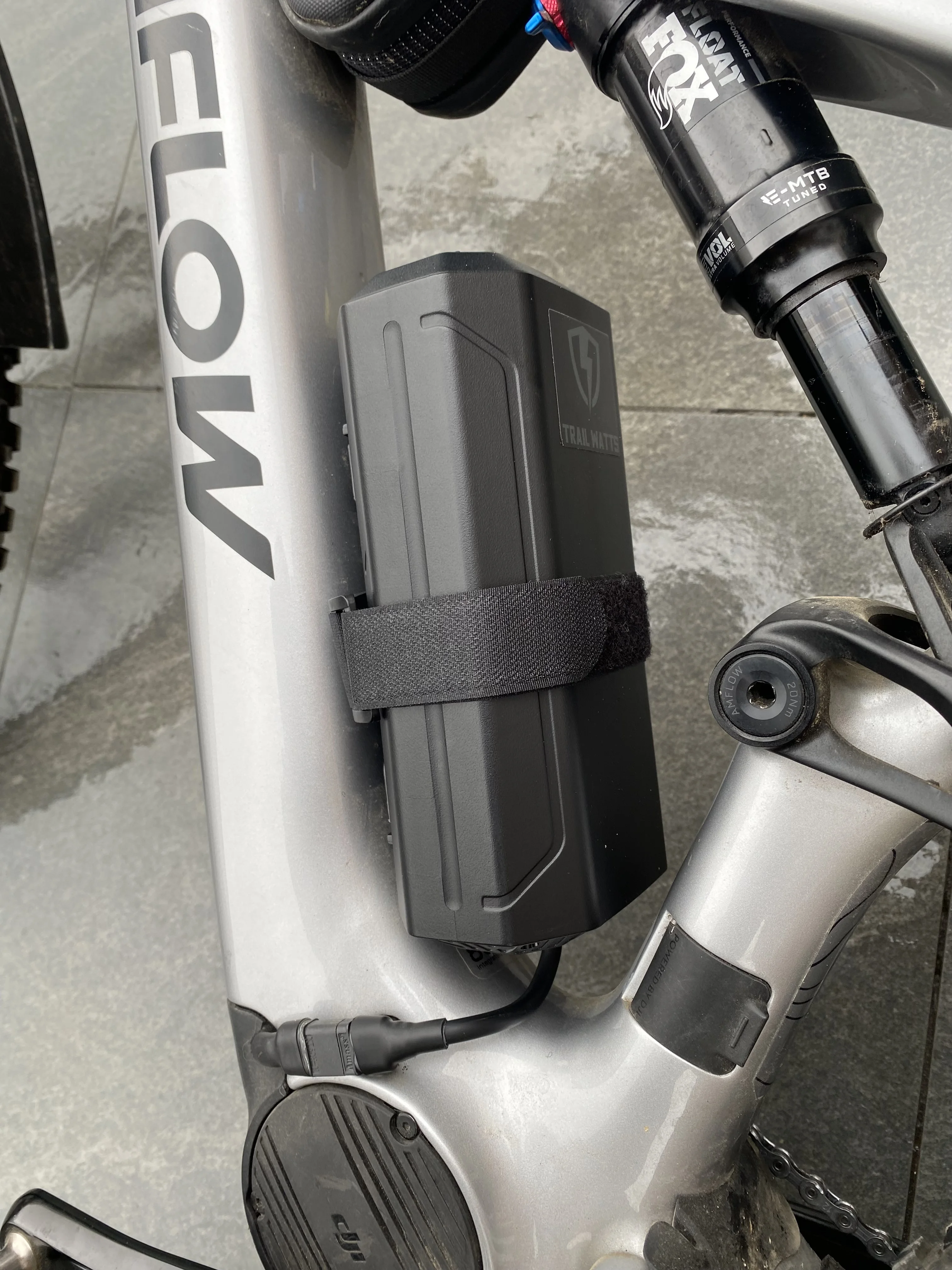

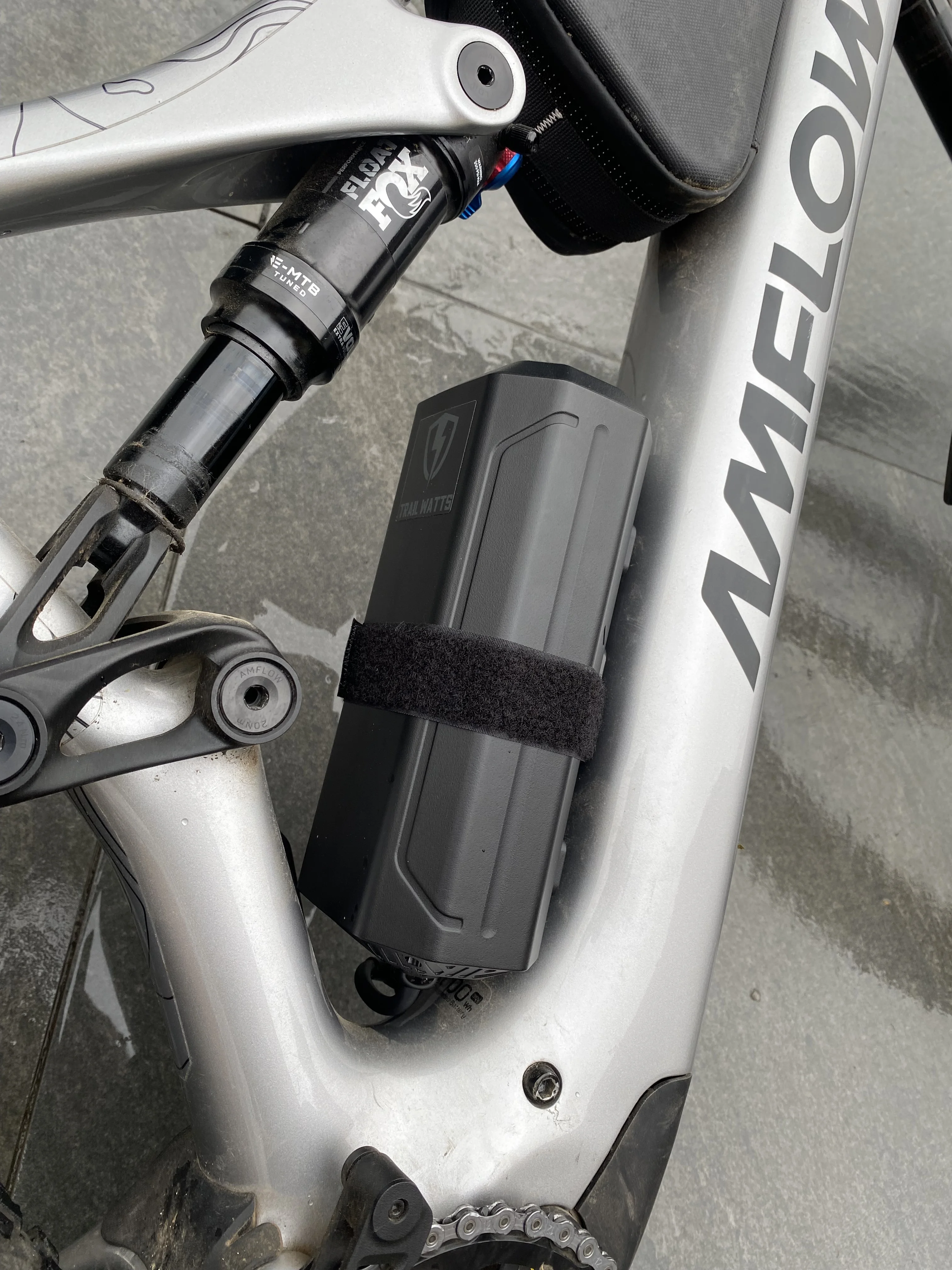

We are testing the M2S motor before releasing anything. As there are multiple power harnesses for various bikes then kits will be built to order. Also space for both 252wh and 360wh requires 23cm height and 9cm depth from the downtube.

As my module load shares without conflicting the OEM layout and does not interfere with the Avinox system. Especially bms-motor communication.

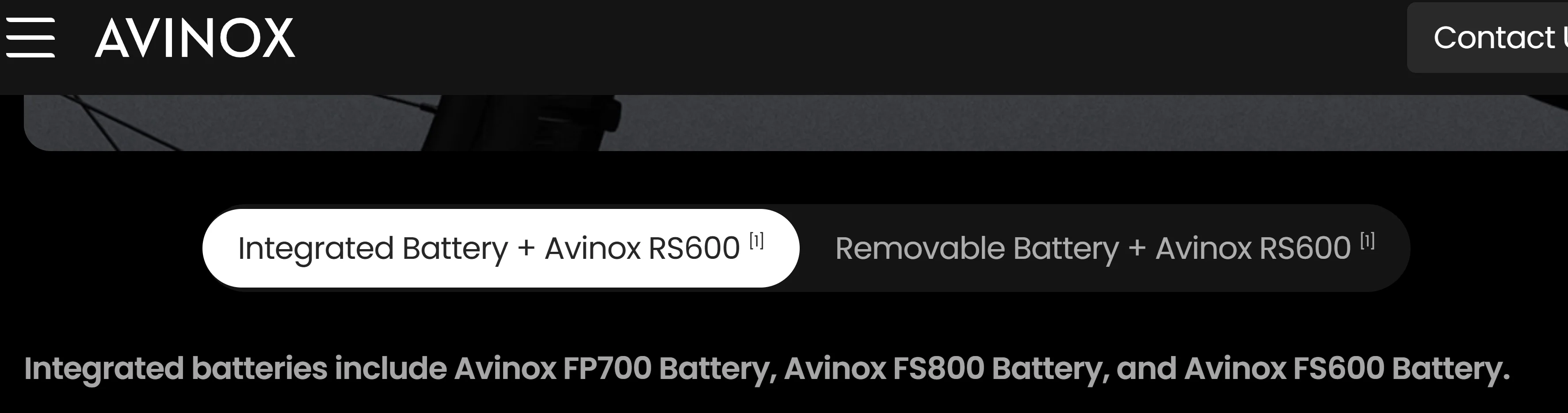

Current firmware already contains support of the two battey.
The dual battery it is an Avinox offer and not Amflow only offering, as you can see on the Avinox web site.
In fact they mention that is compatible also with FS800 and FS600 that no Amflow M2/s model use:
So not sure why you are stating that is not compatible with other brands. Also they have gone public in multiple interviews that they will come out with a smaller one too.
Of course some frames maybe in compatible due to the available space but saying is not compatible with other brands using Avinox is not correct.

Most frames with cell layout of range extender along with shock reservoir will not even take a 400wh.
Only release has been for amflow with 600wh. Not disputing the Avinox firmware etc or options.
Seeing the design of Whyte frame and Yeti makes it impossible to fit the current 600wh or the proposed 400wh.
