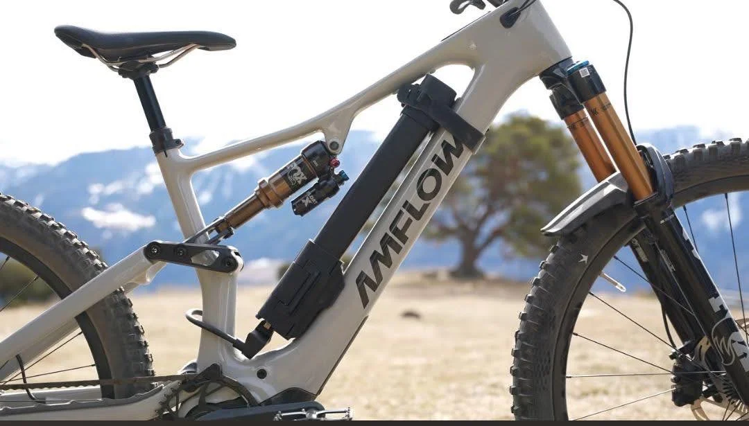

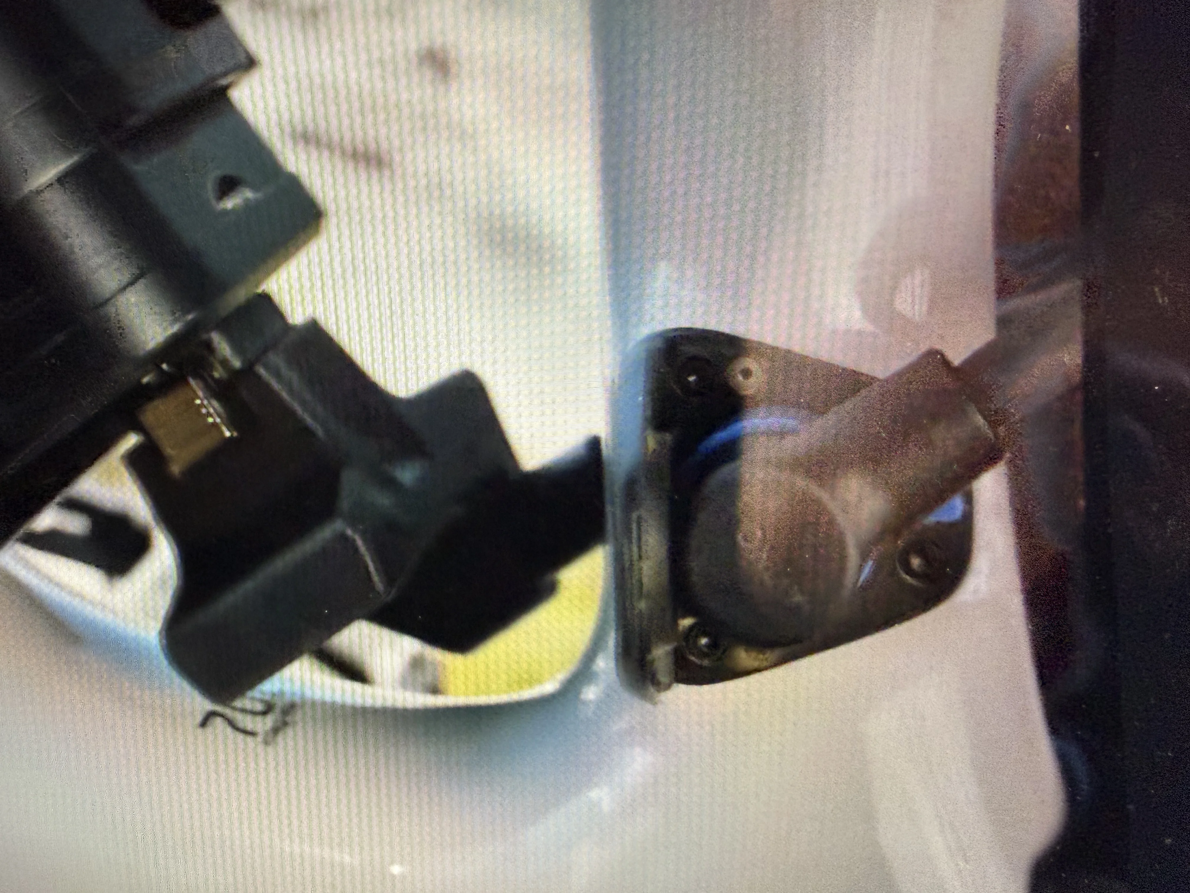

The images of the unit sold on a Spanish site shows the extender plugged straight into the port on an S1 Amflow. At best this is a highly vulnerable position and likely to get the charge port smashed.

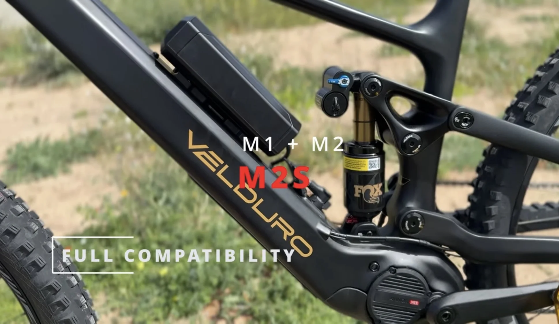

Directly on the charging port as most other brands RE are.
it is, but the Amflow port cover seems badly designed for this purpose (though really good normally as closes itself - I've ridden with my Rise port open and got dust and water in it loads of times over the years)
That is a good point. A charge port cover could be an excellent design for normal use, but terrible for use with a RE plugged into it, or the reverse (flimsy non-self closing ports that normally suck but are unlikely to break off if struck when in the open position with a RE plugged in). Does any company manage to do this well? Locating the port on an interior face (rather than the side) of a tube seems preferable for bikes that may be used with an RE.
Failing all of that, I hope Amflow offers inexpexpensive replacement charge port covers, and hopefully they're not too much of a bother to install, as I can easily imagine catching my foot on the open flap and tearing it off.

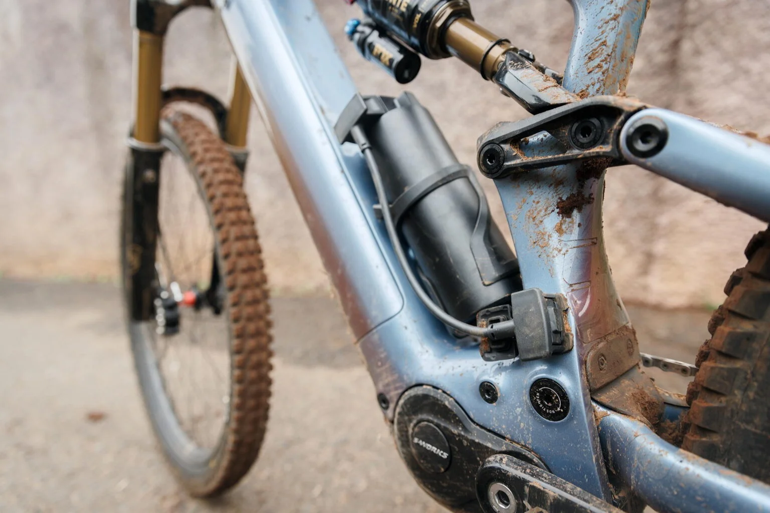

The gen4 Levo is in the exact same spot.
Velduro has the port in the middle that is more protected but depending on the shock it may be an issue
Yeah, that left side of the seat tube position is pretty standard it seems. It is interesting to note how the Levo wire, since it's not routed around the seat tube, helps hold the port cover flap fully open, so it is more out of the way. On the Amflow, since the wire is coming from behind, the flap is at a 90 degree position that makes it stick out maximally and I could easily imagine it snagging pant leg, shoe lace, or stepping on it in the heat of the moment. I'd prefer the Levo routing, although I'd probably want to put a strap around that long stretch of wire to hold it up against the side of the RE, to avoid it getting snagged on anything.

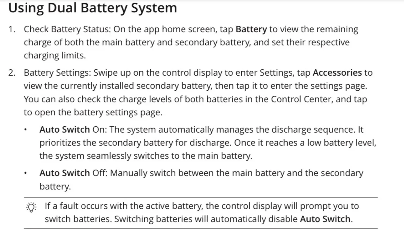

Someone just posted some images from the Avinox manual in the Pivot Amped thread, and it describes how the Avinox system prioritizes usage in a 2 battery system. Sounds like the default is to deplete the RE first, then the main battery, but you can also manually switch between batteries.
