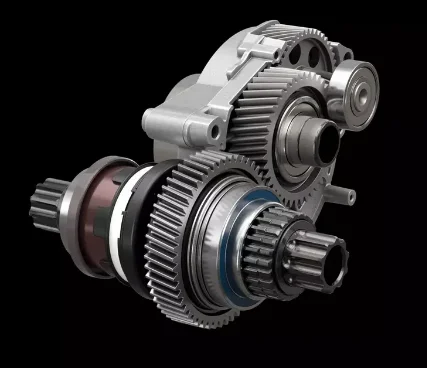

Specialized motor, no planetary reduction and no composite gears.
I dont know if it rattles, but the output shaft follows the same solution with a clutch bearing inside the output gear.
