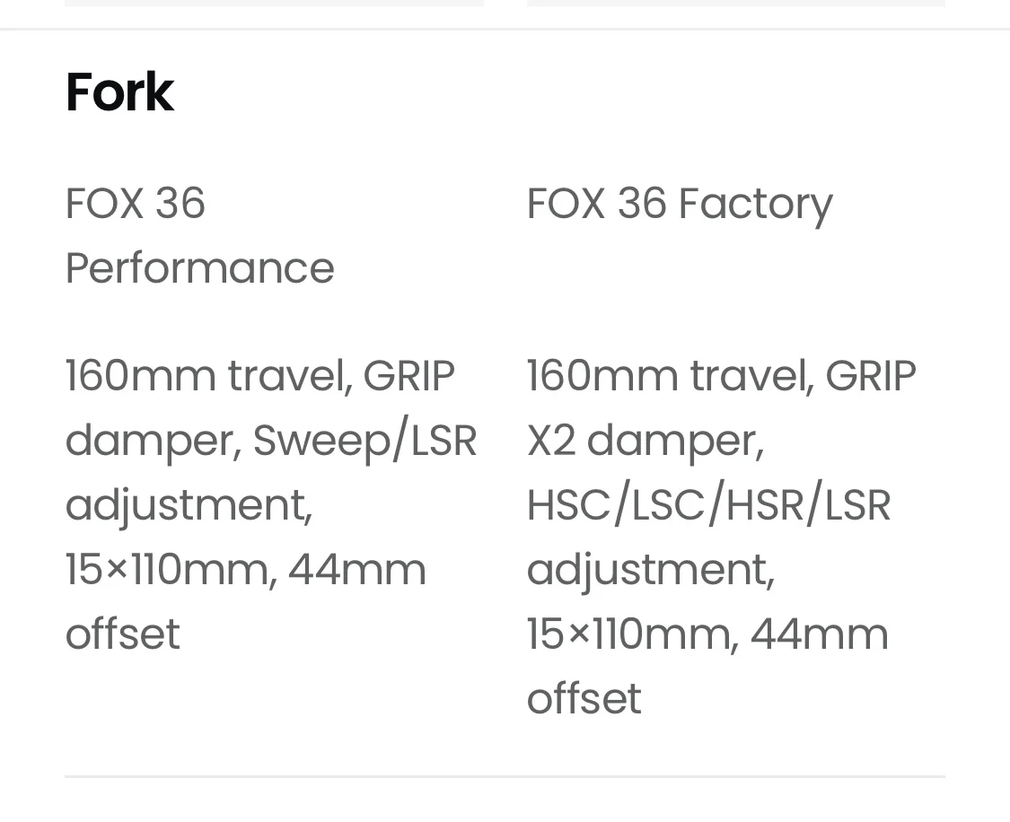

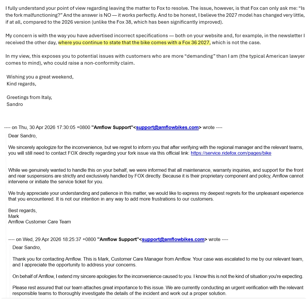

Even if it were written in Arial 40 on the website, it wouldn’t change much; I argued with support for a month asking why my Fox 36 was a 2026 model while the website and newsletters say it’s a 2027.
After dozens of emails and escalations, the bottom line was: “Take it up with Fox or just keep it as it is!”

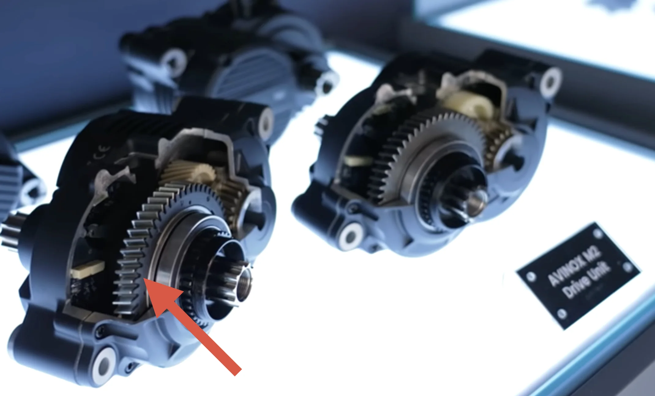

it may not have been explicitly stated, but definitely suggested that it would be pretty silent. Definitely a bummer

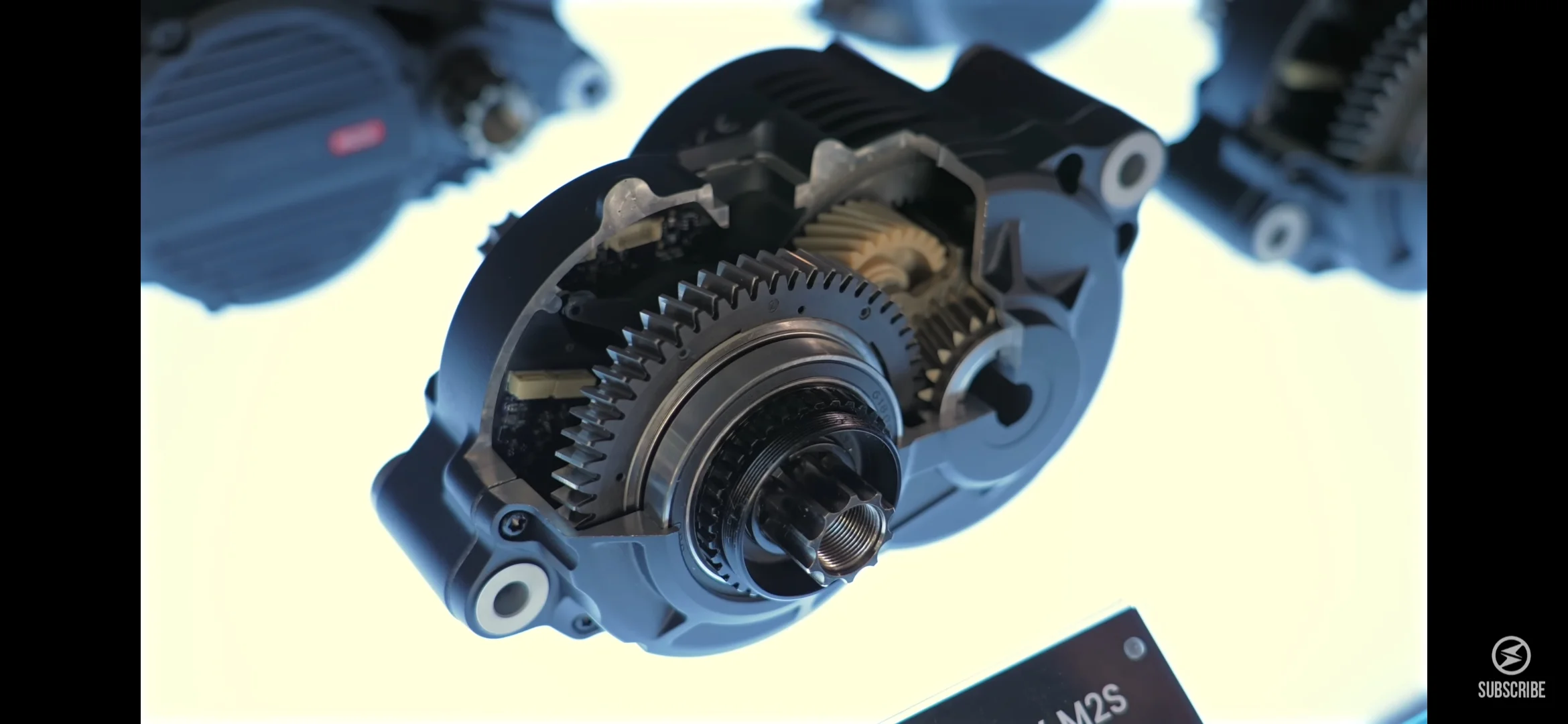

"So this is our like top-of-the-line product where you can see that we worked on reducing and actually eliminating the rattle sound when you go downhill. And for that we have this dual mesh system here that you can see."
1:18 in the video:

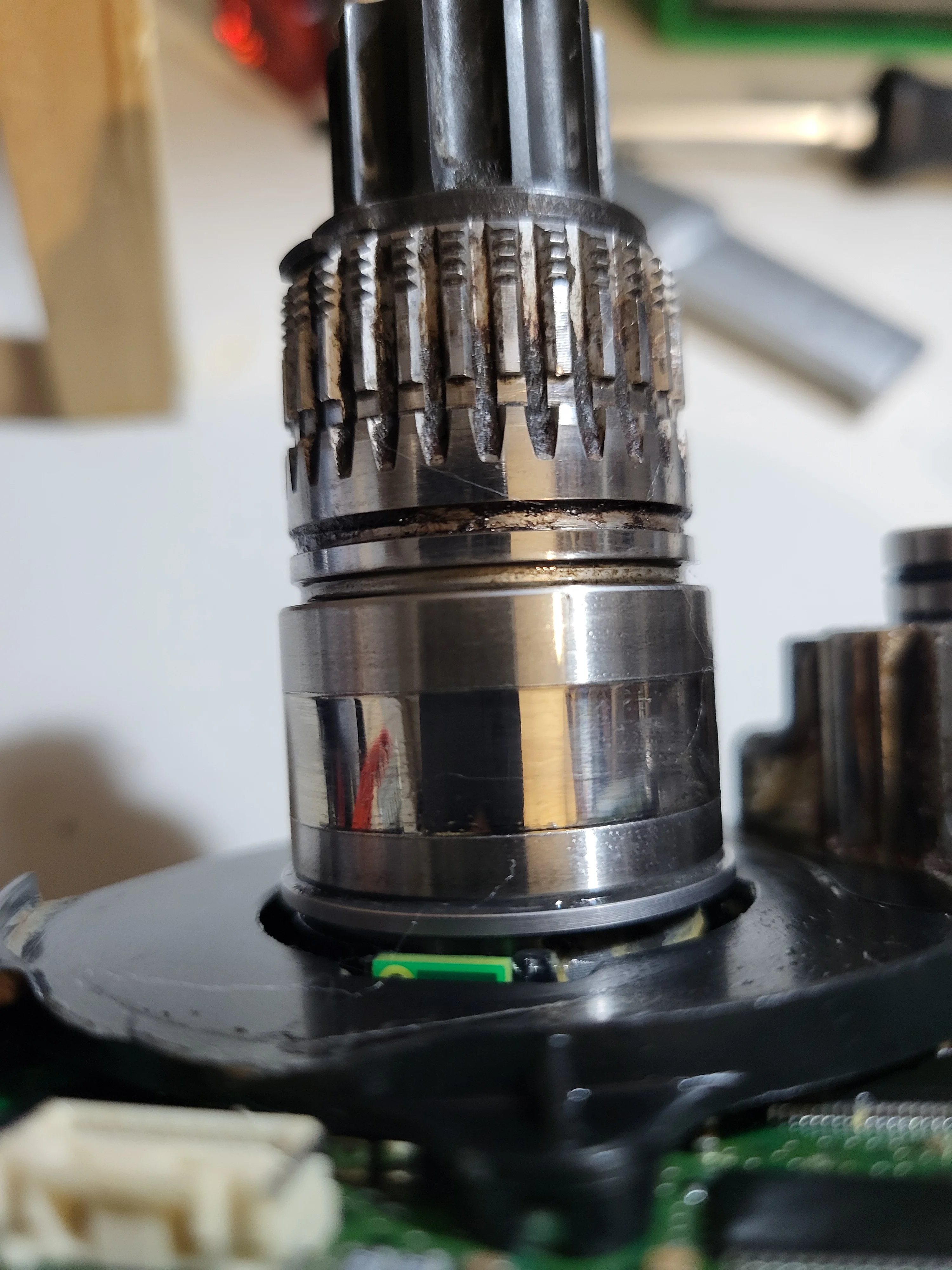

The rattle problem of Bosch Gen 4 was, in my opinion, some play developing between the main gear clutch bearing and the output shaft due to lack of sufficient hardening of the shaft.
Who knows if it will be the same on MS2?

When I saw the plastic(probably delrin material)mesh gear for the 1st time, my initial thought was 》Wow great idea, but why so thin? It looks like maybe only 3-4mm thick. How is the durability going to be, Is is going to last or will it need replacements after a while. Then I thought, well probably they did some testing and got to a conclusion it's fine.
Exactly my thoughts 3 weeks ago

There wouldn't be the need to reinvent the motor, they could just implement a cage damper for the outer sprag clutch like the Bosch Gen 5 has. This thing doesn't need much room and its the only method for making the motor rattle free imho.
