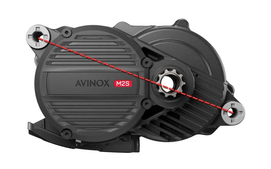

Can someone measure the center-to-center distance between the two mounting points?

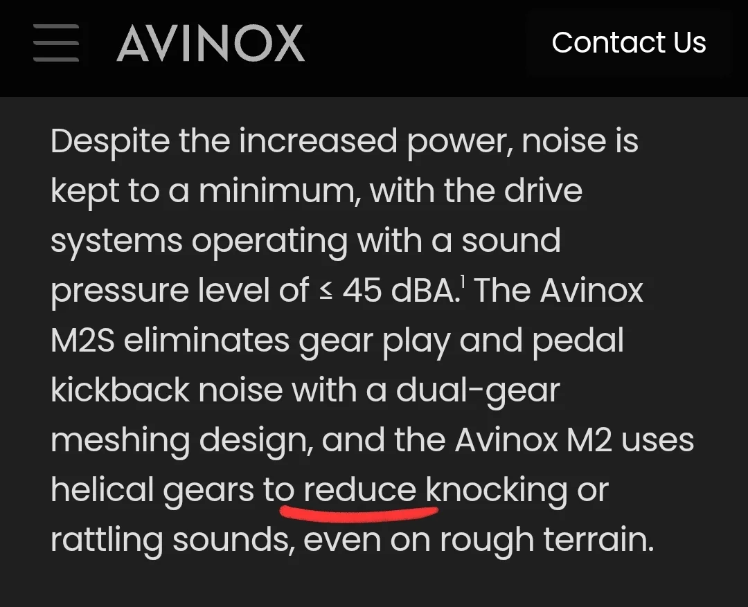

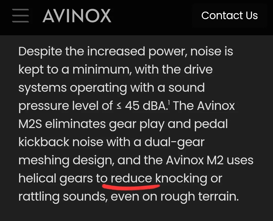

Can someone please point out where Avinox mentioned that M2S is rattle-free? Or rattle-free being as a selling point or "new feature" over M1 ... Have they even officially addressed/confirmed rattle in M1? I know it's being mentioned by almost every influencer out there, but did Avinox said/write anything about that? Because if not, they will simply say or write on their website that this sound is considered being normal with this motor and no warranty will cover it ... Because if it will became a broader problem, maybe they could not fix this problem in current form factor, so even warranty will not save you ... They could only replace the motor and then you will get rattle again over time with each new motor ... Something similar happened with Brose motors failing on Gen2/3 Levos, where some had replaced 5+ motors, Spesh even admitted the problem and extended motor warranty on some models for additional 2 years ...
Despite the increased power, noise is kept to a minimum, with the drive systems operating with a sound pressure level of ≤ 45 dBA.1 The Avinox M2S eliminates gear play and pedal kickback noise with a dual-gear meshing design, and the Avinox M2 uses helical gears to reduce knocking or rattling sounds, even on rough terrain.
Ok great, just in case I saved a screenshot for future reference 😅

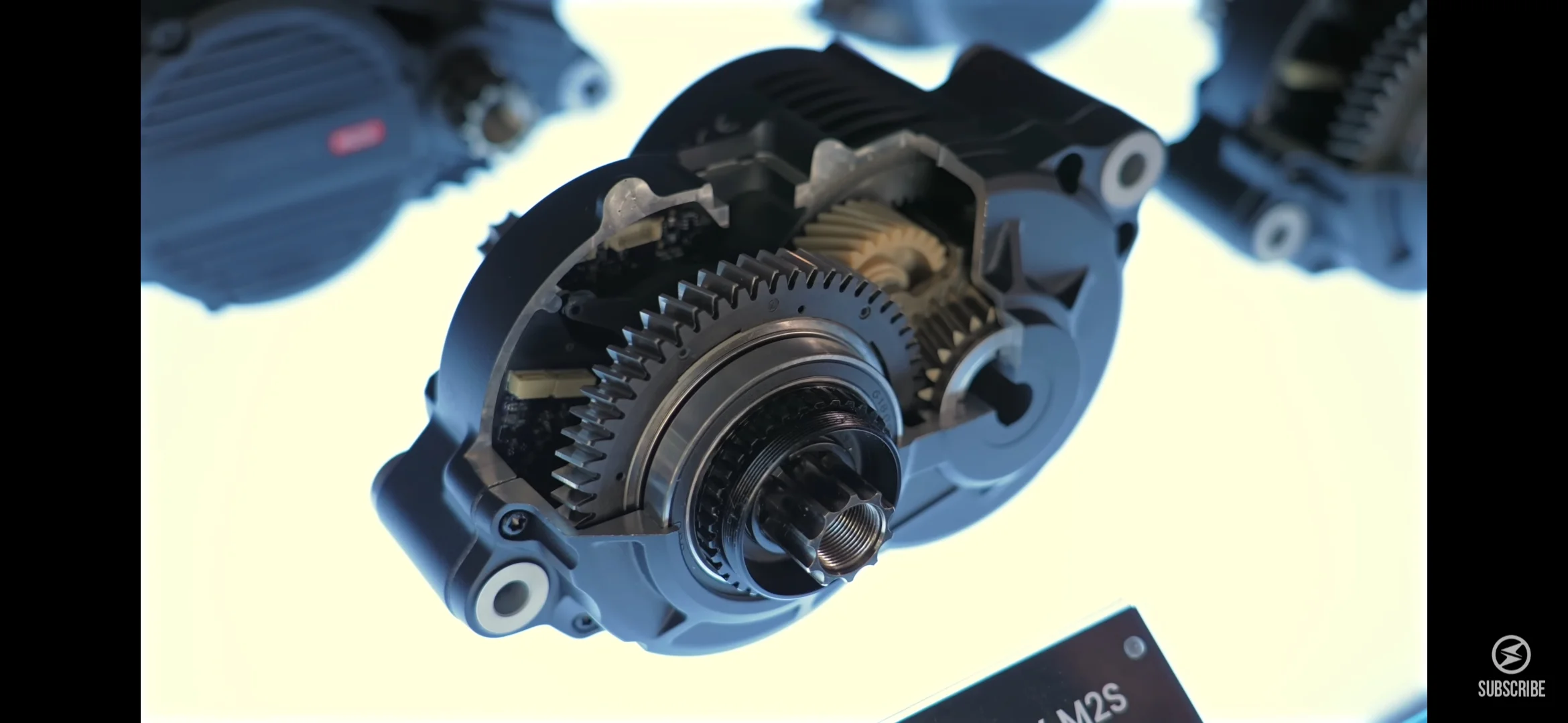

The 'dual gear mesh design' I assume uses a spring mechanism to apply that spring pressure that takes up the gear slack.
With enough motor use, possibly the spring pressure reduces as the spring mechanism itself becomes fatigued, and therefore rattle increases.
I would not expect Avinox to warranty a rattle since they never explicitly stated the rattle was completely eliminated.

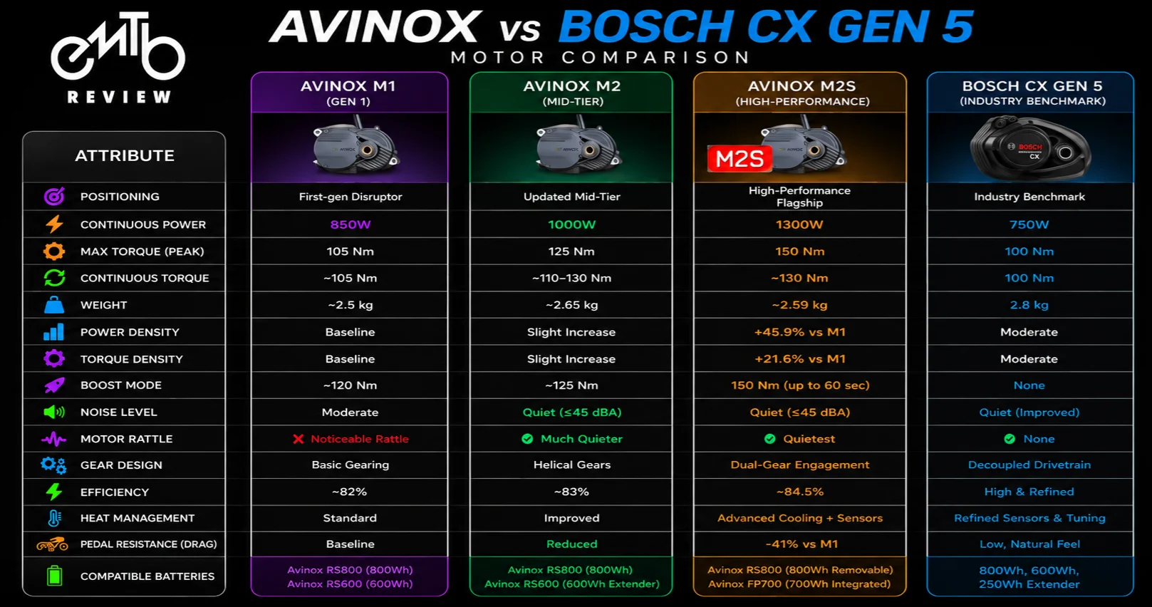

Avinox themselves never claimed the M2S is completely rattle-free.
The comparison table floating around recently actually shows this pretty clearly.
- Avinox M1: “Noticeable rattle”
- Avinox M2: “Much quieter”
- Avinox M2S: “Quietest”
- Bosch CX Gen 5: “None”

When I saw the plastic(probably delrin material)mesh gear for the 1st time, my initial thought was 》Wow great idea, but why so thin? It looks like maybe only 3-4mm thick. How is the durability going to be, Is is going to last or will it need replacements after a while. Then I thought, well probably they did some testing and got to a conclusion it's fine.
Delrin is a phenomenal thermoplastic material with great properties that acts as a replacement for metal parts, that works fine between -40°C to 80°C with peaks up to 120°C.
When I saw Velomotion's test of the M2S, it clicked right away, when they showed the derating test. The M2S unit's housing was measured at a whopping 120°C at that test. That means the internals were at even higher temps.
Could it be that the delrin mesh gear doesn't hold up to the internal temps at high loads and get twisted and jammed due to being that/to thin? Or is there some other problem with the implementation of the gears spring loding mechanism that gets jammed.
Edit: Another thought is on lube, at high temperature lube starts to flow, could the lube that was on the main gear have gone between the plastic mesh gear and the main one and when the motor cooled down thickened back to original thick state and glued the gears together with surface tension and the spring loading mechanism isn't strong enough to loosen them.
With this mesh gear on the M2S they were solving the rattle at the crankshaft main gear(the big one). So going back to the M1, that gear was my suspect on the M1, as it was straight cut there, but the M1 apparently also had a rattle inside of the sun/planet gearset as Rob mentioned when he had a preproduction unit. Could that be it on this M2S? Who knows...
