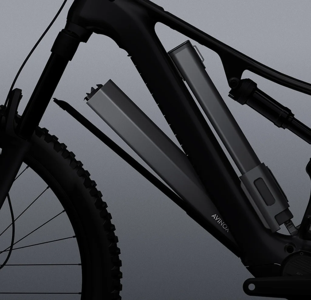

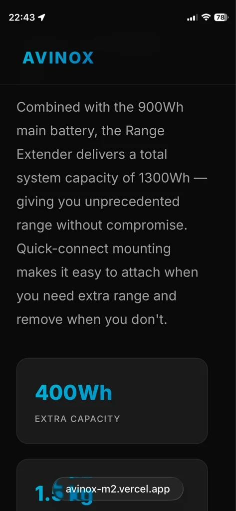

A 900Wh(max 940Wh) is definitely possible already a lot written about it. Slightly less capacity(6,2Ah) cells would equal to 900Wh. Or they are just being modest with the actual numbers and it's in reality a cca 930Wh.
But a 1,5 kg 400Wh is obviously highly unlikely, let's elaborate.
With 21700 cells(5,5Ah) only the cells, in this case for 400Wh we need 20 cells × 73g would weigh in at cca 1450g. 50g for the rest(housing, cell holders, wiring, bms,..)?
Unlikely to use those cells, but the older inferior 18650 cells(3,6Ah), in this cas for 400Wh we need 30 cells x 45g would weigh in at cca 1350g. A 150g for the rest(housing, cell holders, wiring, bms,..)?
Unless Amflow/DJI is a step ahead?
The only theoreticaly possible way for a 1,5kg 400Wh Wh REx is the use of solid state battery tech that's is emerging and promises 400Wh/kg. In that case you stil have 0,5kg left for the rest of the REx(actually u don't need wiring, cell holders, only a bms and a connector).
Maybe new Molicel INR-21700-P60C, 20 x 75 g, = 1.5 kg cells + case, BMS for total 1.8 kg 432wh or even Molicel INR-21700-M65A for 468 wh same weight., less power....
Yes 👍 good math, I already also wrote in one of the threads about these possible REx.
I had a brainstorm about the possible form factor this size REx could have.
We need to stack 20 cells
1. A square shape (2x5 bottom rows, 2x5 top rows). REx cca 37cm in length, 5cm in height and 5cm in width.
2. A trapezoidal shape 3 x 4 bottom rows and 2 x 4 top rows. REx cca 30cm in length, 4,5cm in height, 5 to 7cm in width.
3. A slim rectangular shape 3 x 7 bottom rows(1 row has only 6 cells). REx cca 52cm in length, 3cm in height, 7cm in width.

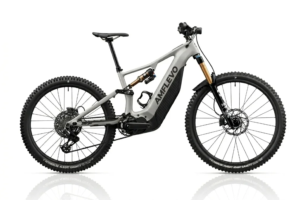

Amflow website updated with new models:
£3999 PR
£5399 PR pro
£6499 PX
£8999 PX Pro
4k for PR is great value for money, disruption ahead.

700Wh battery uses larger cells for higher continuous current draw and improved power density
No Range Extender for PX, but the 600Wh removable battery for the PR can be mounted inside the PR front triangle in a "cage", but only on the larger sizes.
There is a strap that goes round the frame and the top end of the piggyback battery (not shown).

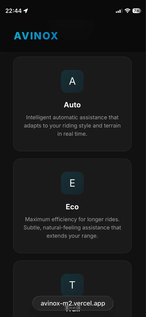

Wired for Auto, Coast etc.

Do we know if the dual setup works also with PX or only PR (which is what i assume).
600Wh Piggyback
Only PR Series
Only PR L/XL/XXL
Only PR Pro XL/XXL

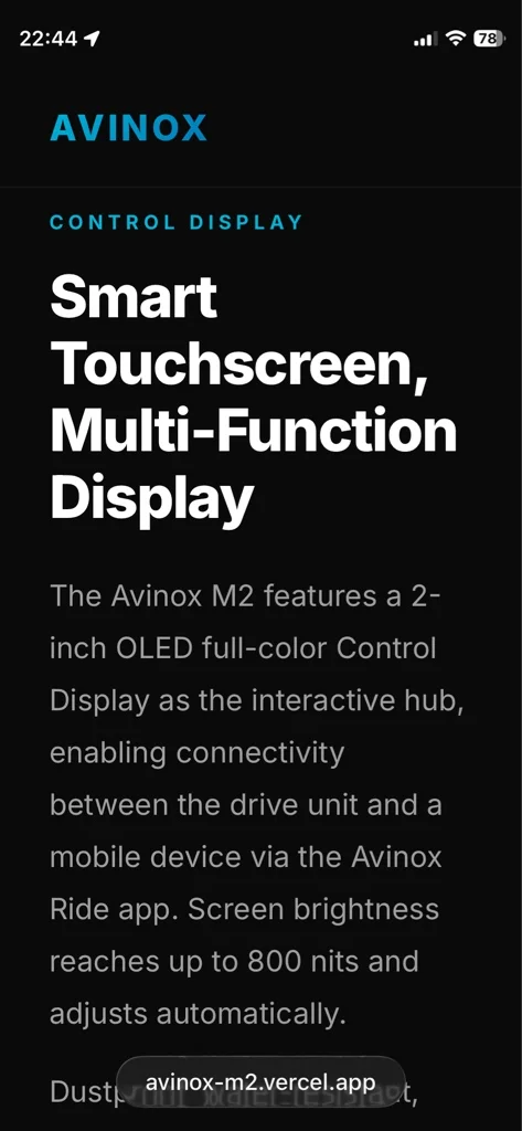

Display change.
No SIM slot
Uses Apple Find My to do tracking without 4G network.
Any word if the regular PX Carbon (non-pro) can use the sim? Or same display as PR series?
All the PX models seem to be using the same controller, so SIM is available and as a nice touch they include a little screwdriver just for getting to the SIM slot :)

600Wh Piggyback
Only PR Series
Only PR L/XL/XXL
Only PR Pro XL/XXL
PR Series uses a different charge socket !
From the official Amflow site:
12. Due to size constraints, the Avinox RS600 Battery is only available for XL and XXL models in the Amflow PX series and is sold separately. Additional configurations will be available soon.
