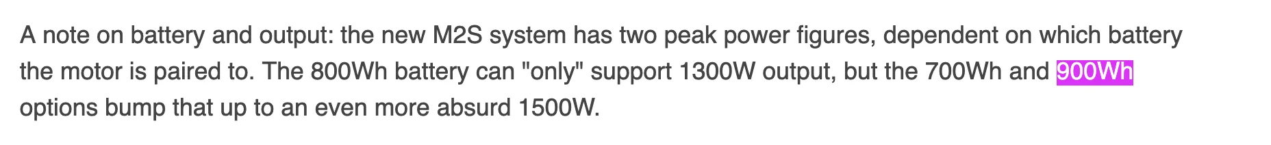

PR removeable doesnt reduce the peak power - it is at 1500W whereas the older ones are reduced to 1300W. Hence my initial assumption. It could be same cells but different BMS/wiring)....
The new cells allow constant 1500W, not just 1500W Boost mode.
"The M2S can sustain its headline figures of 1,500 W peak power and 150 Nm of torque on a continuous basis only when paired with the new FP700 — Avinox’s 700 Wh battery. The 600 Wh and 800 Wh options are limited to delivering this output in Boost mode for up to 60 seconds. The distinction lies not in capacity, but in cell technology. The FP700 employs the new 4680 cell format, capable of supplying substantially higher discharge currents than its predecessors — and it is precisely this current headroom that unlocks the motor’s full potential."

Rumours say 936wh molicell battery in certification phase.
It says 150nm so it will be M2S. It likely uses the last gen 600/800 batteries which cap the M2S at 1300w power.
Propain​
150 Nm | 1300 W​
120 Nm | 1100 W​
AVINOX via Ebike-MTB.com
  • Avinox M2 (performance is independent of battery configuration)
    Regular Modes: 1100 W, 110 Nm
    Boost Mode: 1100 W / 125 Nm
  • Avinox M2S + 800 Wh fixed battery (FS800) or 600 Wh (FS600)
    Regular modes: 1,300 W / 130 Nm
    Boost mode: 1,300 W / 150 Nm
  • Avinox M2S + 800 Wh removable battery (RS800)
    Boost mode: 1,500 W / 150 Nm
  • Avinox M2S + 700 Wh
    Regular Modes: 1500 W, 130 Nm
    Boost Mode: 1500 W / 150 Nm
Nothing quite lines up ? It is closest to M2S though :)
typo or leak from pinkbike?
The Avinox motor runs on a 36V system. To hit that voltage with these 4680 cells, you MUST have 10 cells connected in a single row (10S1P).
  • Adding 3 extra cells in a row to increase the WH would jump the voltage to 48V , it is chemistry, physics and math - even Avinox cant make miracles which is hard to believe for some. I don't think it is going to happen this year. It is completely new system. Specialized is using it and it is overall better but it needs complete overhaul.
  • Don't even know if there is a space for extra 3 cylindrical cells, maybe in the biggest frame.
  • Only way would be range extender for PX line.
  • in future if the length of the battery is already on the limits, they would need to look for thicker cylindrical cells to increase WH. That means thicker tube. Unless there will be a revolutionary cylindrical cell with same size and increased energy.
So sadly 936WH battery is not coming to PX. It may come to PR models though, with Molicell that are not cylindrical.
Correct me if im wrong. I wish i was!
