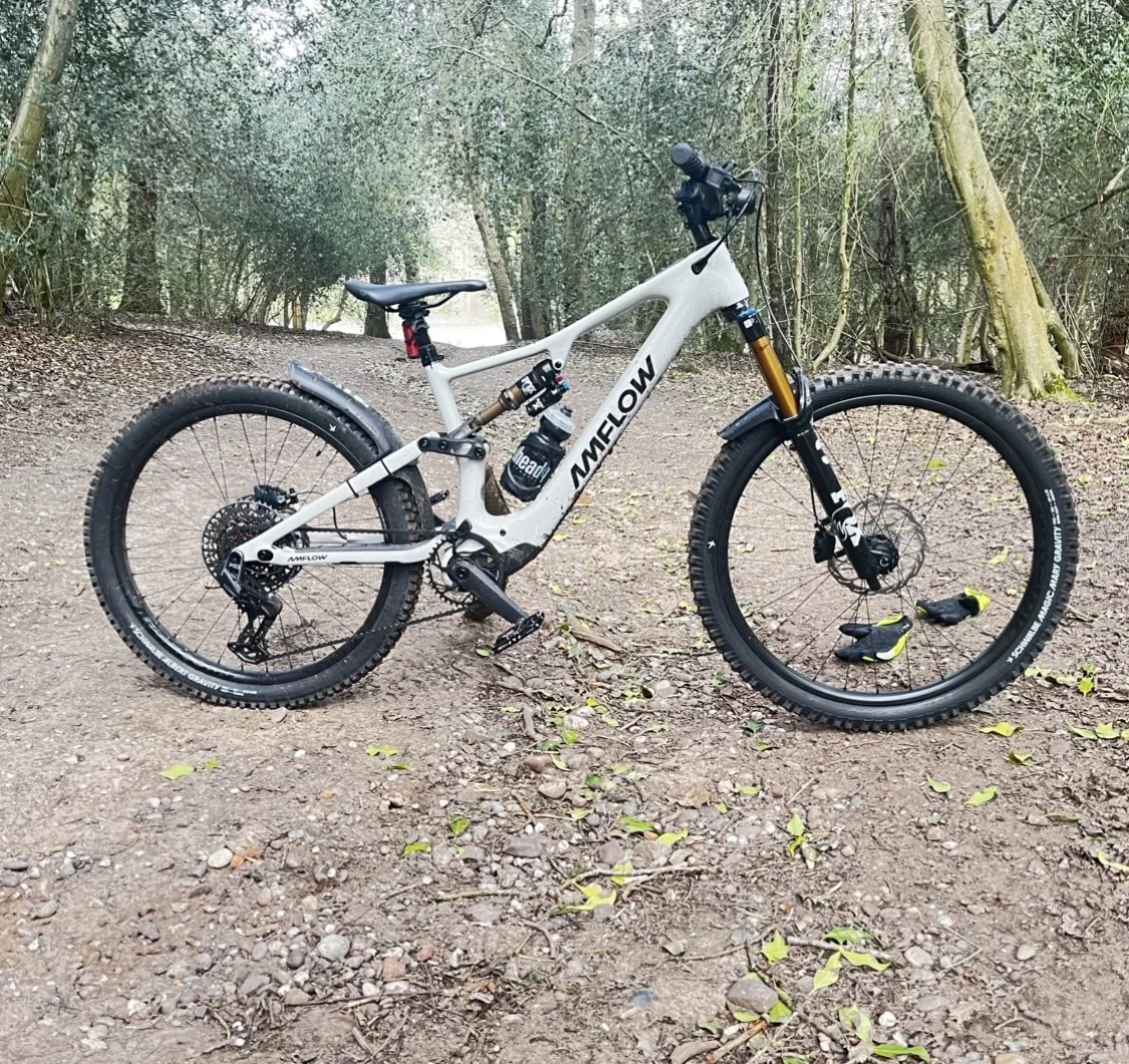

I’ve lost track of how many times you’ve mentioned that Amflow on this Atherton thread! The rear mudguard tells me we are drastically different riders….so your review might be meaningless to me, and vice versa
I ride my bike across many different courses and trails both here and abroad, in all weathers . The rear guard is what the supplier dealer recommends. Been rides MTB , scramble bikes and trial bikes and high powered road motorcycles for over 55 years. I would like to think I have a good feel if a bike is a bag of sht or not. This will be my 9th high end EMTB from 18, over which time I have done around 25,000 plus miles on them across all trails, courses, bike parks etc.
As for your observation with regard to me mentioning my AMflow Pro on this thread, asides to both bikes sharing the very same parts .who the F are you to tell me or anyone on here what to or not to post .
You mean you ride in the dry :) on blue trails only ?
