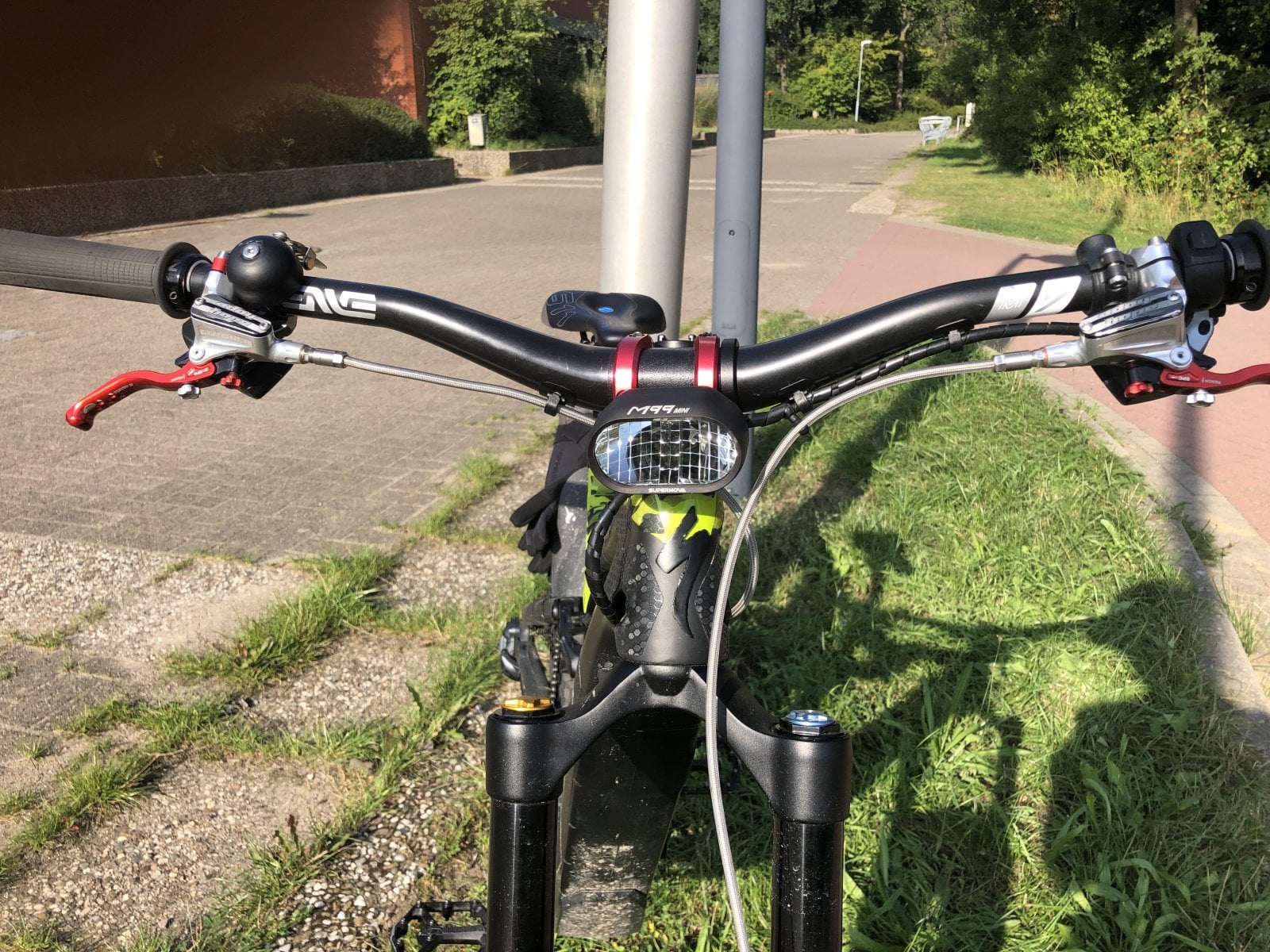

Running a Supernova M99 Mini Pro on the Light connector.
cable was like 12€ at R2 bike, shipping to uk 10€.
wanted to buy just the connector but didn’t find them anywhere, even front and back are a Little different As the back does only support 3w Max or so.
the Supernova E3 Tail light is also super bright, small, and fits perfectly on the seatstay where the braking cable is connected. Cable fits in the chainstay (Also the Aluminium one)

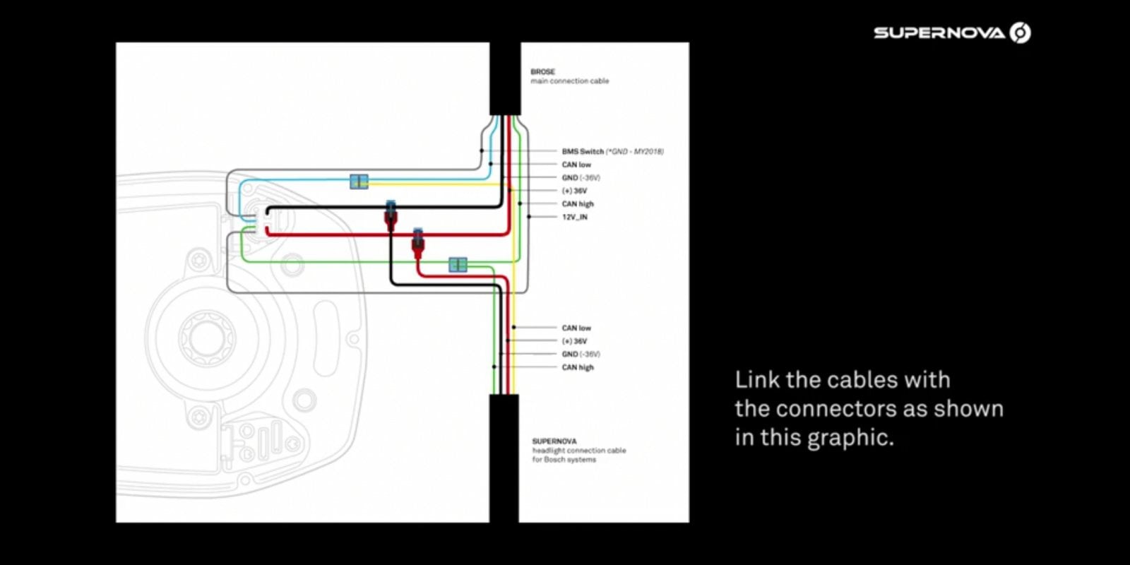

if you want to connect directly to the motor wires you could use the M99 Pro or one of the Lupines and get even more light.
But I liked the tail light much more than the Lupine ones, it doesn’t distract me, but everyone directly behind you will get mad, even by daylight ;) front looks much better too and I like the light distribution. I could take a picture the next time when I’m riding at night...Supernova is like 12w (6v/2a) vs 19w on the battery.
But even with the 12w from the light output passengers stop and turn in he other direction if I forget to change to low beam (Street legal mode)

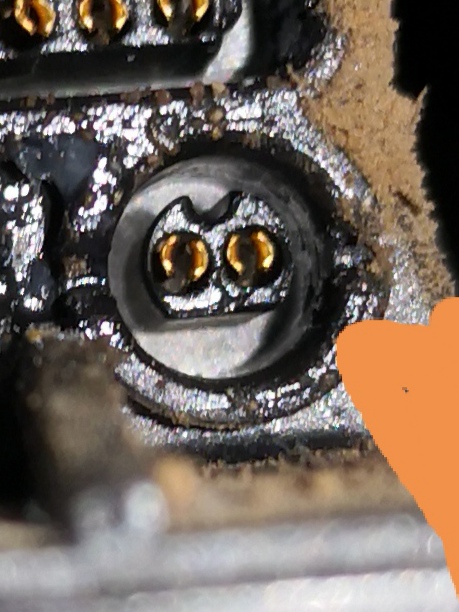

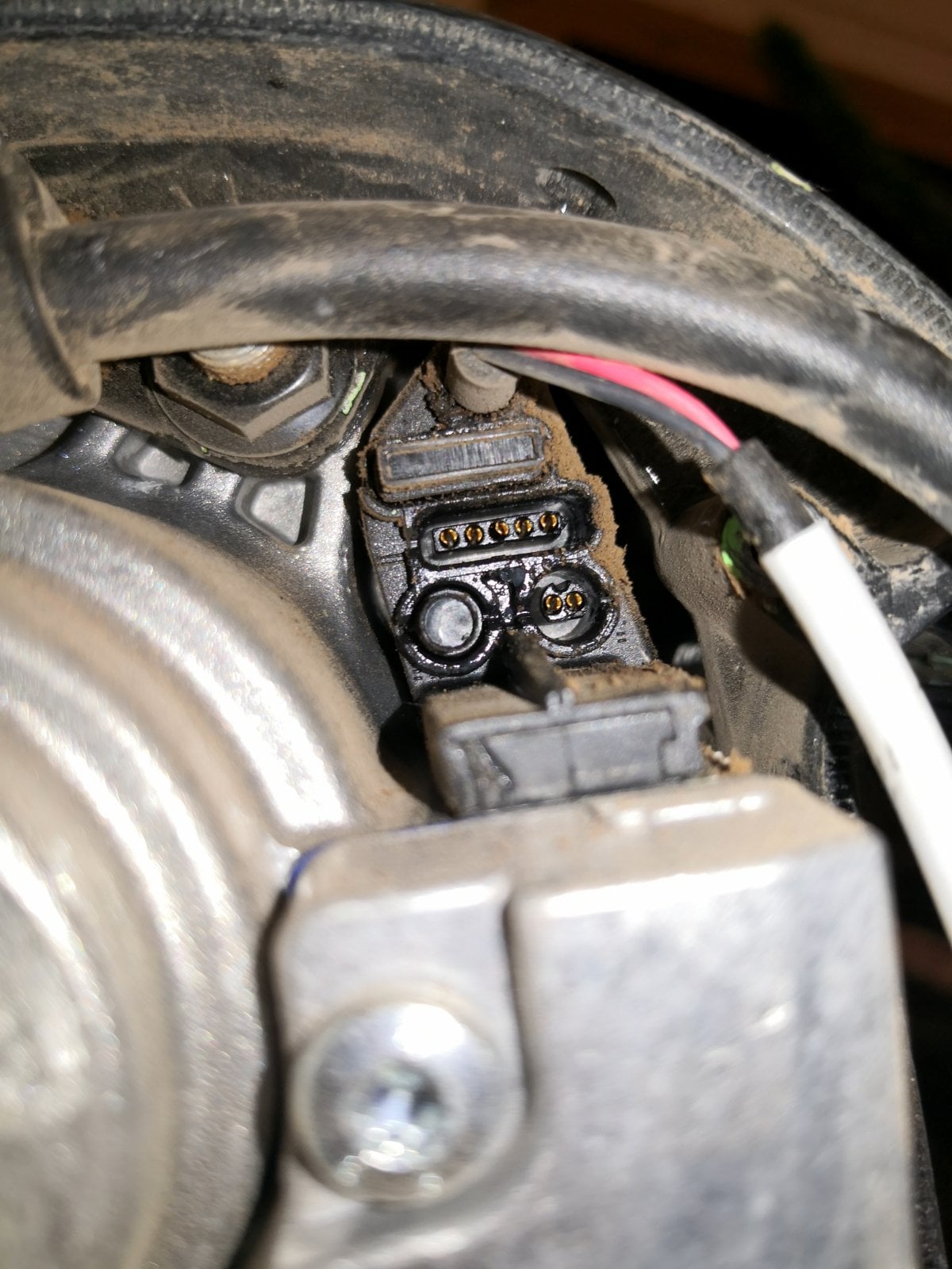

I don't know what the amp. ratings are on the two motor connectors, ( there is one for a front light and one for a rear light) or if they can be purchased in a local electronics shop.. I've certainly never seen this type of connector before.. it has an "o" ring to make it watertight.

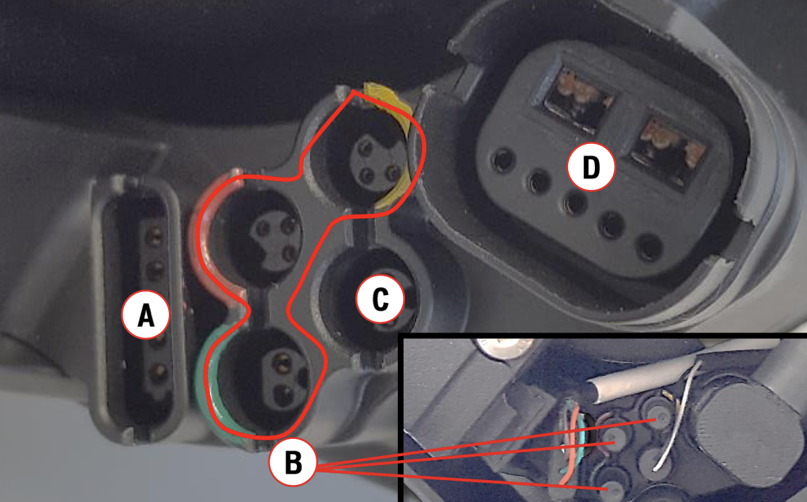

You can see the two motor connectors in the picture I took, on my Kenevo Brose motor:
The two round connectors, one with it's cap one, the other with the cap removed. The flat connector is the assist mode switch connector.

The MY19 uses a 2-pin connector (the green one at the bottom). I used the Lupine cable to pug directly into it.

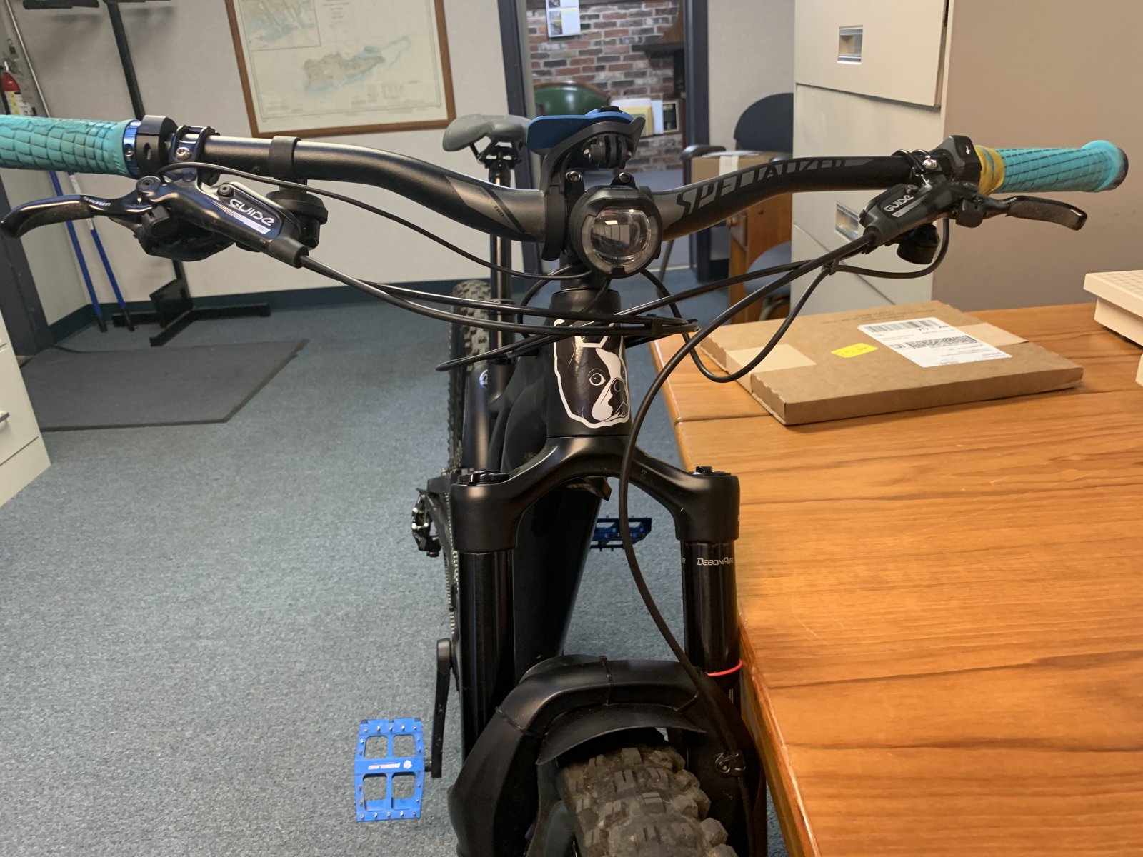

I bought a Lupine cable from eBay. It was about a tenner. It plugs into the port on the Brose motor, and has a bare black and red wire at the other end. I ran it up through the frame to the ports where the brake/gear/dropper cables exit. I used an old female connector from a broken battery pack, and joined it with a cable connector.
This runs my £10 Magicshine headlight on the bars perfectly. I still use a 18650 battery pack for the helmet mounted light.

I have a 19 Levo. It has ports to run a light? Where?
Take your left pedal off and the motor casing. There are two plugs blanking plugs on the motor, green is the front light, red is the rear light.
Both ports are active when the TCU is on so you need a light to auto sense the light conditions or fit a switch.

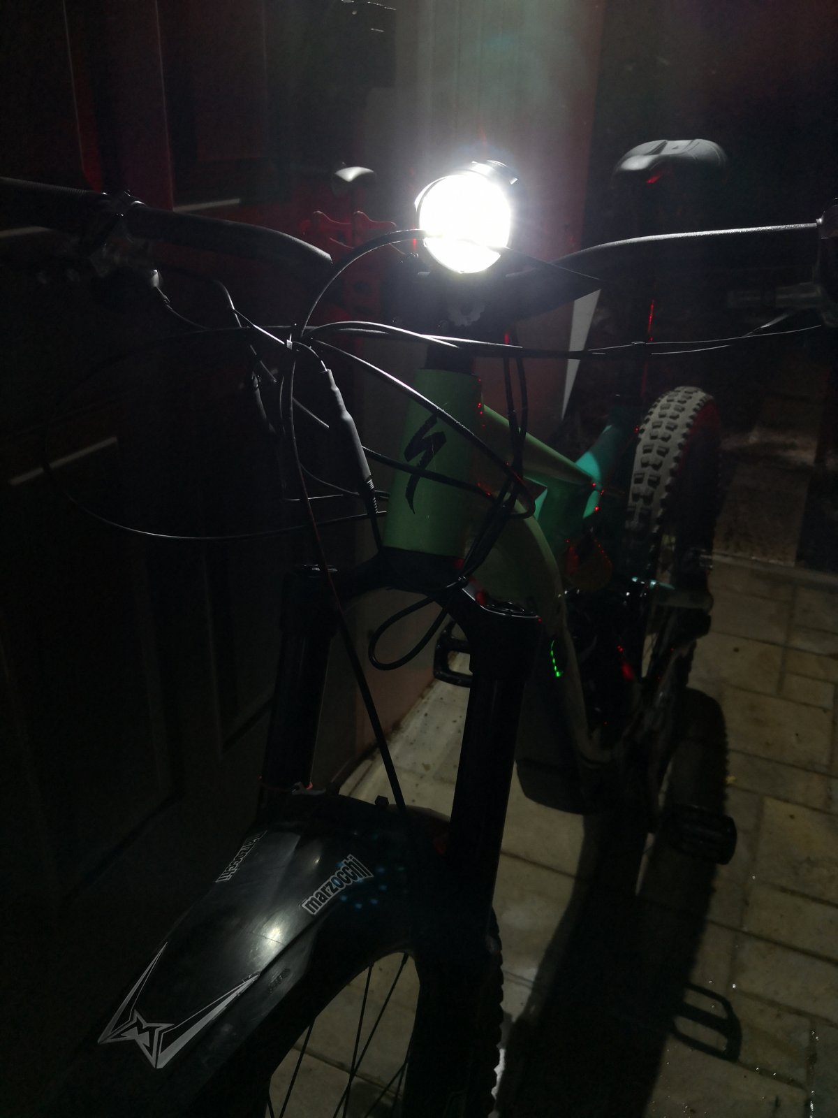

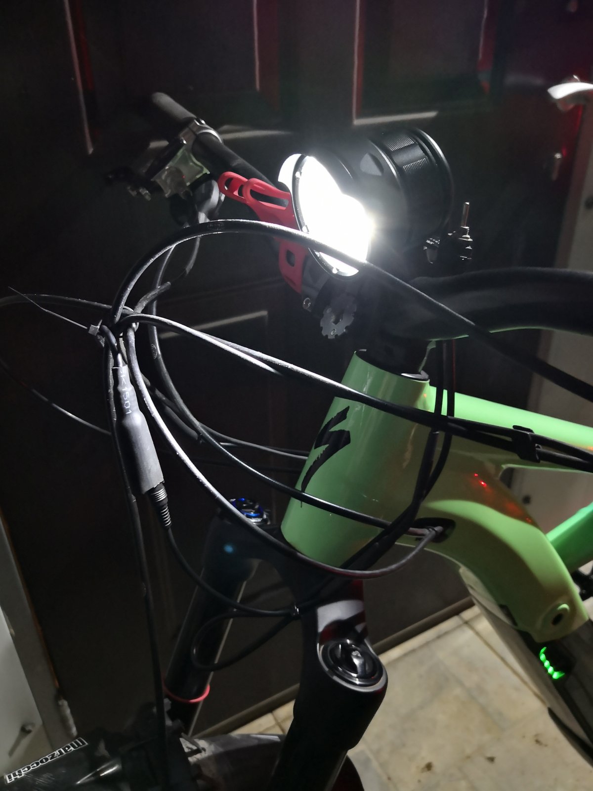

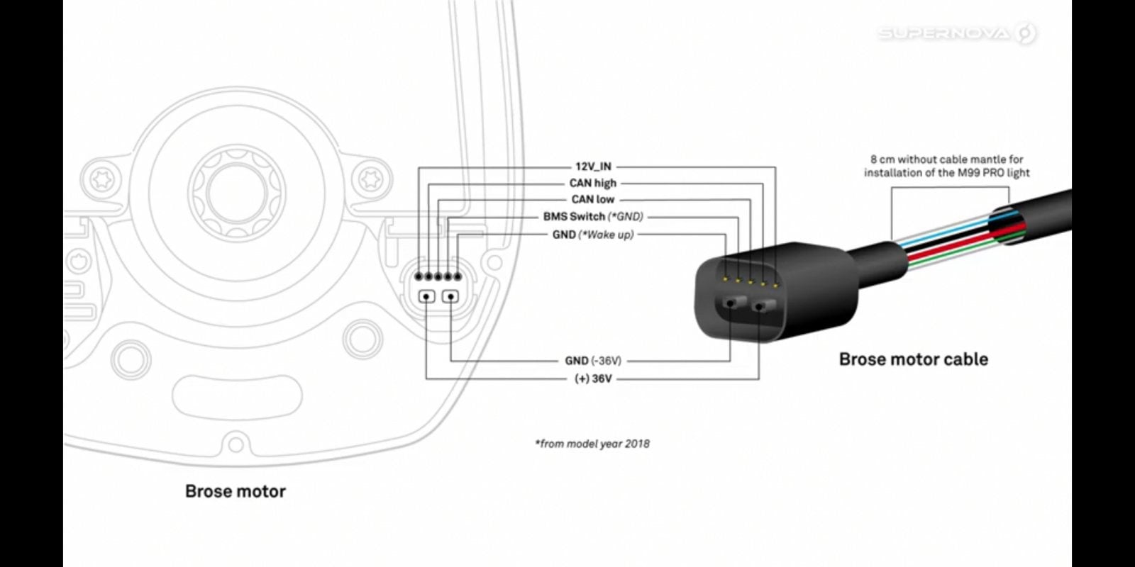

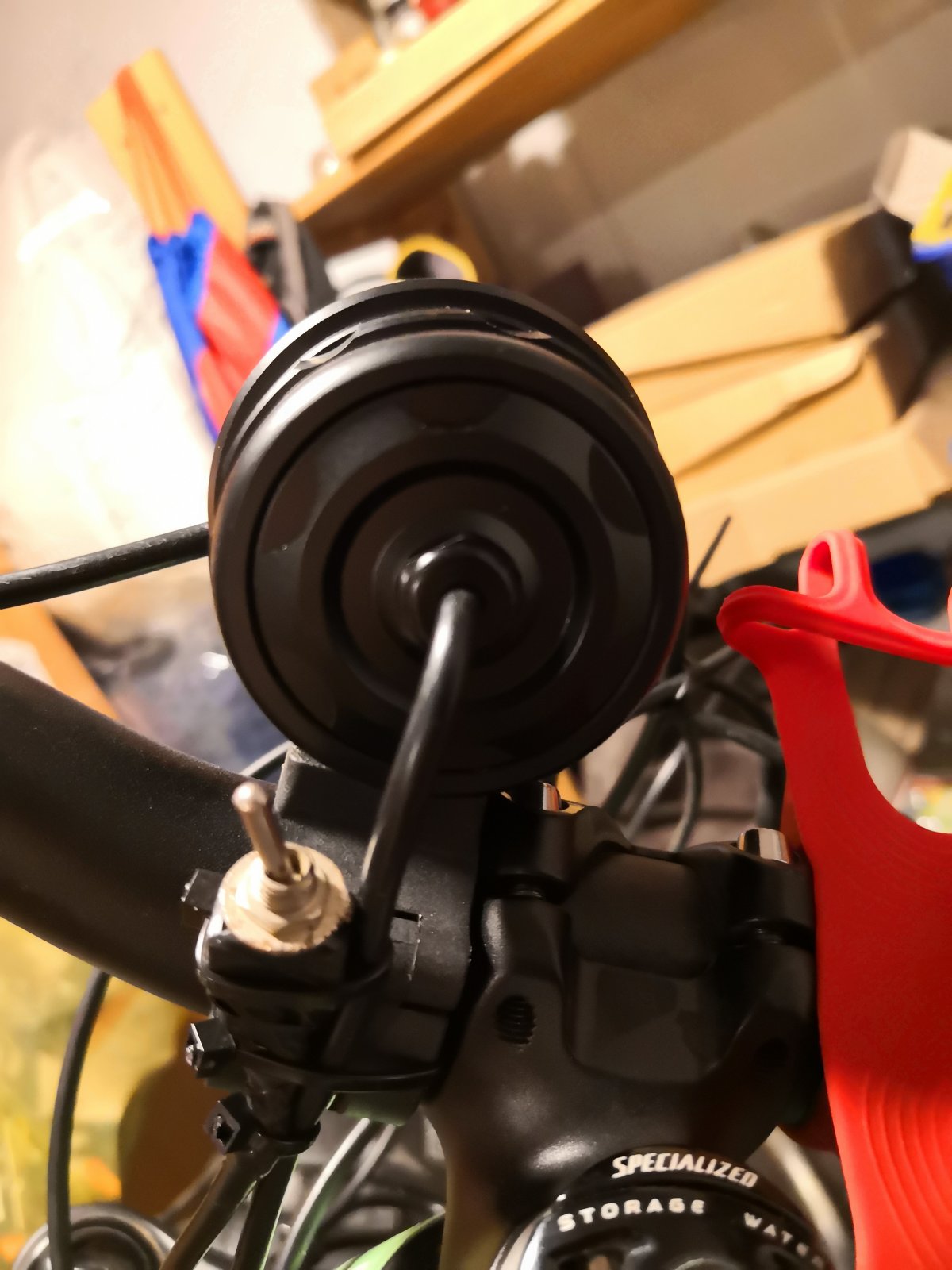

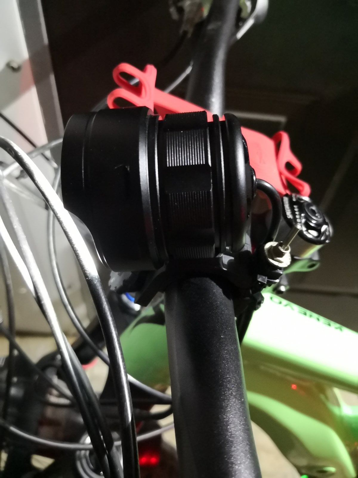

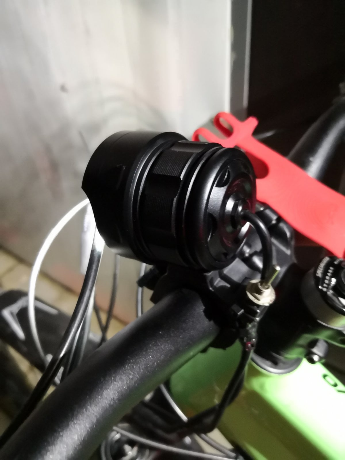

O.K. - so I realized the 6v 2 amp. Output on my 18 kenevo, was not suitable for my needs from an off-road lighting setup ( of multiple lights) the 6v lights I know of are not strong enough for my needs..
So decided to hook up the " multi-voltage" (12 to 100v) light I got off eBay for about 10$, directly to the battery cable - as i had seen in this video, from Supernova :
And according to the attached diagrams.
So striped the cable, soldered up the plus and minus wires, and routed the cable thrue the downtube up to the bars! And hooked it up to the light, and WoW! It works great! I've got 38v power on my handlebars! For any lighting or other needs I want!
And yes, before you all scream how dangerous this is.. I put a 5amp fuse on the plus side of the connection to the battery cable, in case of any shorts.
Hooked up a temporary toggle switch( till I can order a proper handlebar mounted switch) and tried it out, and it is a great light! With three power modes+ flashing mode.
Took it out on a ride at night, and the light was great!!!.... Only one "tiny" little problem..........
When I switch the light on....the motor power dies... And won't come back on till I switch the light off, and turn the battery switch off and on again.
Apparently the bike has a "CanBus" system.. like on motor vehicles, and senses a problem and shuts down the system when I turn the light on.☹️☹️☹️
Any bright ideas how to get around this wonderfull technology!!?????

I will order the Supernova Brose cable and try to wire up some Magicshine lamps I got.

My bike is a 2019. I have not checked yet what Voltage my lamps are. I guess they are 7.4V, so I will try to see what happends when I connect them to 12V. I guess a LED lamp will work ok anyway.
grantini
May 7, 2019
610
539
Delaware
Im sure this has been covered. but searched for lights and so on.... and found nothing of interest.
can someone tell me from their experience - if its worth it to buy the original (and expensive!) cable to hook up a light, to the dedicated connecto on the Brose motor? or just "hotwire it" to the battery harness, and it will work fine..? are there advantages? or disadvantages to either way? if so what are they..?
i've been looking for cheap alternatives to buying the customized headlights built especially for Ebike's, as i cant afford to spend 800 pounds! on a light..
so got a few from china that work on voltages up to 80 volt, but my problem is this - wiring it up.
checked on wiring harnesses, and the wiring plus shipping was at least 30 pounds! finally got a cheap one off Ebay.. but ended up getting one for a Bosch motor instead of the Brose motor i have..so it had the wrong connector. so if anyone needs one for a Bosch motor... iv'e got one for cheap!
would love to hear from anyone with real experience at installing lights...
what type of light? rated power? how you wired it? what kind of switch used? and so on..
Thanks!
Tim
I just installed a lupine all sf. It is awesome. Product support was excellent too. The only issue was cabling which was tight and the connector was damaged in the process. I cut off the connection and spliced in another and it works great
