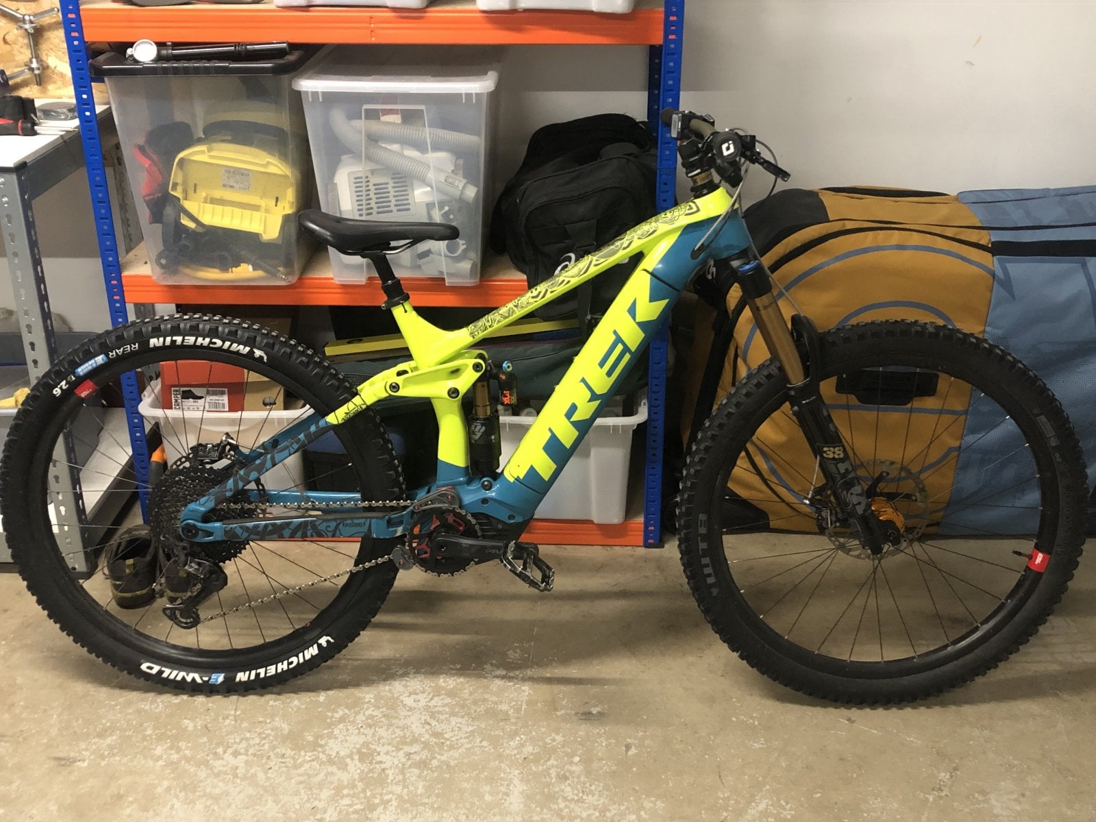

Fife
with 170 38’s
Jamo
Jul 25, 2020
52
22
Fife
Still trialing a few settings. Not quite where i hoped/expected it to feel but getting close.(y)
