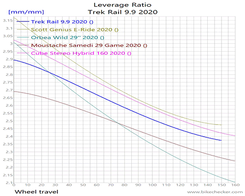

Don't you get more than 160mm in the rear ?
Ratio seems to be at 2.4
2.4*5mm = 12mm more travel ?
