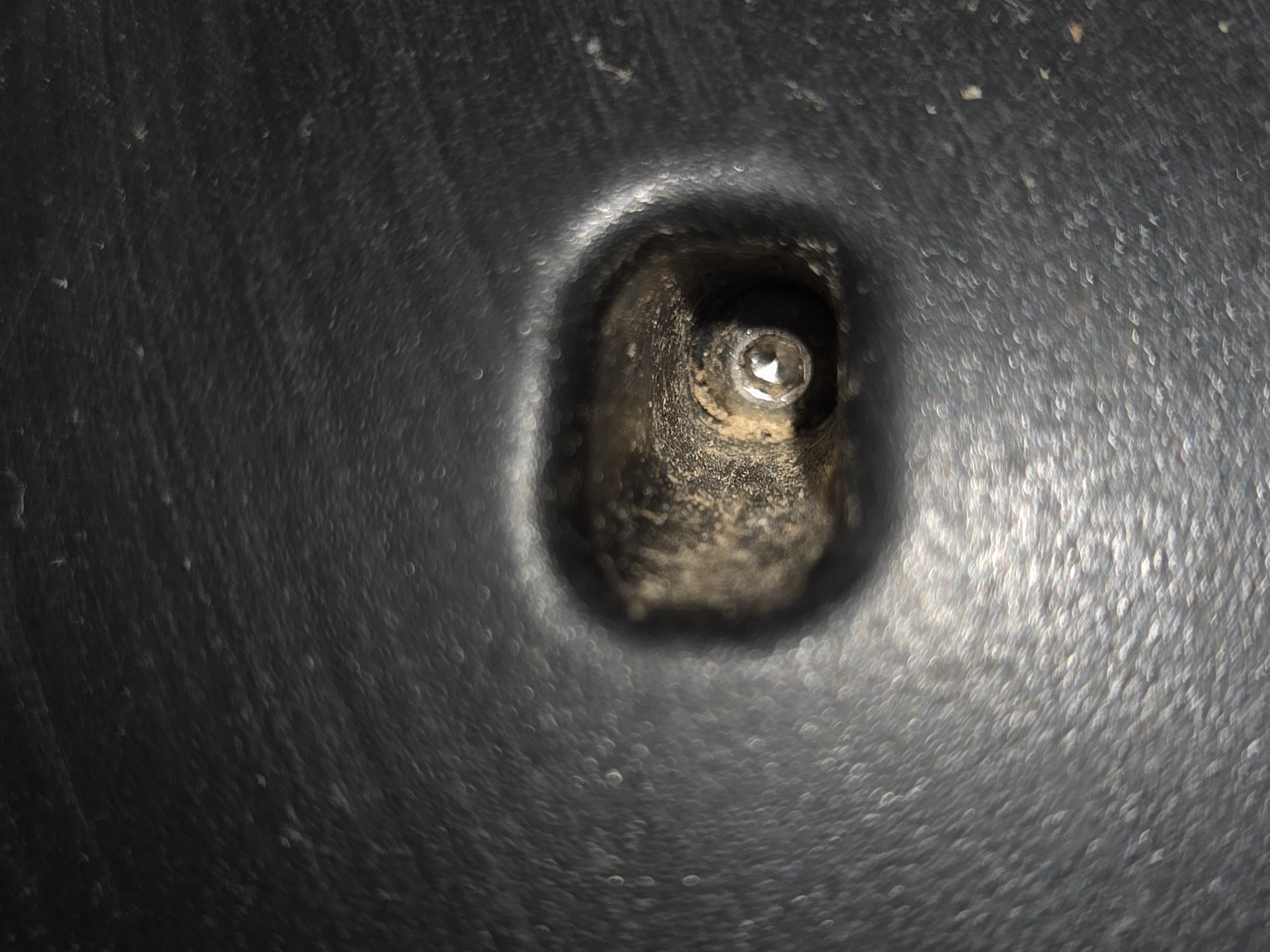

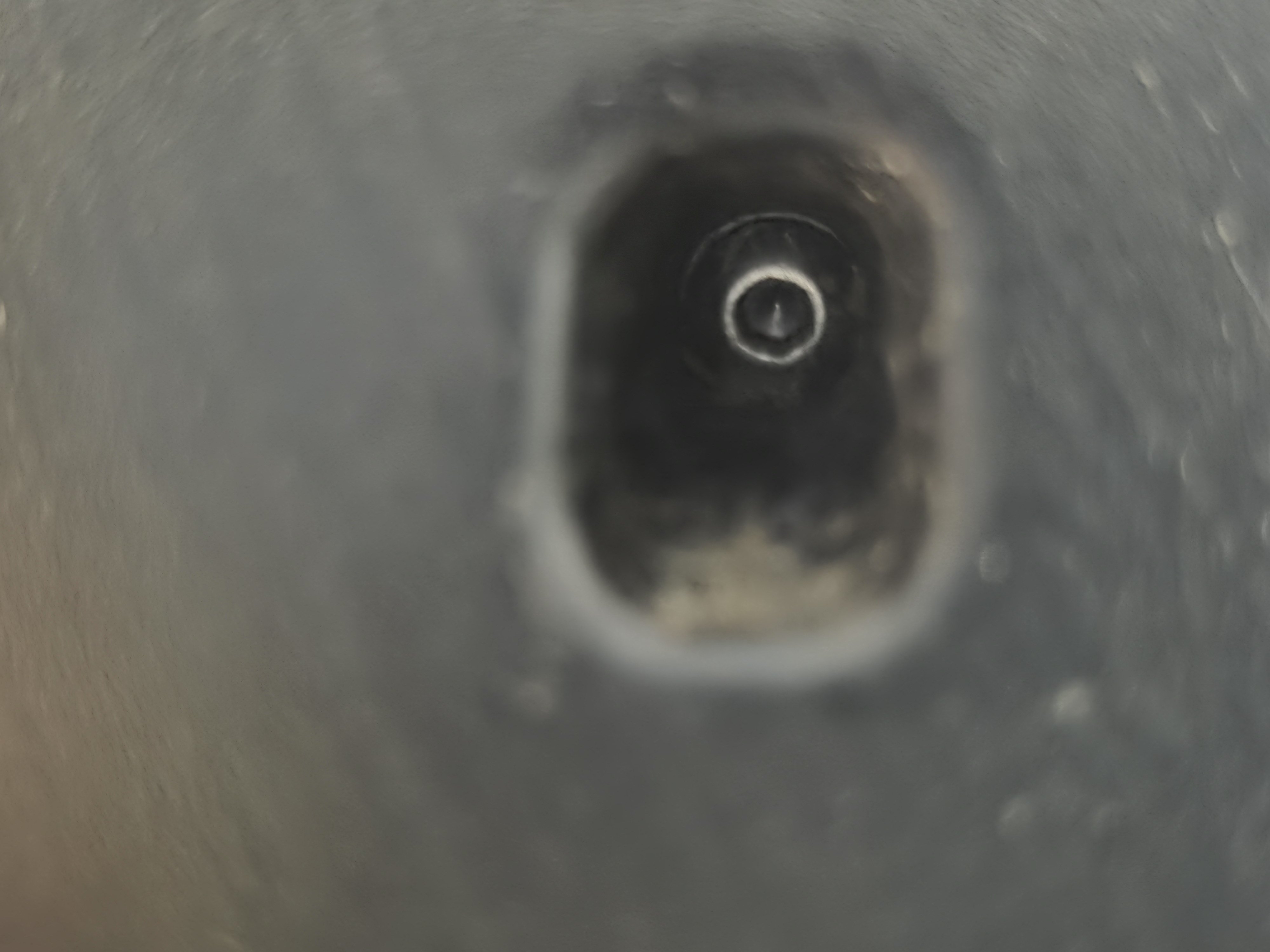

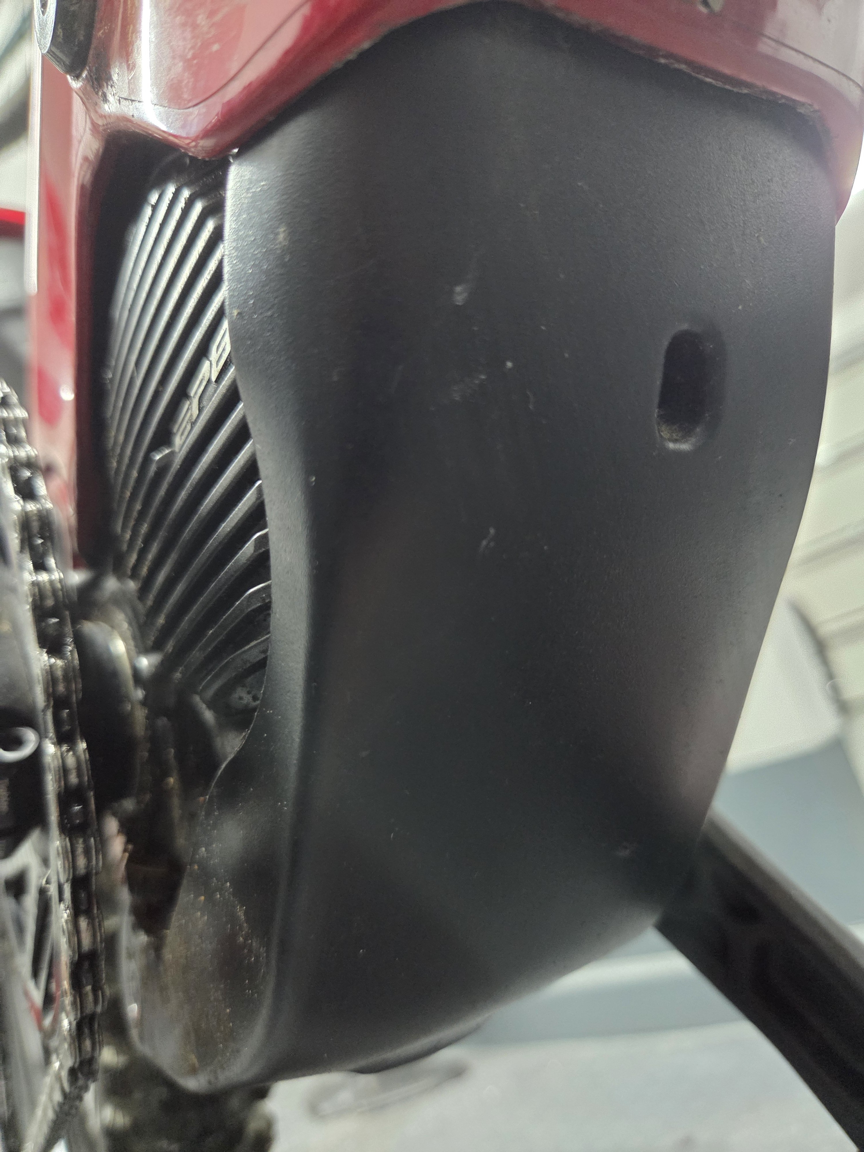

Trying to weather proof my Moterra by applying some Muc-Off HCB-1 Harsh Conditions Barrier, but struggling to remove the motor cover, can any one advise. I've removed the rear T40 bolts, is the front just a pin. I don't want to pull it any hardware in-case something snaps.

It’s not a pin it’s a 2.5mm or 2mm allen bolt, need to clean it out with something sharp first like a pic

Whatever you do don’t use a ball head allen key as it’s not deep enough really, use a torque or flat ended allen key
Got it, thanks guys. It was indeed 2mm and good advice regarding the flat allen key.

Be careful with the dialetic grease, only smear it on the outside of the connections to seal them up, i put some inside as they should be fine but the battery connector doesn’t have enough space for it so it stopped the connection, i had to clean it all out again
