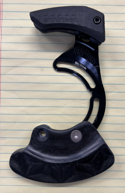

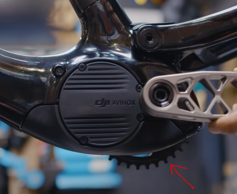

Hi Amflow Support. I should be getting my new Carbon Pro next week. And I have been buying lots of accessories to protect it.
One thing I have noticed, is that the chainring protrudes significantly below the motor bash guard. And is extremely vulnerable to bashing it when dropping off steep ledges. Damaging or bending teeth. See photo.
I also noticed that there does not appear to be any mountings for a chainring protector on the drive side. See photo.
Most frames where the chainring will be exposed, have 3 bolt holes to mount a chain-guide and chainring protector.
As the SRAM Transmission Chainrings are very expensive. Do you have any way to mount any sort of chainring protector, like the one in the next photo. This is for a Bosch motor.
Dear customer, our motor uses an ISIS crank interface, and both the Amflow PL and PL Pro have a chainline of 55mm. You can add a BCD104 bashguard, but we can't say which one will fit because it depends on how thick the bashguard is. Your local bike shop should be able to help with that.
We hope this info helps clear up any concerns.

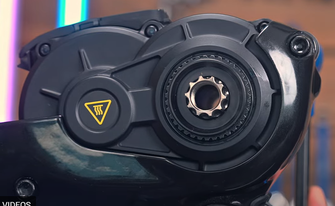

For the removal of the cranks, you may utilize an 8mm hex wrench to proceed. Please ensure that the outer bolt cap is not removed, as it must remain in place. Regarding the removal of the chainring, a spider tool is required. You are advised to contact our support email or reach out to a local authorized dealer for purchase.
Can you give any more info on the spider tool. The lock nut appears to be 51-52mm diameter, and the diameter at the lug notches is 47mm.
This seems to match the spider tool for the Bosch Active Performance Line.
Unfortunately, we can't share the precise specs of our spider tool. If a customer uses non-official tools to remove the motor and it results in damage, the warranty might not cover it. We hope you understand.
