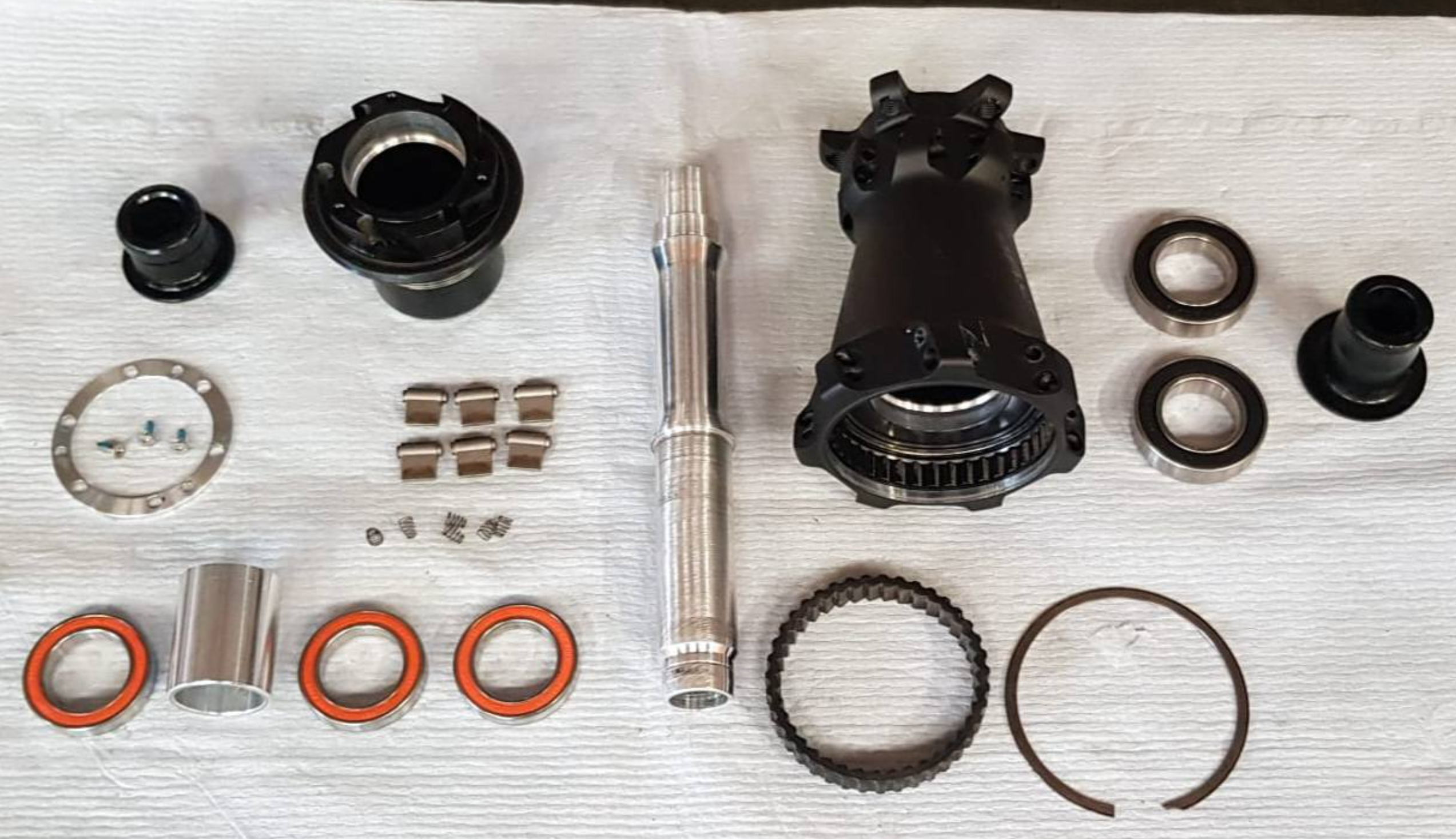

What bearings are used in the rear hub? 3x in freehub, 2x in hub. Carbon Pro model, carbon wheels.
Please label and dimensions. Not listed in the manual and I don't want to take it apart first before I change them. I assume it's probably some common Chinese production and not quality like e.g. Enduro or similar?
Because, which is really hard to understand, after about 350km the bearings in the rear hub are noticeably worn and not running smoothly... It's really totally unacceptable to have to change the bearings after 350km... Very disappointing...
Anyone with similar experience?
6903 x2 in the Hub shell & 6803 x3 in the freehub.

Sorry, you are really have no idea what bearings are in hub/freehub in rear wheel of YOUR bike? Hard to believe....
Okay, I'll tell you, fortunately the others have already found out.
There are 2 pcs of 6903 in the hub shell and 3pcs of 6803 in the freehub...

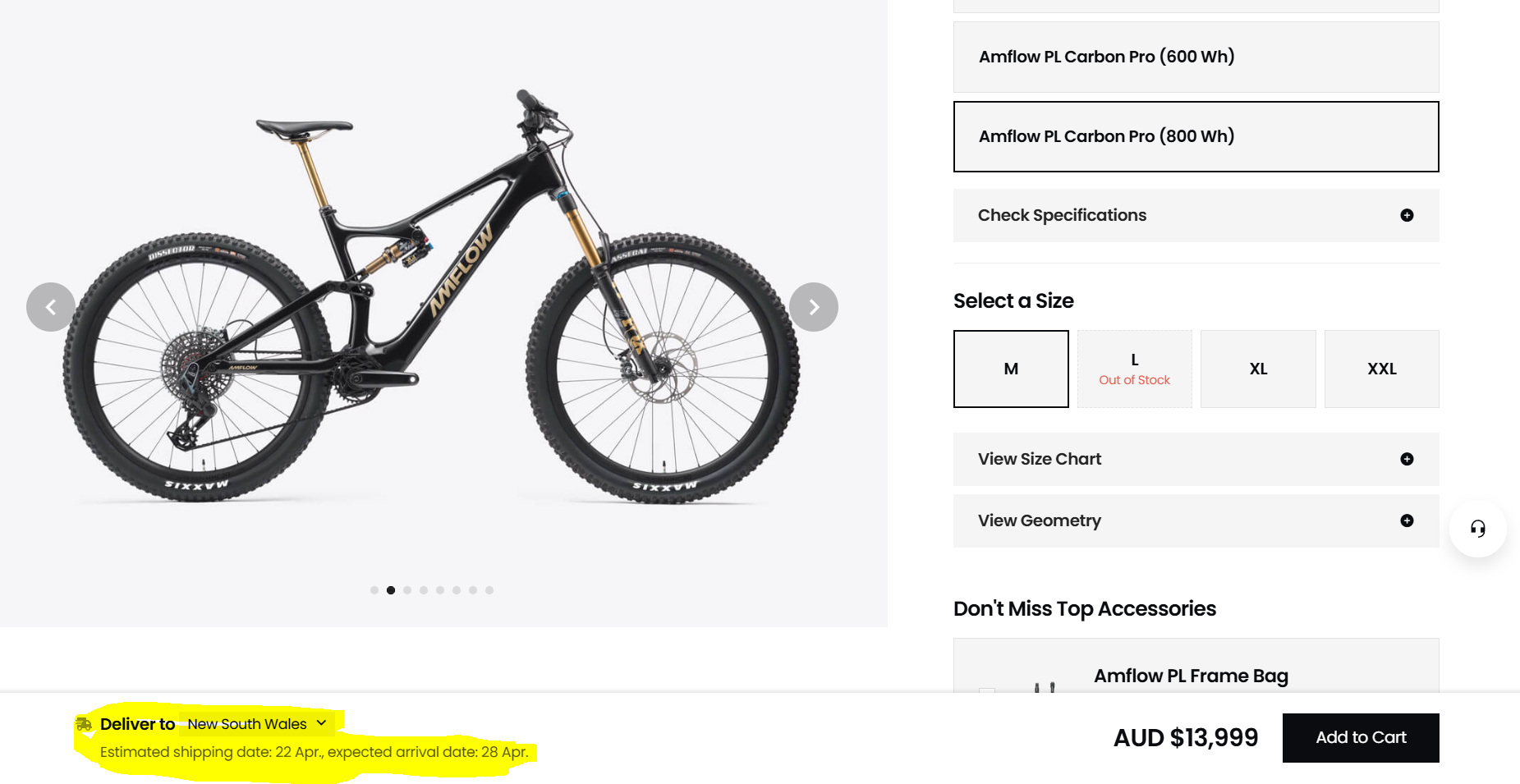

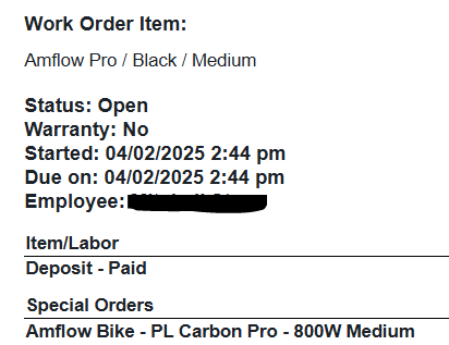

Hi @Amflow_Support
I paid a deposit and ordered my Amflow PL Carbon Pro over 6 weeks ago from my Local Amflow distributor in Sydney Australia. (Cyclery Studio)
I still cannot get a delivery date from the Store.
Is this normal ? Should I be concerned ?
@Amflow_Support:
We apologize for the delay in response. The latest confirmed information regarding the Amflow PL Carbon Pro is as follows:
The Front wheel uses bearings with an inner diameter of 18mm, an outer diameter of 30mm, and a width of 7mm, totaling 2 pieces of SB-18307 bearings.
The FREE HUB of the rear wheel uses bearings with an inner diameter of 17mm, an outer diameter of 26mm, and a width of 5mm, totaling 3 pieces of SB-6803 bearings.
For the HUB SHELL on the rear wheel, it requires bearings with an inner diameter of 17mm, an outer diameter of 30mm, and a width of 7mm, using 2 pieces of SB-6903 bearings.
Furthermore, both the inner and outer rings of the bearings are made of bearing steel.

Hi @Amflow_Support
Amflow Customer Support have got back to me and told me that the bike will not be delivered until early May. How is that possible, when I ordered the bike 6 weeks ago, and if I order one today from your website, the site says it will be delivered on the 28th of April ?
I am extremely disappointed with your ordering process, when I was told it should be 6-8 weeks delivery.
It gives me very little confidence if there are issues in the future, when this is the service delivered, once you took my deposit.
Below is the order form from your website right now, showing an April 28th delivery.
