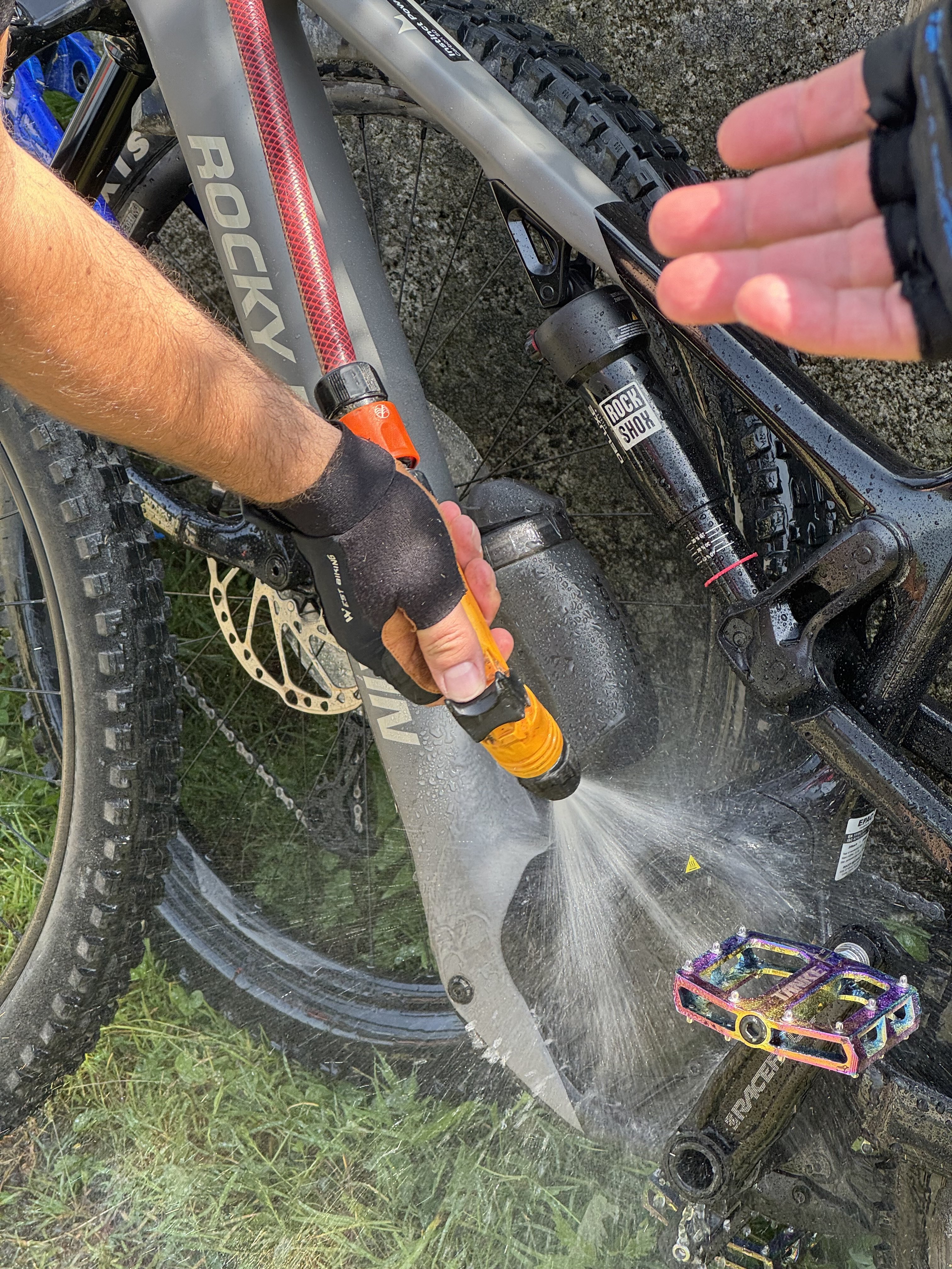

Hey everyone! My new Amflow PL Carbon 800W (size L) is arriving soon from China. Local forums keep mentioning that it's crucial to perform initial suspension service on both shocks right away. Apparently, Fox 2026 model dampers may contain metal debris from manufacturing. Anyone else dealt with this?
