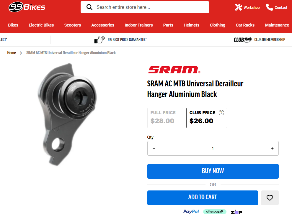

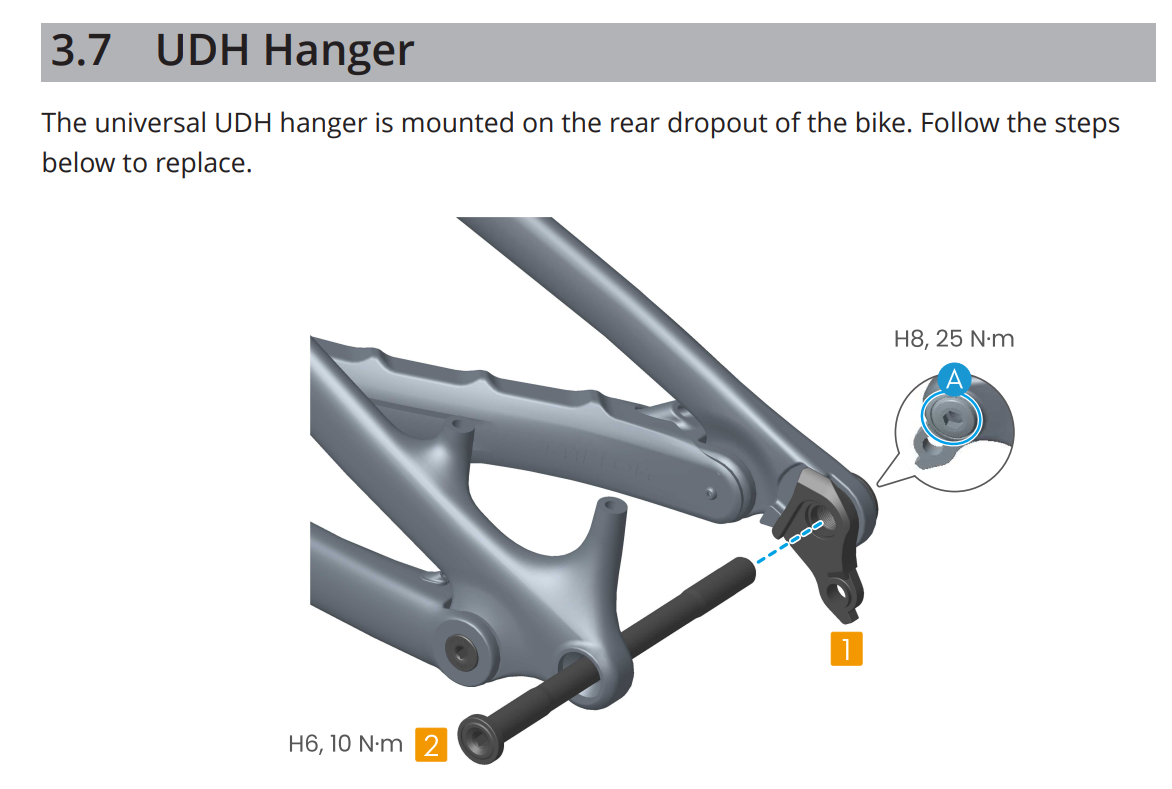

Where to buy replacement derailleur hanger for the GX on the PL 800? I couldn’t see one on the Amflow website.
I'm pretty sure it's just a SRAM UDH. Most LBS sell them. Just take it up and check.
Thank you for your inquiry! Since this part is manufactured by SRAM, Amflow does not sell it directly. May we ask what issue you are experiencing? If possible, please share some photos of the issue and we’ll check that and assist you further.

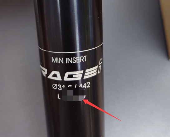

My mates Amflow dropper has broken, its slides up without pressing the leaver and its goes down when sat on it. We have removed the post from the bike and it starts extending very slowly without even touching it.
About the dropper post automatically rising, could you provide us with the bike SN and the dropper post SN (as shown in attached image)
We will report your case first so that you can reach out to your bike shop or the manufacturer of the dropper seatpost for warranty support.
hi. The bike was purchased direct from you guys. What would the plan of action be? I’m awaiting his info so I can pass it on to you.
