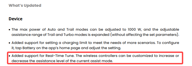

Hi @Amflow_Support. I have installed the latest update but cannot seem to get the micro tune feature to work properly (I have assigned the controls already). Is there any steps I can follow to get this working please?
Hi there, may I confirm if you refer to this function?
Hi, yes this is indeed the function I am referring to.
Thank you for your confirmation.
Regarding this function, currently, adjusting the assistance level directly through the controllers may not display the changes on the display, but you should be able to feel the difference during actual riding. We will continue to optimize this feature in future updates—thank you for your valuable feedback.
If you would like to check the specific adjustments, please refer to the Custom Assist Modes in the display or in the app.

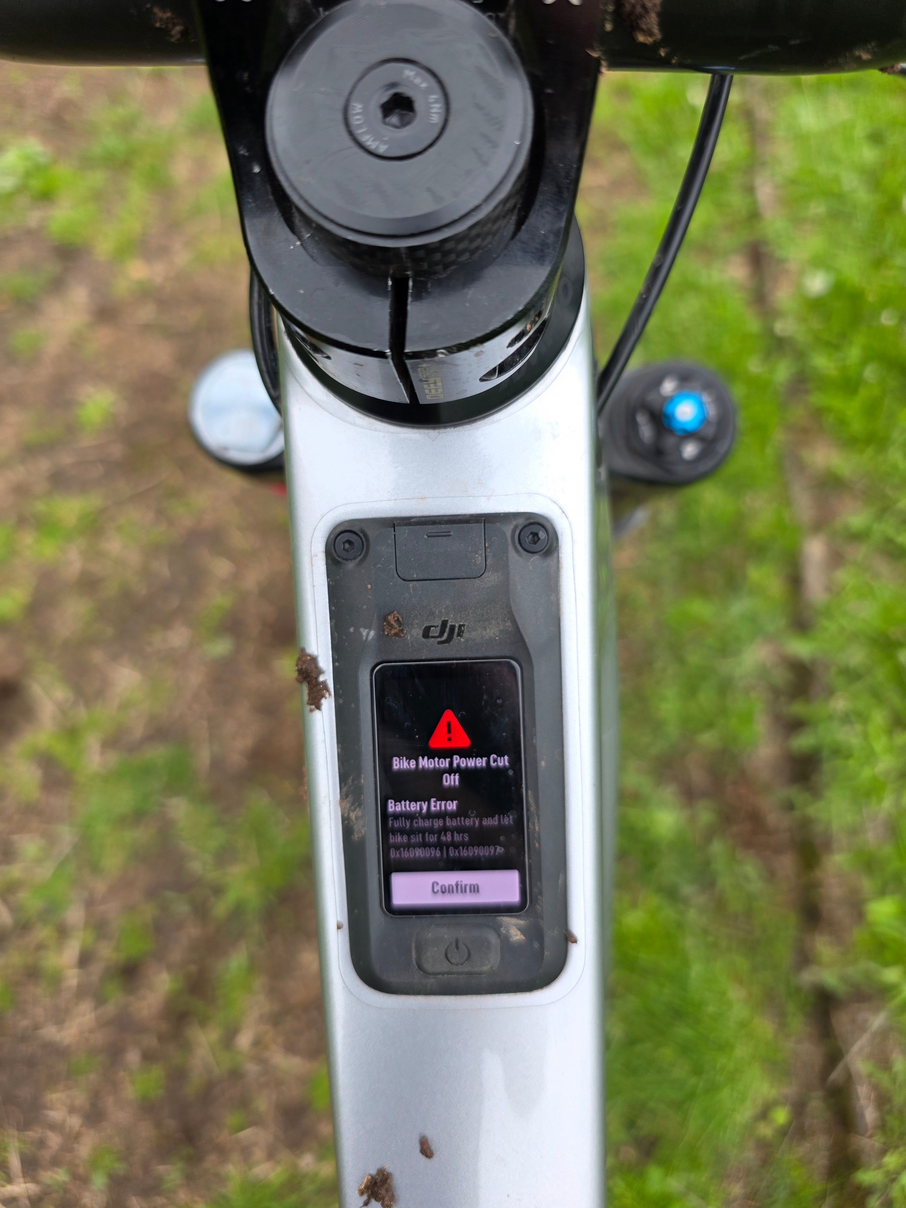

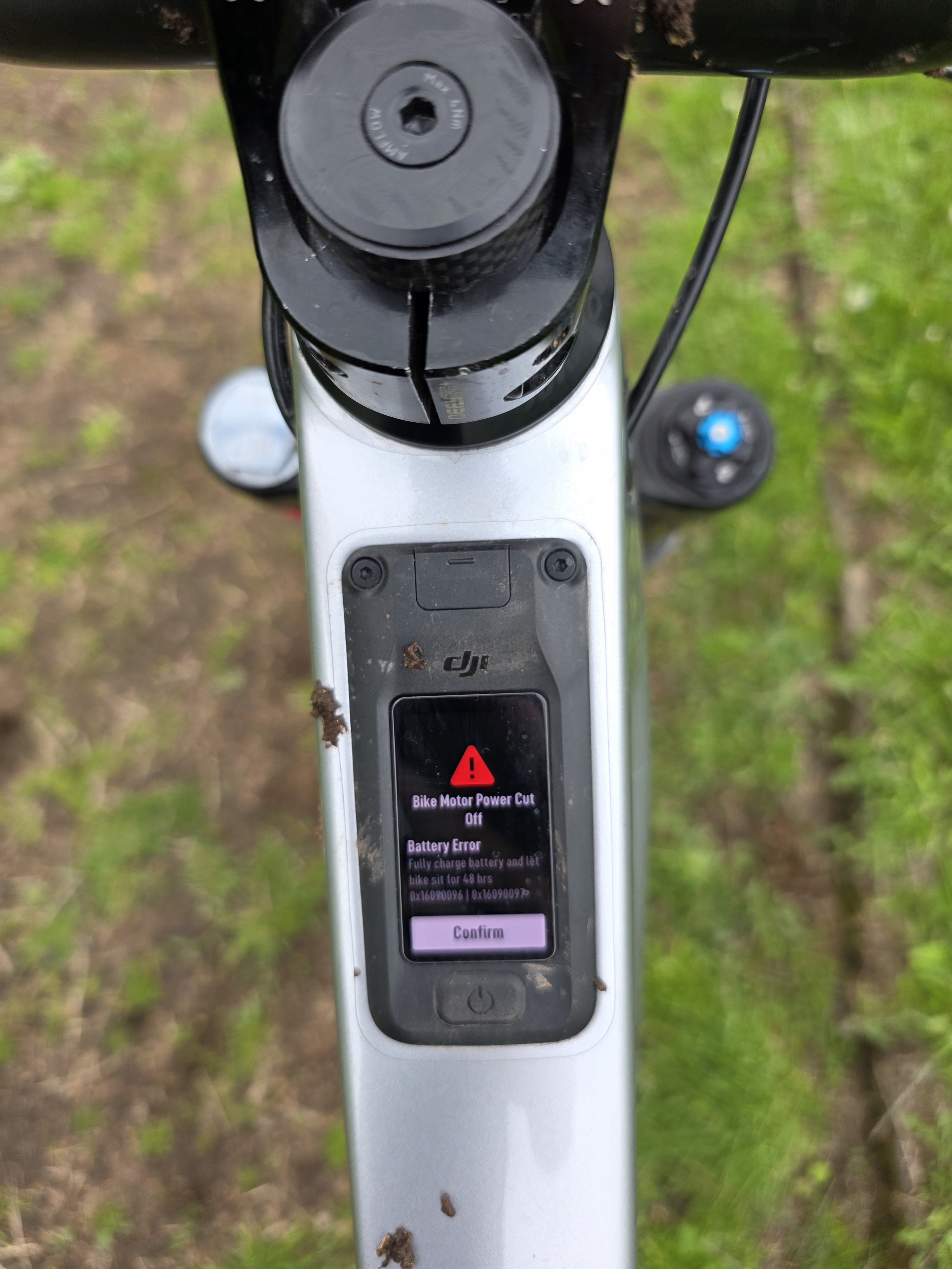

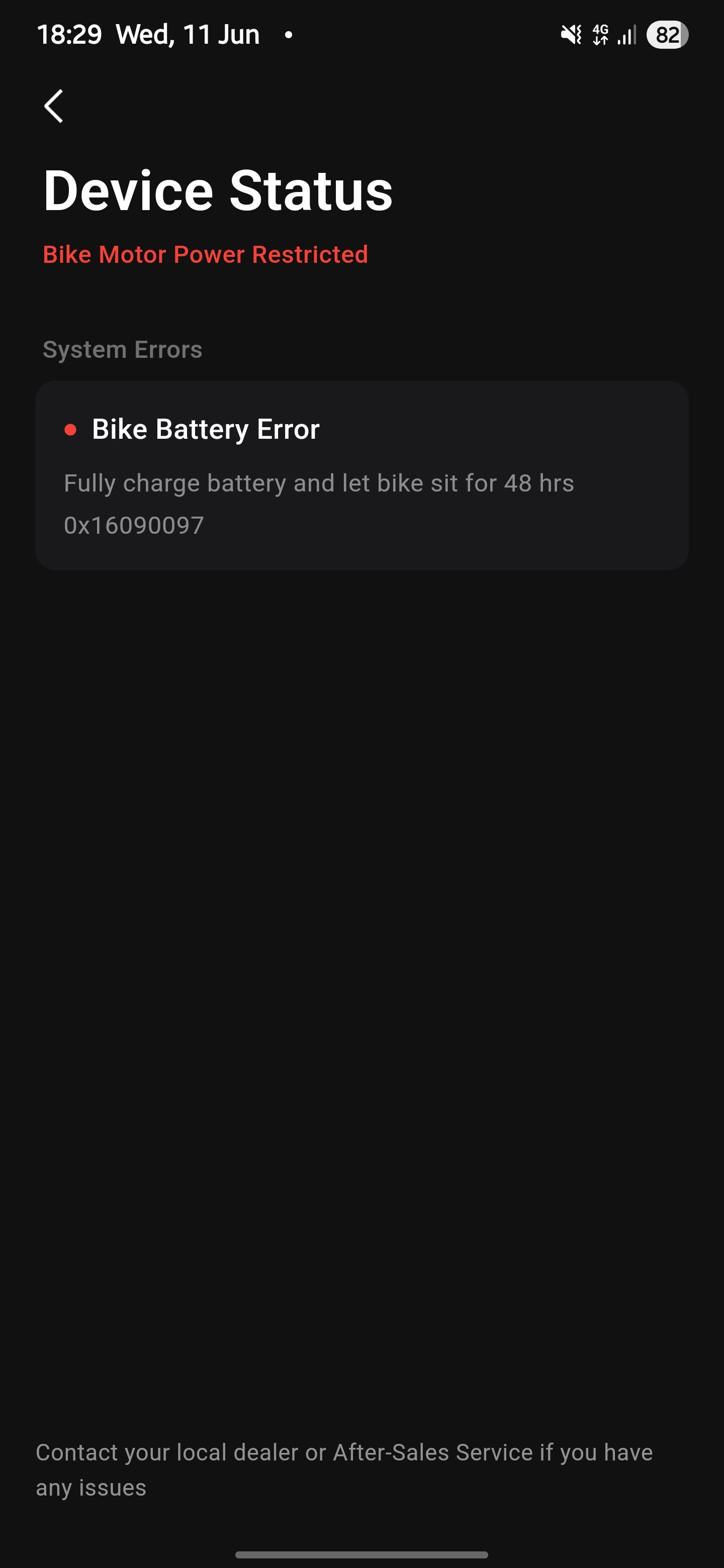

So I got this battery error today during a ride. Battery at approx 50% at this time
0x16090096 / 0x16090097
Motor power restricted
Please fully charge battery and let sit for 48hrs
The bike could still be ridden with decent assistance back to the car
I restarted the bike. Same. Opened the app and could see the same error, would not reset
I took the bike home and by this time (approx 45mins), when powering the bike on the error was gone. I haven't had a chance to ride the bike since, instead choosing to charge it to 100%
Is this the start of more serious or continued issues? Any advise? I know it says let bike sit for 48hrs but my next planned ride may be inside that 48hrs

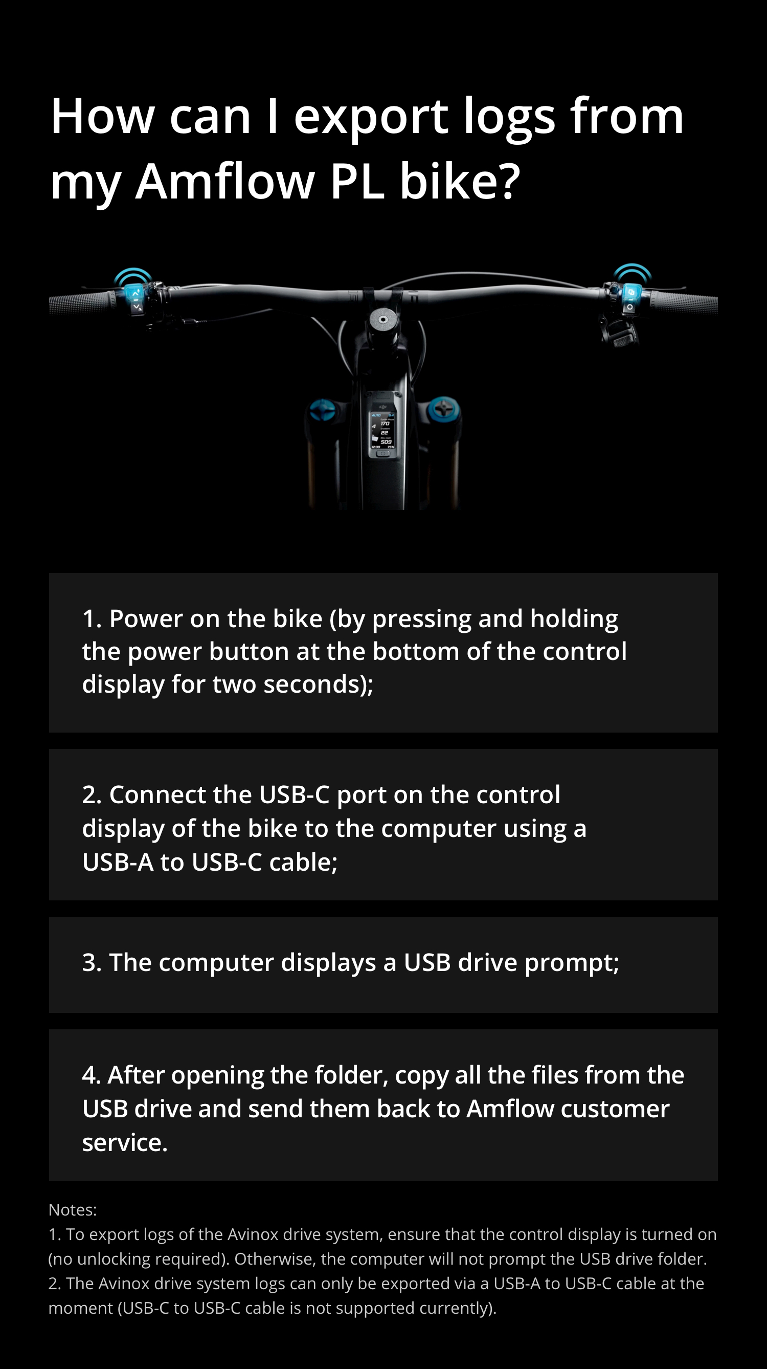

we sincerely apologize for the inconvenience you have experienced. Could you please provide the logs from your bike by sending them to [email protected]? This will help us assist you further in troubleshooting the issue.
For instructions on how to export the bike logs, you can refer to the image below:
We appreciate your understanding and cooperation, and we are here to help!
For instructions on how to export the bike logs, you can refer to the image below:View attachment 162369We appreciate your understanding and cooperation, and we are here to help!
Thank you. Logs sent today
