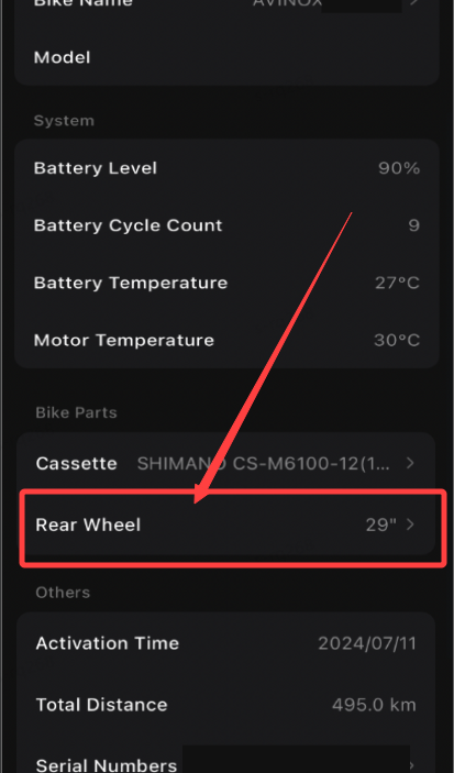

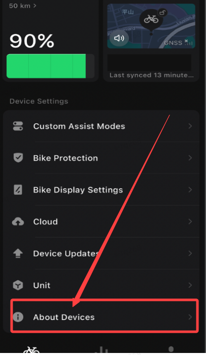

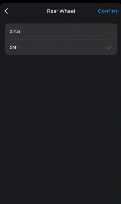

Anyone know how to change the wheelsize setting (from 29" to 27.5") on the bicycle screen?
Hi there. At the moment, it’s not possible to change the wheel size setting directly from the bike’s display. You’ll need to adjust this in the AvinoxRide app. The specific steps for setting the wheel size are as follows:

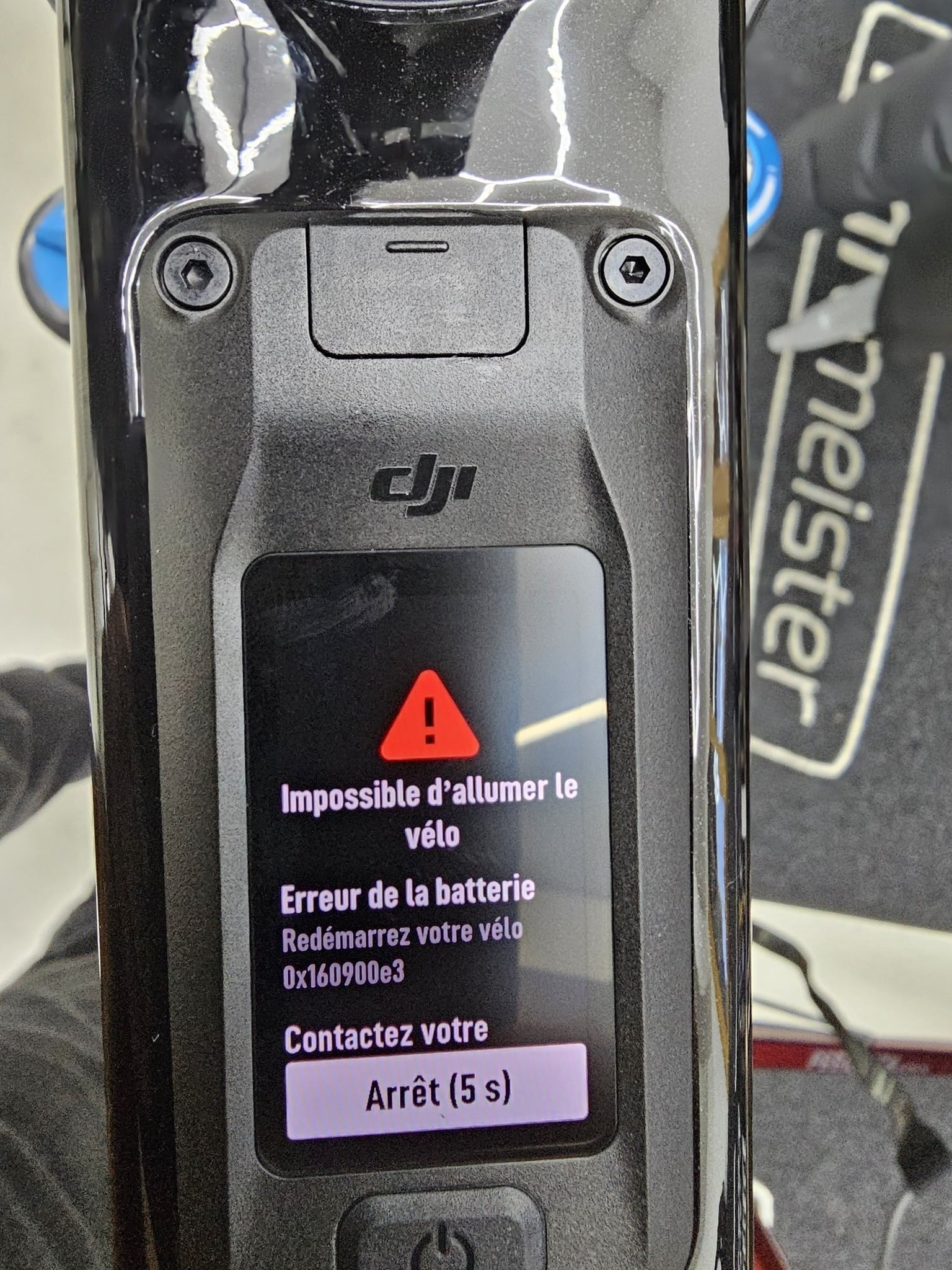

Hello, I just bought an Amflow PL Carbon Pro and I haven't even been able to ride it for a single kilometer. The salesperson tested it in the store to make sure everything was working properly, but once I got home, I couldn't turn it on… The only thing I can do is press the power button for at least 10-15 seconds; the screen lights up and then immediately goes off. When I plug in the charging cable, this is what appears on the screen...
Thank you for your help
Check your battery connection as the first thing to make sure there are no loose wires.
After that, take your bike to the shop as it should be their issue to resolve under warranty.
Hi there, we are truly sorry to hear about your issue. The error code you’re seeing indicates there is a problem with the battery. We recommend visiting the dealer where you purchased the bike for warranty service or after-sales support. If you need further assistance, please send an email to our official support address at [email protected], and we will do our best to help resolve the issue.
