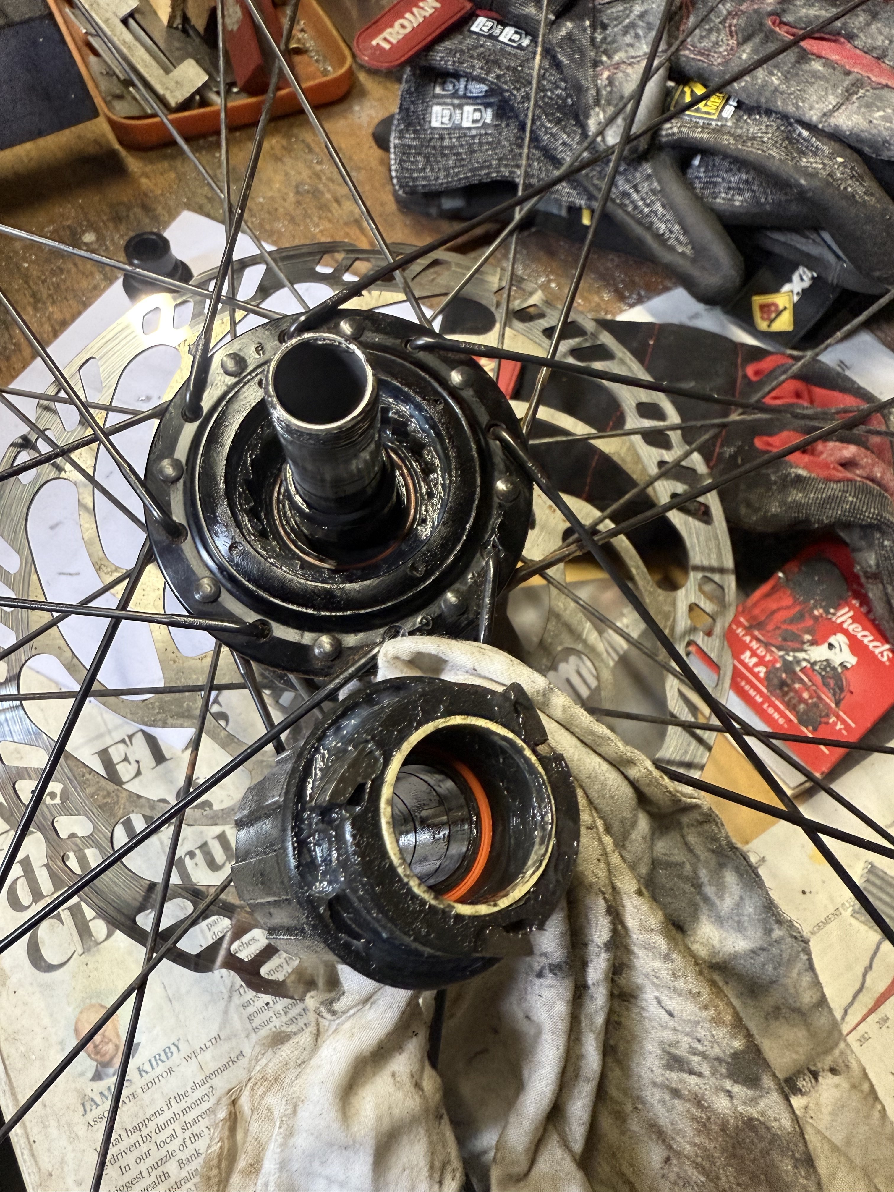

Servicing the freehub on an HMA - how does this end cap come off. It says ‘loosen’ (reverse thread) and has flats to do so but there are no flats on the opposite end cap? What and how should i grip to do so?

Well, that doesn’t work because the freehub just… freewheels. 😂
But, given amflow support is lying flat on me here I have pressed on.

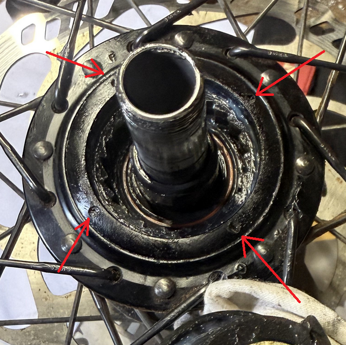

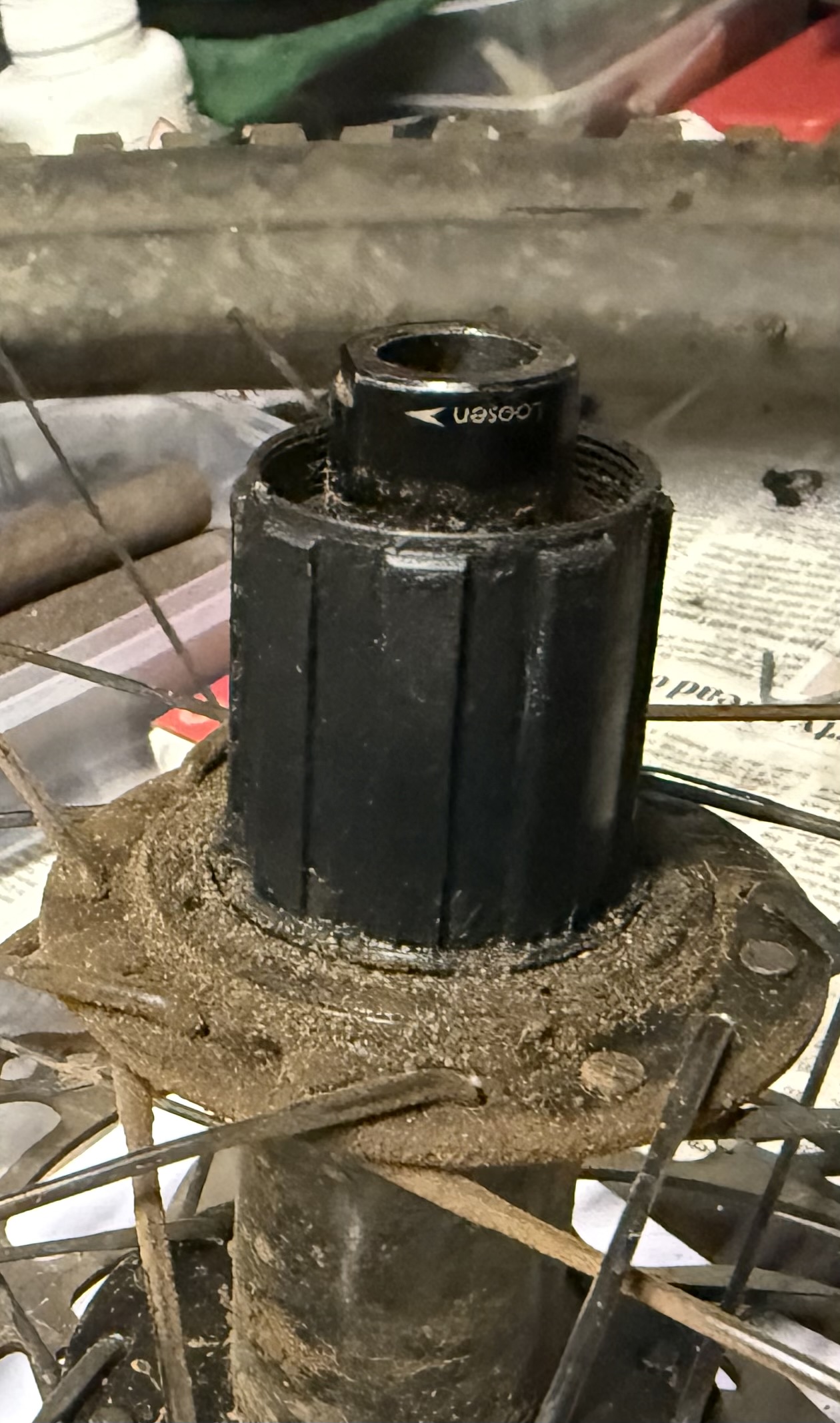

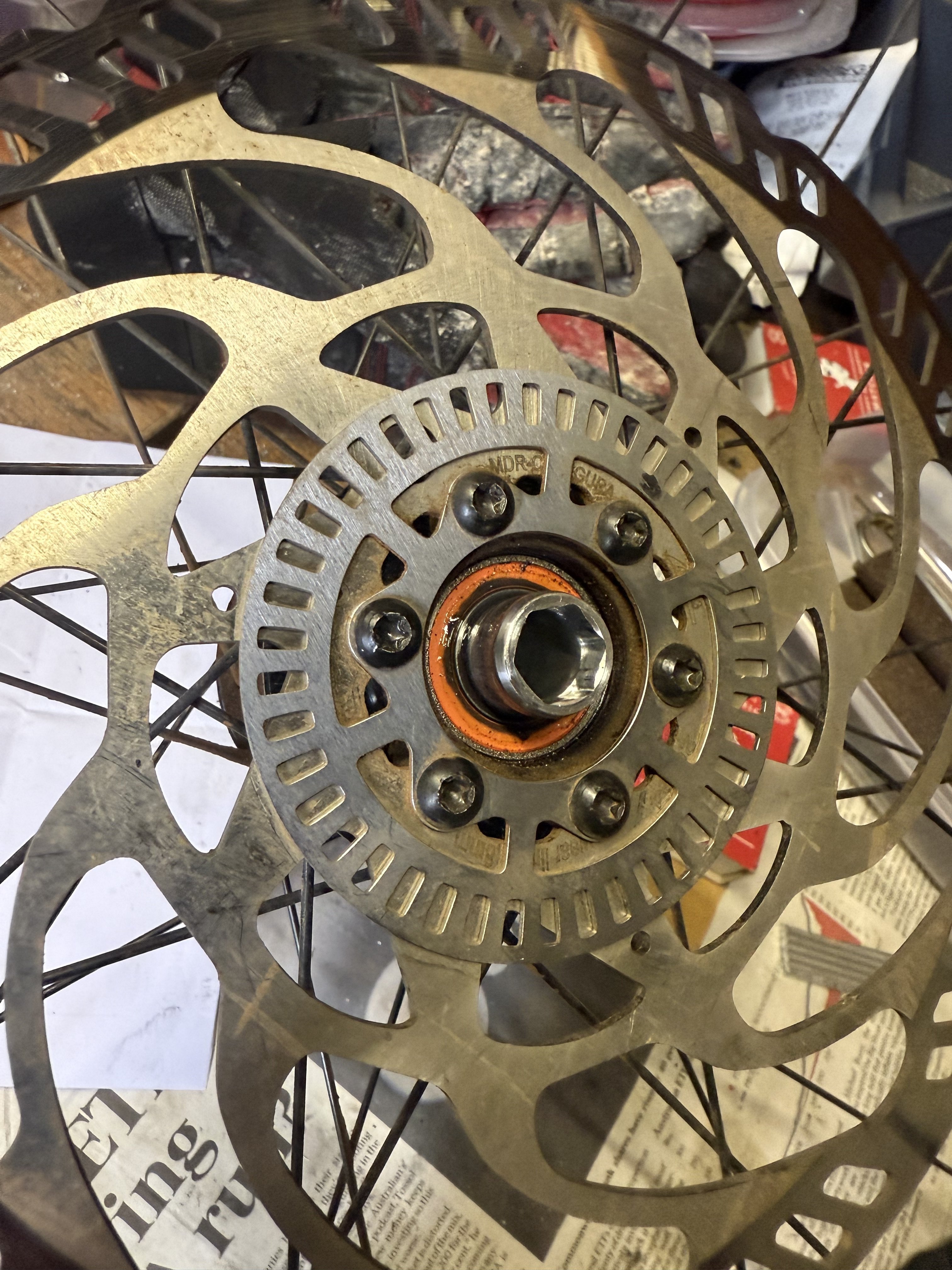

Taking the opposite end cap off reveals a 12mm allen key. That allows the end cap on the freehub to be loosened.

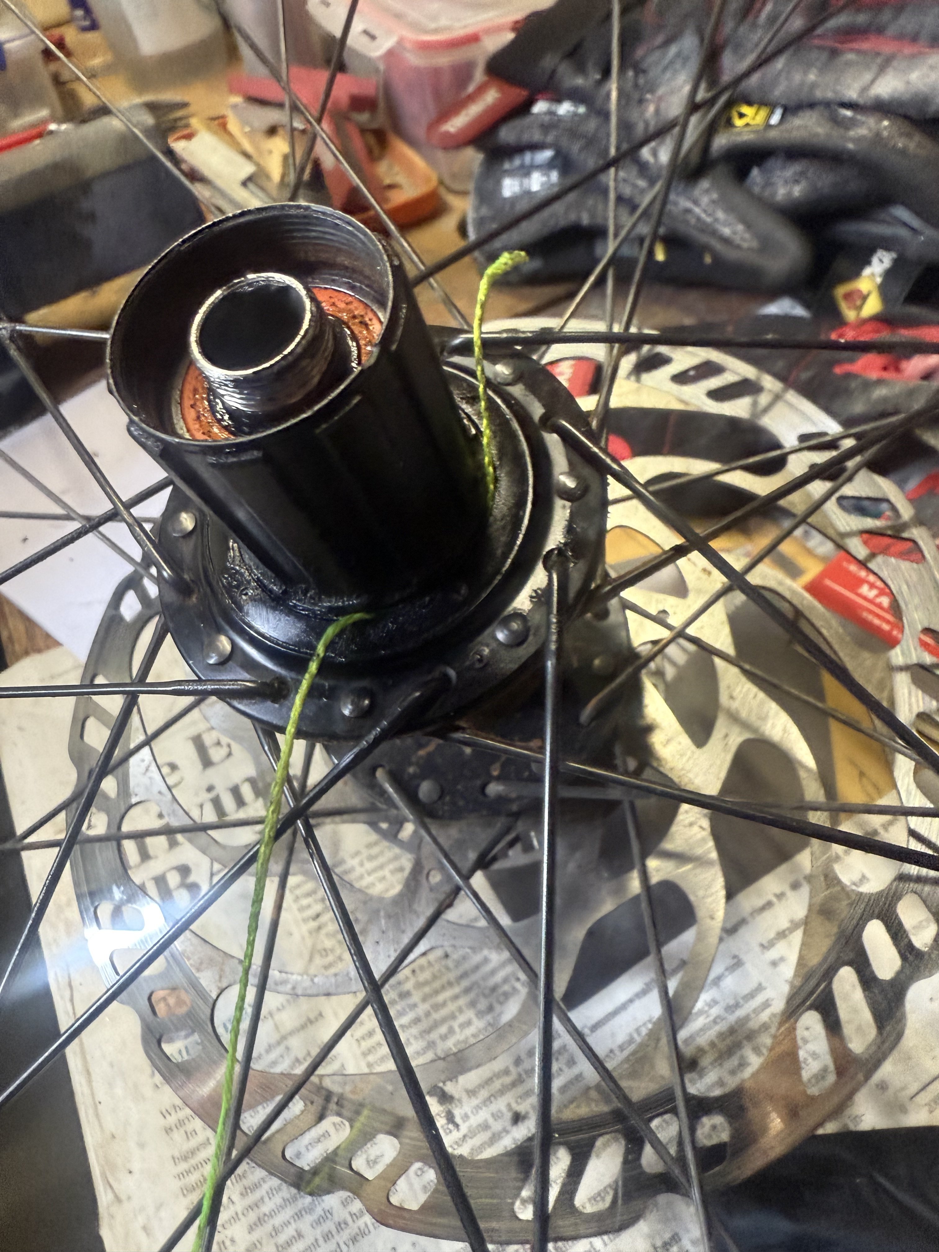

Now the freehub is off and greased, the next problem is getting the freehub back on, as the pawls are an interference fit with their housing…. somehow need to hold all three pawls closed at the same time to slide it back in.
I’m starting to get really frustrated by all this. I hope i get it sorted in time for my ride on Friday! 🥵
You will have to unscrew this ring with 4 holes first, these holes are for putting in a pin spanner wrench or you can also do it with more common retaining ring pliers. This ring has integrated rubber lip seal which protects the internals. After you put in the freehub driver you put over this ring and screw it back in (keep an eye on not damaging lip seal), but make sure you put few very small drops of thread locker on this ring thread (clean everything first), you don't wanna this ring unscrew itself because it will lock-up your freehub and will rotate the front chainring/motor when you stop pedalling, happened to me a few times before I used the tread locker ... I then replaced this hub for DT Swiss 350 Hybrid hub with a ratchet and never looked back, so more simple and reliable ...
Brilliant - good to know - thanks!
I just did a work around with some builder’s line wrapped to hold the pawls closed as I slid it in. Then snaggled it out at the last…. All good. 👍
