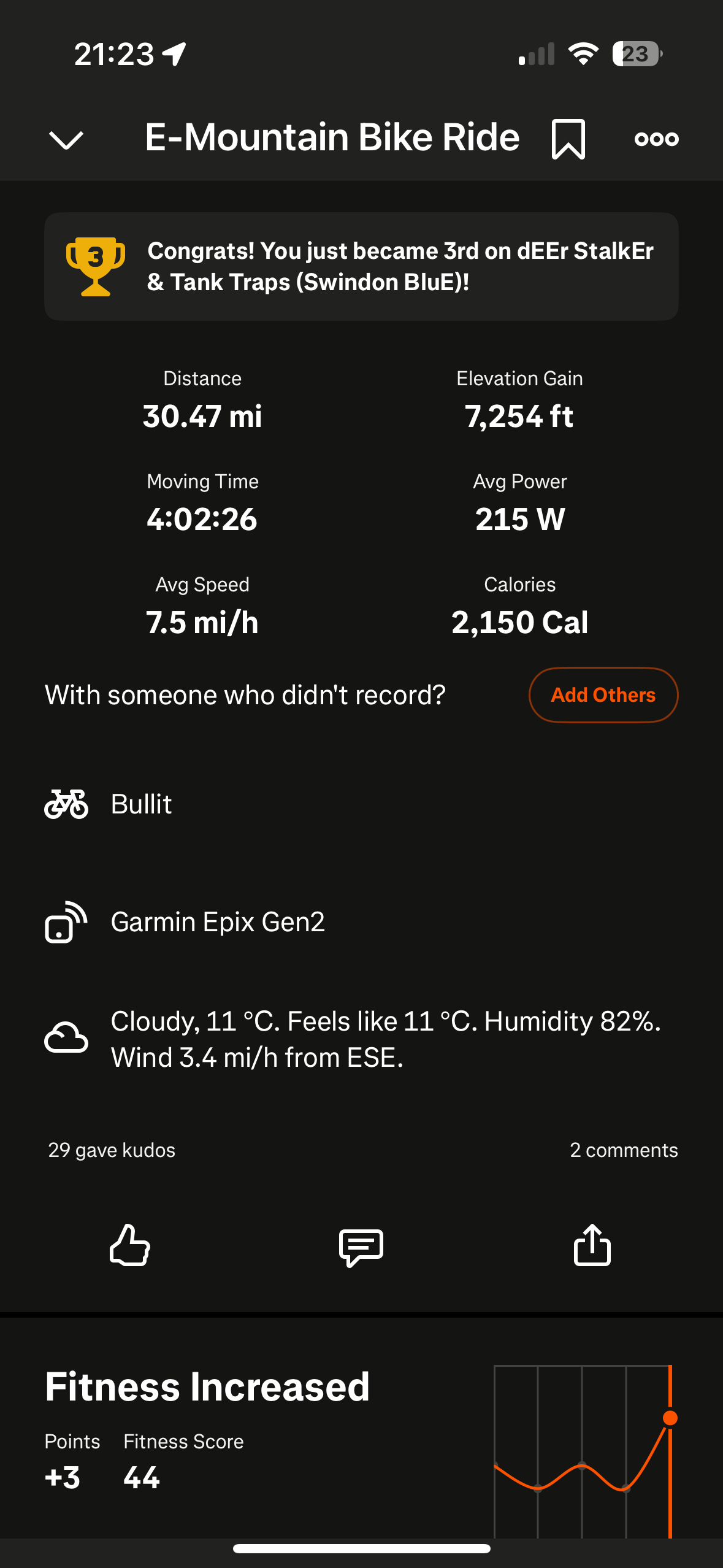

First ride on the Bullit today, was hoping for decent range using just the 600kwh battery.
Managed just shy of 1800m over 25 miles using a good spread of power modes, plenty of emtb
I’m super pleased with this, was a mild day in UK so expect a drop off come winter however no complaints given the Bullit is a FF 170 monster truck
Handles well too, think this was the correct choice over the Vala
That's a LOT of range on a 600w.
I wonder if anyone has ever noted how efficient the Bosch motors are compared to some of the other options...
He must be light or really fit, otherwise it's a bit difficult to reach those numbers on the 600wh. Tour+ & Emtb can give somewhere around 1500m of vert. Anything above that is either low mass or serious man power
The Bullit is my first ebike and I ride plenty of good old fashioned pedal power and yes generally fit @ c72kgs
I like to have a work out so pedal the fire roads up to the trail head in Tour + trying to maintain a high cadence
The climbs are not tech but a fairly long creep uphill (Surrey hills)
Best I’ve managed c2.2k metres vert with the range extender with just under 10% left
So pleased with it - hope it holds together, all the ebike stories I’ve heard previously did worry me I must say!
I can relate to that, I'm 81-82 naked and 84-85 geared up so I could reach 2000 vert with the 800wh battery and still have some spare change but but much . As current offerings in full powers motors , Bosch is clearly the most efficient. I think the new TQ is going strong as well but would be interesting if you set the power on some modes to match it from a Gen5 with the 600wh battery if it would surpass it
