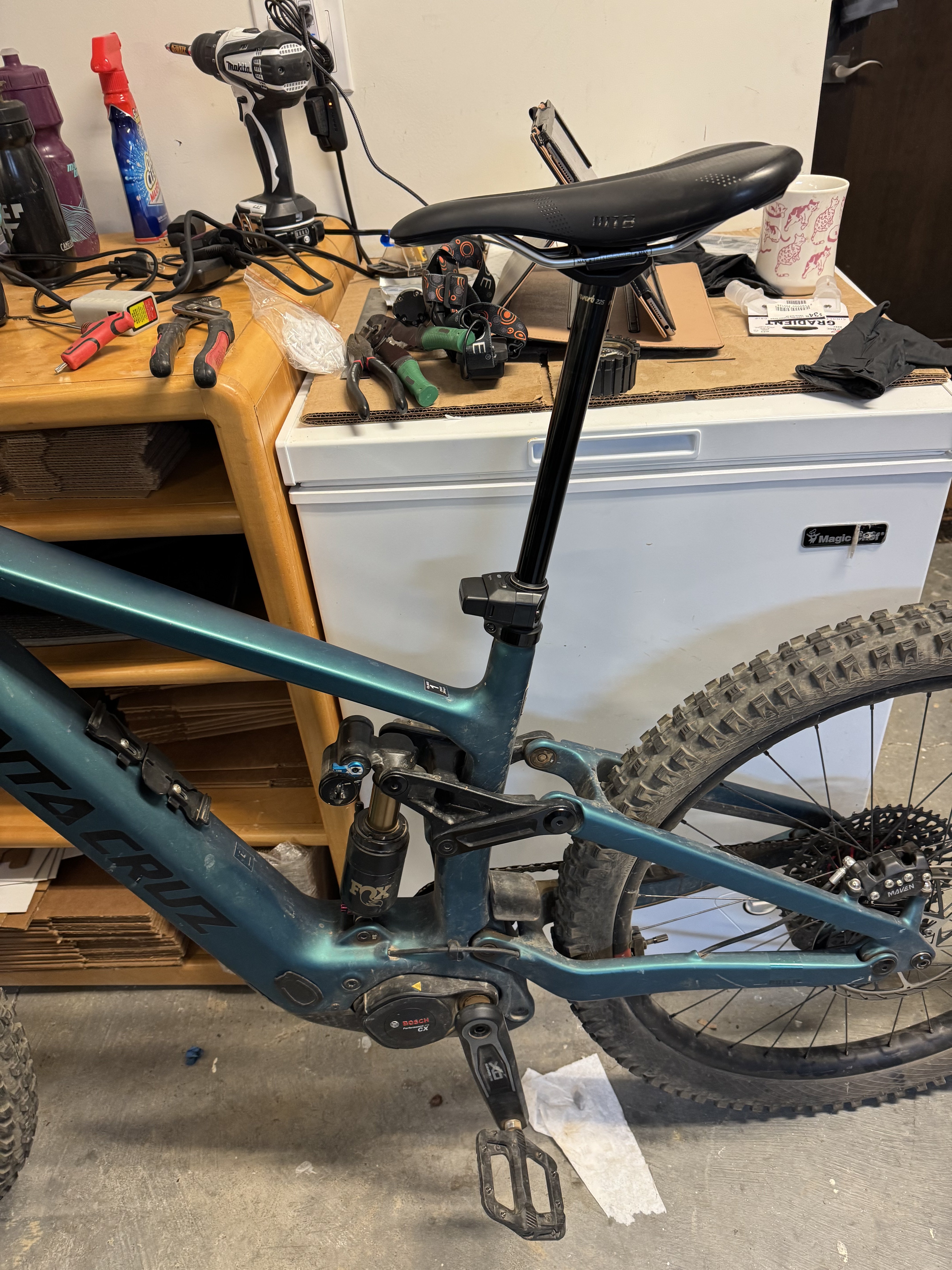

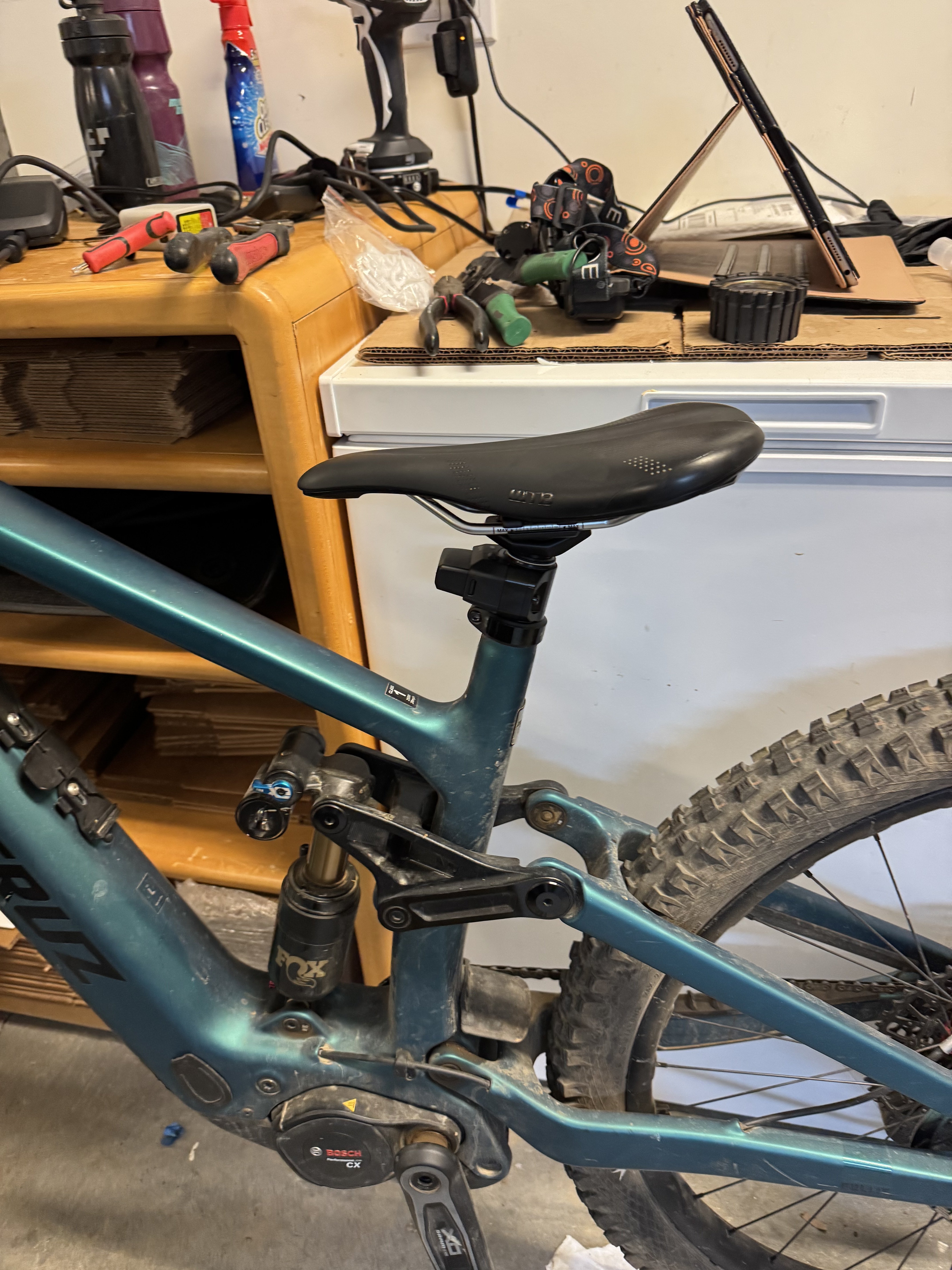

Anyone replaced their 210mm dropper on large Bullit frame with a new AXS dropper? What size did you pick to account for the battery collar? Pictures would be great to see how it looks?
225mm on size L. Slammed

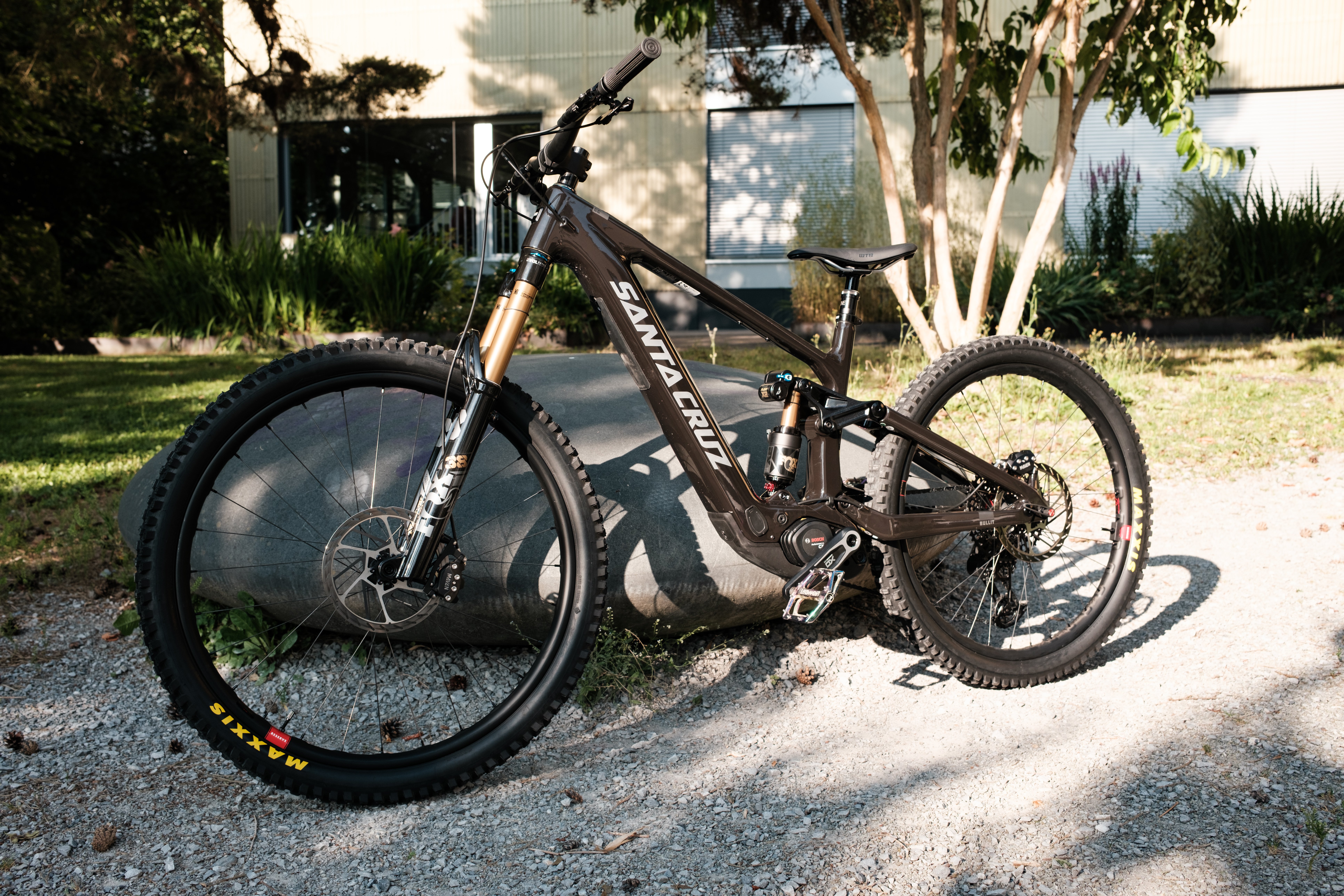

Ive been trying to determine if the black gloss bullitt has silver or white lettering. Anybody know?
the decals are silver - inbetween like a brushed aluminium / chrome shade.
and yes - when the sun hits it there is definitely a dark brown / dark purple tint to it, a bit like black biro ink or liquorice
on an overcast day it looks gloss black

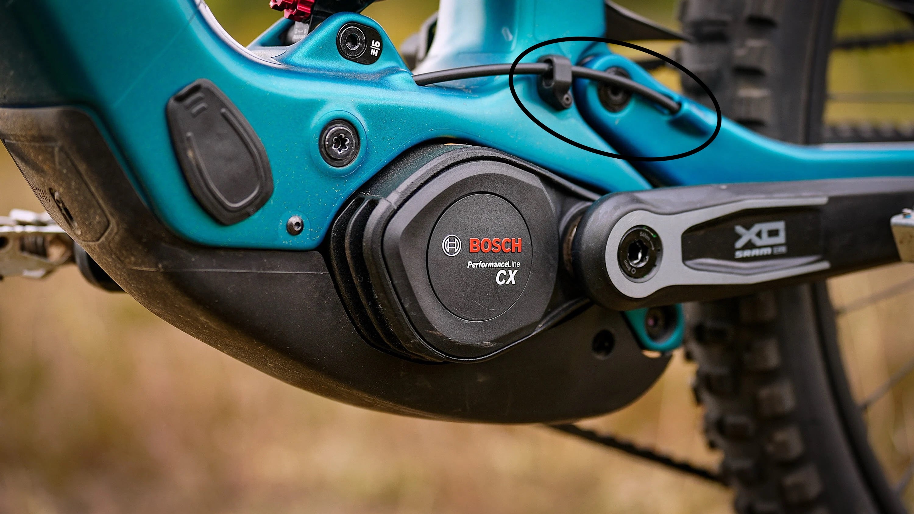

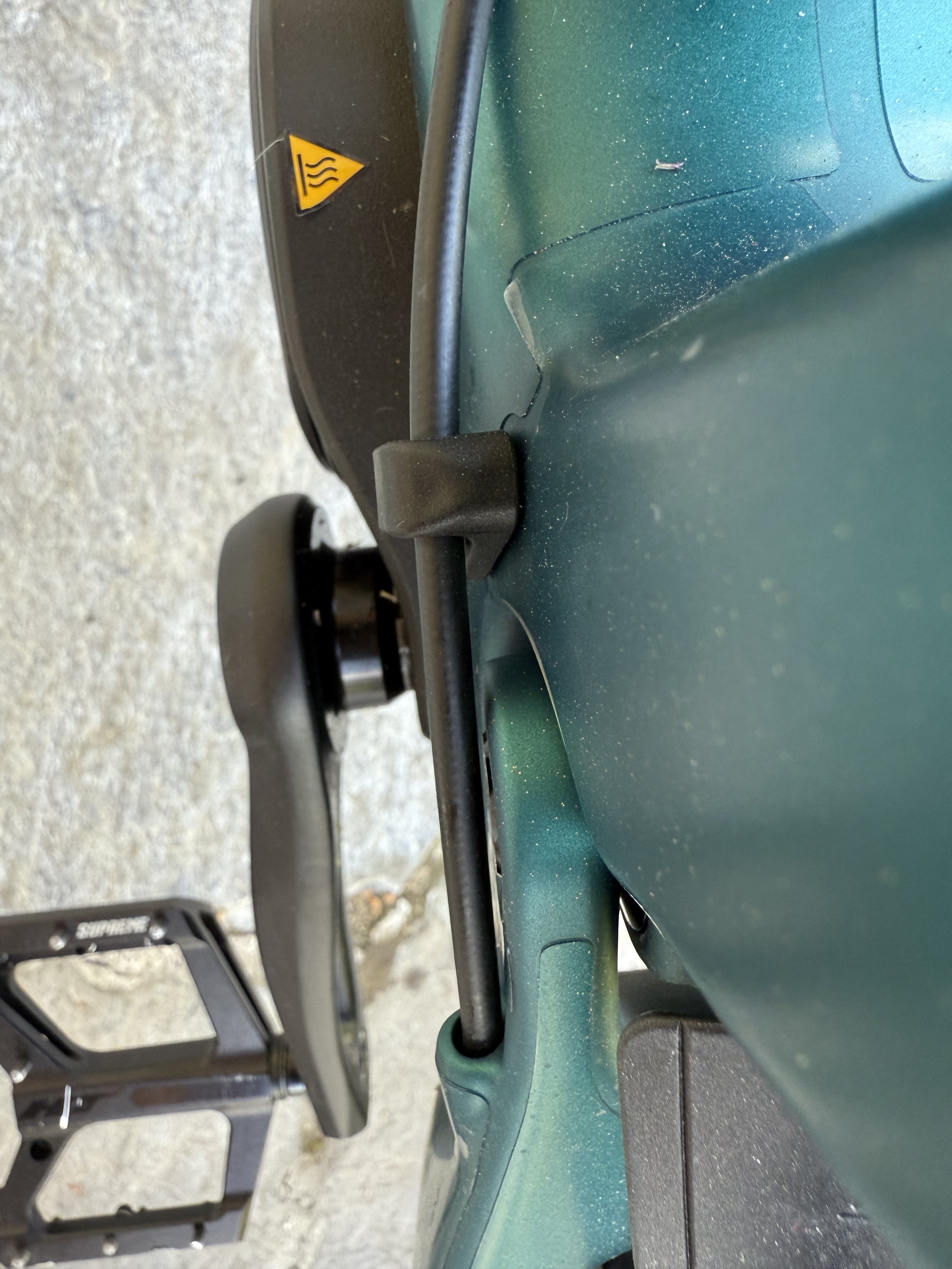

Am I the only one that thinks this might be a deal breaker?
I could get over the looks of it, but I feel like this will certainly rub through the paint in the circled area eventually? I'm a big Santa Cruz fan, butI'm still torn between this and the Orbea Wild. Stoked both have the fixed 600wh battery; it's the best solution out there for full powered emtb's at the moment IMO.

It could end up wearing through the carbon after the paint though
Am I the only one that thinks this might be a deal breaker?View attachment 162207I could get over the looks of it, but I feel like this will certainly rub through the paint in the circled area eventually? I'm a big Santa Cruz fan, butI'm still torn between this and the Orbea Wild. Stoked both have the fixed 600wh battery; it's the best solution out there for full powered emtb's at the moment IMO.
You're the only one. The cable has a guide and does not rub on any carbon parts. If you're looking for a reason to not buy one, you can just, not buy one.
No reason for the sass. I’m looking at everything as I’m torn between the Bullit and the Wild like I said in my comment. When you’re spending 10K+ this isn’t a ridiculous question IMO.
Here is a picture from above:
It doesn’t look like it rubs against the frame. But it’s close for sure.
I use a ride wrap and this specific area is covered, at least partially.
Hope it helps!

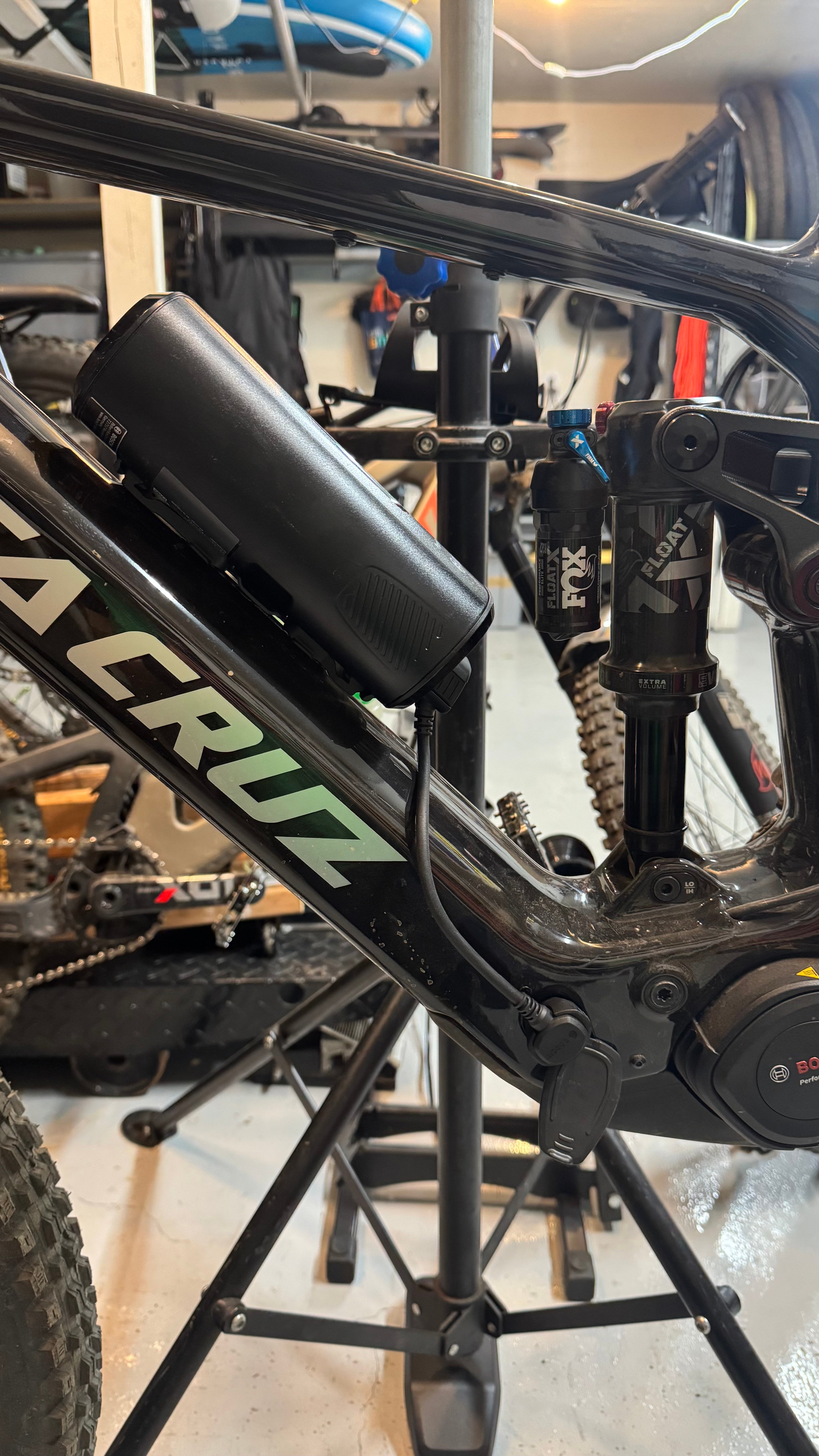

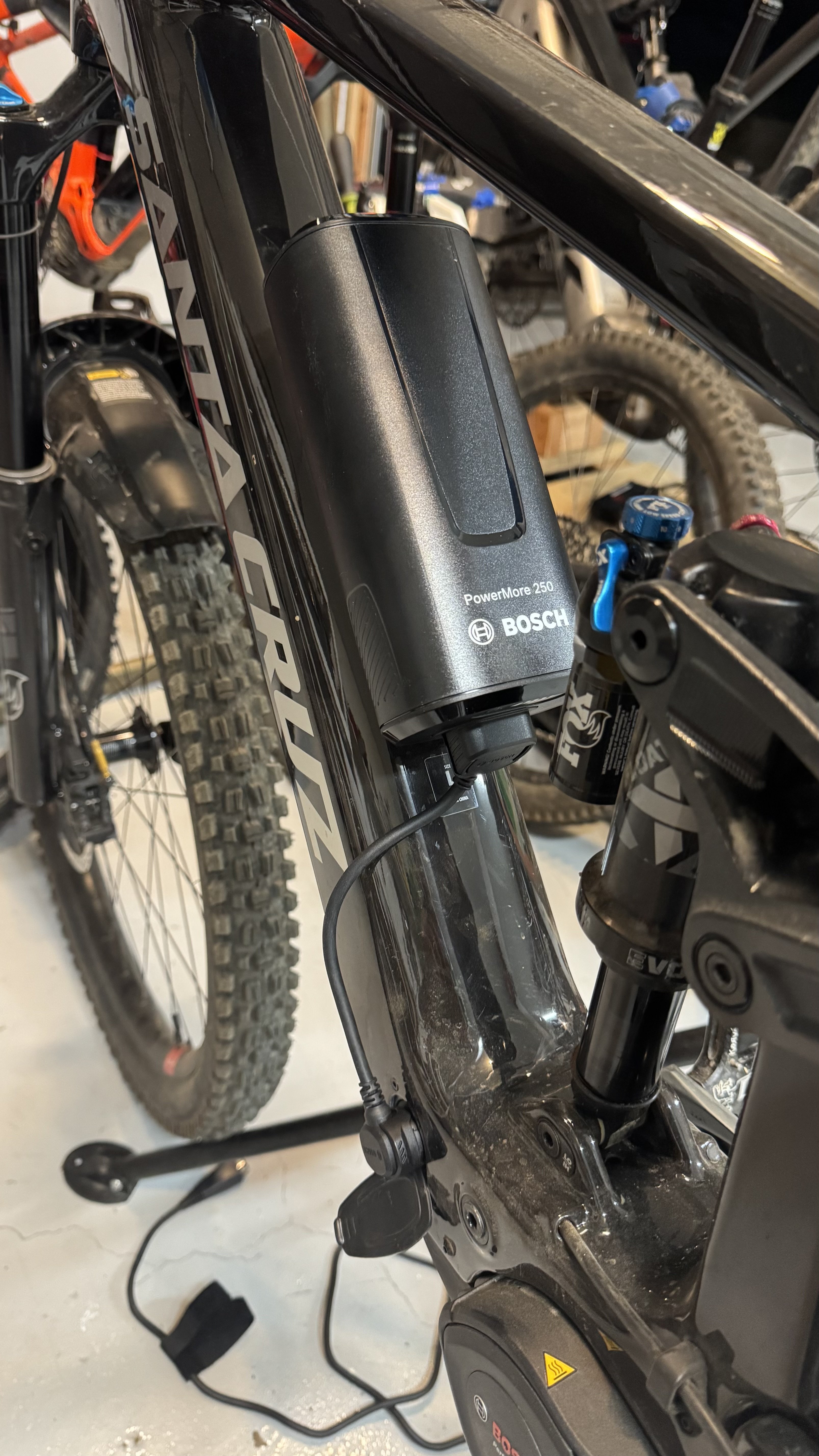

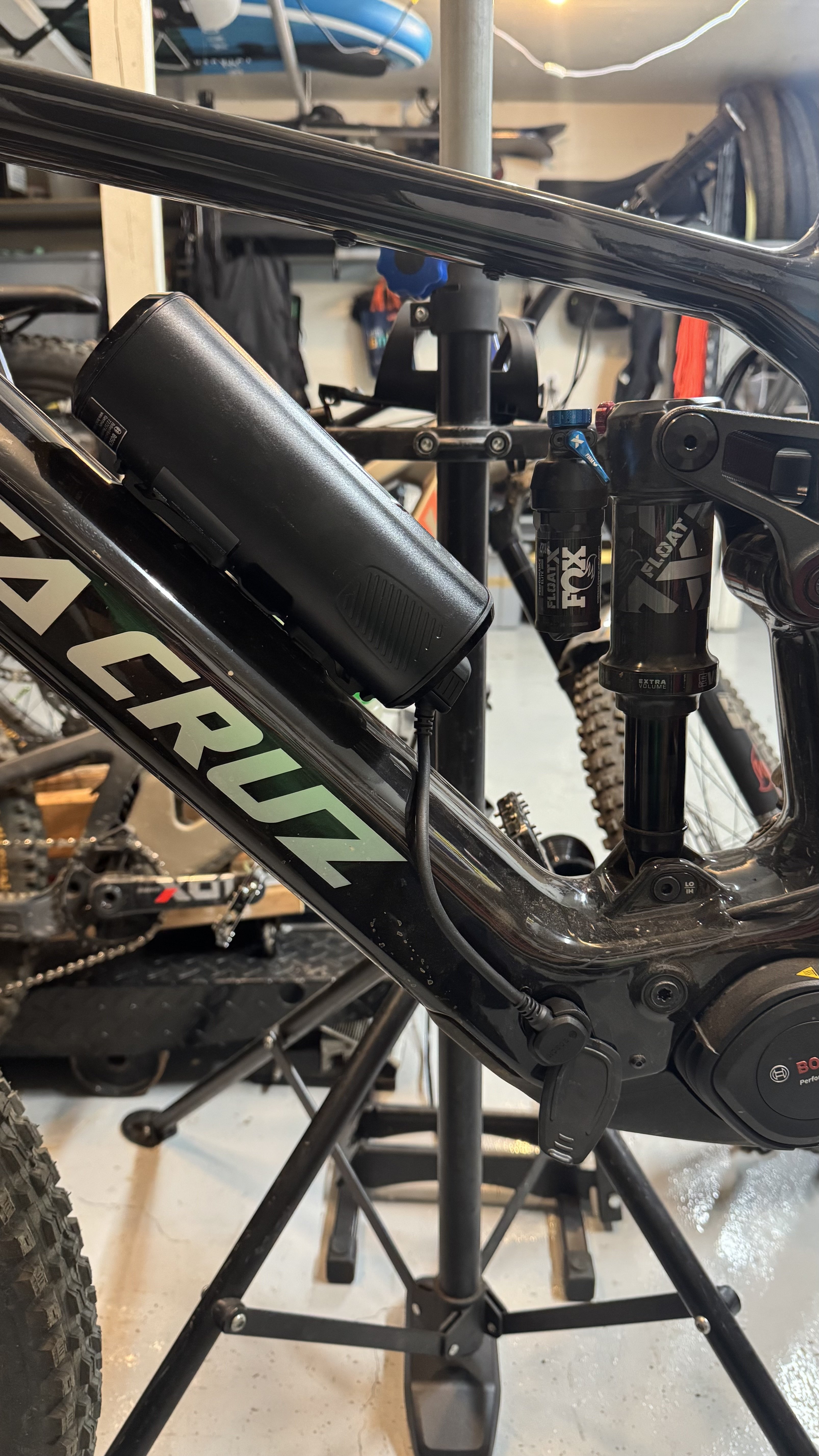

What range extender cord length are people using? The FAQ on SC website says 150-250mm. I ordered a 150mm but am wondering if it's too short.
I just measured mine: it’s about 200 (not sure where they measure exactly but it’s between 200 and 210). And it’s definitely the shortest you can use (we tried a few in store). It’s tight but it works well. Not had any issues so far. I don’t believe 150 will fit.
Also: you do need to make sure the extender is positioned in the higher position. The bottom one doesn’t work. It will rub against the shock.
Thanks! I wasn't aware 200mm was an option.
It’s too short unless you put the range extender in the wrong holes. Not a good idea. I tried it and eventually had contact. Luckily no major damage. Have 250 now
The 150mm came in and I think it turned out perfect. Battery holder is in most top position.

Hmmmm weird! Your frame is large? With mine the cable barely made it and had to stretch a bit to connect. Ive heard the same from other people. Maybe they started making them slightly longer now?
Yes large. It's in lo progressive setting but shouldn't make that much of a difference to matter.
