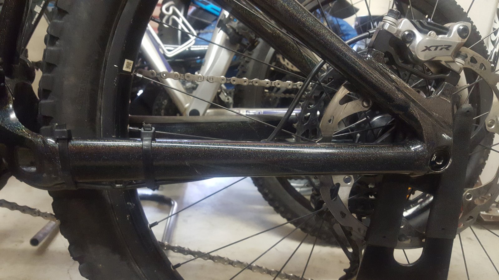

Not something simple like a broken cable tie where the rear brake line or wire comes out from around the motor area and runs along the swingarm and the brakeline/wire reacting with suspension bob and slapping on the rear triangle or frame?

Not something simple like a broken cable tie where a cable comes out from around the motor around the swingarm area reacting with suspension bob?
Thanks for the suggestion but by a process of elimination, it definitely only happens only when I am pedaling and under load (light or heavy, makes no difference). No load, no noise.
