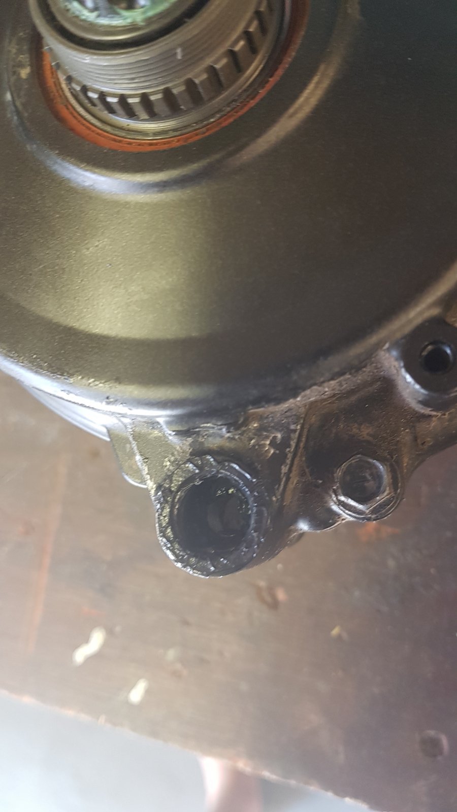

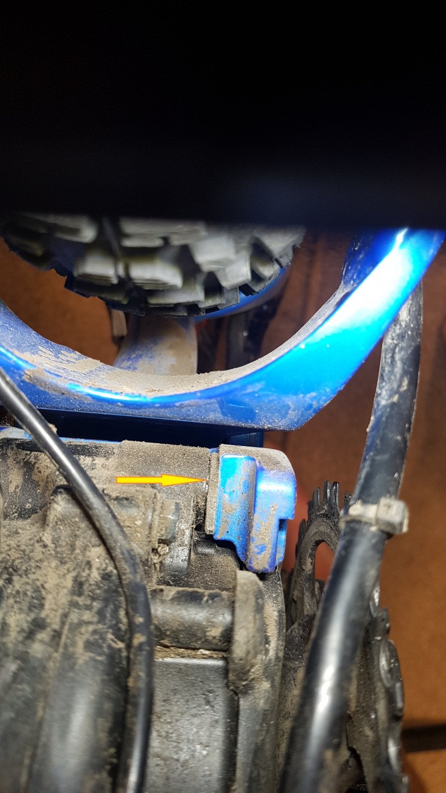

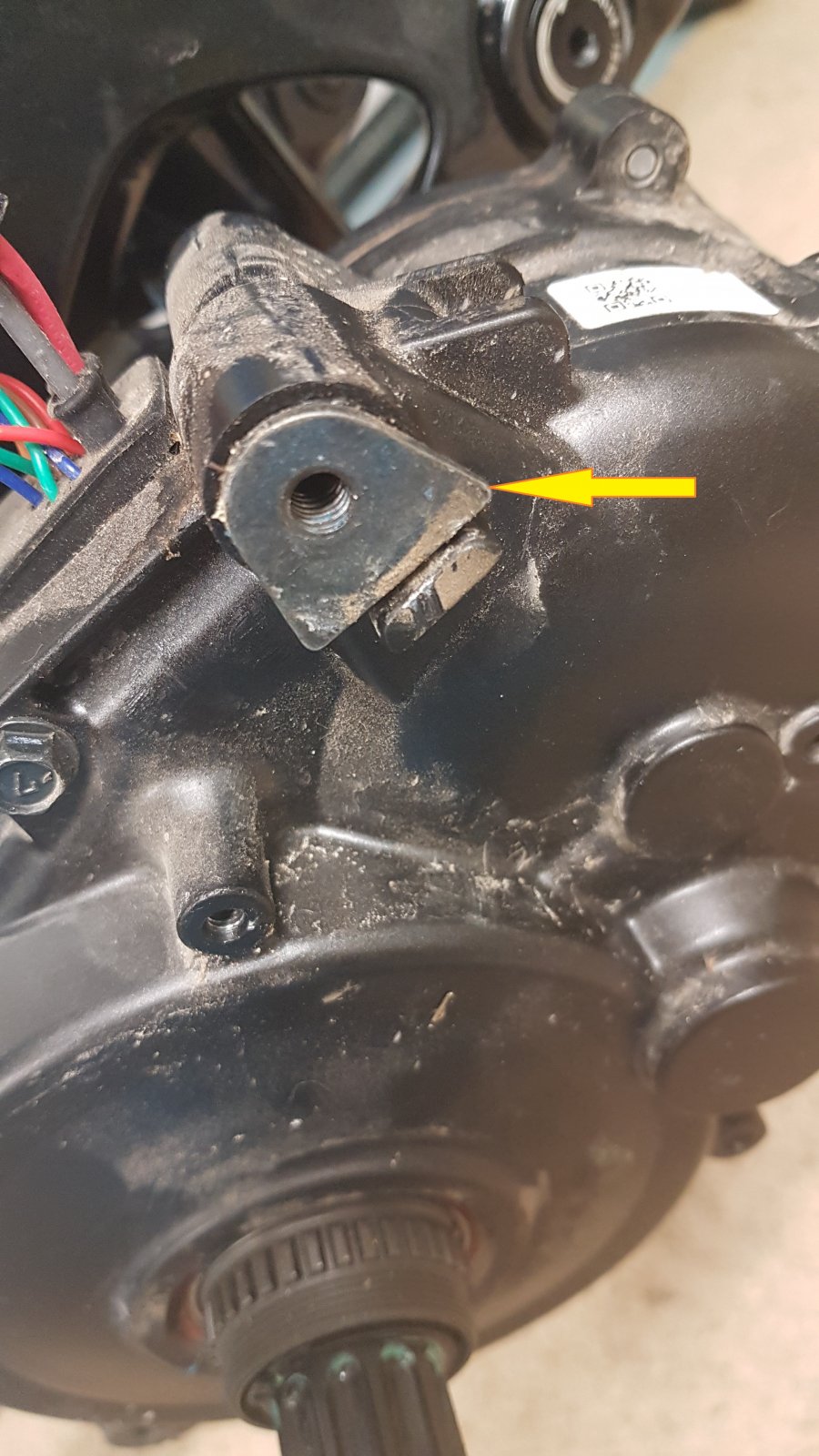

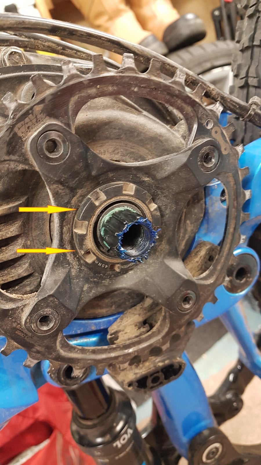

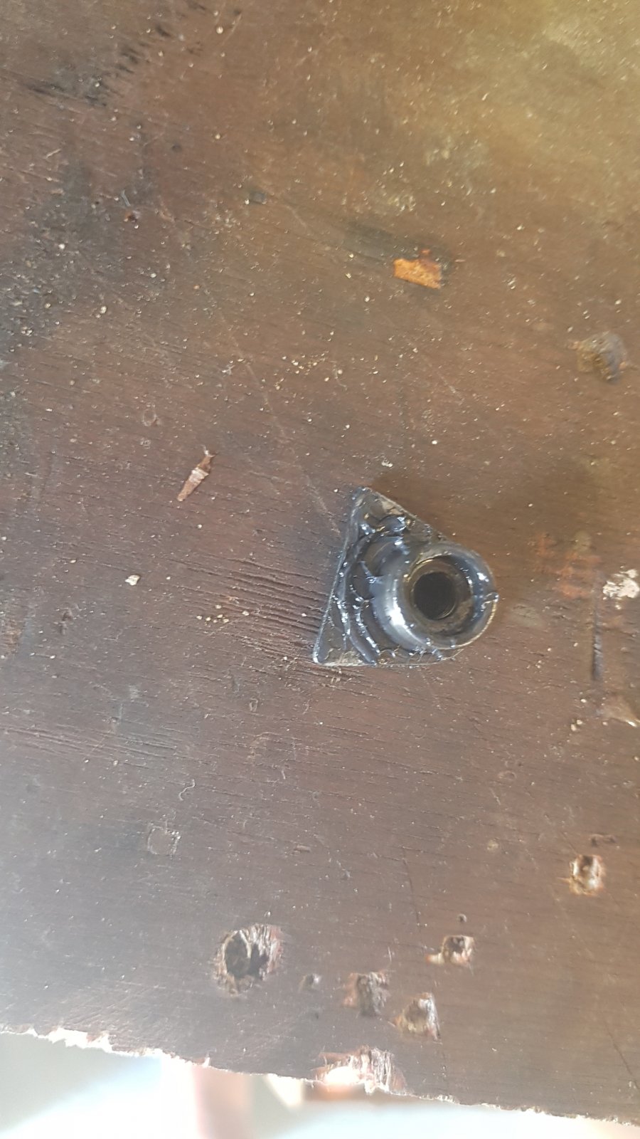

Gooday all. Since my post I found out what the "Ticking..Creaking" was. Have attached photos to clarify better. Seems that the motor is held in place by 4 bolts. The two largest, (charging side) secure the motor to left side of frame. The two smallest (chainwheel side) secure the "bush" that attaches to the motor in a very tight tolerance hole.This allows for any movement between either side of the frame around the motor housing. Any movement in the frame will be in the bush to motor, so if this is not allowed to move the connection will become solid. On my bike, the steel "bush" either end of the motor were stuck very tightly. As their shape makes it hard to get mole grips, etc on to pull the bush from it's mounting, I carefully used a hot air gun to try and break the seal between bush & hole it sits in. Then cleaned up bush surface and hole with emery paper and greased. Noise instantly vanished. I will be checking this after Winter and then before as possibly water getting in this area and / or Summer possibly drying out any grease. Common problem looking at the number of people reporting noise when peddling under load. Did check the head bearings and there was a build up of dirt that was another possible suspect after reading posts on EMTB.
