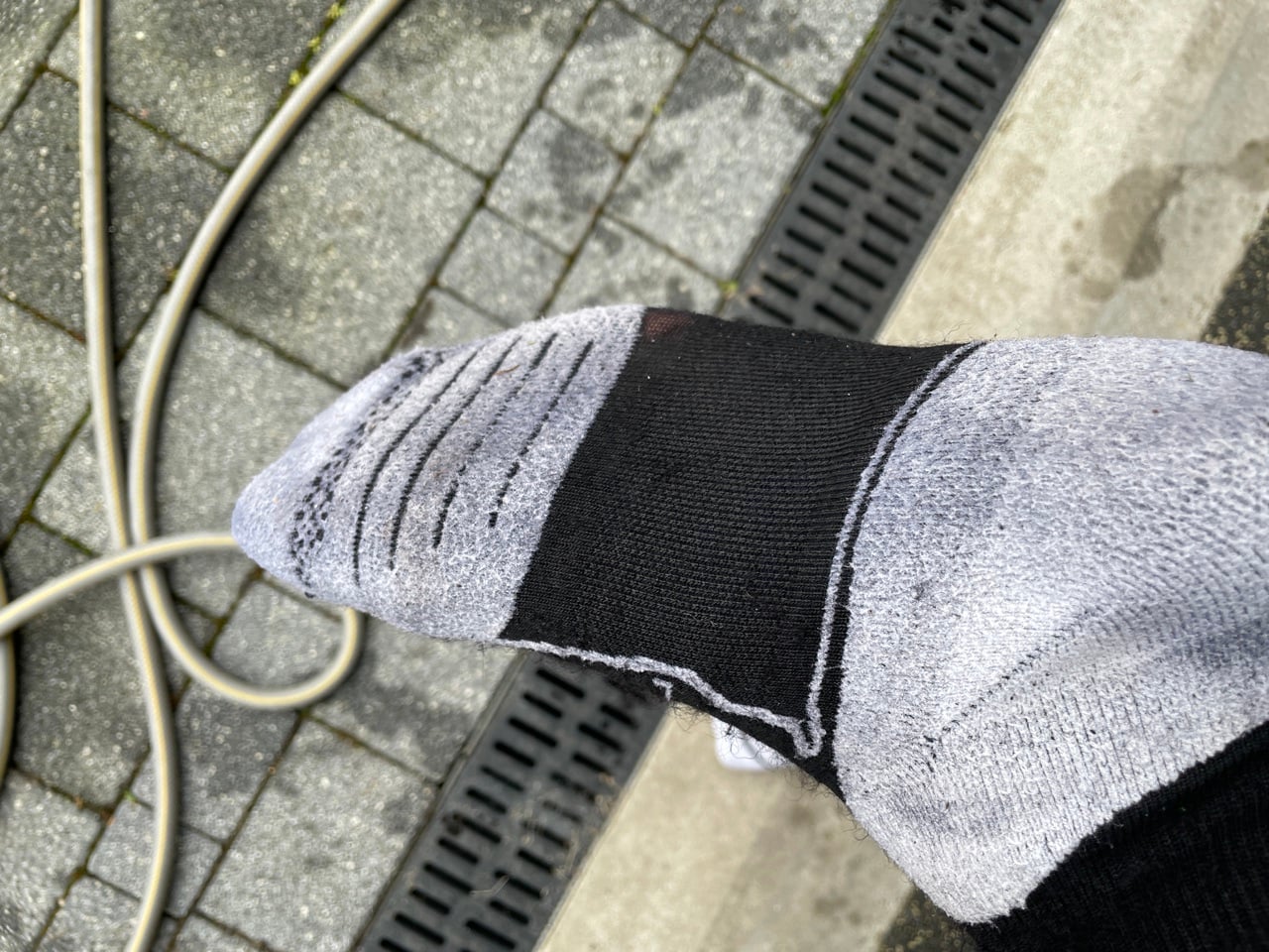

If the water was wicking down the sock I'd expect the sock to be fully wet if the toes are wet.
That’s my concern. The toes are wet, but quite a lot of the sock wasn’t. I wondered if water was getting through the toe box somehow.
I’ll try giving them a good dunk tomorrow and see what happens… and dig out some light grey socks for reference!

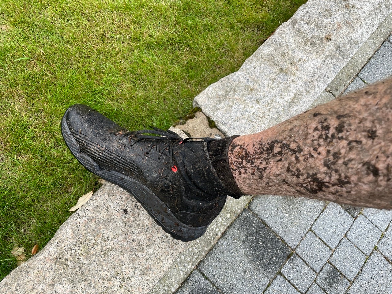

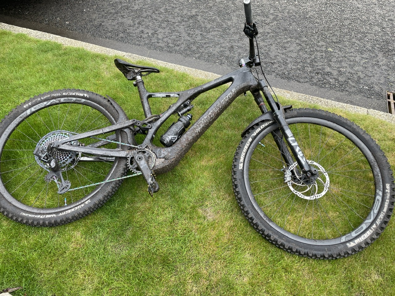

Although it’s nowhere near winter today, it’d been raining most of yesterday. I thought the trails might be a bit soggy, so a good time to test out the Trailcross GTX. It was about 18degC, so I went out in shorts / T-shirt / and a regular pair of bike socks - which sat just above the top of the boots.
First impressions were the Trailcross were really grippy. Much grippier than my Shimano / 5:10 sole hybrid boots. I think this is because my Shimano boots have a really hard sole, but the Trailcross are a bit softer. They felt pretty comfy too. If anything, they were too grippy with my HT ME03T pedals, as I was struggling to ‘adjust’ my foot on the pedal without having to lift it fully off and re-position. As the ride went on and the soles got wet, this became a bit easier.
I rode about a mile of roads to get to the trails, and then about 15 miles of trails. They were mainly damp, with some puddles and sludgy bits. As I cycled, I was getting splashes off the front wheel, and by the end of the ride - I was pretty dirty.
Not clarted in thick dirt like I’ve been in the past, but a film of dirty spots.
Compared to my legs, the boots looked pretty clean! Perhaps the water coming off the front wheel was cleaning the boots?!

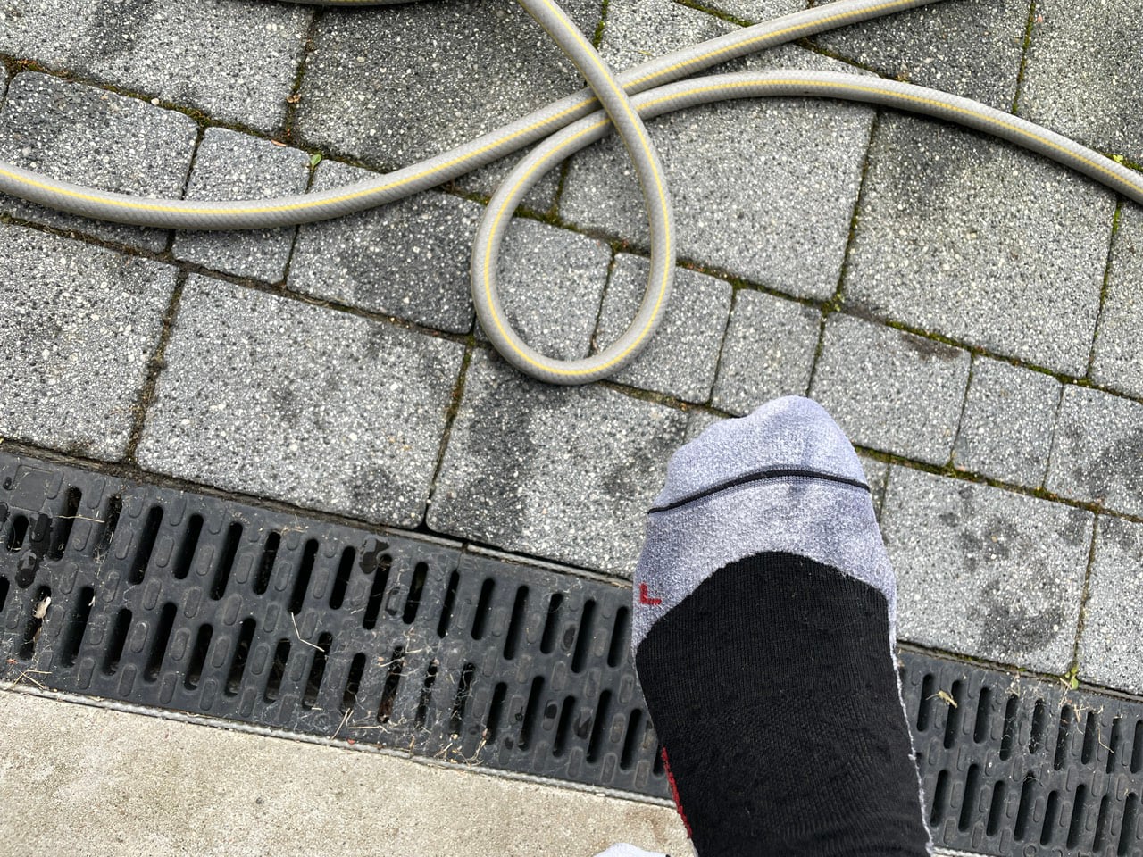

By the end of the ride, I felt like my feet were soaked. When removing the boots, one foot was soaked and the other was pretty damp. The insides of the boots were visibly wet, and they felt like someone had poured water in them.
Now…
Did the boots leak, or did the tops of my socks get wet and soak right the way down?

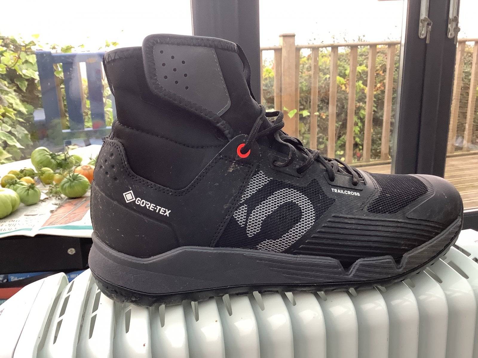

After the ride, I washed the bike, and the hosed the boots down. I was concerned that the ‘grid’ type pattern on the toes would hold onto the dirt… but they cleaned up well.
They’re now on my boot drier getting dried before they stink of damp!!
Once the shoes are dry, I’ll have to experiment with them to see if they’re letting in water. I saw a guy doing a review of these boots who had his feet in a basin of water and his didn’t leak… so I’ll give that a try.
If that’s ok, then my next ride will be with socks lower than the neoprene ankle gator!!
If they leak during the basin test, then I’ll be getting in contact with Adidas to see about getting them swapped over.

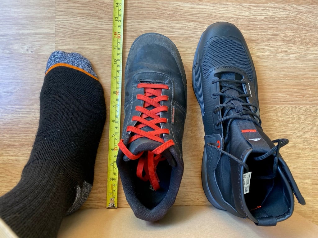

Well the 10's arrived and they were a little tight, fine with thin socks, but not thick ones. Physically the were longer than the Bontragers even though they were tight, so back they went for a size 10.5.
The 10.5's arrived and the first thing I had to do was fight a cat to get to them:
Once I got to try them on they fitted perfectly, just like the Bontragers. Physically they are much bigger than my normal shoes and the Bontragers, but I think thats down to their construction and built in protection.
I've yet to try them out on a ride, and test how waterproof they are, I'm hoping they are as good as YouTube video.
@Doomanic commented about sizing up and ending up with clown shoes, well its a close call! :unsure:
I'll have to get use to their size, SHMBO says they look 'Chunky'. Anyway here's a pic to try and show just how big they are in case anyone's interested:

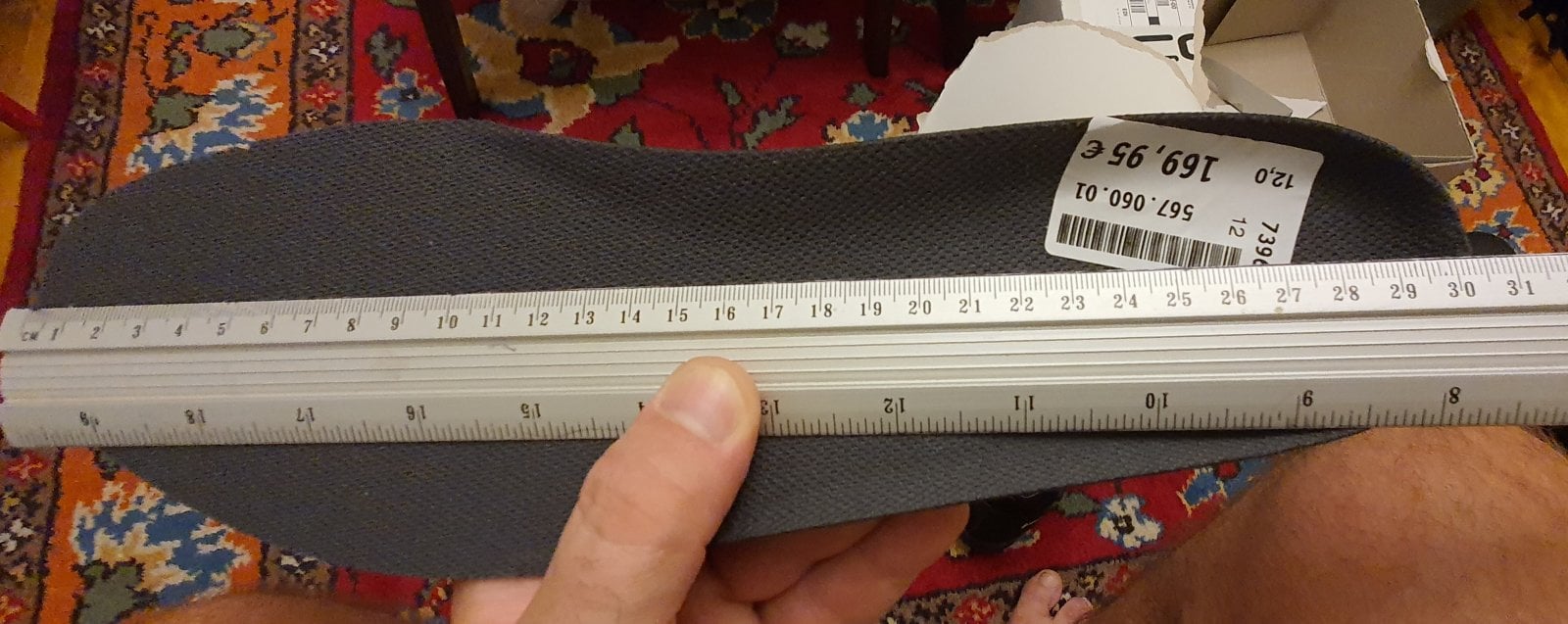

a half above your foot in cm ? Because i measure my foot and i have 28,8cm and i order 29,3cm aka size 12 uk.
I’m normally a U.K. size 11 and I ordered a U.K. size 11.5
No measurements, sorry.
My pair is here. The shoes is size 12 uk , my foot measurement 28,8cm. size 12 must be 29,3cm foot in the five ten chart size. But look at this : The back of the insole is 29,5 cm and the front side is 30,3cm. In normal european size i wear 45 size, here we have a 47,5cm size from five ten. Same problem was with a boots frok Salomon : 46,5 cm was to tight for me. My foot is a little wide on the front and the Five ten is on the limit. I have almost half a cm or a cm in the front of the shoe. I keep that for a thick winter socks. Also i can't stand that my foot to be tight in the shoe and i don't know how i will deal with a almost 1 cm extra in the front when i will ride my bike. And at 47,5 size they don't look like a clown shoes. Maybe if your foot in no to wide. I'm waiting the cold season to weare them.
shoe measurement is not your footprint, it is the length from the end of your toes to the furthest point of your heel. To measure your foot length accurately you need to stand with your heel against a vertical surface and then mark where your toes end on the horizontal surface. The insole measurement on the bottom of the insole takes account of room required at the back of the shoe to accomodate the heel.

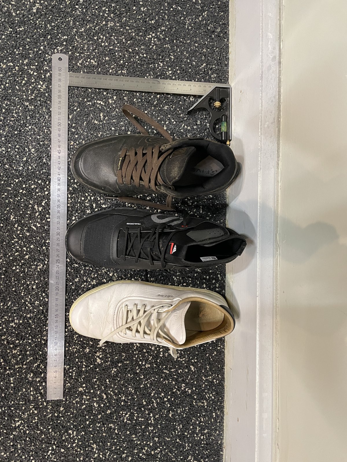

Here’s my comparison. A 5:10 Freerider in a 9.5, the Trailcross GTX in 9.5, and an Adidas Adipure golf shoe in 8.5 (all UK sizes).
The ruler is 100% square (although it doesn’t look it!) as it has the same gap at either end.
The shoes are all pushed right back against the skirting.
The Freerider and golf shoe both fit my foot perfectly, and the Trailcross is slightly bigger - but the 9 in it was a bit snug and wouldn’t have worked with thicker socks.
Physically, there’s not much in it - and the Trailcross being slightly bigger matches up with the fit. It just shows that the 5:10 sizing is a bit off!

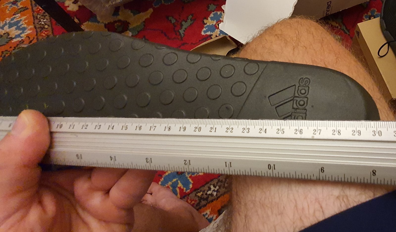

As for the sizing, I've looked at the chart and read these posts, as far as I can tell the CM sizing is likely correct and being mapped to larger UK and EU sizes than is normal. We'll see,! was reading this post before ordering some :)

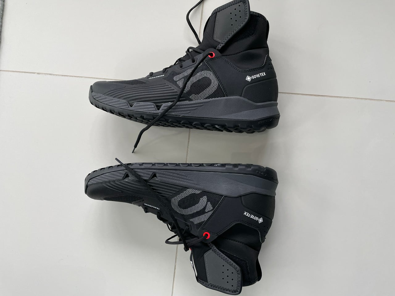

So following my first couple of rides in I thought I would do a brief review.
Firstly they do come up small, I've never ordered larger than 8 and in fact sometimes 7.5 UK across all brands including many pairs of Adidas trainers over the years (Im 54 and started with Kick and Samba). Although I do have wide feet and felt very pinched in the 8's the length is also fine with a little "wiggle room". Returns are easy and prompt if you order direct off Adidas so buy your normal size plus a half size bigger is my suggestion.
Pros:
Well constructed.
Good overall quality of materials.
Rugged looking, stealthy and no bright "features"
Decent toe and ankle protection.
VERY grippy on flat pedals (DMR Vault with spikes).
Decent grip on mud and rocks (significantly better than standard 5:10's).
Seem decently waterproof (not extensively tested yet).
Good seal around the sock/ankle (my main reason for buying these).
In short they have transformed my riding style and I'm positive they will keep my feet dry and warm in the sunny Pennines!

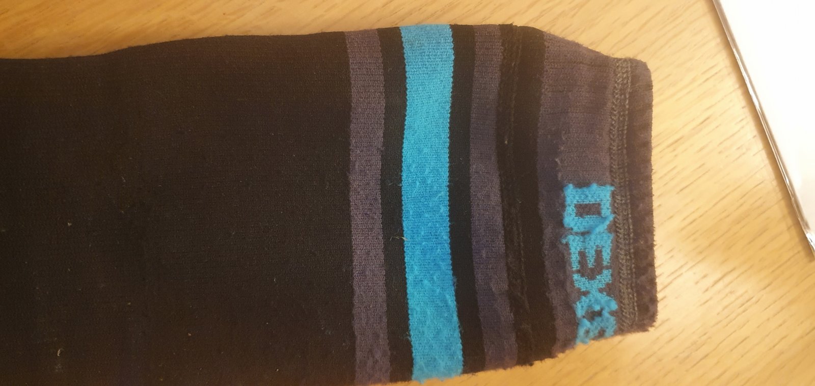

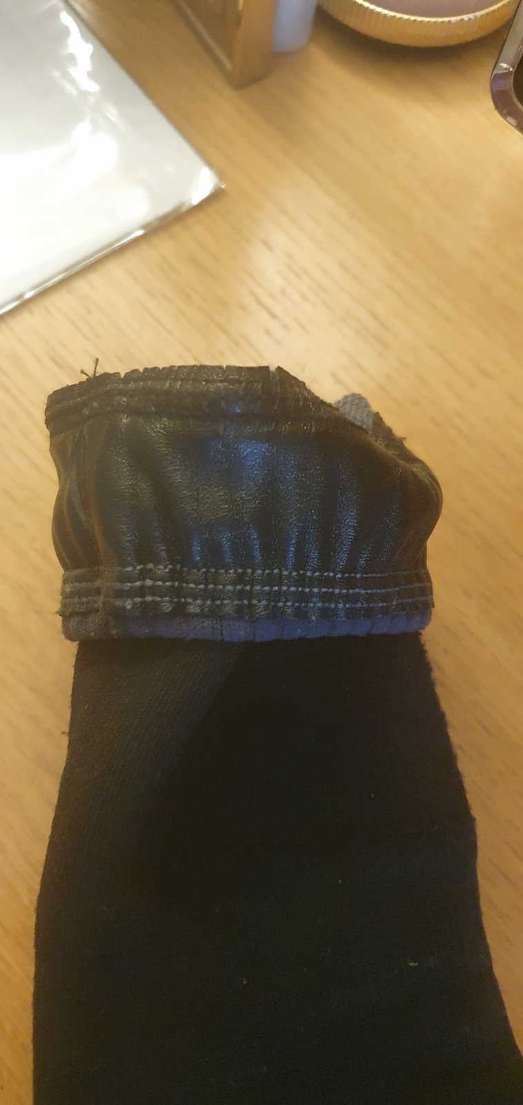

As mentioned a little earlier in the thread, sealskinz hydrostop socks, job done! I had that crap drizzle stuff all day at Skiddaw none stop, the only thing that was dry were my feet 😃
