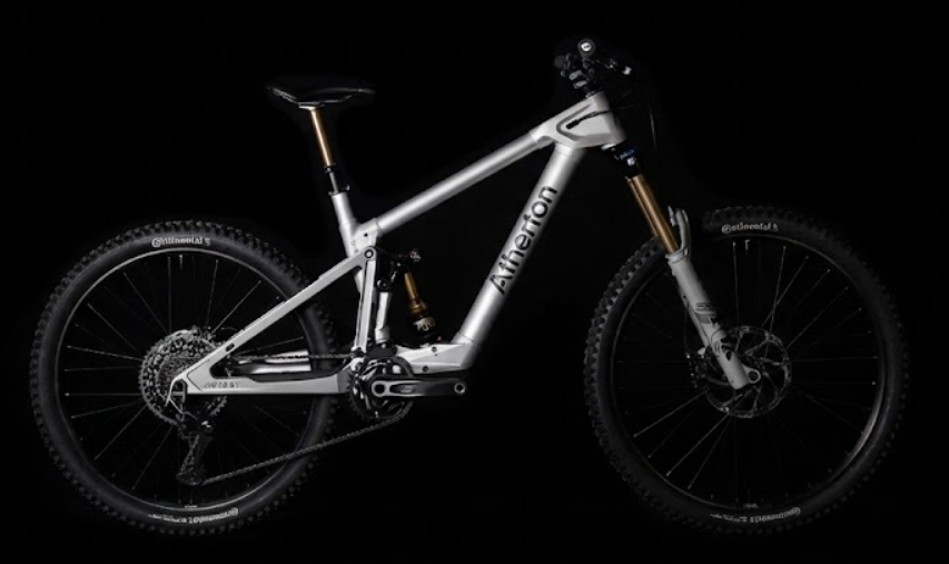

Tidied up image from @GatorXman
Launches April 2026. Pre-orders are open now for the first 50 bikes (Total £8999 - S.170E.1 / S.170E-2 - £7799 / £6999 - S.170E.3), with delivery scheduled for April and May. (Deposit £1000, Balance due 30/03/26) - Example Pre order S.170E.1 bike : Fox Factory suspension and SRAM X0 Eagle Transmission
Atherton bikes direct link :
Basic Specs :
Avinox drive unit
Full-sized battery inside downtube
DW4 suspension with 170mm rear wheel travel, 180mm fork, and MX wheels
63.6° head angle, 75.6-77.6° seat angle, 435-445mm chainstays
Machined lugs and 7075 alloy tubes
12 sizes, 405-515 mm reach
Mavic E Deemax mullet wheels, Hayes Dominion A4 brakes, and FSA Gradient cockpit
All sizes will have the same size battery - battery size yet to be confirmed.

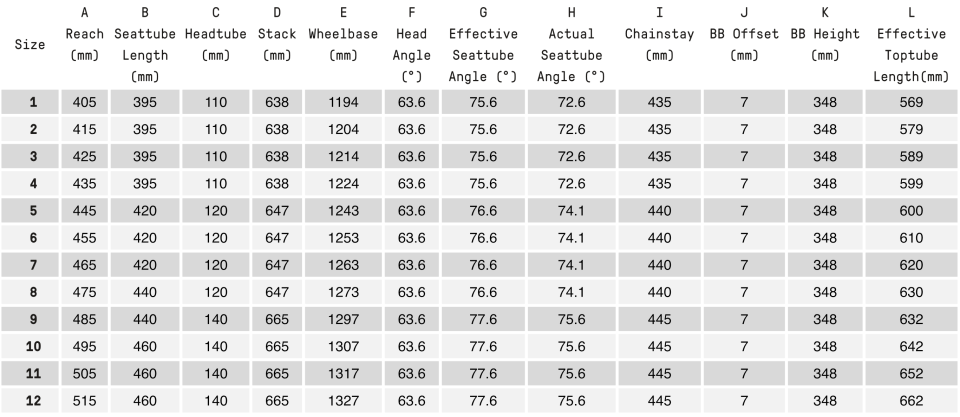

Geo :

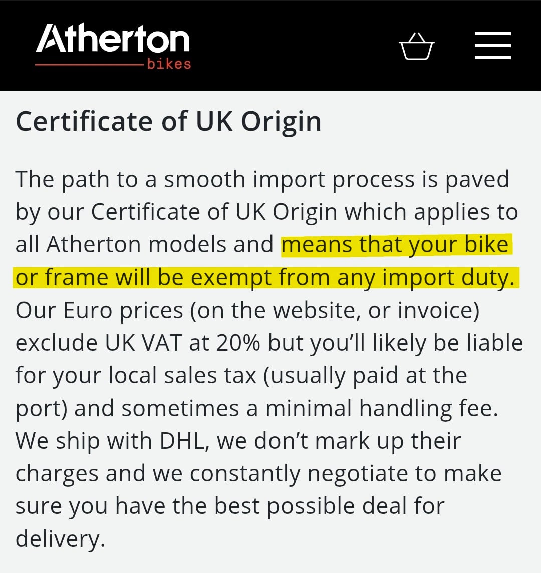

I was quick (and lucky) enough to secure the S.170E.1 from the 1st batch, but I’m EU-based (Croatia) and a bit concerned about import taxes and duties.
Atherton states that their bikes come with a Certificate of UK Origin and should be exempt from customs duty under the EU–UK TCA, with only local VAT and a handling fee due. Still, given that most components are sourced outside the UK/EU, I’m unsure how this works in practice for a complete bike.
Has anyone here imported a full bike from the UK into the EU recently and can share real-world experience with the process, VAT, duties, and total costs?

I’ve read their website and understand what they’re stating. What I’m really looking for is first-hand experience from someone EU-based who has actually purchased a complete bike from the UK.
I’ve had a very bad experience with my local customs office in the past when ordering car suspension from the UK, even though it came with a Certificate of UK Origin. I was asked to pay VAT, which was fine, but also customs duty, which shouldn’t have applied under the EU-UK Trade and Cooperation Agreement. I went back and forth with customs by email trying to prove it qualified for zero duty, but they wouldn’t budge.
In the end, I had to return the suspension to the UK store. I felt especially bad for the shop, as they ended up footing the bill.
That’s why I’m a bit cautious here and would really appreciate hearing real-world experiences rather than just what’s written on the website.
It will you are mistaken here, VAT+custom duty, been there done that last year. There is no such agreement ...
It really depends on custom for payment, sometimes it is them, sometimes it is through the transporter directly for payment.
Honestly if I ever buy an Atherton, I will pick it directly from UK through a trip :D
If that’s the case, then the information on the Atherton website isn’t fully accurate.
That’s exactly why I’m trying to verify this with real-world EU import experiences, because what’s written on the website and what some people are reporting don’t seem to fully line up.

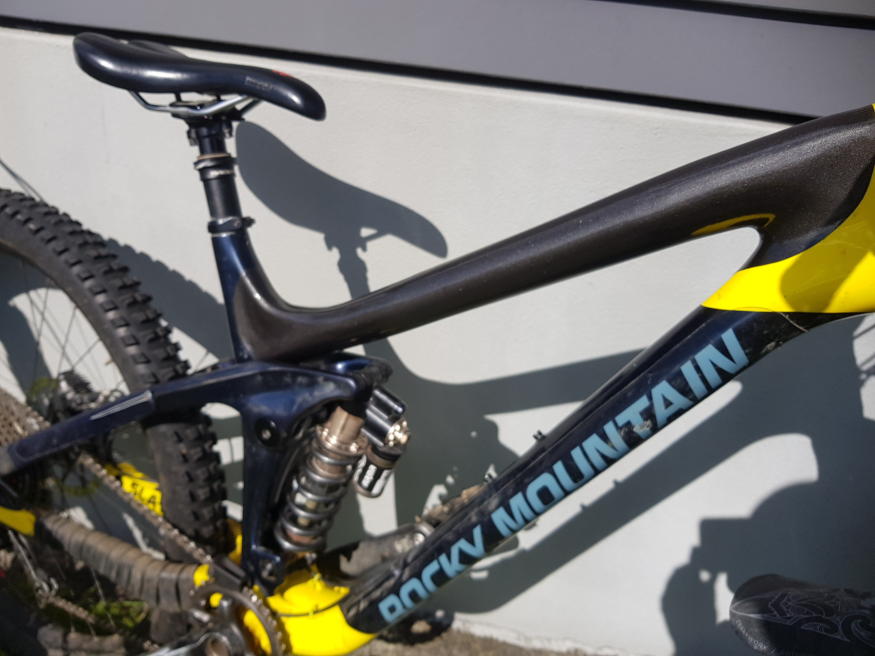

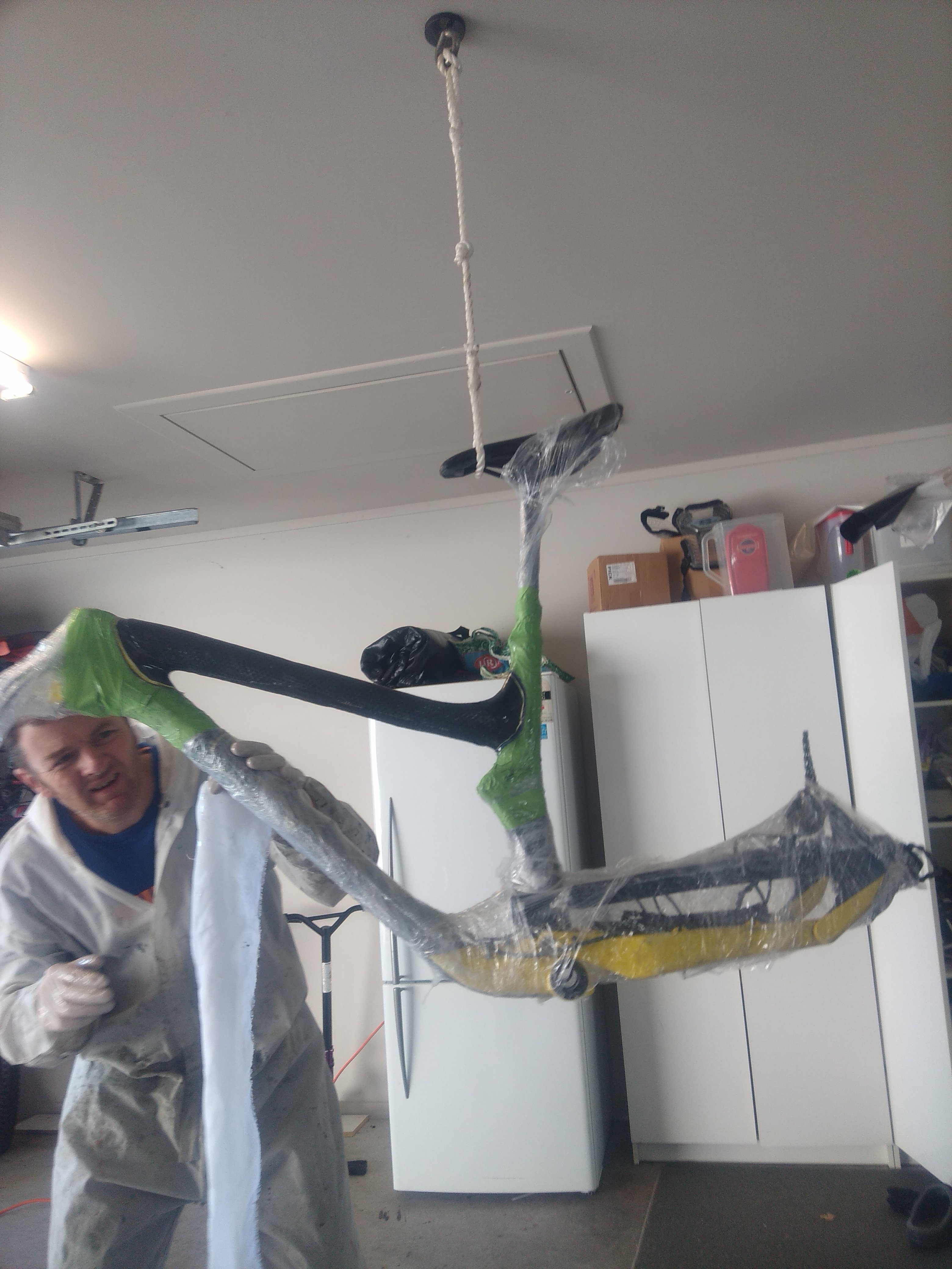

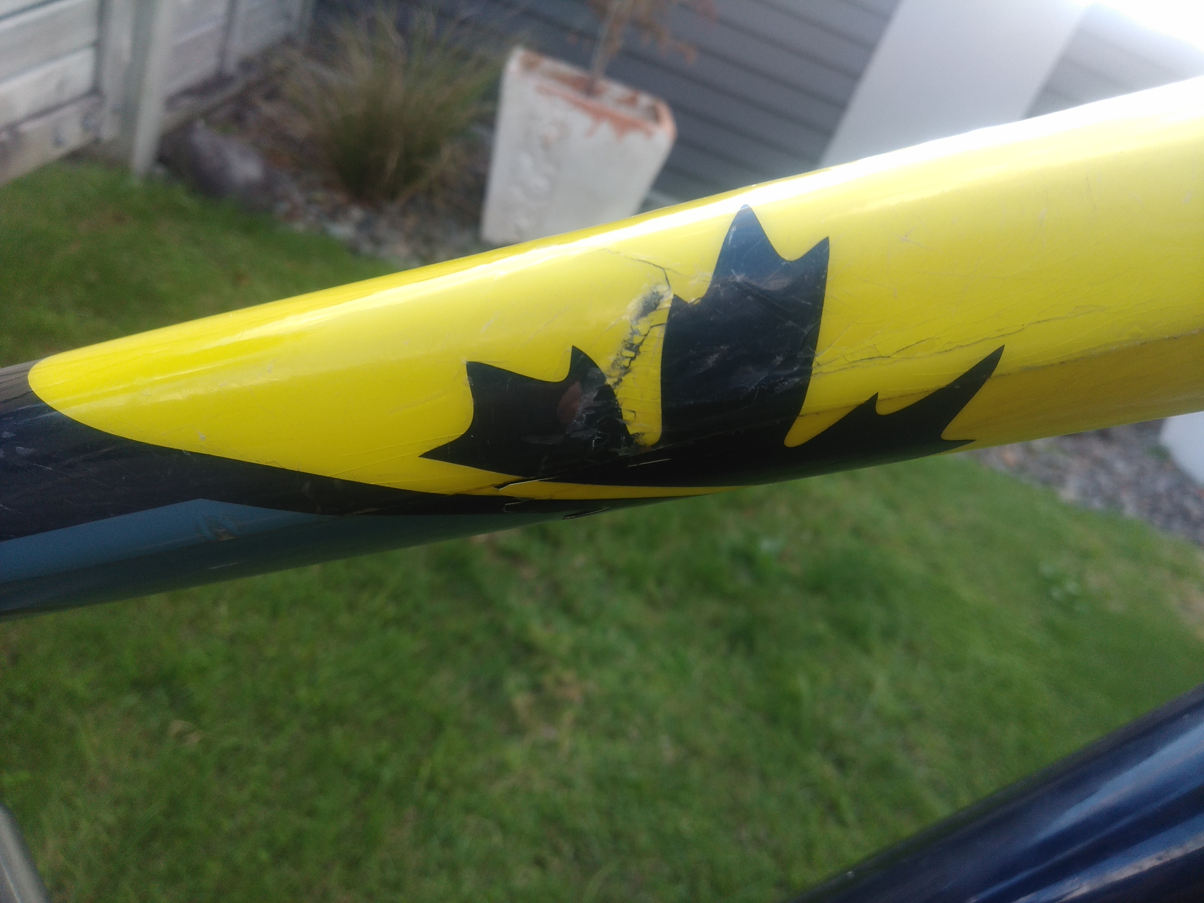

Below is one of the frames I fixed. Cracked the top tube right through. Performed a carbon repair in my garage and then stress tested that repair for 4 years as my huck it and hope bike with zero failure. As evidenced by the below sizable huck. That photo is 4 years after the repaired.
Can carbon be repaired? yes it can. If you have the knowledge its quite easy and can be done with basic tools.

AI detail is useless, I run an engineering company and the people next door to me specialise i n aluminium welding. As for Pole, they had issues from day 1 which is very well documented and it was always doomed to fail. Ive seen one snap at dyfi and split apart. How the Athertons approach bonding is completely different. Its the same way they bond aircraft. Hence people from that industry are on the team. Given your 'knowledge' I assume you should know this? You cant compare one to the other. I could pick holes in your logic for days, but its wasted efforts. keyboard warriors....
I understand the bonding differences between pole and Atherton. I agree the Atherton method is preferred out of the two. However any bonding of alloy method immediately rules out welding as a repair method.
A bonded alloy frame is the worst frame construction method for local repairing if the manufacture goes out of business.
So far you have stated carbon is not repairable and you have been proven wrong and also incorrectly stated that talked about welding alloy as a repair method which is most definitely not practical repair method for bonded Atherton frames.
Maybe go next door and talk to your alloy specialists and ask them to teach you about the best repair method for cracked or damaged bonded 7075-T6.
ive seen no evidence of a carbon repair, you have shown a comestic layer crackle which you bonded over. Thats not a carbon repair. If that had properly cracked, your repair would of never held. There are specialist. carbon repair companies for a reason. You seem to have a real issue with repairing a frame. If you bought a decent bike in the first place, its a none issue. Especially with warranties. Pole were always going out of business, there was enough evidence of that from very early on. Even more so with the owners replies to people .when their frames broke. If anything happened to the atherton frame just give it back to repair. But considering this isnt a new way of doing things and they have sold a lot of aluminium frames without any issues, noone should be concerned. I see how they get treated at atherton bike park every week, they are built to last
