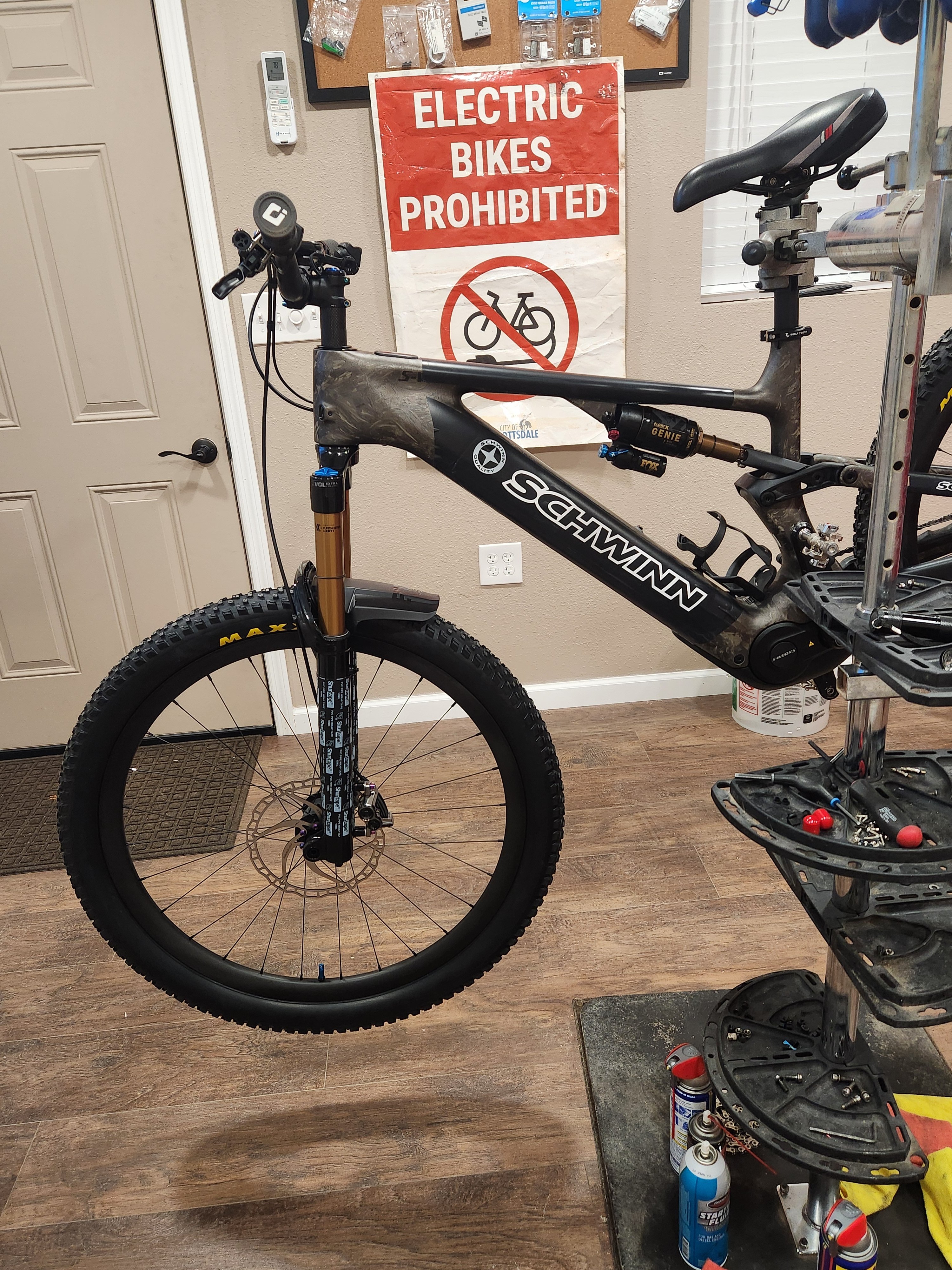

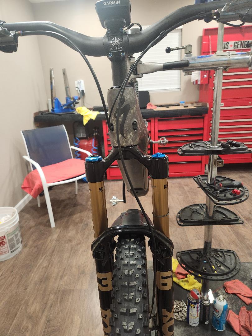

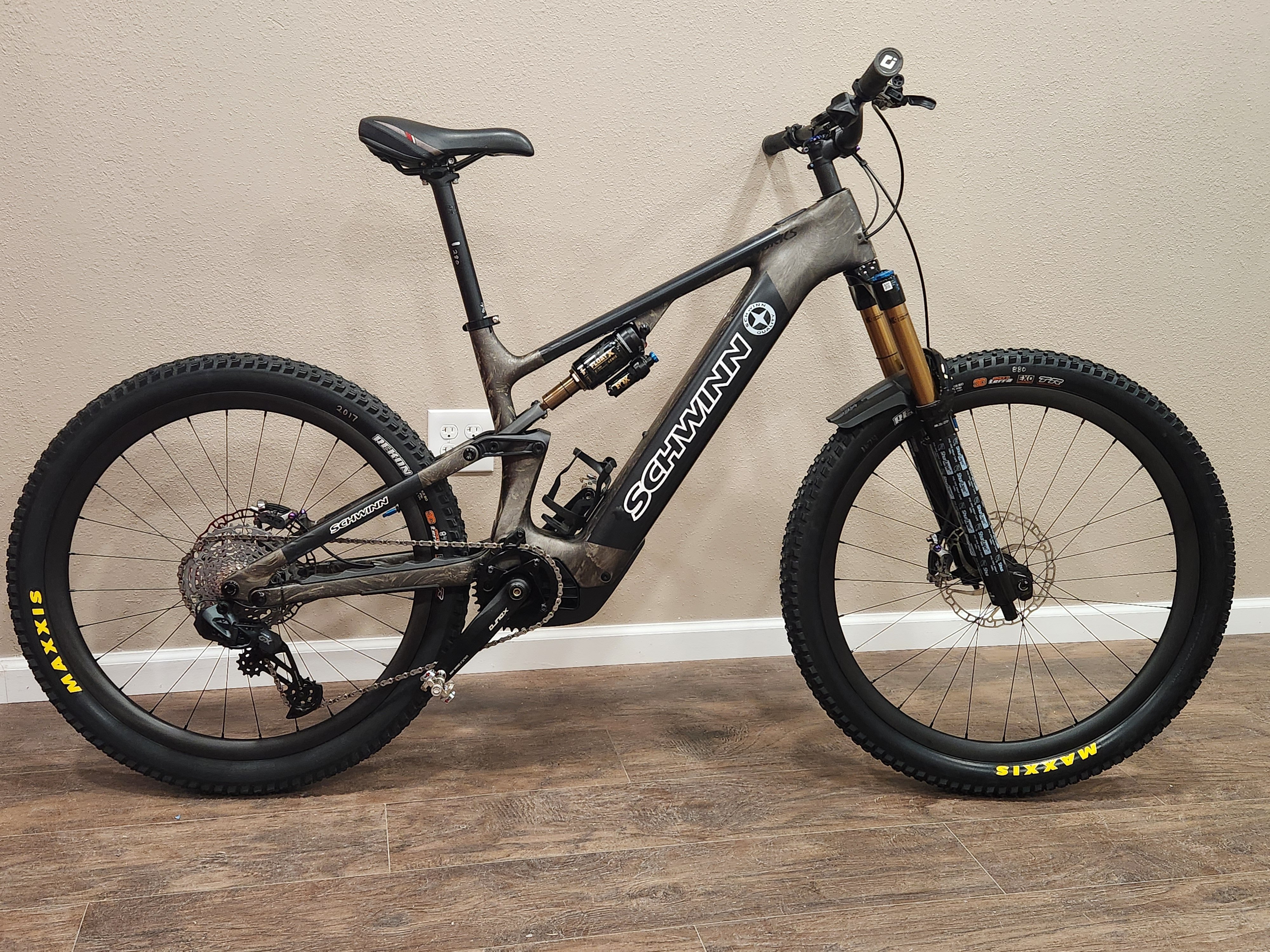

I re-weighed the bike today, complete as pictured previously at 51.8. total complete, meaning that by swapping out the 840 W battery w/ the future 600 w battery , a savings if 2.2 lbs, i can get it down to 49.6 lbs w/ Fox 38 fork. I will be upgrading, however to the new Fox Podium inverted fork later this week, which is rumored to add .75 lbs over the current Fox 38 fork but offer superior handling and plushness. A worthy upgrade, though pricey at $1835 discounted cost.

51.8 I think is a great weight. That’s about my gen3 weight with a 700wh battery. If I can get the bike to that weight with a 840wh that mint. Especially with a 38

Wow how did you get it to 21kg? Is that with the 840 battery in?

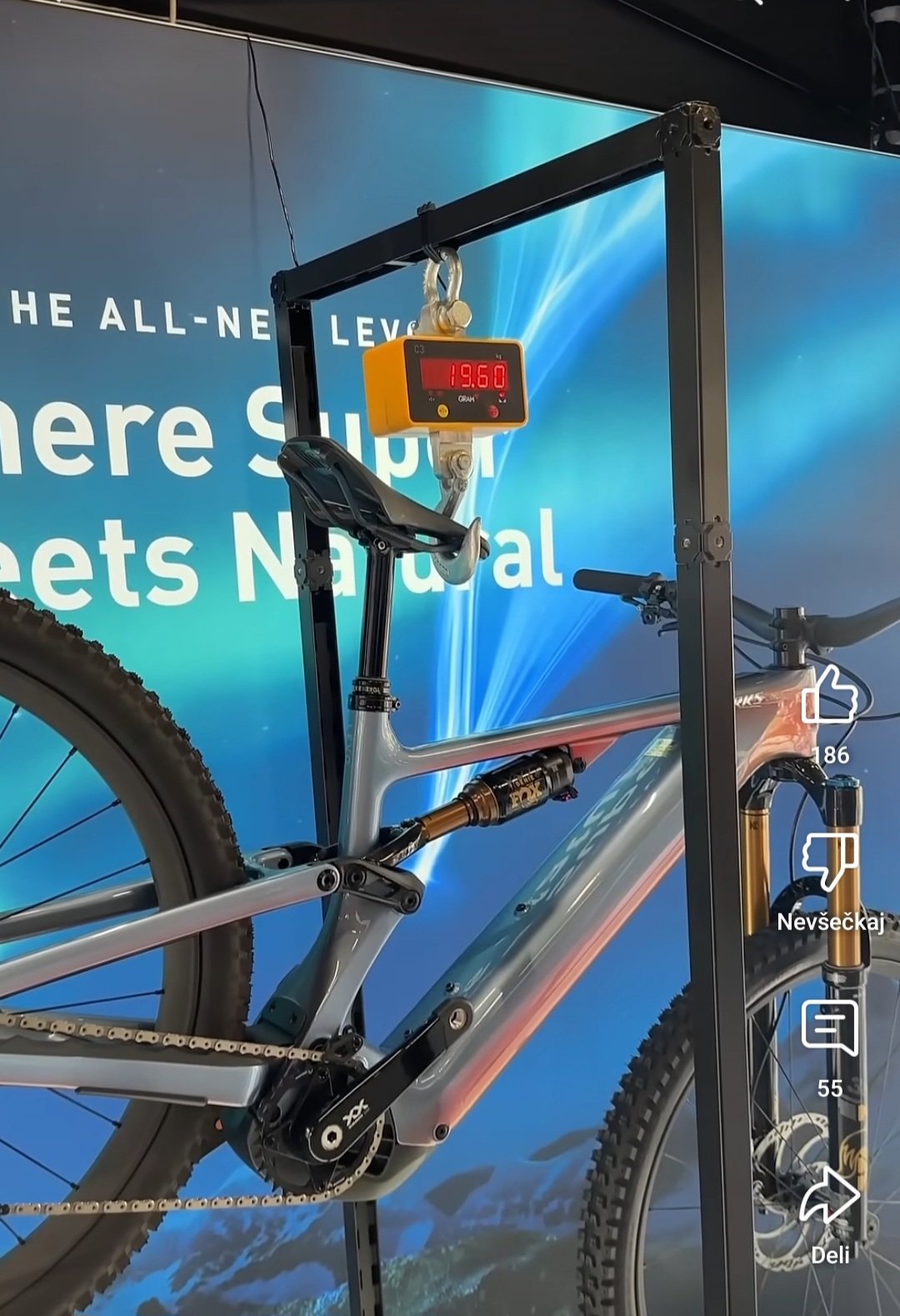

Now stick the 600Wh in there and you are at 19,7kg...just shy of the festival showroom suspicious 19,6kg S-Works.
I've been trying to find the answer to this 19.60 kg build from the very beginning with no success.
The confirmed weight for the Specialized Levo 4 bike is 23.62 kg without pedals and with the tyres set up tubeless (proof at Flow Mountain Bike). So tubes are off the table.
At the 19.60 kg weight mark, Specialized stated that this is a trail-ready build without critical compromises. As far as I see, there is an Eliminator + Butcher tyre combo, which is not cross-country, and weighs something like 1 kg for the Butcher and 900 g for the Eliminator. I also assume from their statement that they didn't use the lightest cross-country wheels to achieve that weight and those are probably regular levo s-works wheels maybe for 28 spokes in the rear.
My approximate counting is:
S-works weight is 23.6
lighter battery - 1000 g
tyres – 600 g
fork – 300 g (in my experience upgrading from fox 36 to fox 38 was 250g weight difference)
shock – 200 g
dropper – 200 g
brakes with rotors – 300 g
lighter wheels maybee 28 spokes in rear – 200 g
Which is 2.8 kg lighter, lets be generous and round to 3kg — so how did they manage to drop whole another 1 kg?
it looks like a marketing gimmick to me 🤷‍♂️
Apparently it was an S2 sworks with fox 36, rear shock no reservoir, lighter brakes, trail tyres, 600 battery, no swat and manual dropper.

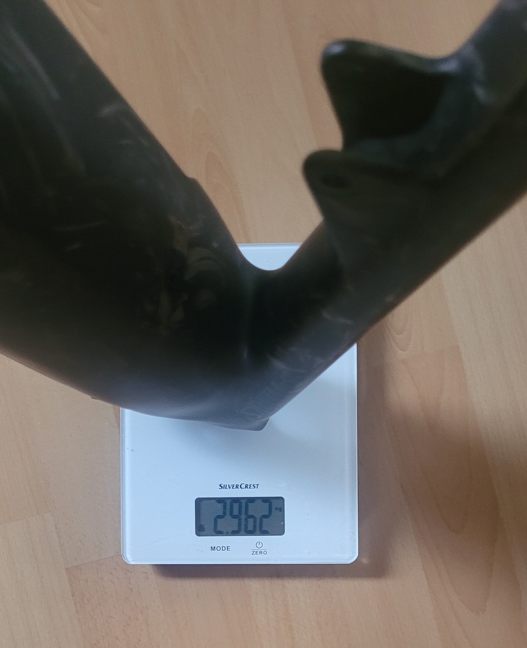

Did anyone weight their frame before building it?
2.962 kg
without: motor and shock and tcu and remote and chainstay rubber protector and rear axle and derailleur holder and other parts,
but with : rear fork, battery dock, motor to tcu cable, speed sensor and cable and axs derailleur power cable, and shock link without flipchip
View attachment 1661902.962 kg

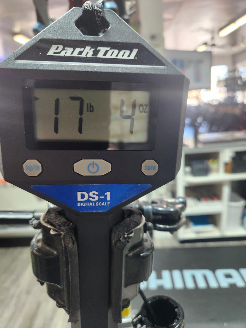

The frame as it comes out of the box without the battery is....
