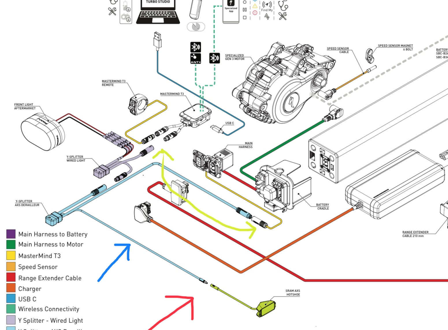

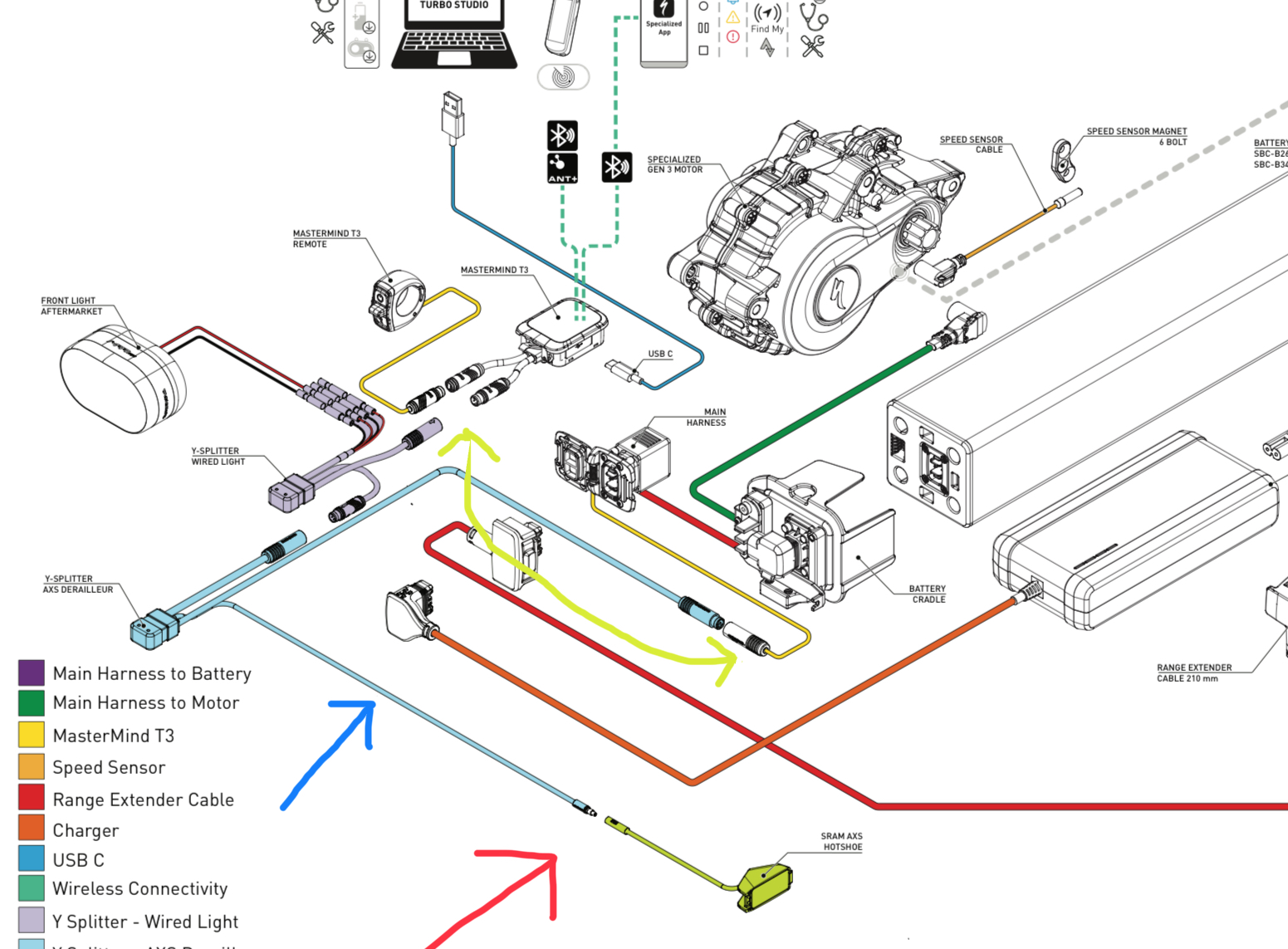

Is anyone here not riding SRAM and have experience of removing the preinstalled AXS hot shoe? Trying to understand if you can remove the AXS cable without dropping the motor?
The y-splitter cable that the hot shoe cable terminates (blue arrow drawn on my attached image) at could be removed but you’d need a replacement cable (shown in light green) to link the display and the wiring loom - but this appears to be unobtainium.
Almost just left with cutting the AXS hot shoe cable off and be done with it. However one of the wiring diagrams suggests it has a connector (red arrow) that I could remove it from, but this also seems hidden by the motor. Can anyone confirm this?
I’m pretty much resigned to dropping the motor but just hoping someone might know if I’m wasting my time as risking damage to wires in the process.
Any help appreciated

The blue wire and the hot shoe plug in together on top of the motor so yes the motor needs to be removed, and and once unplugged the hot shoe wire simply pulls out...
Thanks for the intel! Anything I should be wary of when reinstalling the motor?
Many thanks

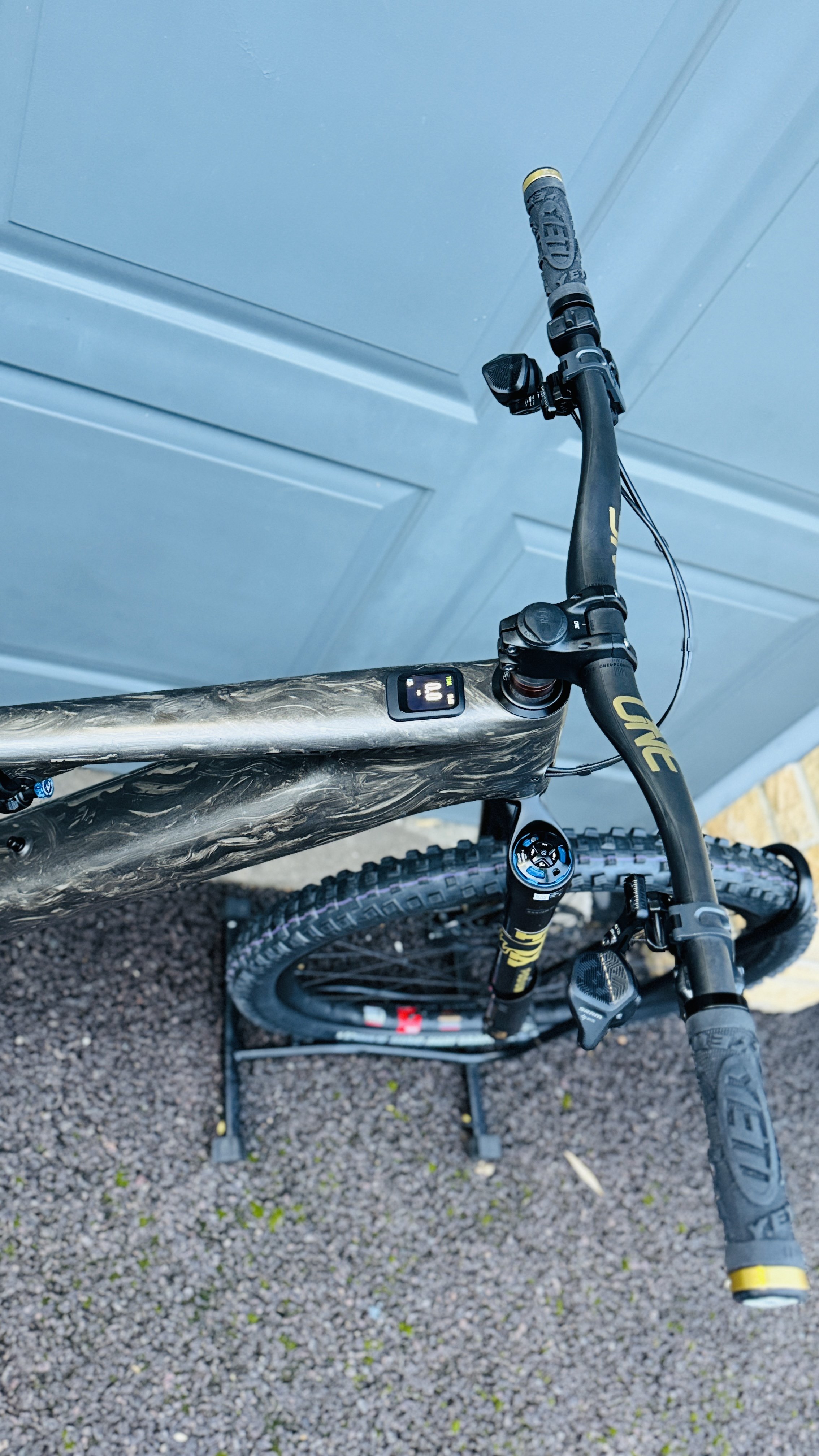

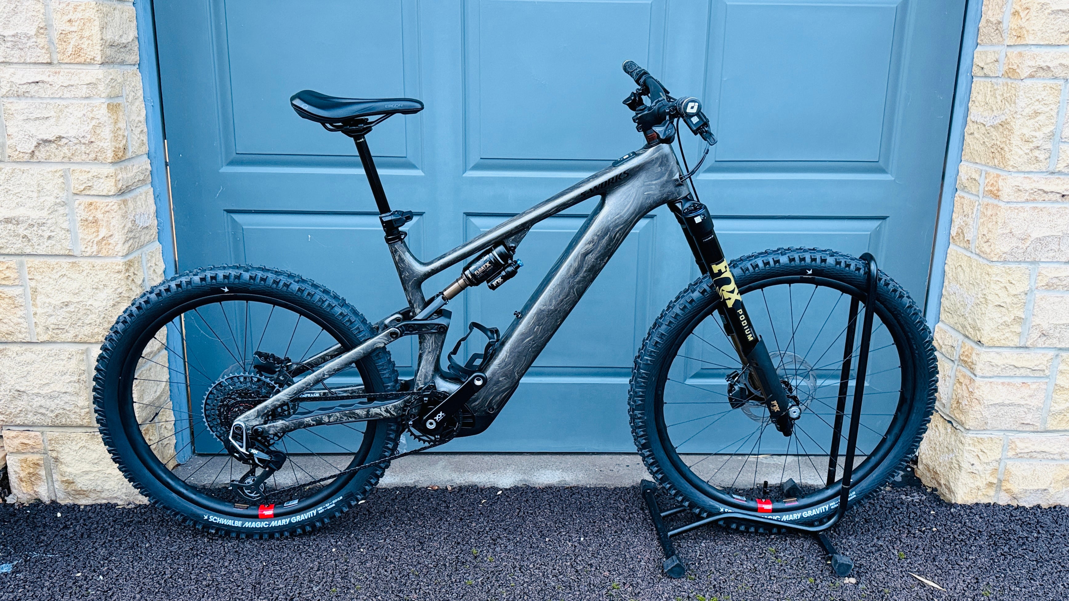

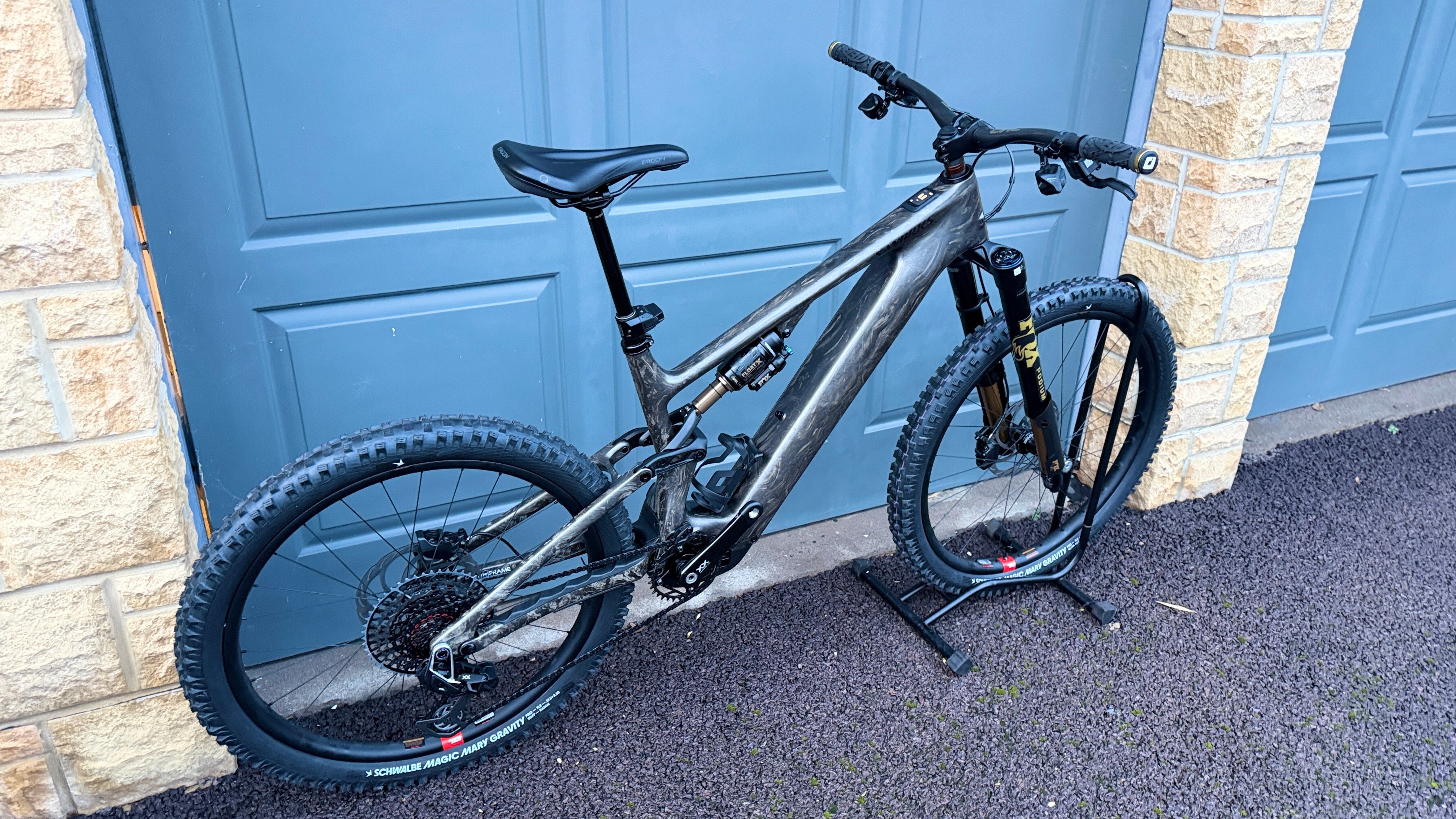

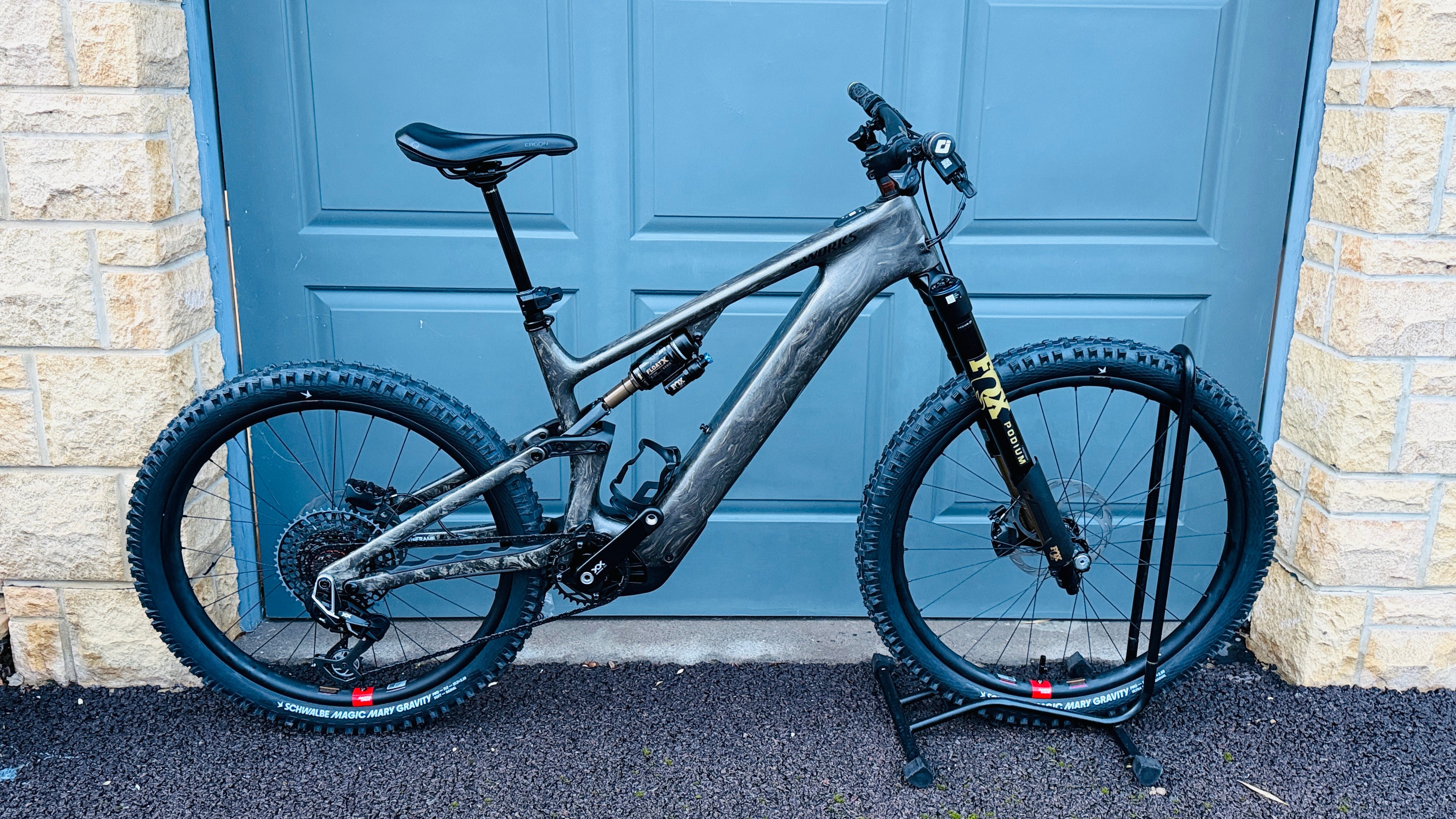

Just joined and thought I would share my new G4 build .
Hope Brakes , Fox dropper , Swiss carbon wheels , Push nine one
It’s a great ride , loving the suspension , and power .
I have just received a range extender and this integrates well with main battery and gives the extra mileage I was looking for.

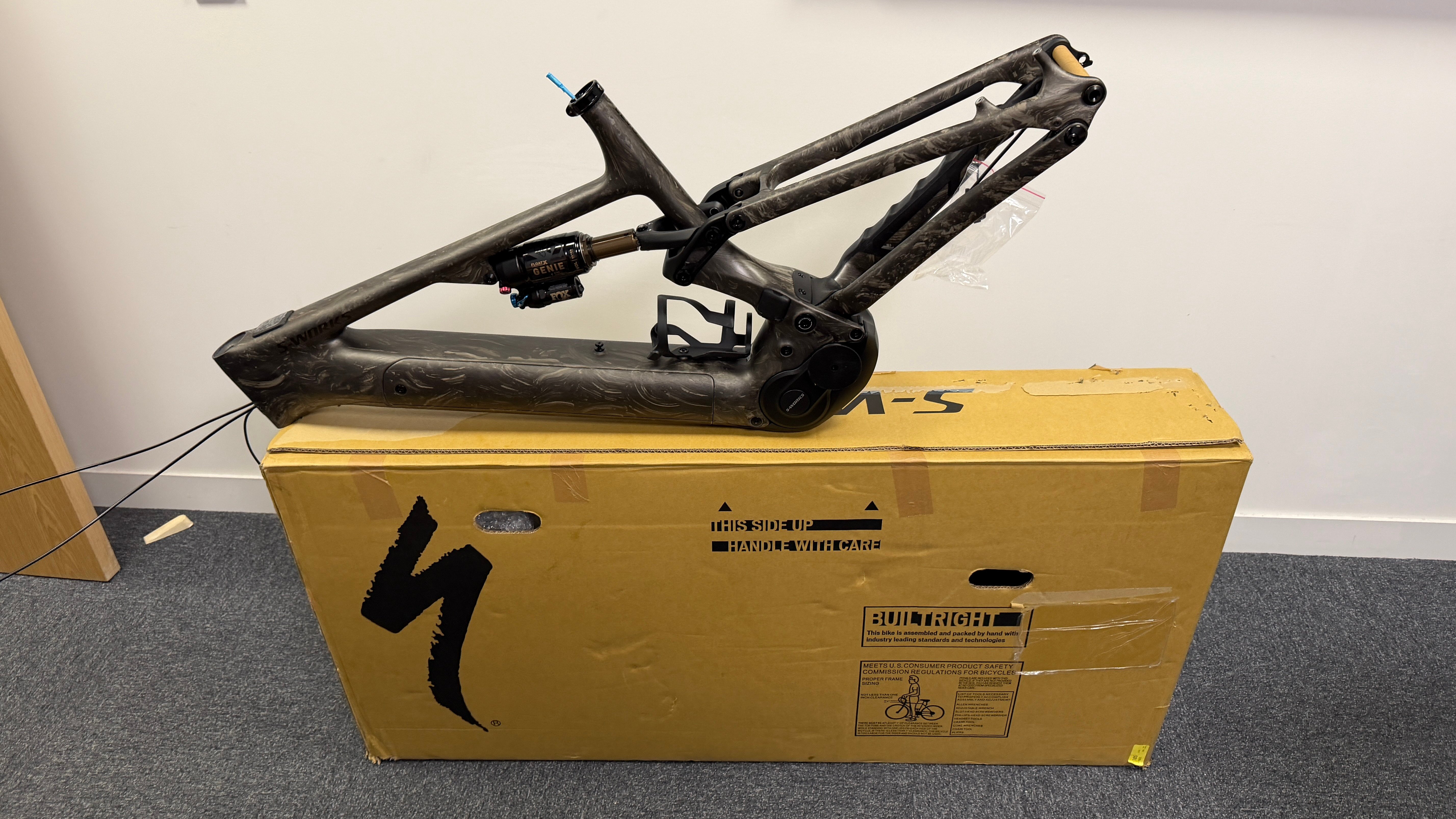

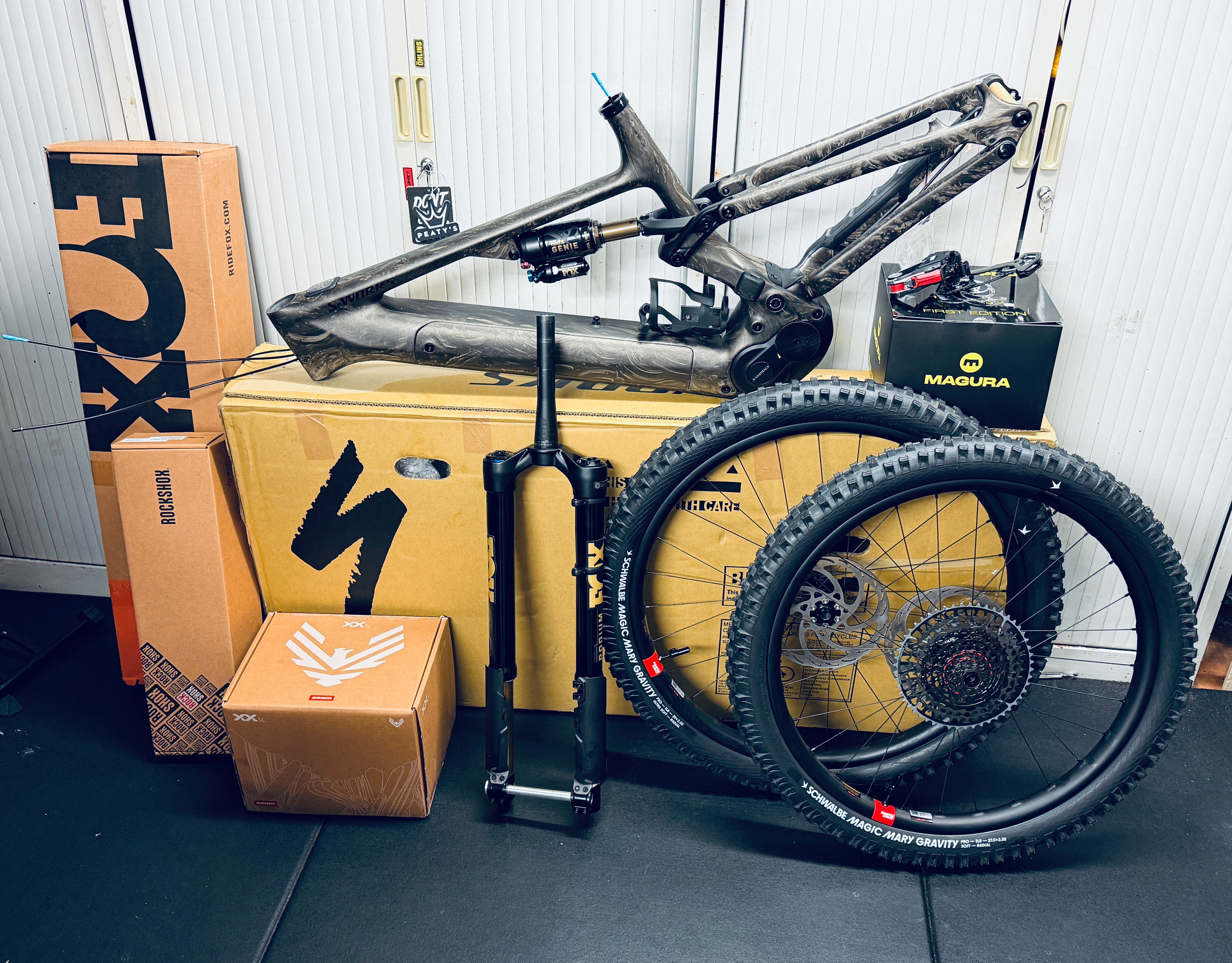

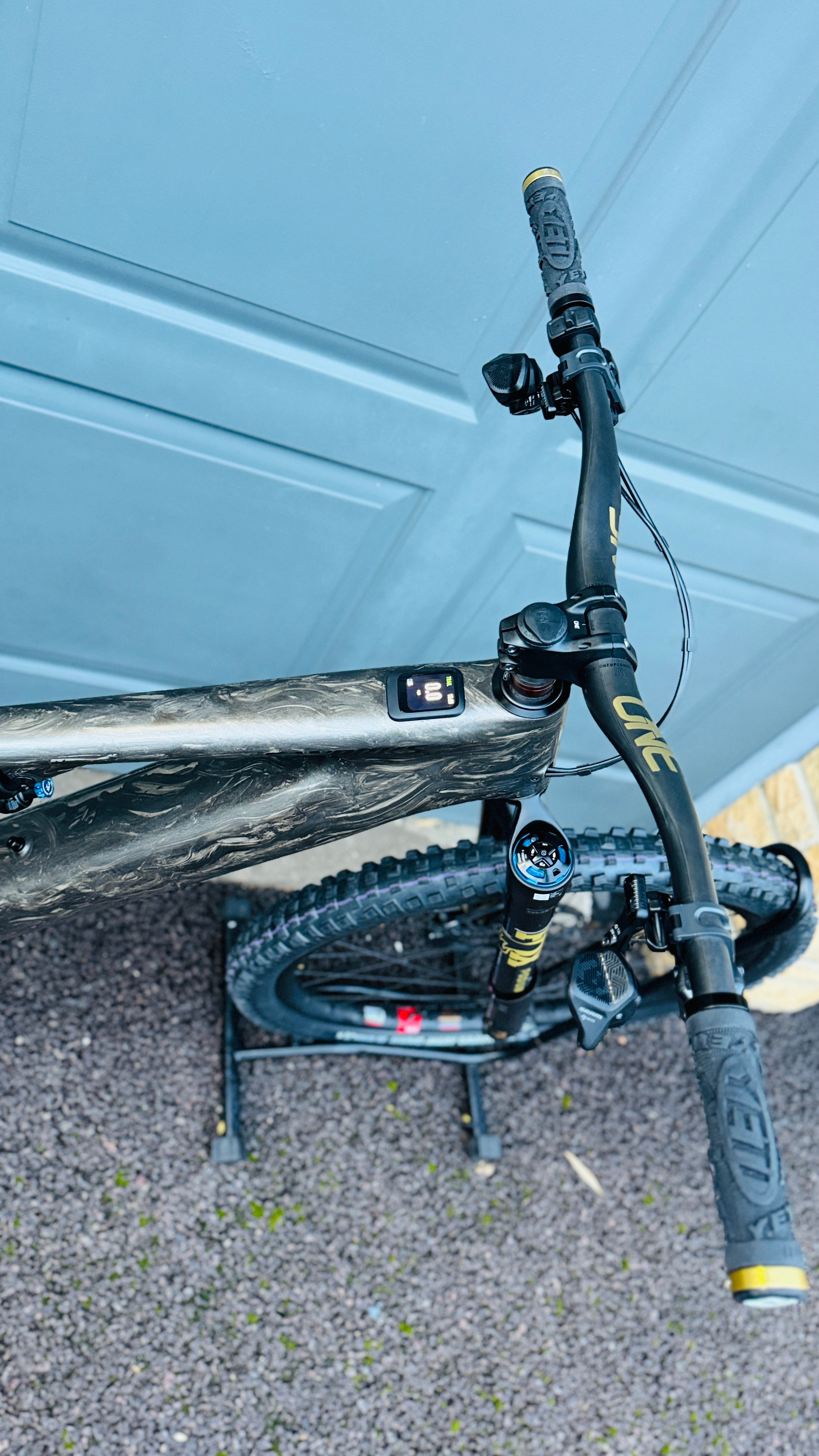

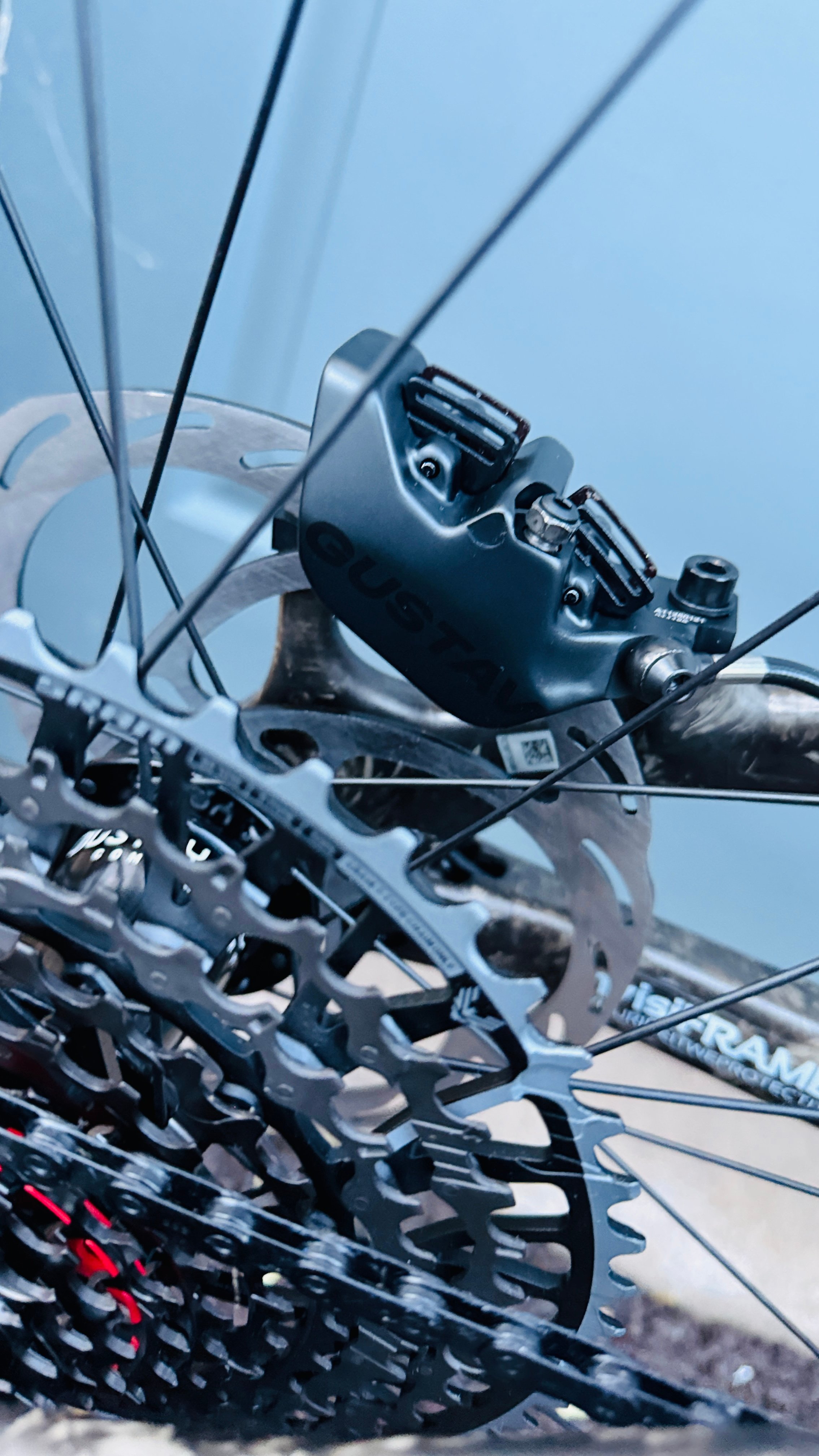

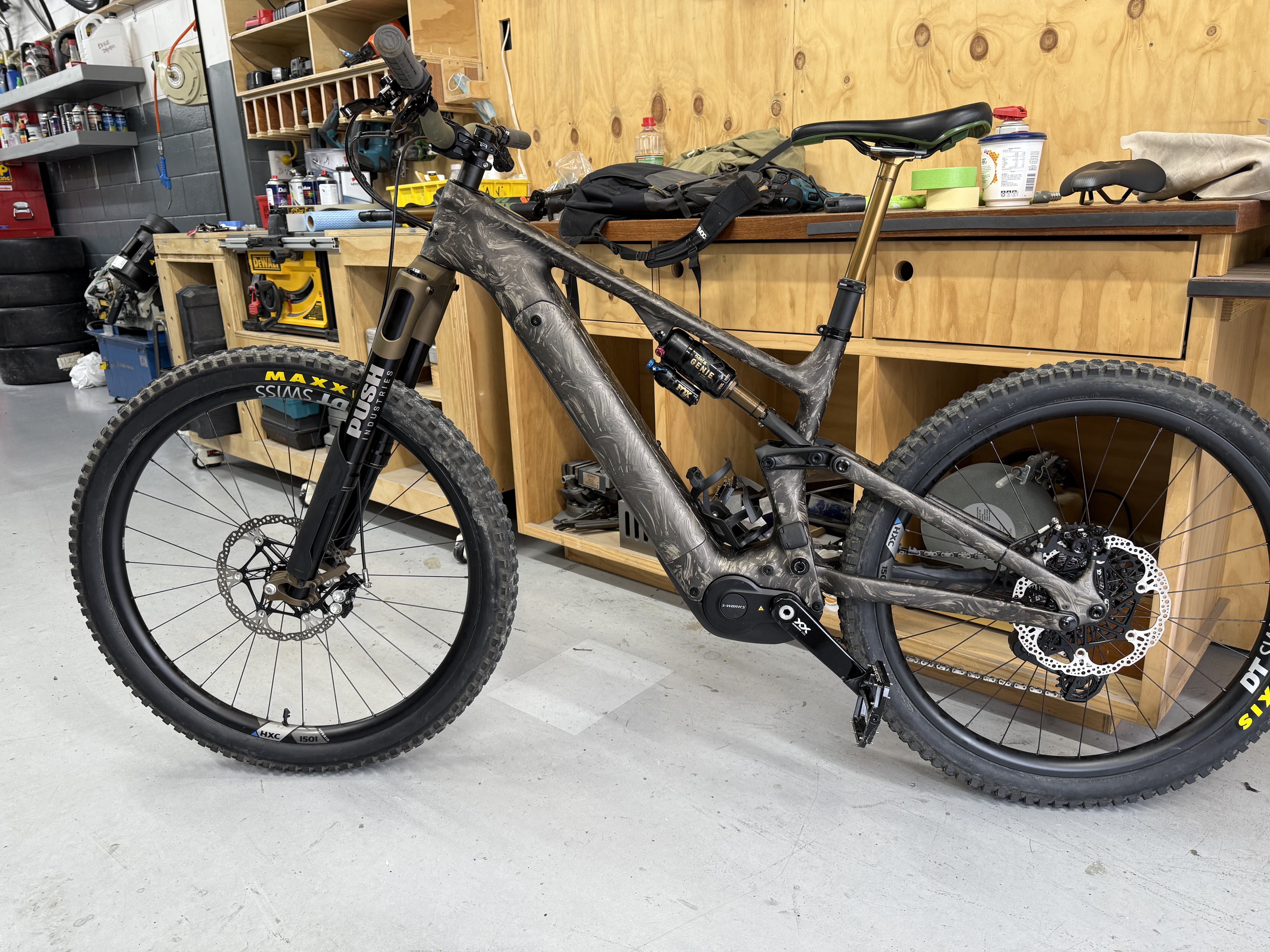

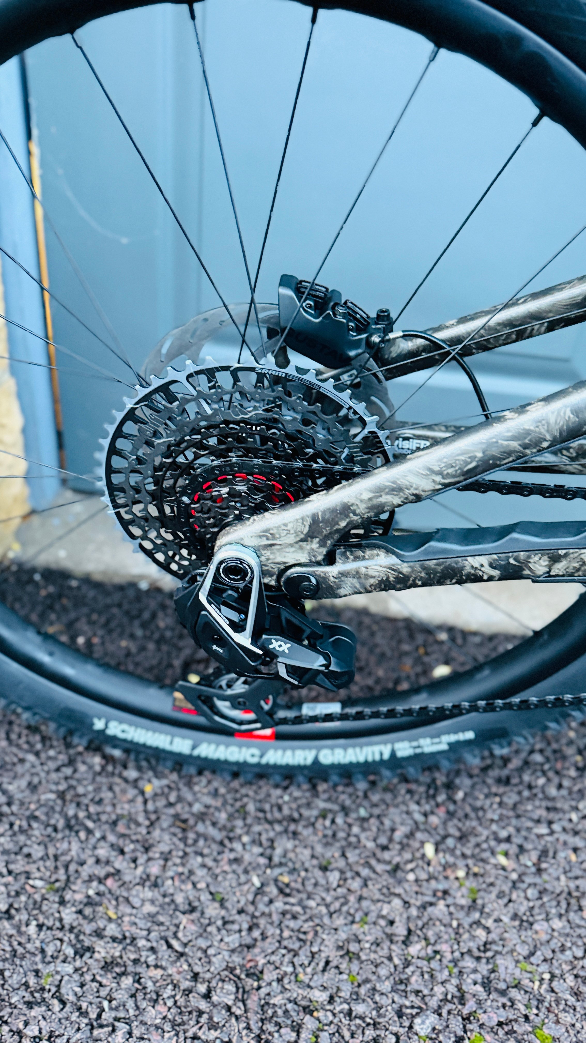

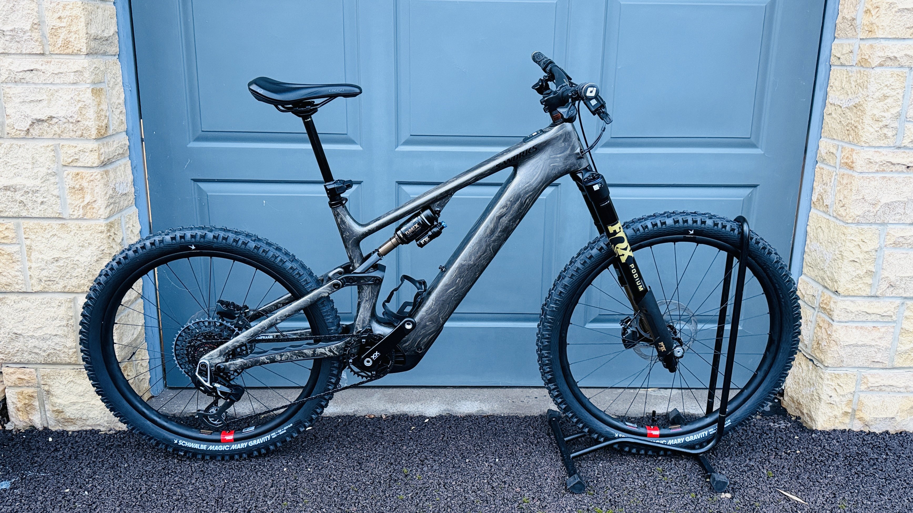

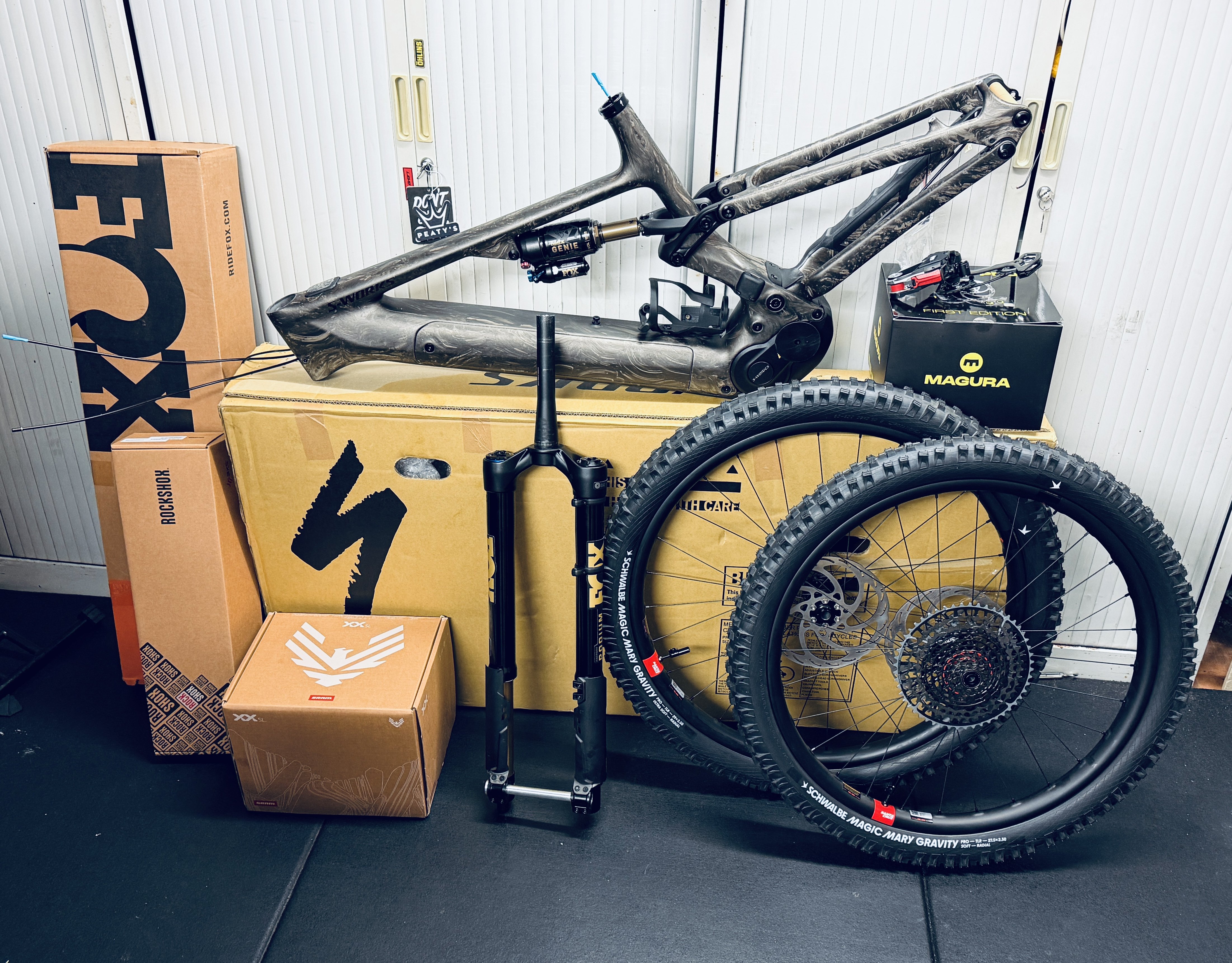

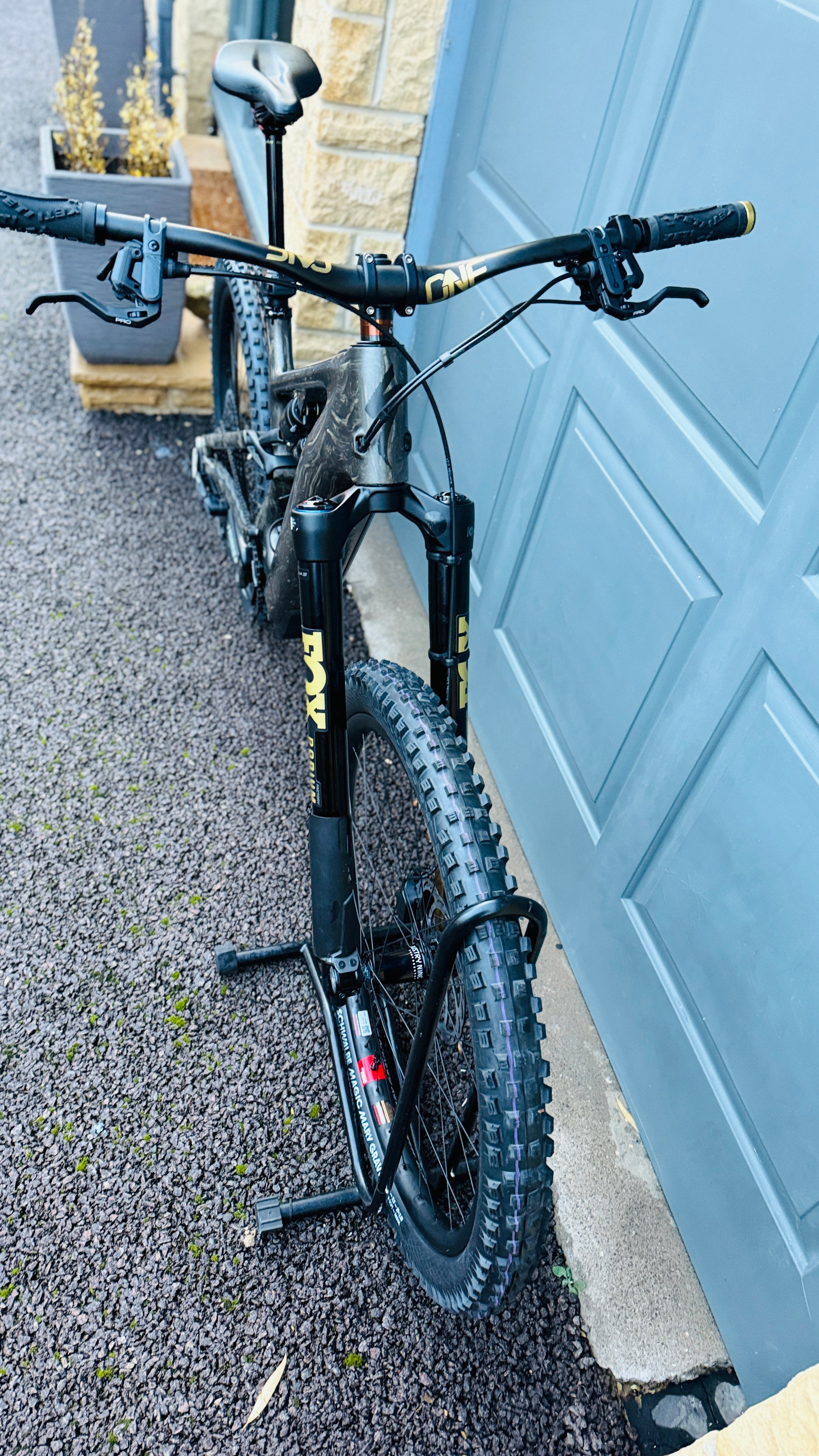

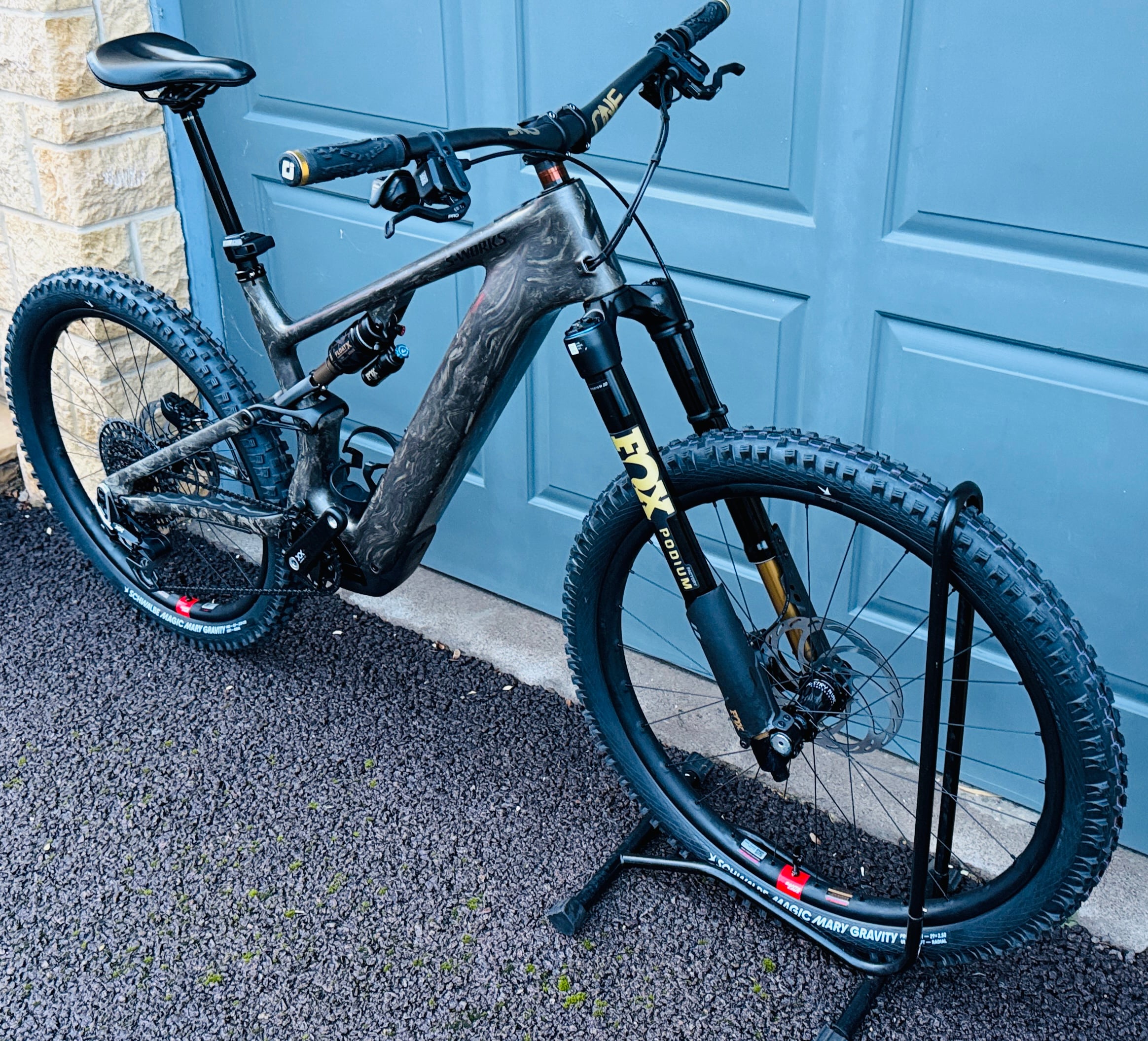

Managed to get my hands on the last S Works S5 Frameset from Chris and the legends at Berkshire Cycles Co and have collected some parts ready for this build. 8 weeks ago I had a total hip replacement and coming from gen 1, 2 and 3 x Gen 3 S-Works Levos, then an Amflow…. I am pleased to be back on a Specialized Bicycles for my rehab back to riding.
Spec is -
SRAM XXSL T Type Groupset.
Fox Podium Factory 170mm
26’ SRAM Reverb AXS.
Santa Cruz Reserve Carbon 30HD on I9 Hydra Hubs & Schwalbe Radial Marys
One Up Carbon V2 bars and Stem

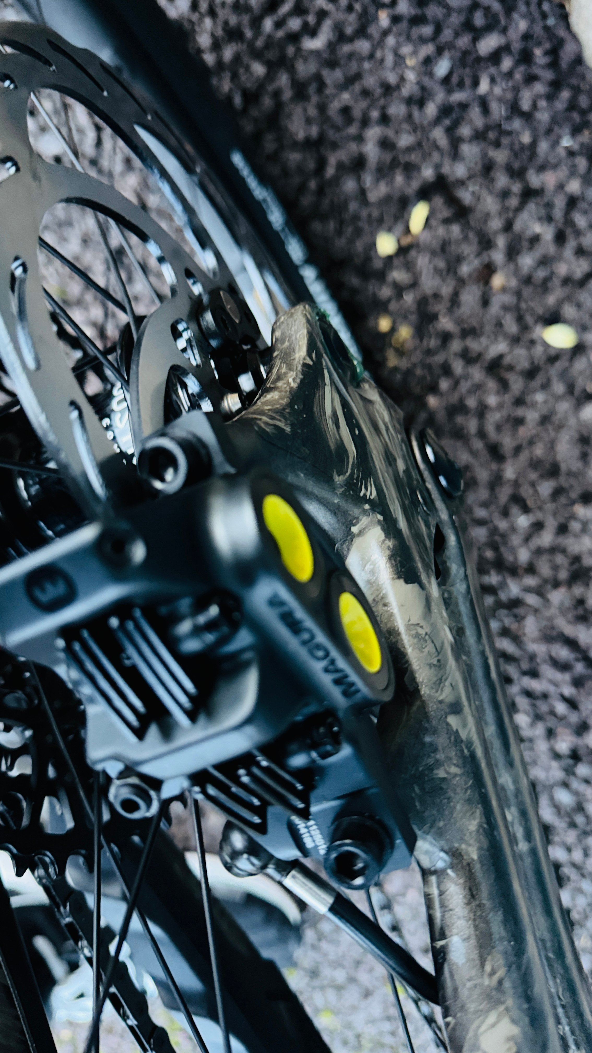

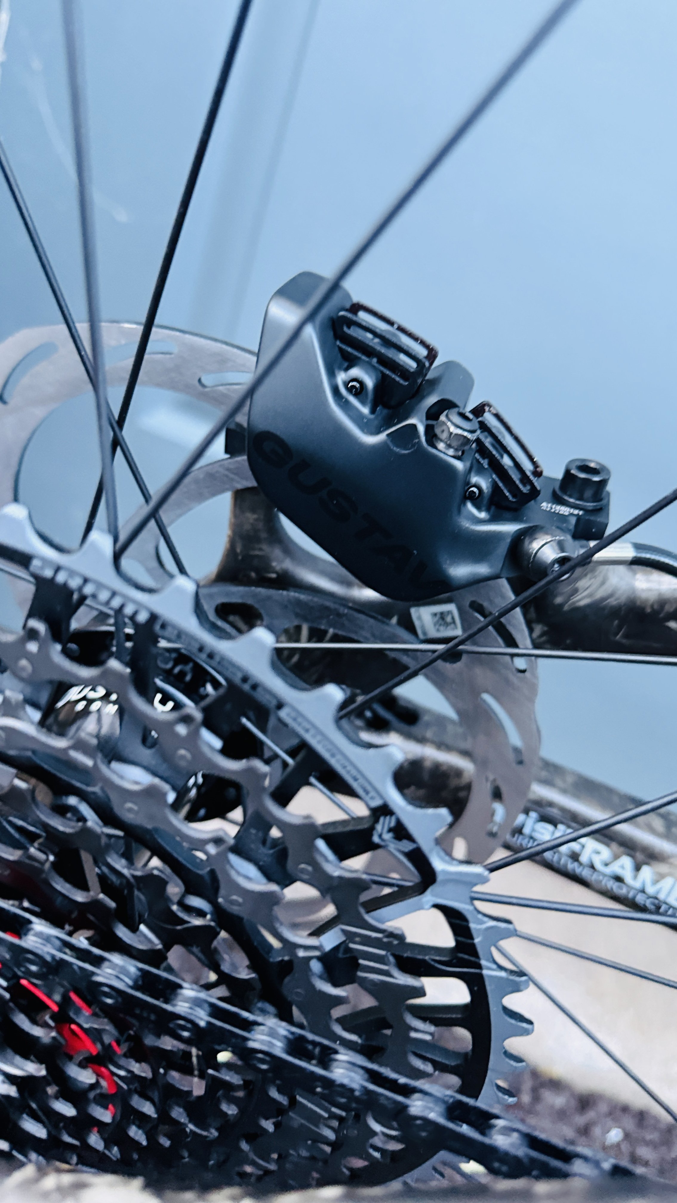

Magura Gustav Pro 1st Edition Brakeset
Second S Works Gen 4 frame only build I have done, but this one is mine and I am looking forward to getting some mileage under my belt

Remove those grips, or you will be banned from the forum for life!!
Other than that......Great build!!
Nice except Magura.
Had them on last 2 bikes, best brakes I've run, recently ncluding MT7's, Hope V4's, Maven Ultimate Limited (Red) and Trickstuff Maxima. As a bigger rider, on a heavyish bike, these things slow, give good modulation and have never overheated, something the others cannot say. Horses for courses, but for me they are great.
