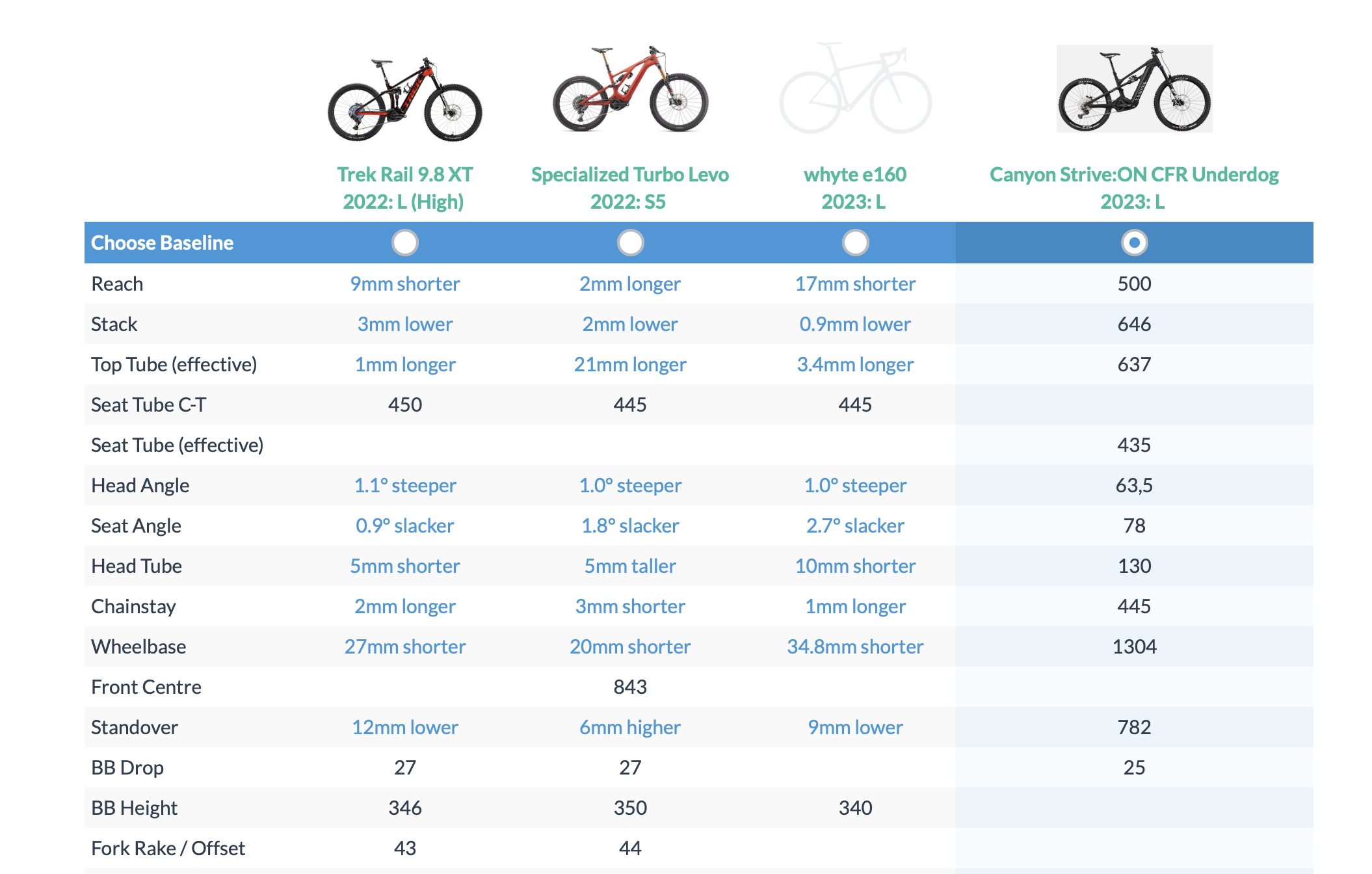

Ignore the size tag and go on Geo. Large has a 500 reach which is definitely long compared to other larges.
Its almost as if the Strive:On relative sizes to other ebikes are M / L / XL / XXL and a Small doesn't exist...
Compared to other ebikes mentioned above, the L is similar in reach to S5 levo!!
