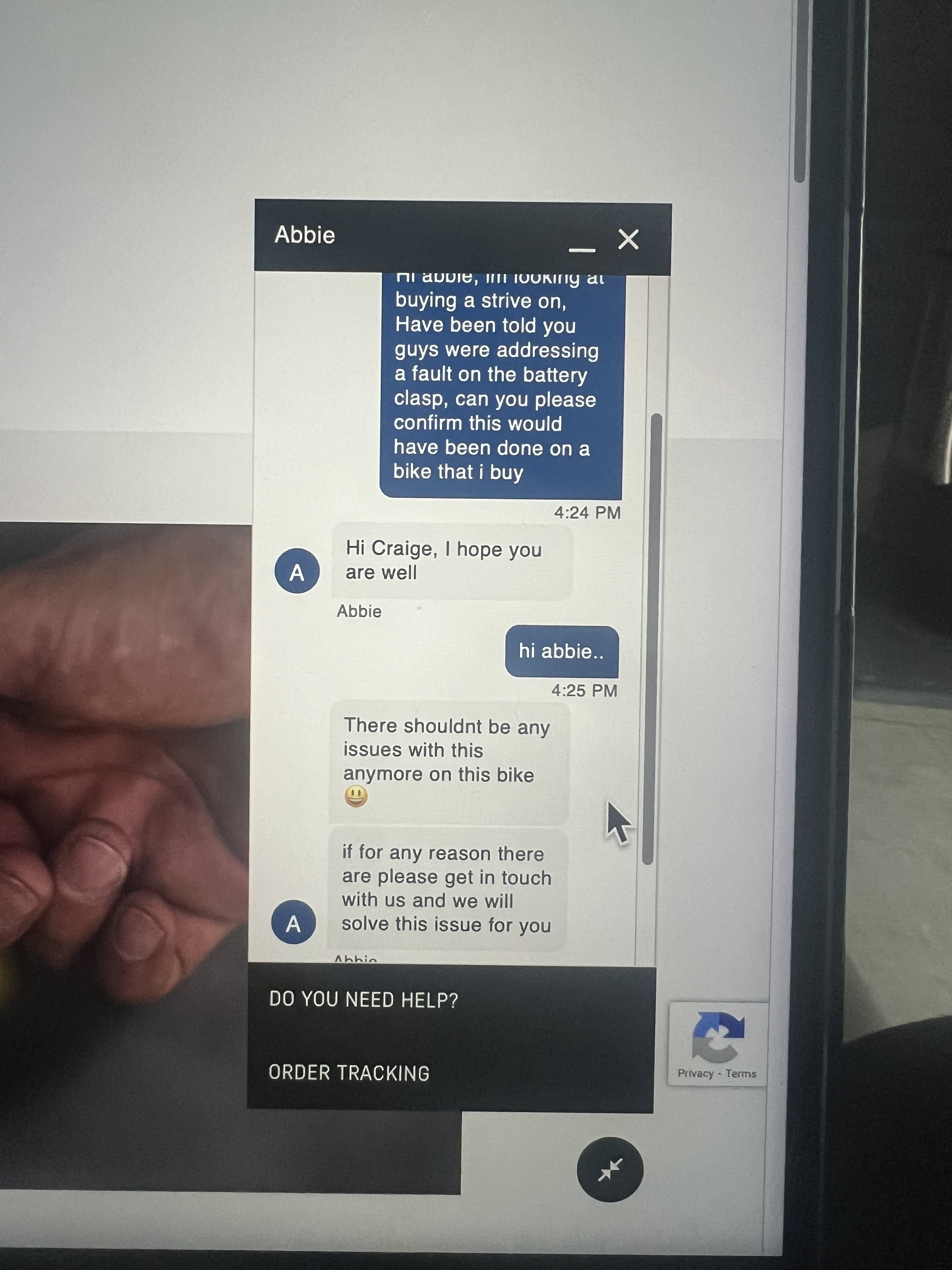

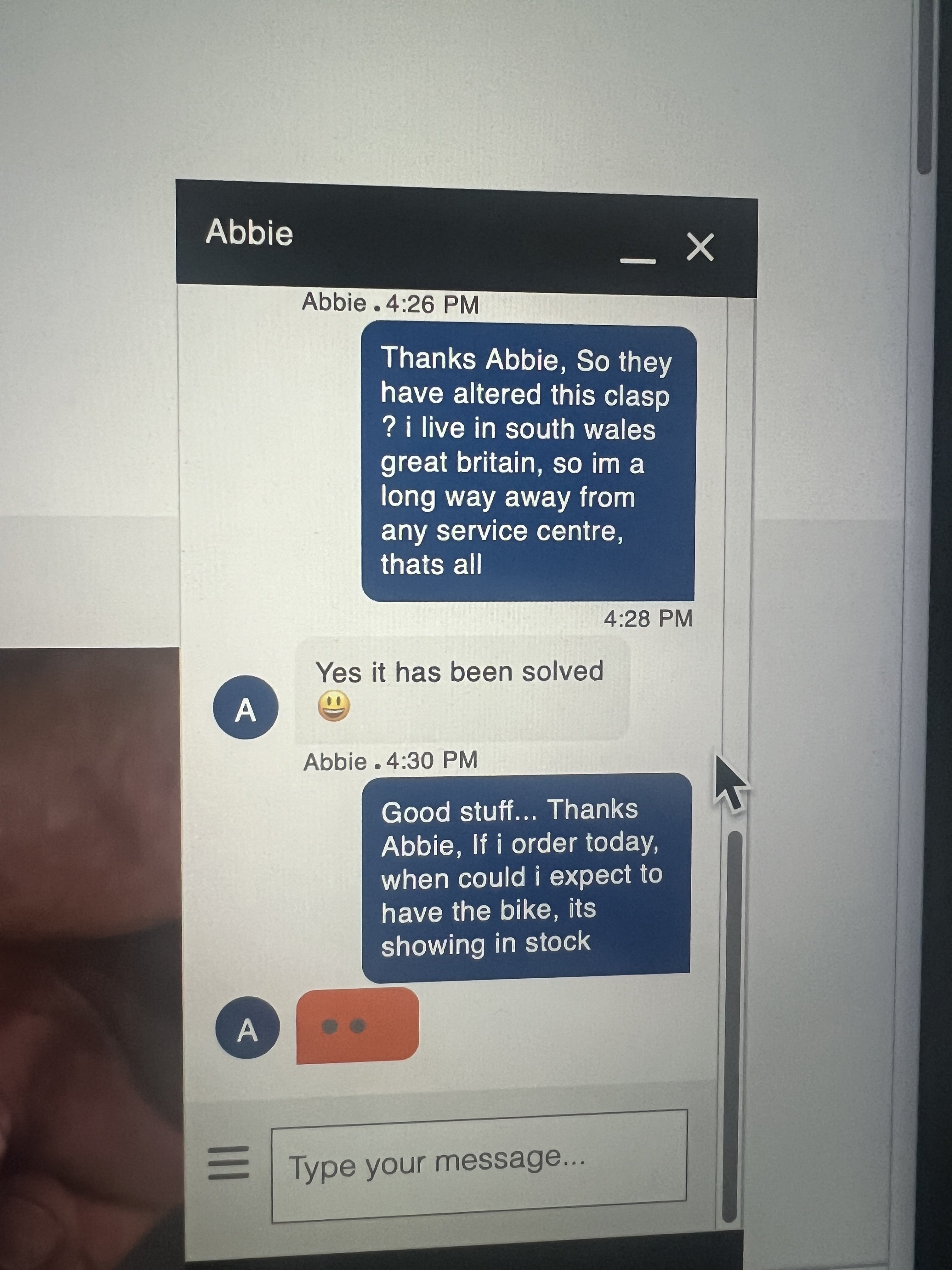

Ordered my strive yesterday, Chatted with Canyon who assured me the battery latch has been sorted..

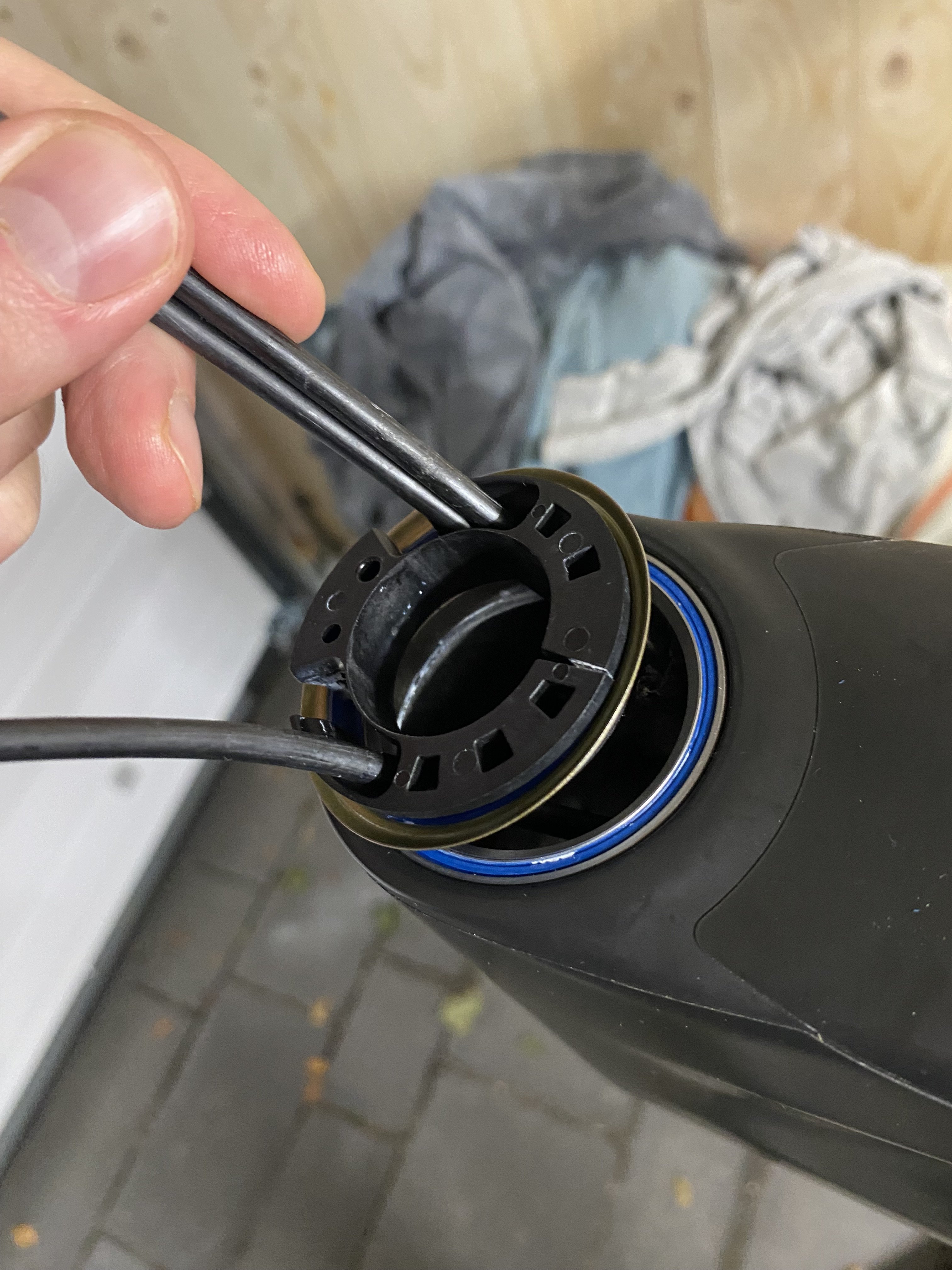

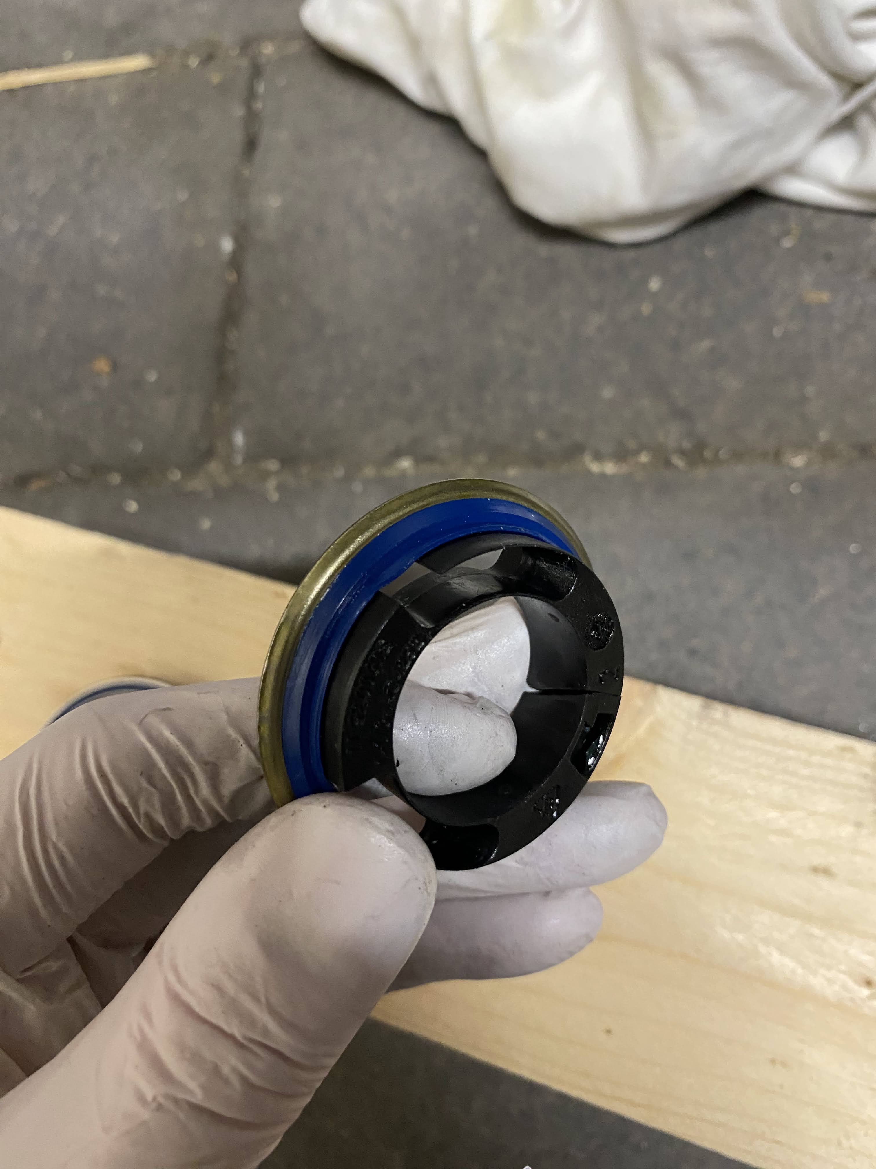

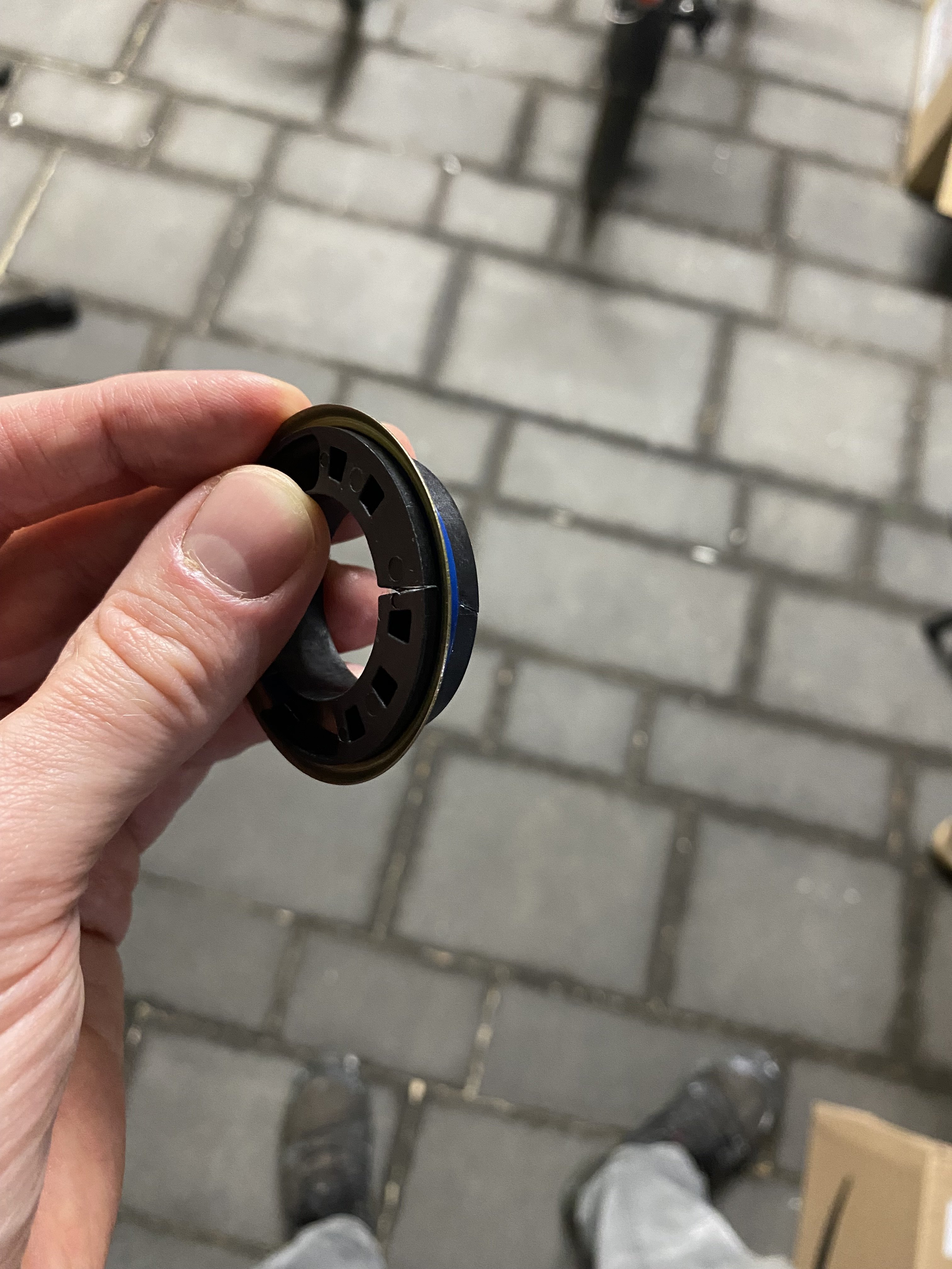

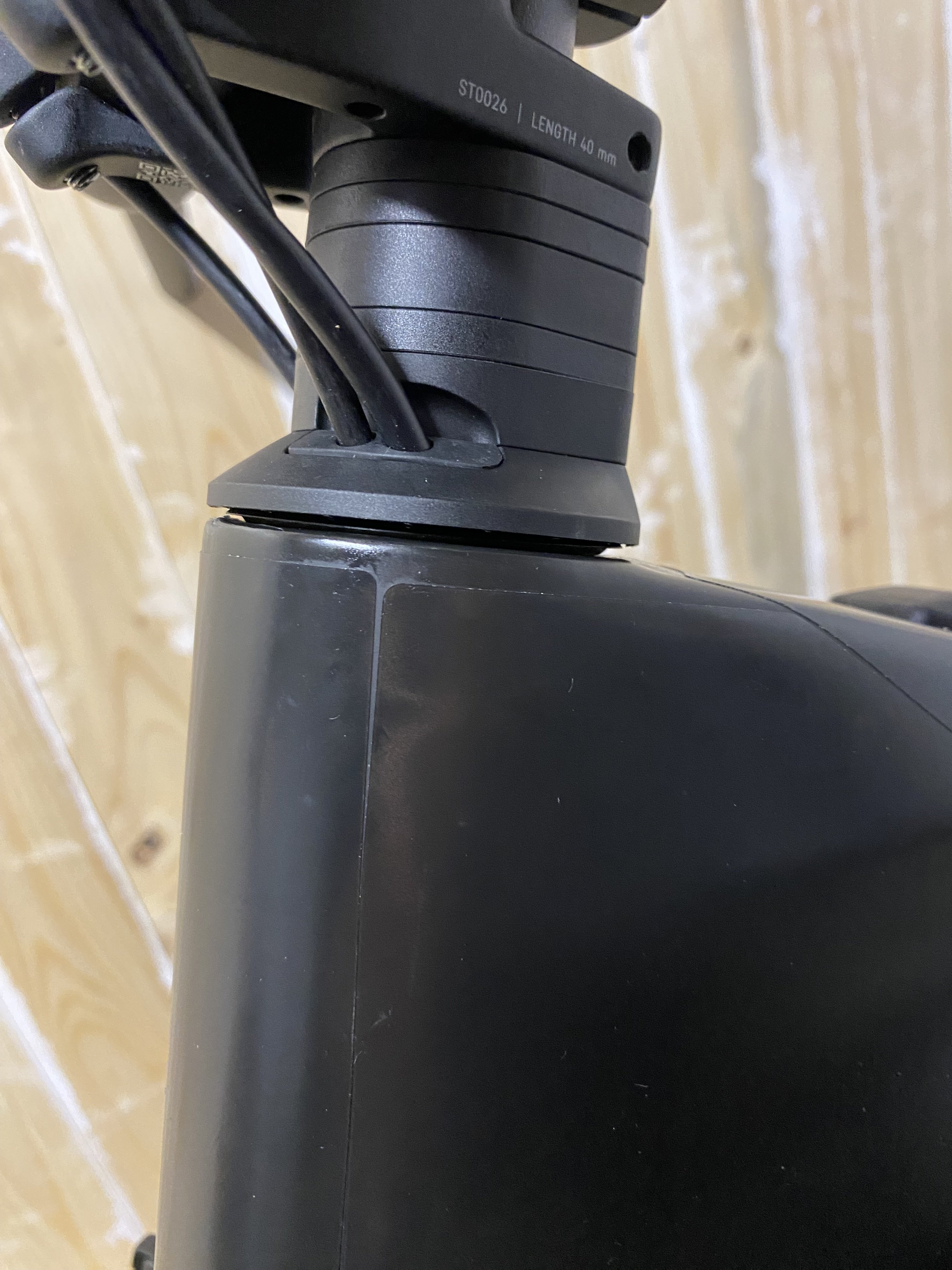

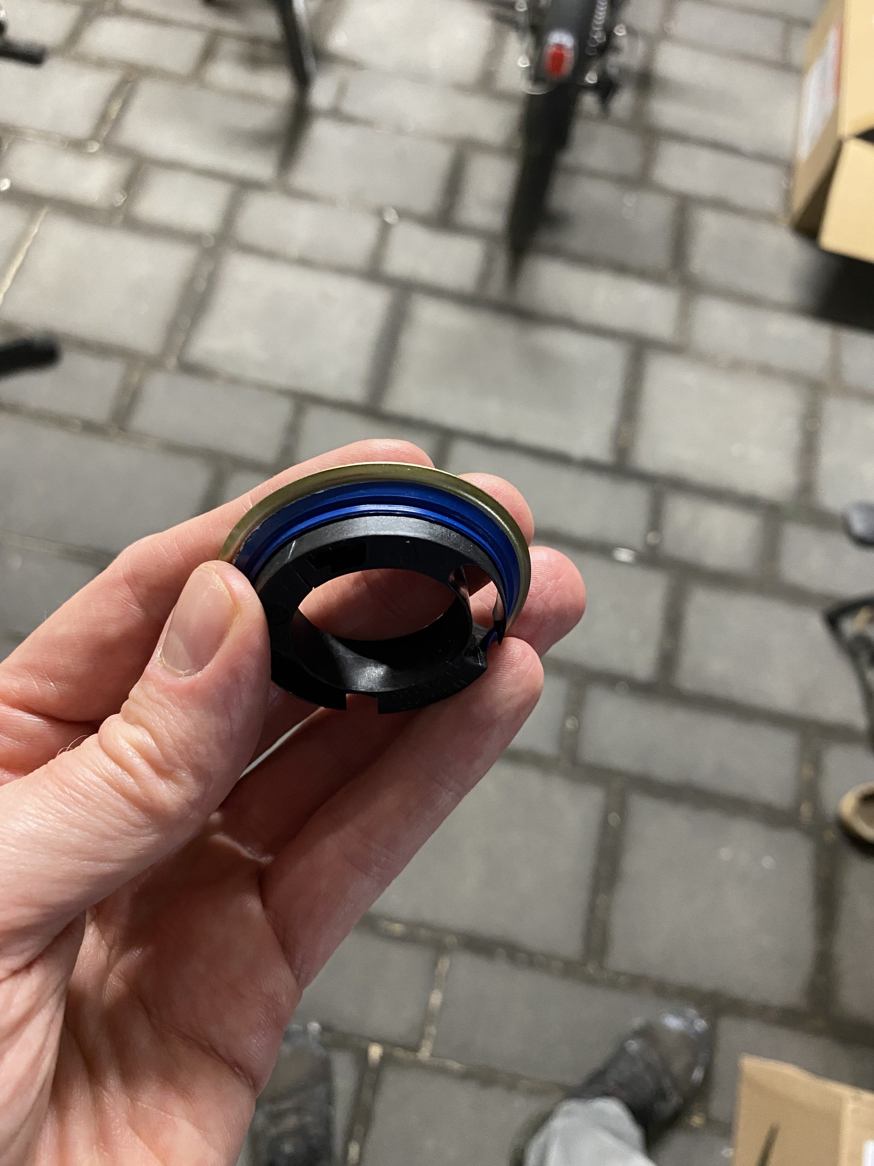

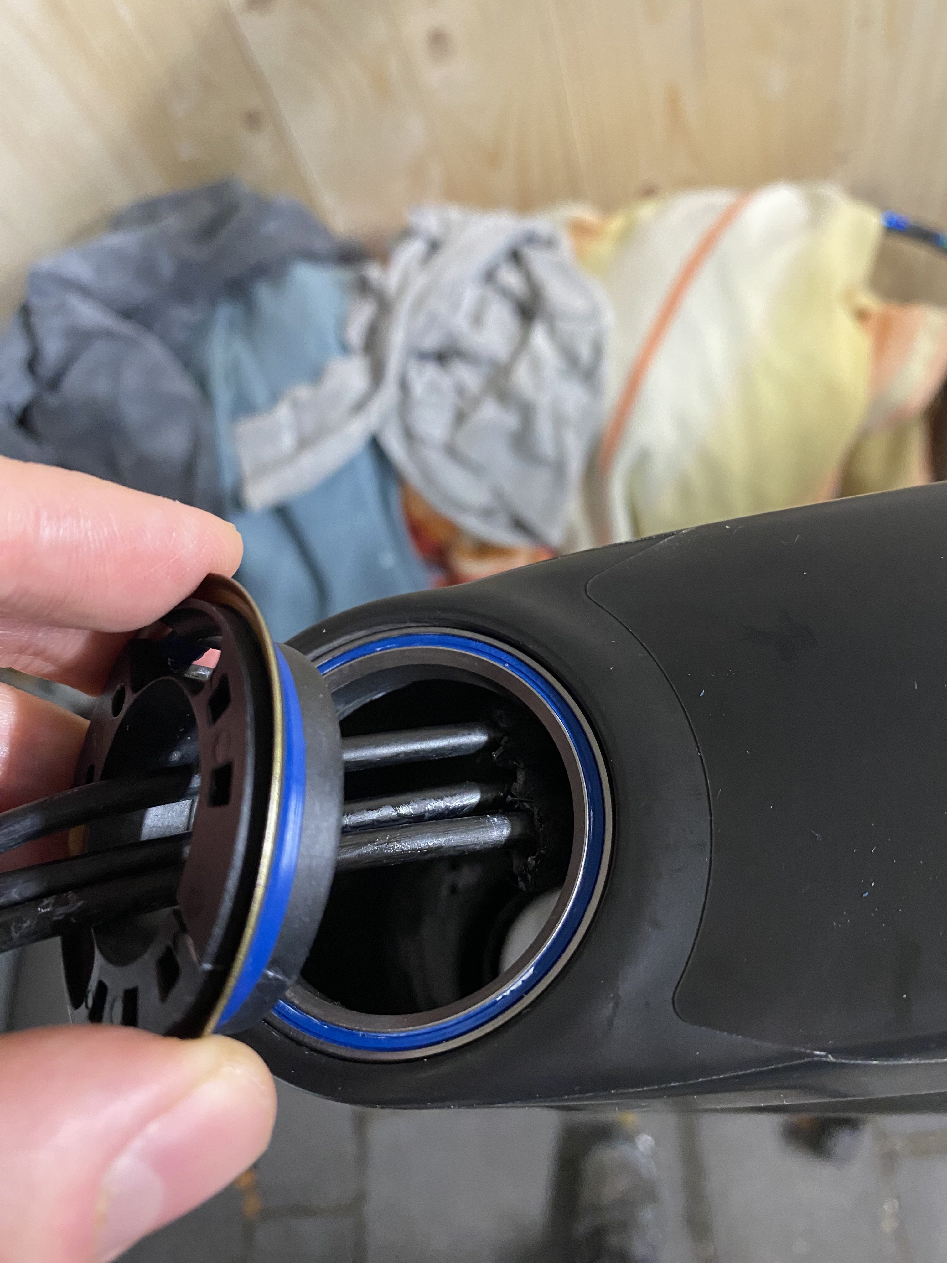

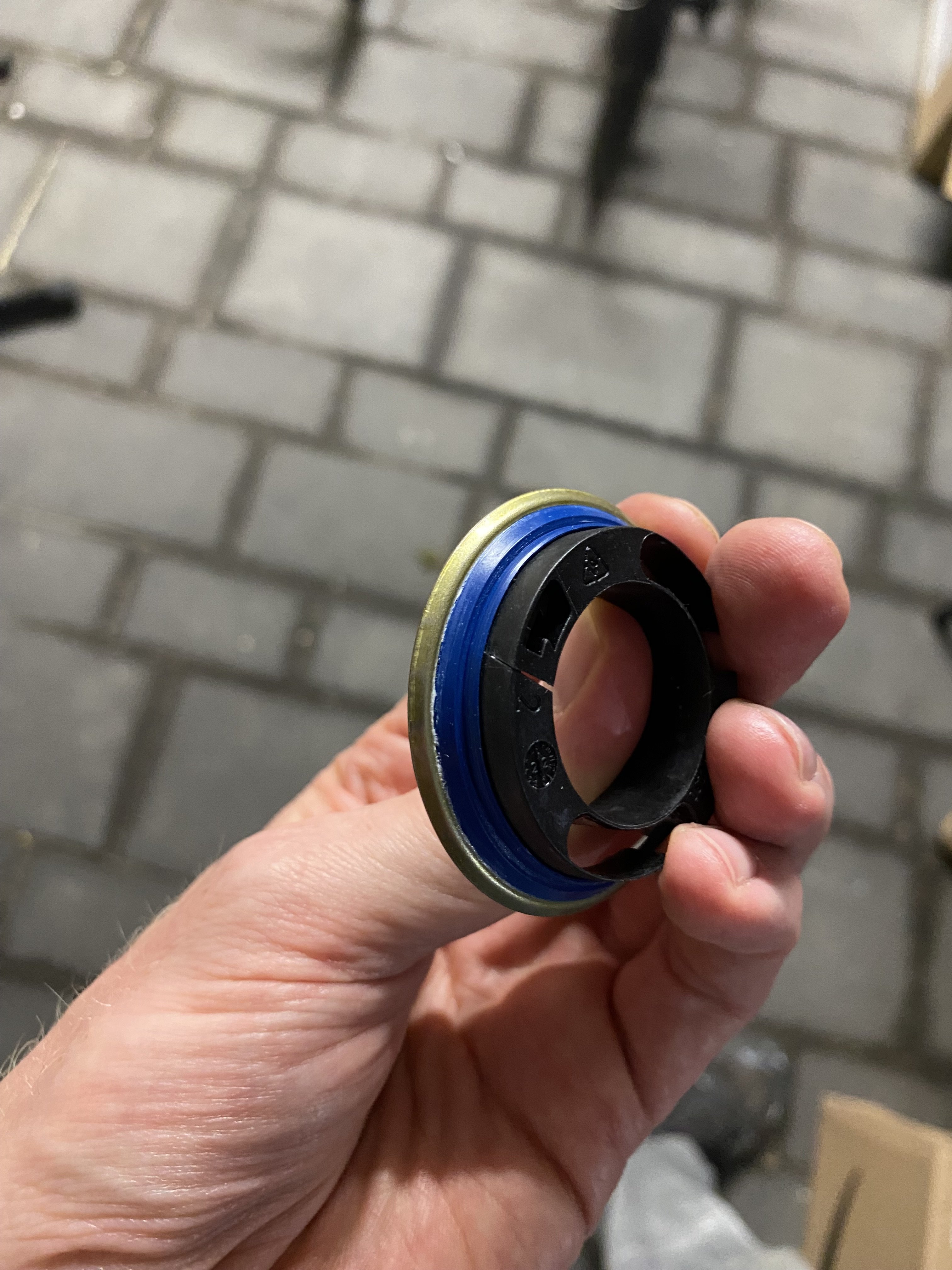

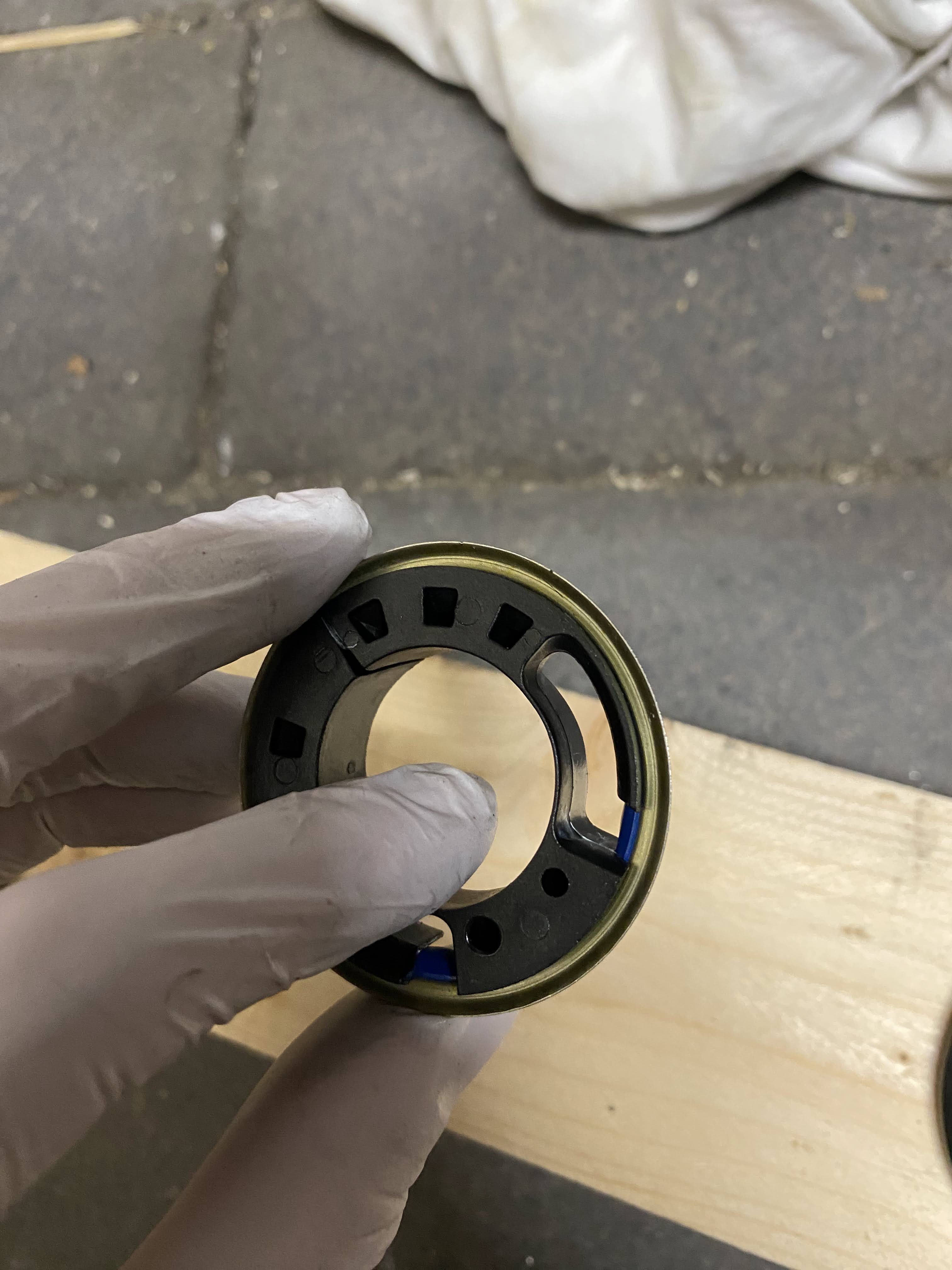

Could anyone be so kind and tell me, of this is the correct way to fit the upper bearing, seal and plastic cap?
I‘m not 100% shure, cause the gap between the last sealing cap an the frame is so big now
(Please dont think about the spacers, have to cut the steerer tube)
From memory that gap looks too big to me but I'll check mine this evening before I go out and let you know.
Have you got the top cap bolt tight enough and is everything you took out back in the same place?
yes, the bolt is tight.
Not 100% shure about the blue seal. Hope ii got it the right way in.
And are the top and bottom bearing the same, or are they different?
I would not trust that at all. Companies and especially customer support have a habit of giving inaccurate information all the time.
But please let us know how it goes. I hope you get a bike where it has been sorted and maybe you can let us know in what way they fixed it.

Yes, Well i gat a "i has been resolved" so we will have to wait and see, just had my "its been shipped from ups so Shouldent be too much longer neither
