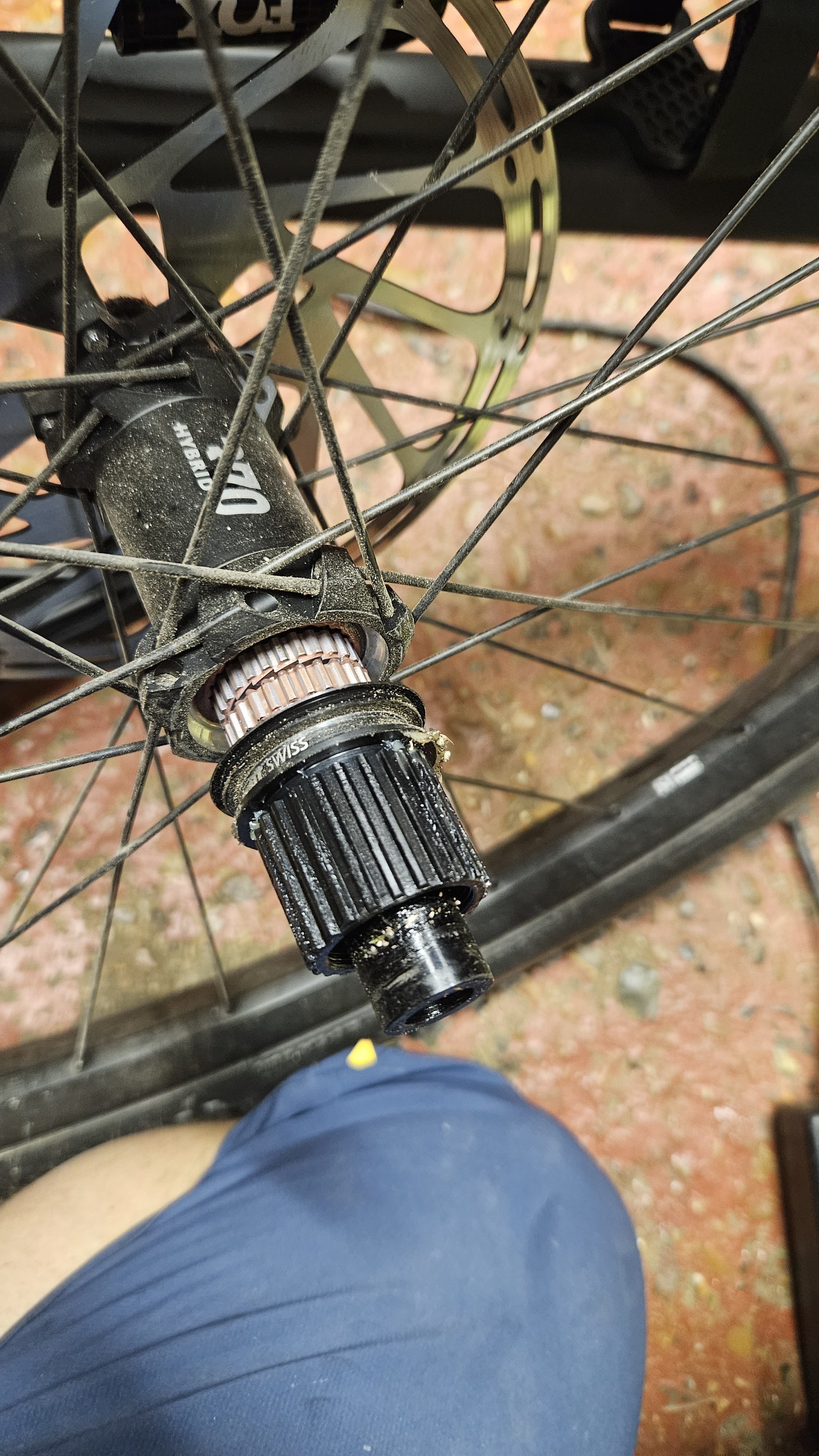

The DT H1900 wheels have the ratchet system already installed. I thought they came with pawls. Noticed when I removed the wheel protector disc thing.

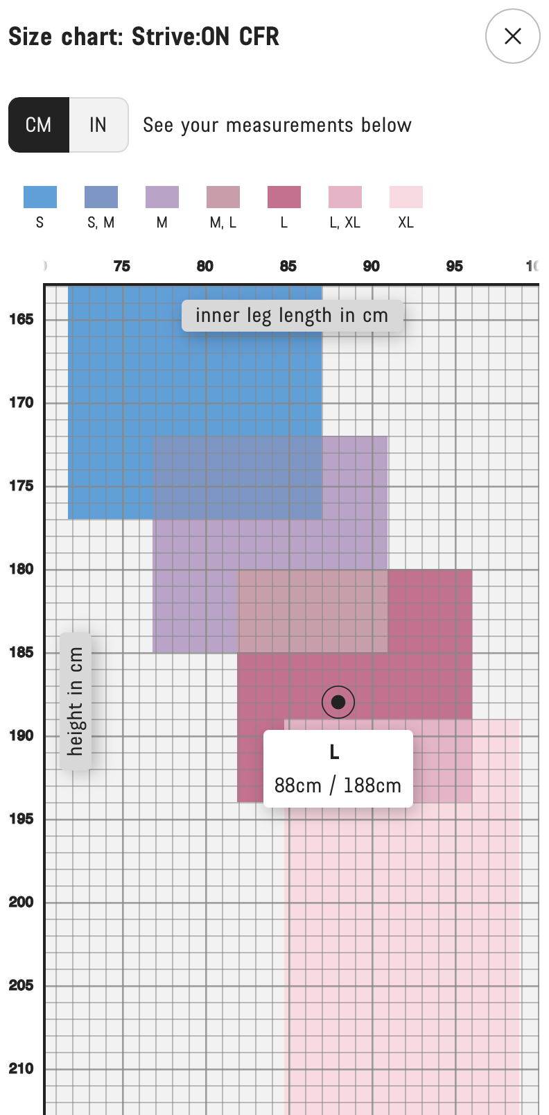

I'm a tad over 6'2 (~188 cm - 88cm inner leg). I've been riding my Large Calibre Bossnut Evo for 5 years and always found it a bit too small and wished I'd gone XL, though I sat on a large YT Decoy recently and that felt like a good size. I put my inner leg length and height into the Canyon website and it recommends a large, but thought it was worth checking the experience of you guys
Anyone my height got any opinions on whether to go L or XL?
There is also size chart in Canyon website where calculator recommendations are based. Hope that helps with deciding size.

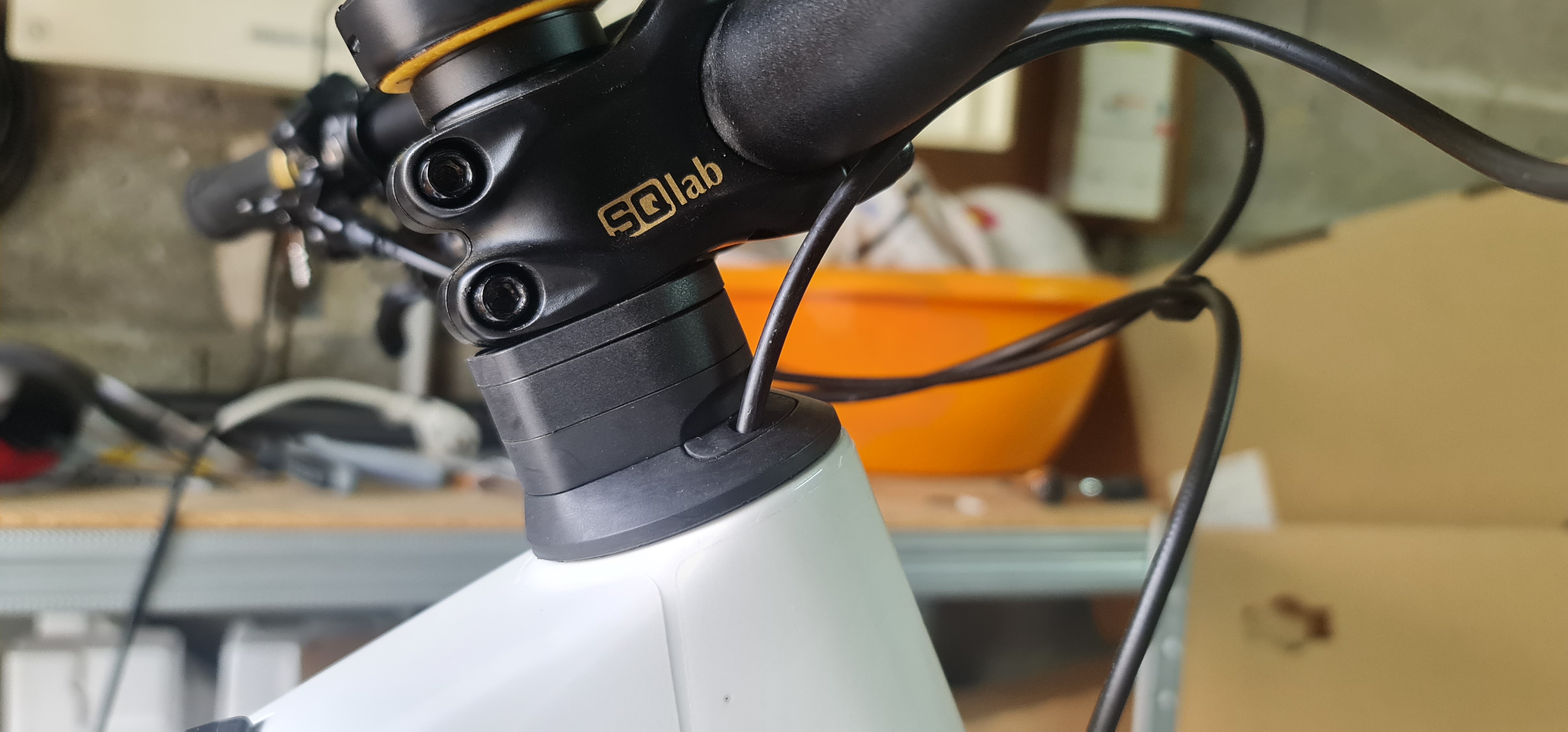

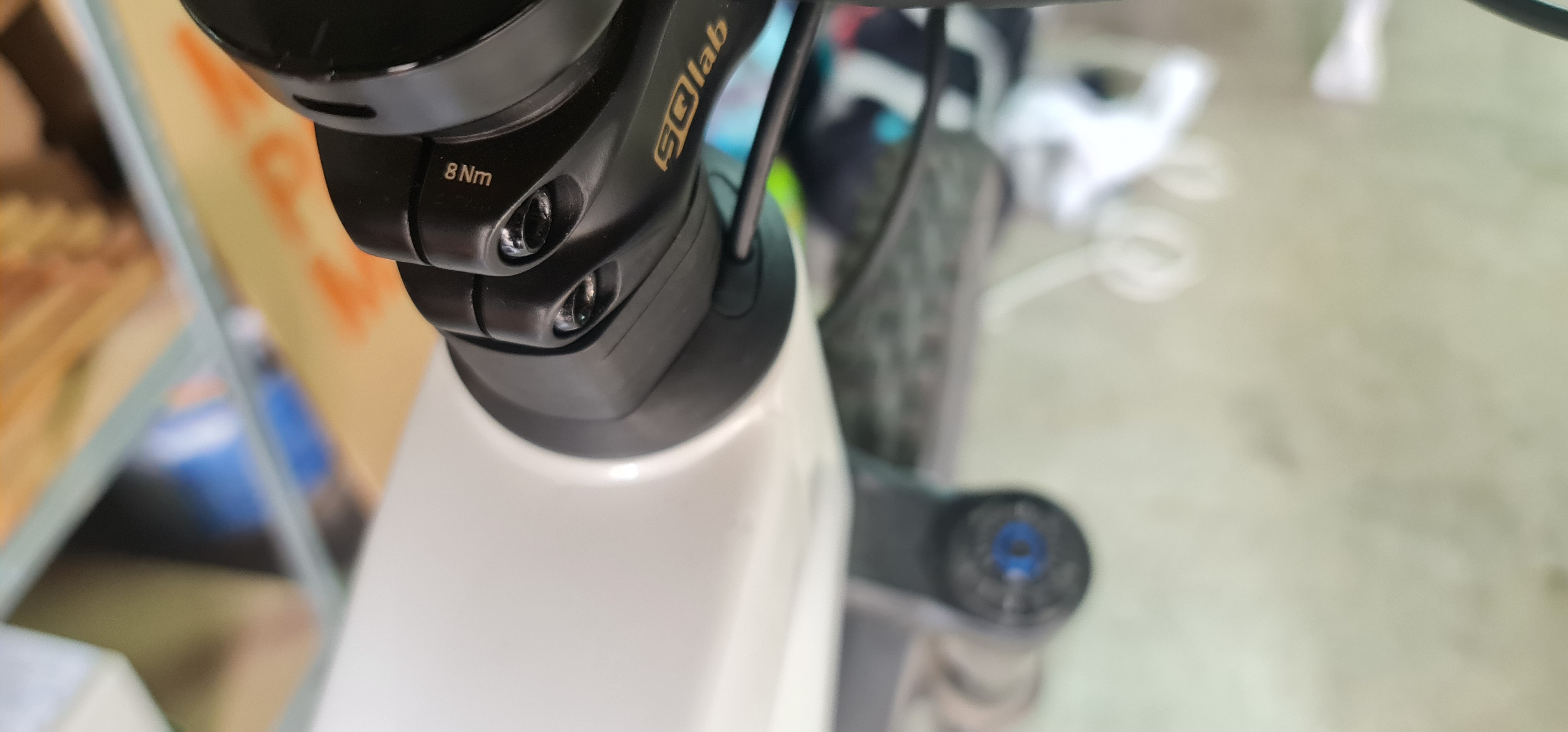

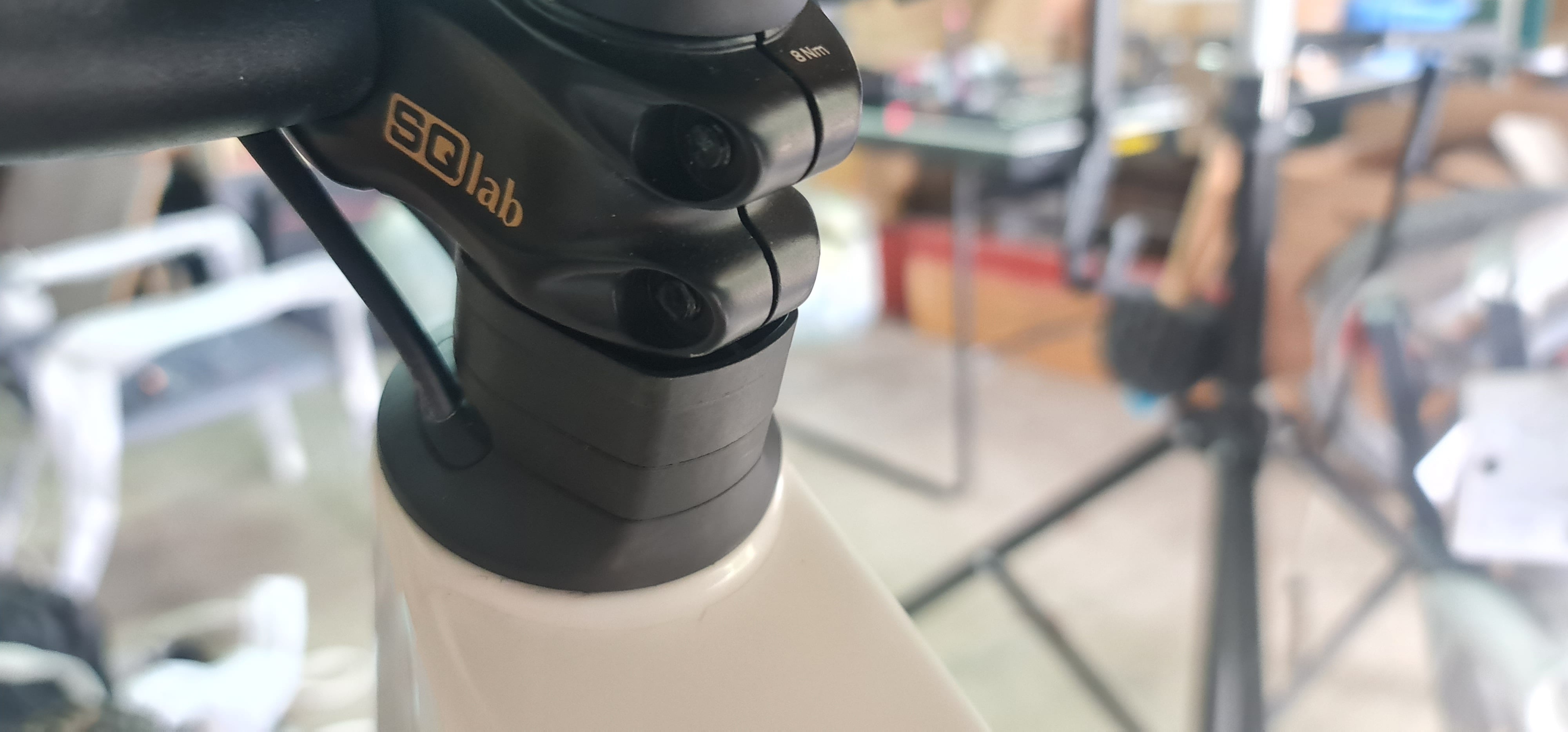

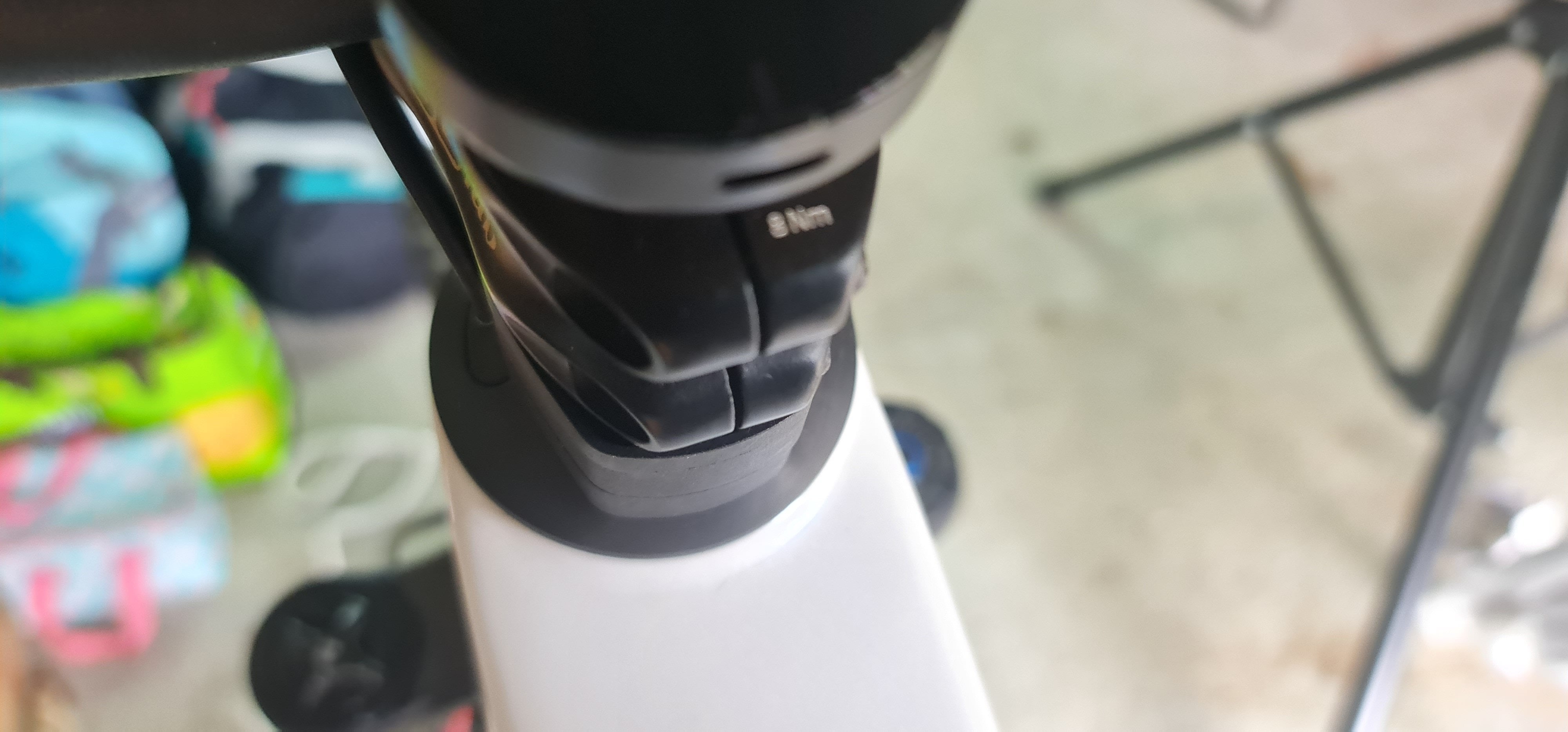

Does anyone know if there are any issues replacing the stem with an aftermarket one? The spacers look to be a different shape to the usual round ones you usually have between the headset and stem. Am waiting for my strive on to arrive but am wanting to upgrade the stem and bars quickly
There are some, since the spacers do have small plastic pins on top of them (and small holes at the bottom) so they can perfectly align.
With that said, I did replace the stem on mine, you just need to sand the top spacer (the one jthat will be just under your stem) to make sure to remove those pins and make it level ;)
Cheers for the info, so I take it the pins on the top spacer fit into the stem that comes with the strive on, but won’t on an aftermarket one ?
That's right ... initially didn't noticed when putting the stem on at first, but then it got pretty wobbly up there and noticed that those created an extra space where the stem couldn't rest on the top spacer due to those ...
They're just plastic tho, so pretty easy to sand to get back to level (I did order extra spacers tho so that I can still put back the original stem if need be)

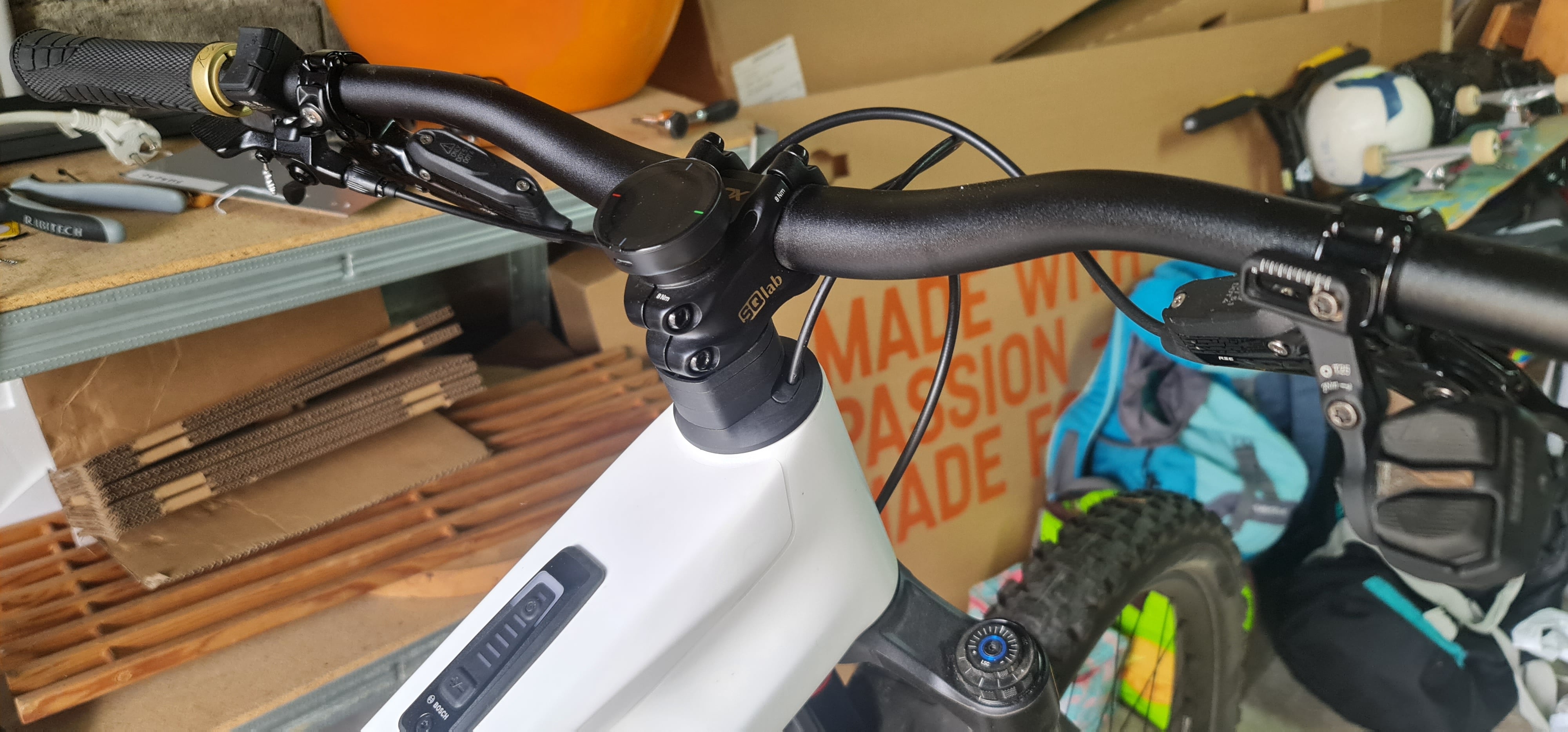

Cheers for the confirmation, was planning on doing the same and ordering a spare set. Does it look ok with a 3rd party stem and those spacers on or do they stick out a bit, etc ? If you could put a photo of yours on so I can see how it looks I would appreciate it 👍
sure, here's a few pictures from different angles ... you can notice that it's not perfectly aligned to the spacers as the canyon stem would be, yet it doesn't break the aesthetics or aerodynamism of it either ;)
20230829_133339.jpg 20230829_133237.jpg 20230829_133230.jpg 20230829_133334.jpg 20230829_133255.jpg
one more thing, the standard stem cap from Canyon will likely not work with/fit your new stem (and my stem came without a cap). In my case I replaced the cap with my bike computer mount but you may have to get a stem cap separately as well ;)

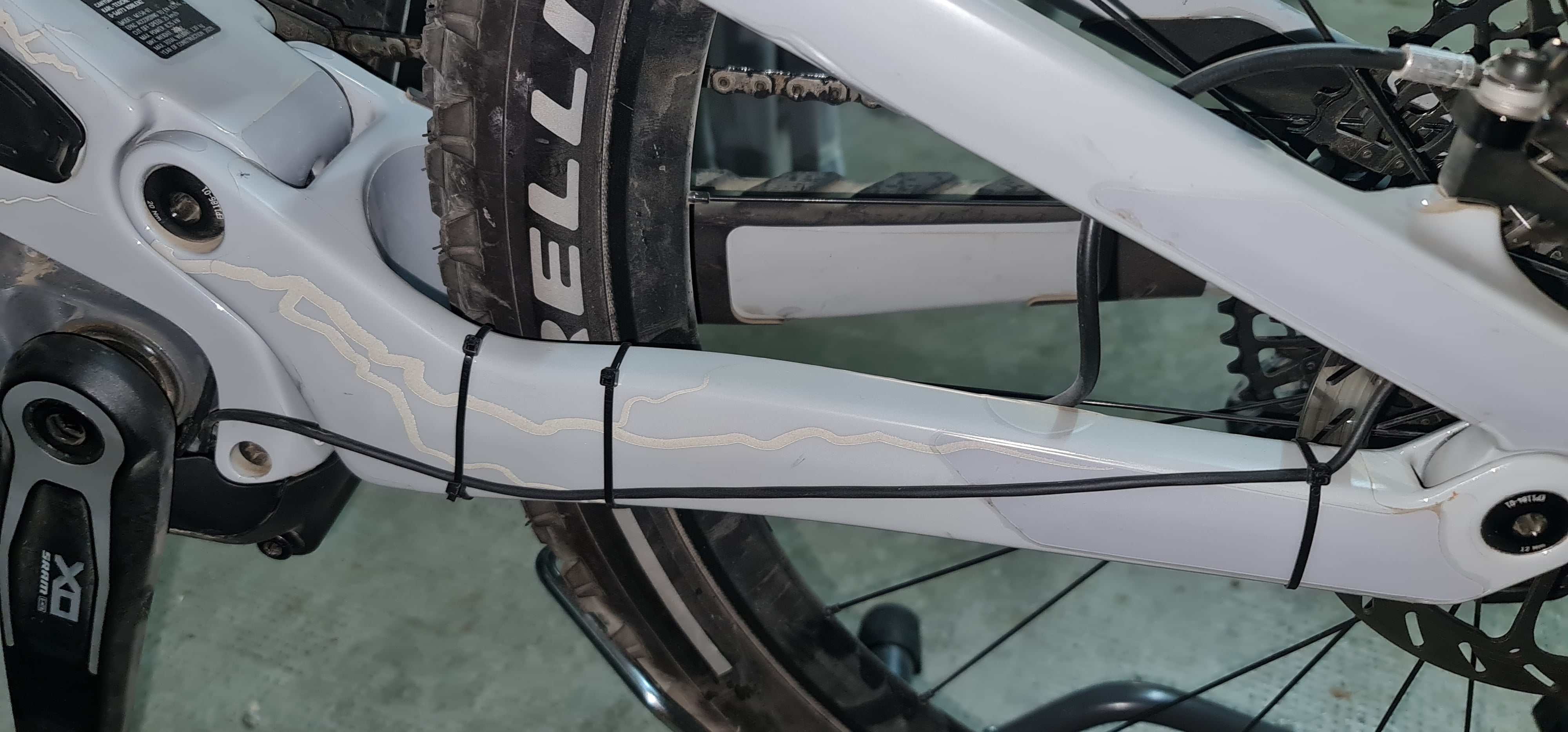

Where did you pass the cable for the disc magnet? I also have a Megabobra but not yet instal

Megabobra (from this very forum) is a device created by @megabobra (plans and code are available so you can do it yourself)
@Mars2 my first implementation is a bit ghetto but works well (pic attached) ... planning to try and put in inside the chainstay tube at some point since there's a hole in the back of the rear triangle to route it to the motor (possibly moving it to the right side and using a spoke magnet so I can use the empty hole on that side of the chainstay)
