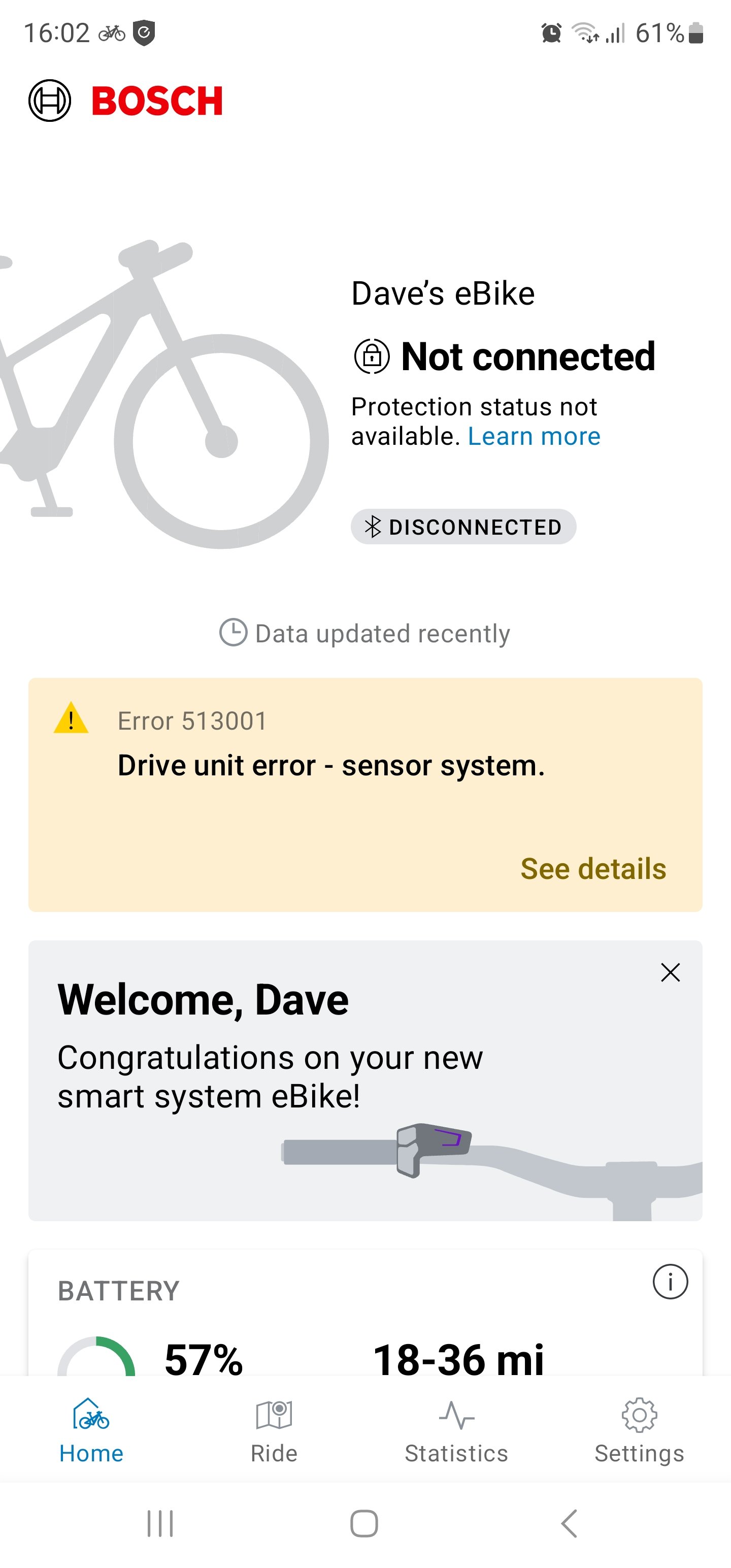

Has anyone else had problems with the battery cutting off and the whole system shutting down?
For me, it started two days ago, and yesterday it just kept switching off.
Sometimes it would turn on for a brief moment and then die after that.
On other occasions, it doesn't even power up and shuts down immediately.
Canyon Strive:ON CFR battery cutting off while riding on minor bumps
Canyon Strive:ON CFR battery cutting off when stationary

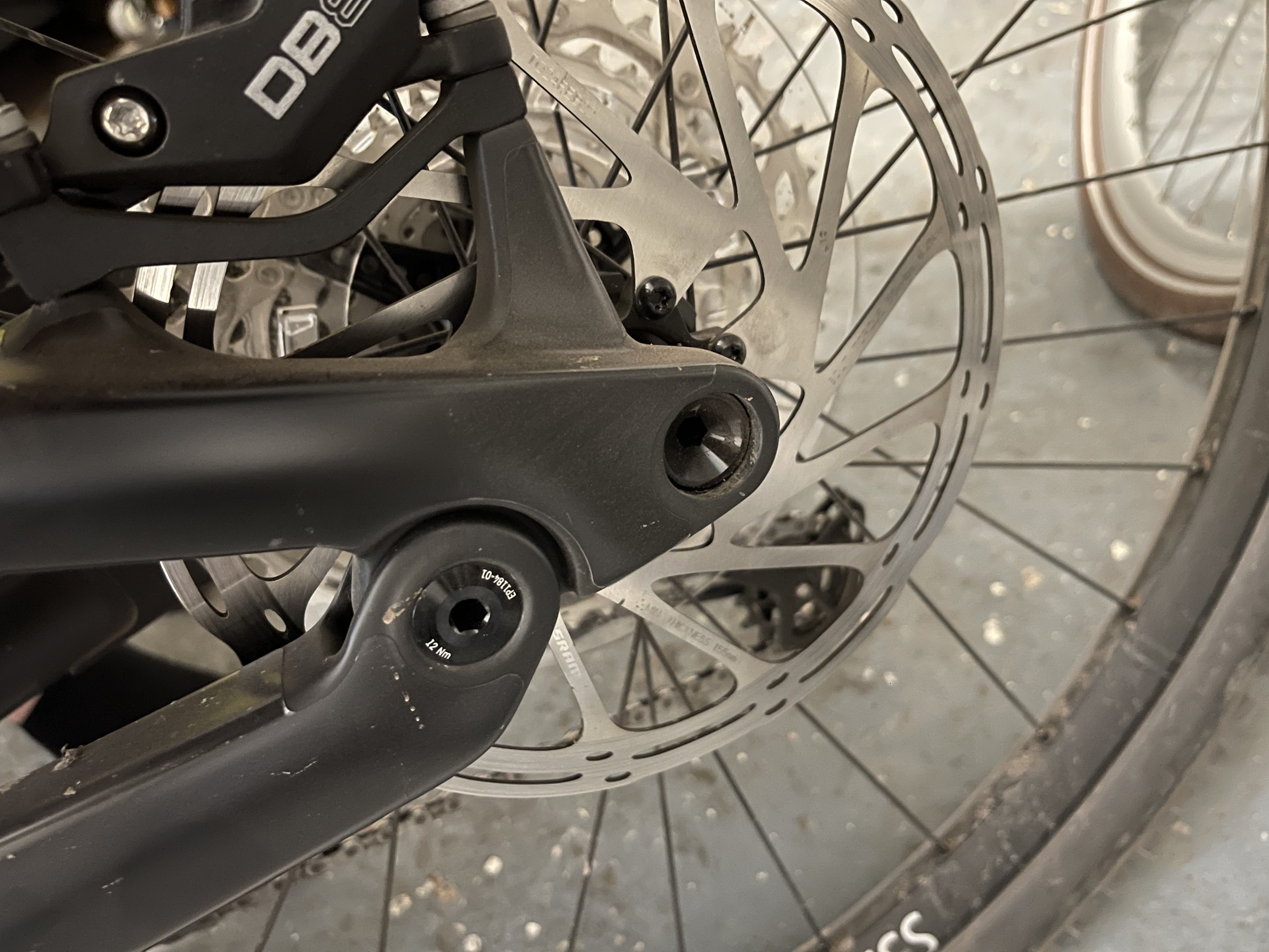

My rear thru axle is also completely seized presumably through over tightening at the factory (I've only had a 2 days) but that's a different issue...

Mine started the same way, with brief cut-offs for a split second, and now it would turn off completely while riding.
In the beginning, it was noticeable only in turbo mode.

Yeah, I did it twice, but no luck. Do you have a photo of the latch and how far you can push it?

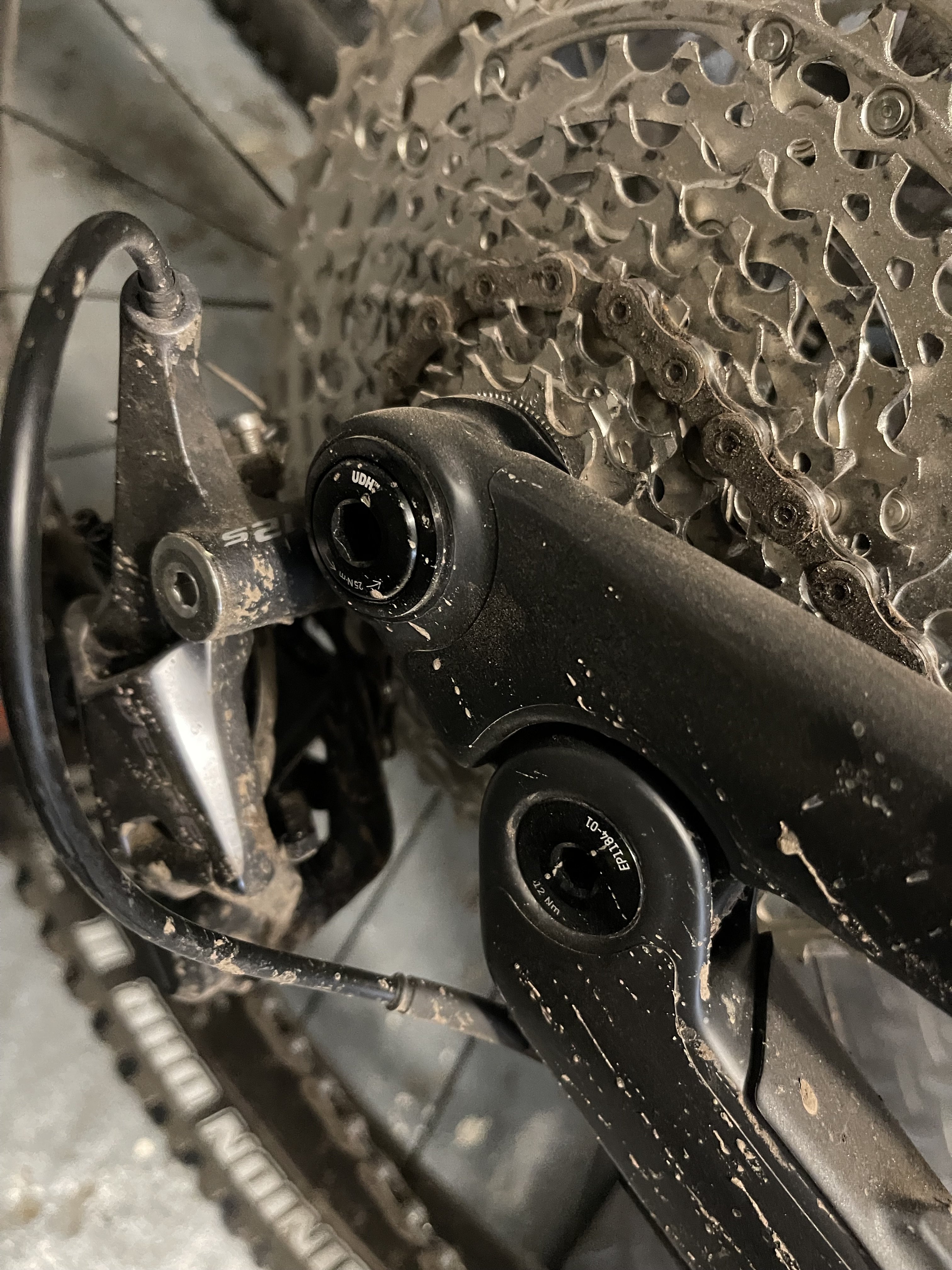

Assume you’re unwinding from the correct side? There is what looks like an axle on both sides but the actual axle is on the brake caliper side. The other side tightens anti clockwise so trying to undo actually tightens
Side to unwind
Not this one

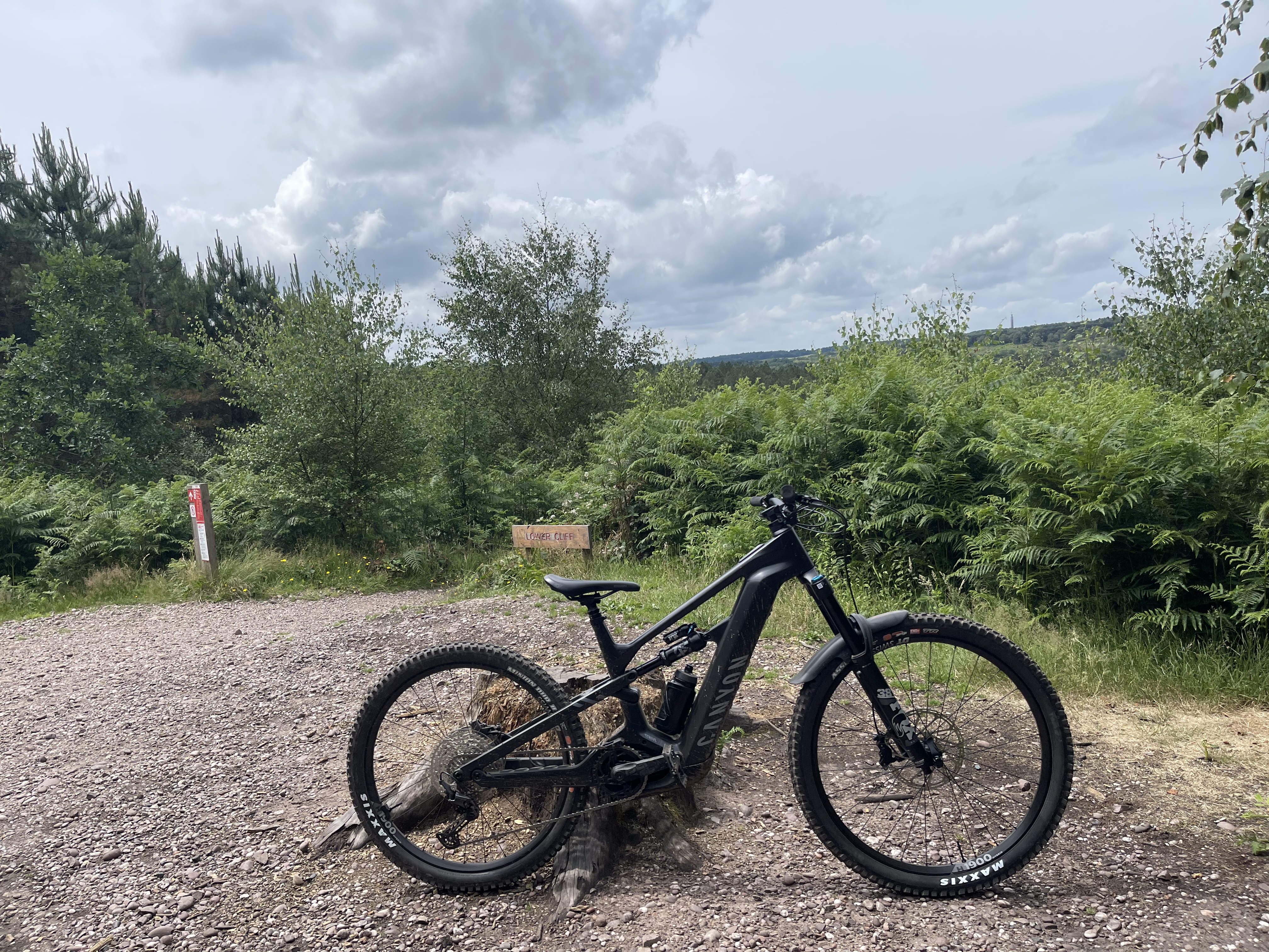

A few more observations from a loop of the monkey and follow the dog at Cannock.
It’s fun everywhere, agile and super capable. Rolls over the rock gardens much better than my old 27.5 plus front wheel. Also I feels so much more confident on drop offs and anything steep and technical
I’m now sold on the motor. 15 miles in Emtb mode and had 60% battery remaining. Power when you need it, control when needed and the over run feature to push over obstacles is great. I’d pay almost any amount to have it set to USA speed limit however. That few mph makes such a difference
Suspension now dialled in and pressure reduced on front tyre and it feels very plush.
Tyres are excellent. The double defence tyre on the back gives me much more confidence I’m not going to rip it open like I normally do at llandegla.
Bars perhaps a bit too wide for me. Clipped a couple of trees so may reduce a small amount.

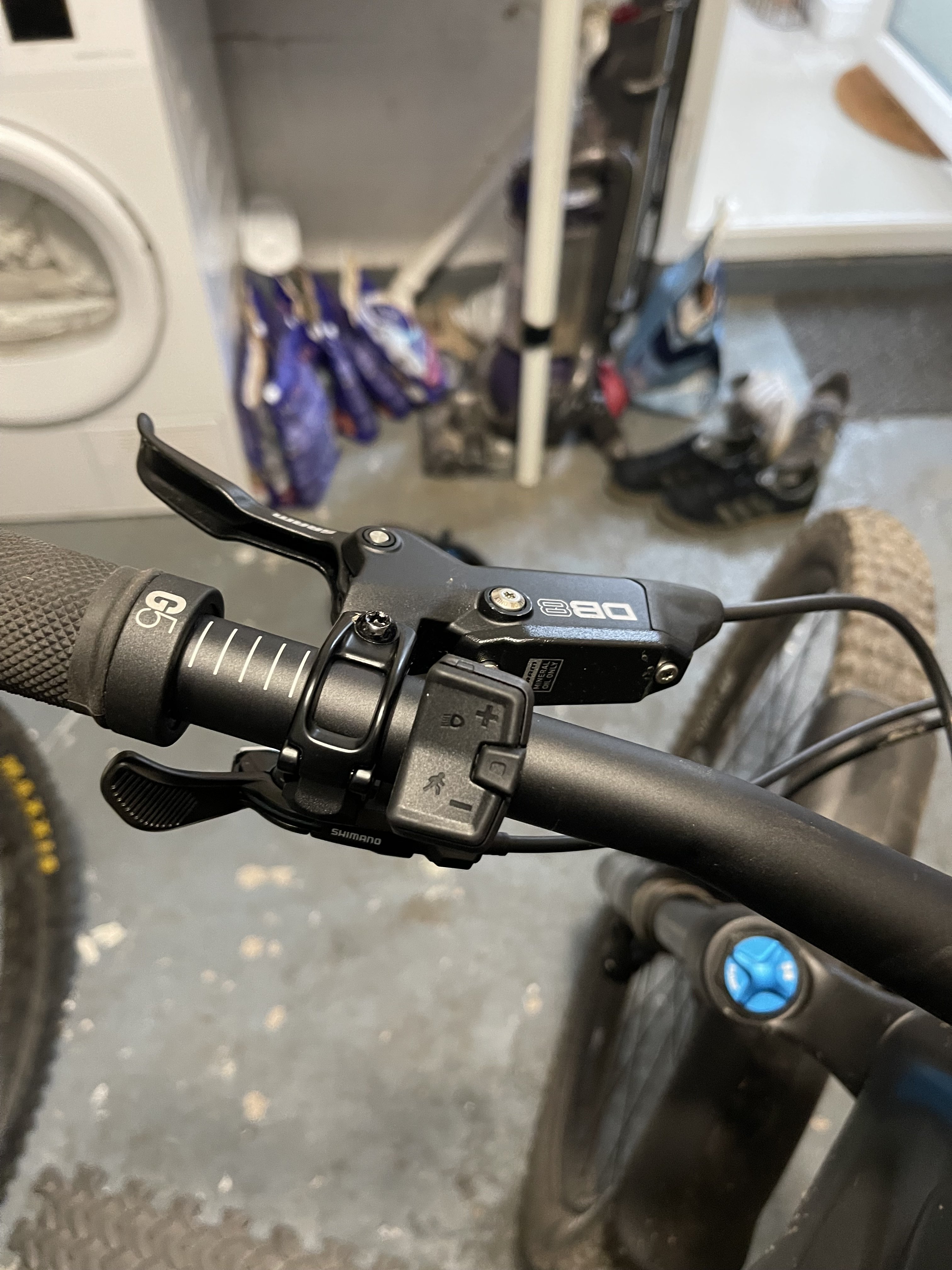

I’ve had to move the mode controller inwards as I keep knocking it and changing modes whilst riding
I basically have one challenge with it at the moment. Pedal strikes, I must have had 10 today. Literally can’t pedal with any lean on on the trails. My plan as I was riding was assuming it had 175mm cranks and I’d swap for 160. However they are already 165mm so not sure it will make any difference. Going to have to learn to ride differently
But it’s an absolute beast and I’m sure I’m going to have many happy years on it.

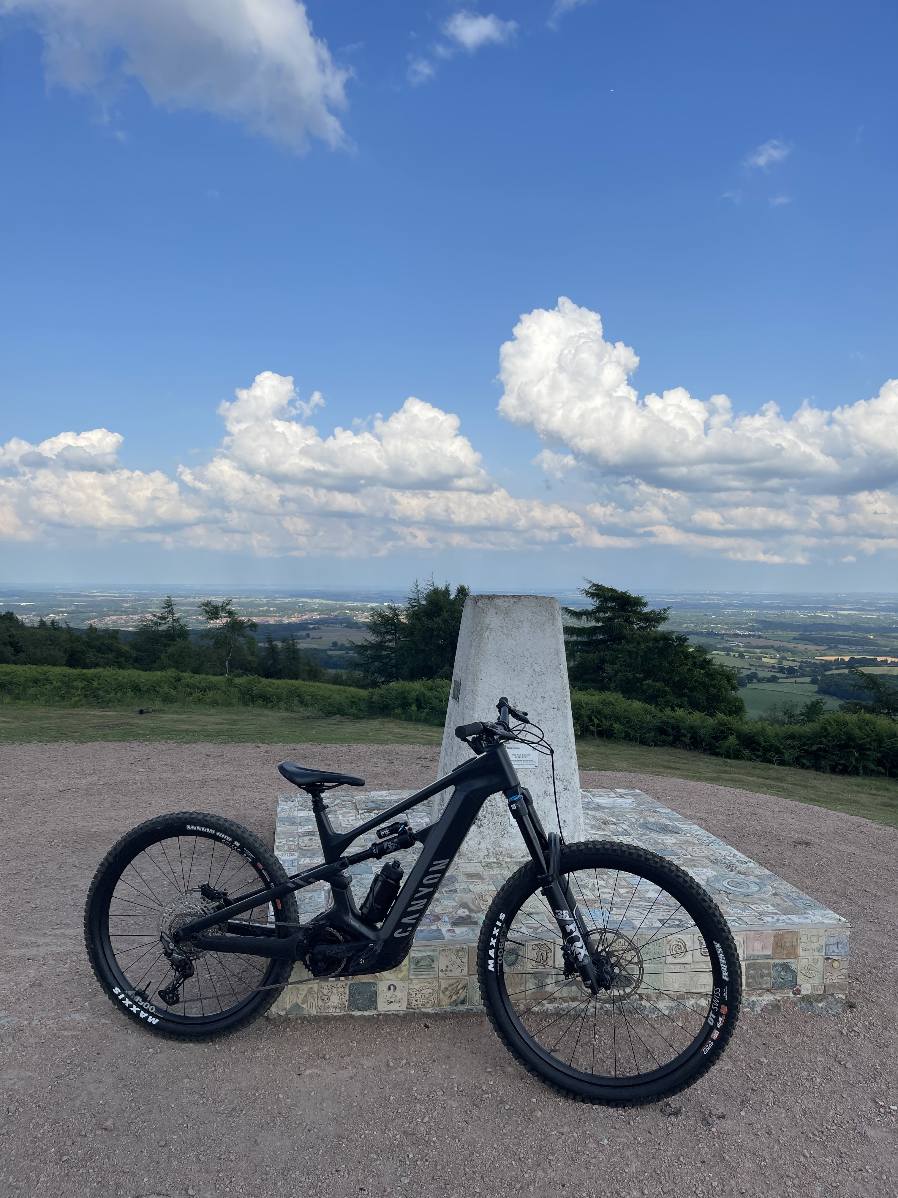

Wrekin yesterday
Chase today
Side to unwind
Not this one
I worked this out last night disassembling my bike to have the damage repaired.
The mech side just undoes the UDH and the wheel needs to be removed to undo it.
The other side is the axle and uses the same size Allen key as the front axle.
Side to unwind
Not this one
Erm yeah, might have been that 😬Let's never speak of this again 🤫 😆

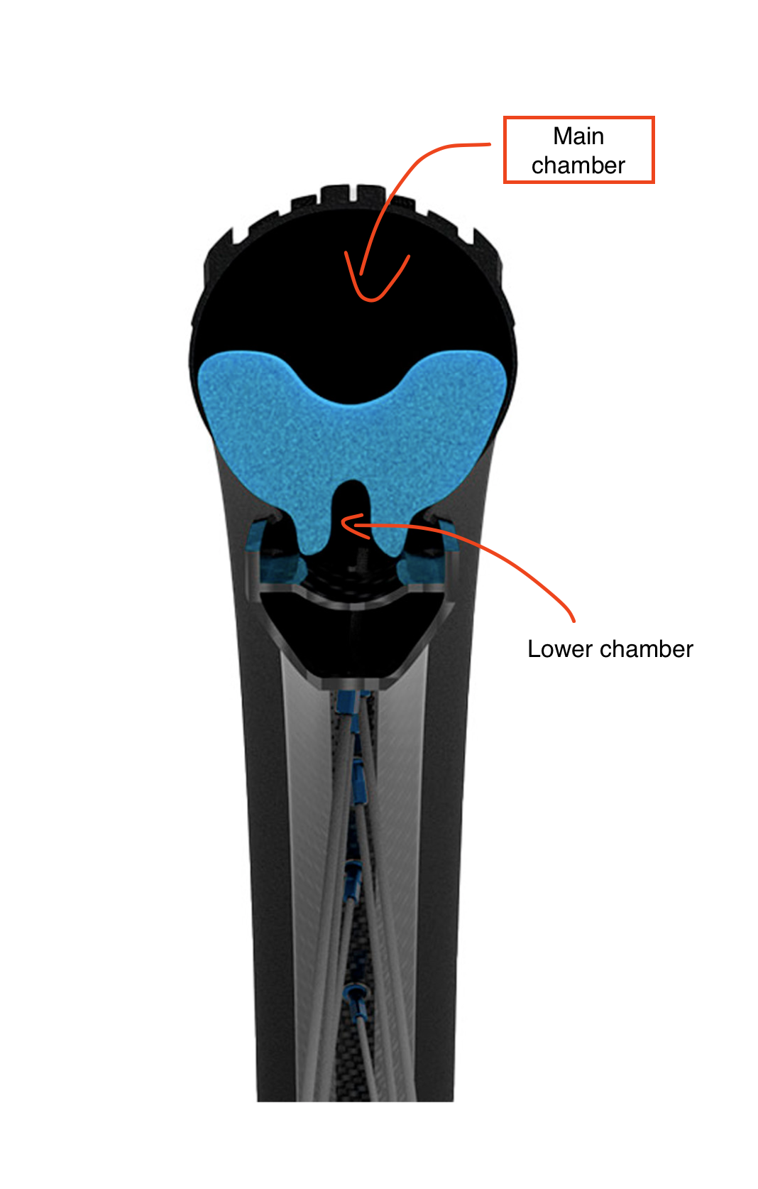

Have you fitted tyre inserts before? I put Tannus Armour in my previous bike and nearly killed myself getting them both in. Not sure I'll bother this time - I'd never be able to put an inner tube inside if I had a puncture, it'd be too fiddly to do on a trail.
That said, I worry about not having the protection. I heard Cushcore was harder than the Tannus as well.

Wrekin yesterday View attachment 118617
Chase today
Good to hear some feedback and impressions of the bike ridden on trails I know well. I experienced a lot of pedal strikes on my Orbea Rise. A touch more air and an extra click of rebound quickens the rear up a little and the strikes lessened. I also swapped to Burgtec pedals. Very low profile. This took the strikes down again
i've never fitted an insert, i watched every single installation video/tutorial on internet, i'm the wikipedia of the cushcore installation....i know it could be hard to fit, especially cushcore...but i'm up for the challenge (i might change my mind after a full weekend failing to do it).
If it could save the rim from a bad shot in the park, i want to try. (rear tire only)
I've got a mesh repair kit in case of puncture on trail, hopefully it will do the job🤤
I have fitted the Tubolight EVO HD inserts to mine, and they work great!
Installing was extremely easy — way easier than fitting PTN inserts to my gravel bike :)

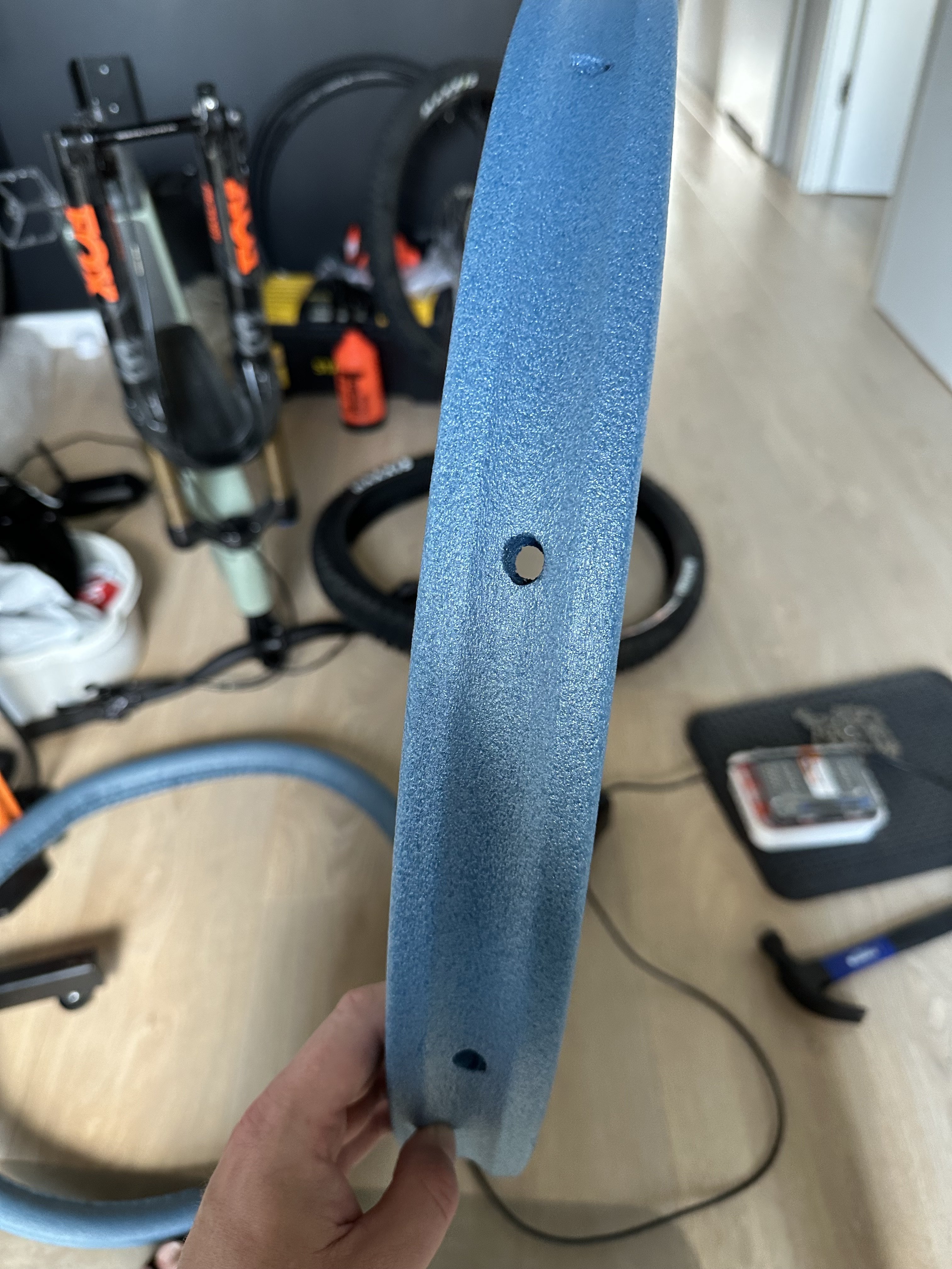

I did one modification, though, and I added some holes to the insert so that the below-insert and above-insert chambers could equalize the air pressure. My reasoning was that on the other bikes where I installed inserts, there was always a problem with adding air or sealant as it needed to be pushed from below the insert to the main chamber. I saw some manufacturers are adding those holes so I did something similar to Tubolights.
How easy was it to get the tyre back on the rim with them inside? That's always the tricky bit. Even with the Tannus Armour inserts I had.

Then rode today, cut out 10-12 times in the space of an hour most times loss of power for 0.5 seconds then once for 10 seconds. Most of them while climbing but a couple on the flat. Bike never switched off though, on the 10 second cut out the controller started flashing red.

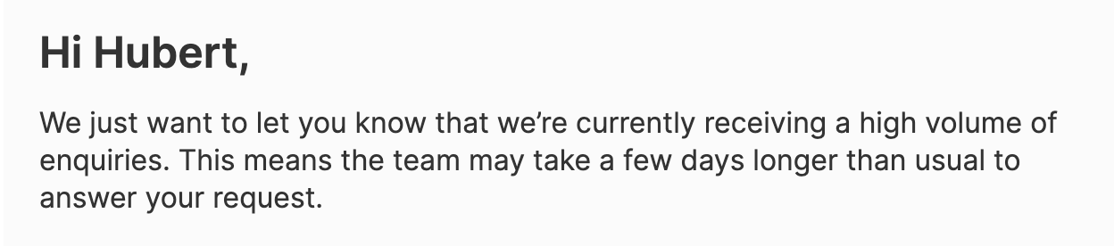

@Herder000 any updates on this one? After my last ride, I reported the issue to Canyon, and I'm still waiting for a reply.
It takes forever for them to reply, and I'm getting frustrated by the bad customer support.
When I arrived from the last trip, the motor shut down, and I couldn't start it. I inspected the battery and the mount, and I know that the battery was latched properly. After re-inserting the battery, I was able to turn on the system.
I still see some play in the battery even when latched properly, which makes me wonder if the connector mounted in the downtube shouldn't be adjusted.
I'm not sure how to do it, as it's buried deep in the downtube and I cannot reach it by hand.
Have you tried talking to them on we chat? They reply pretty instantly then. Will need to be during normal working hours though.
Yup, already tried that - no luck :/
Today I got an email that they're experiencing a high volume of support cases and I should expect a longer response time.
