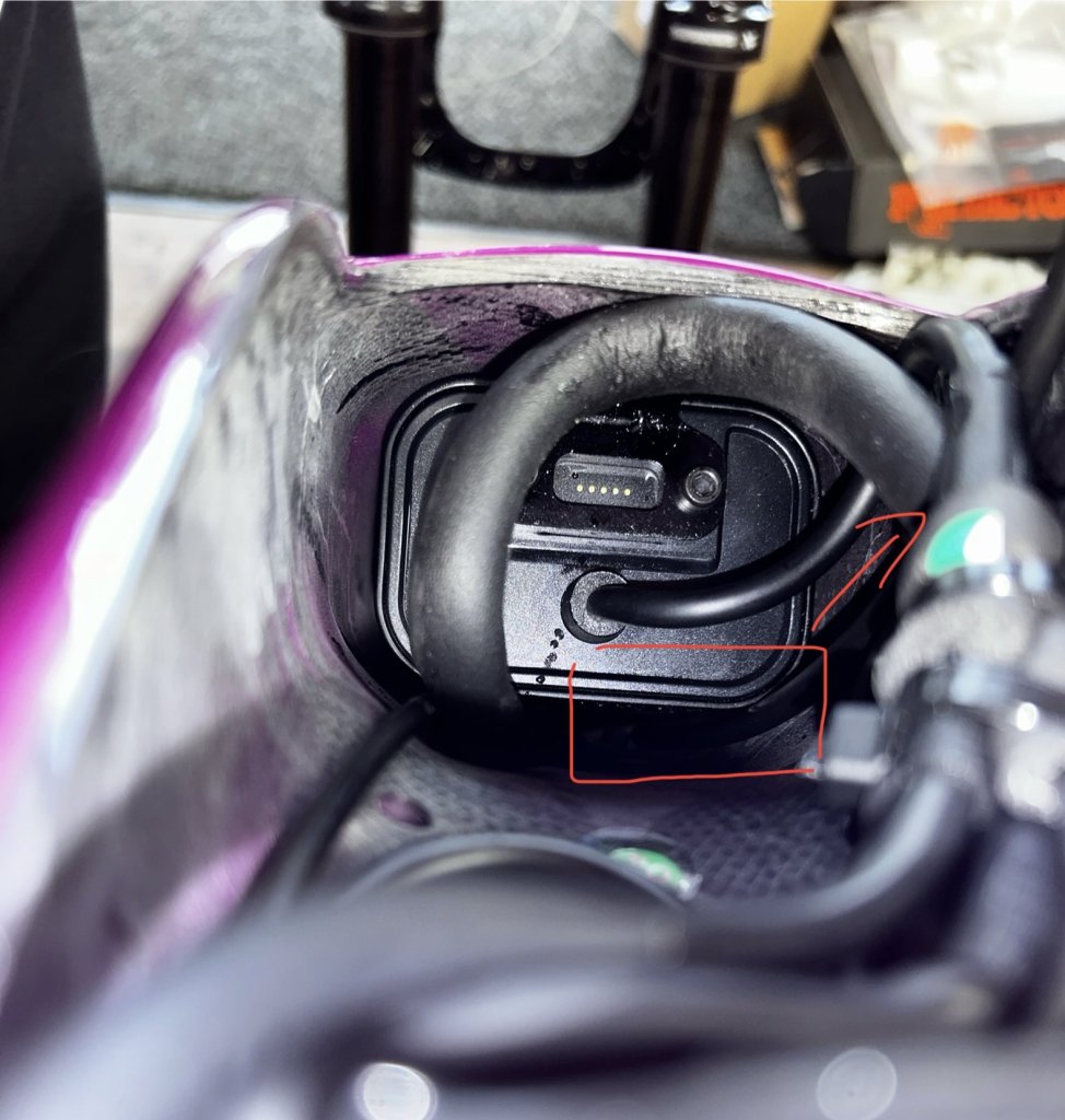

Hi all,
what you should know: Before laying a new brake line, first unscrew the protector. Then the cable routing in the down tube becomes visible. Otherwise it just costs nerves.

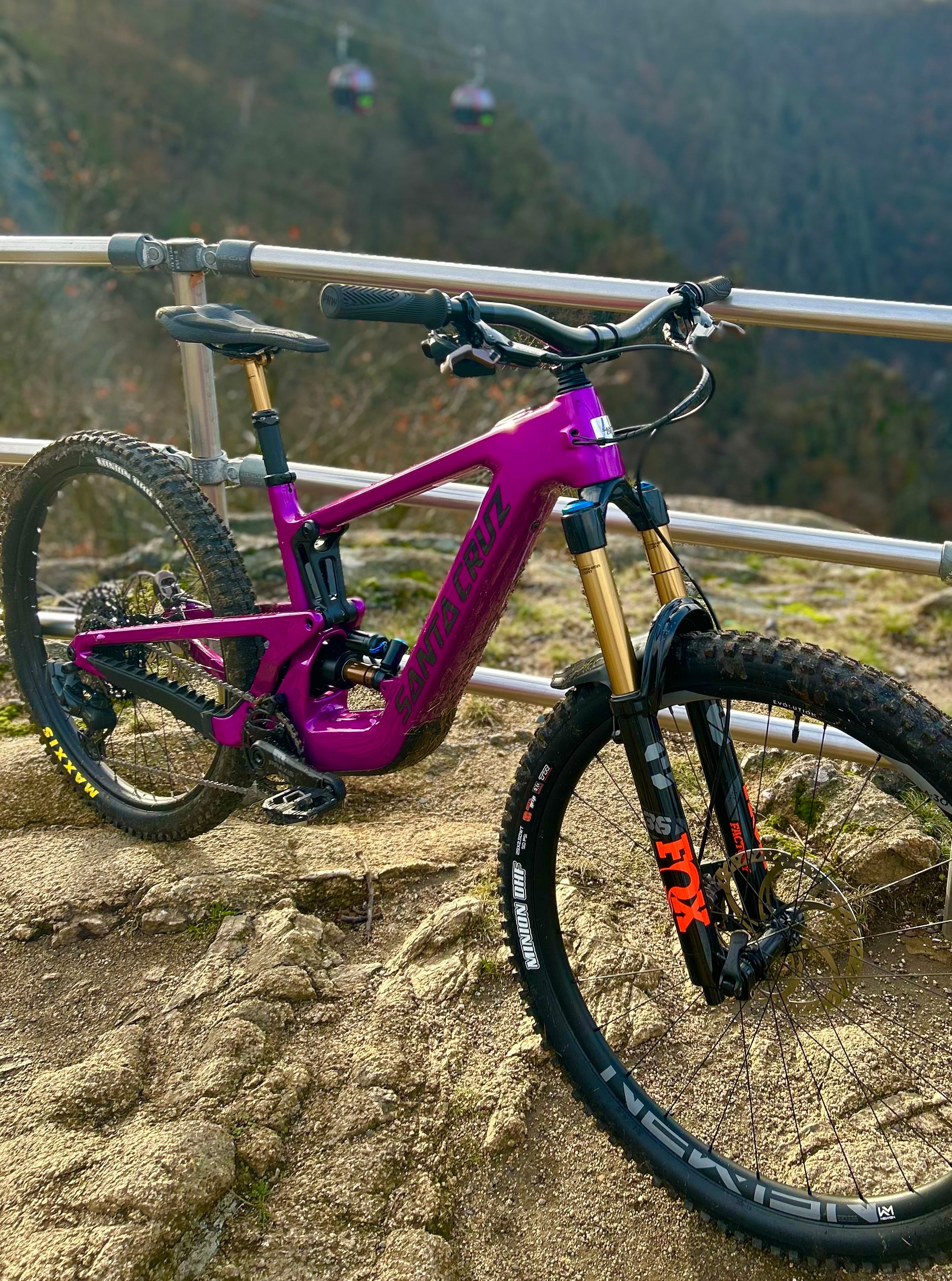

My „Eliot Jackson Edition SL“ - custom:
Beast Riser 780/35 & Intend 50er & PNW Loam
160er 36er Factory (2021er) + Fox X2
150er Fox Transfer & SQLab 6OX Infinergy
GX AXS (old)
Hayes A4 Dominion & 203er Trickstuff Discs
Newmen SLA.30 wheels
Love that Bike (y)
Regards from Germany

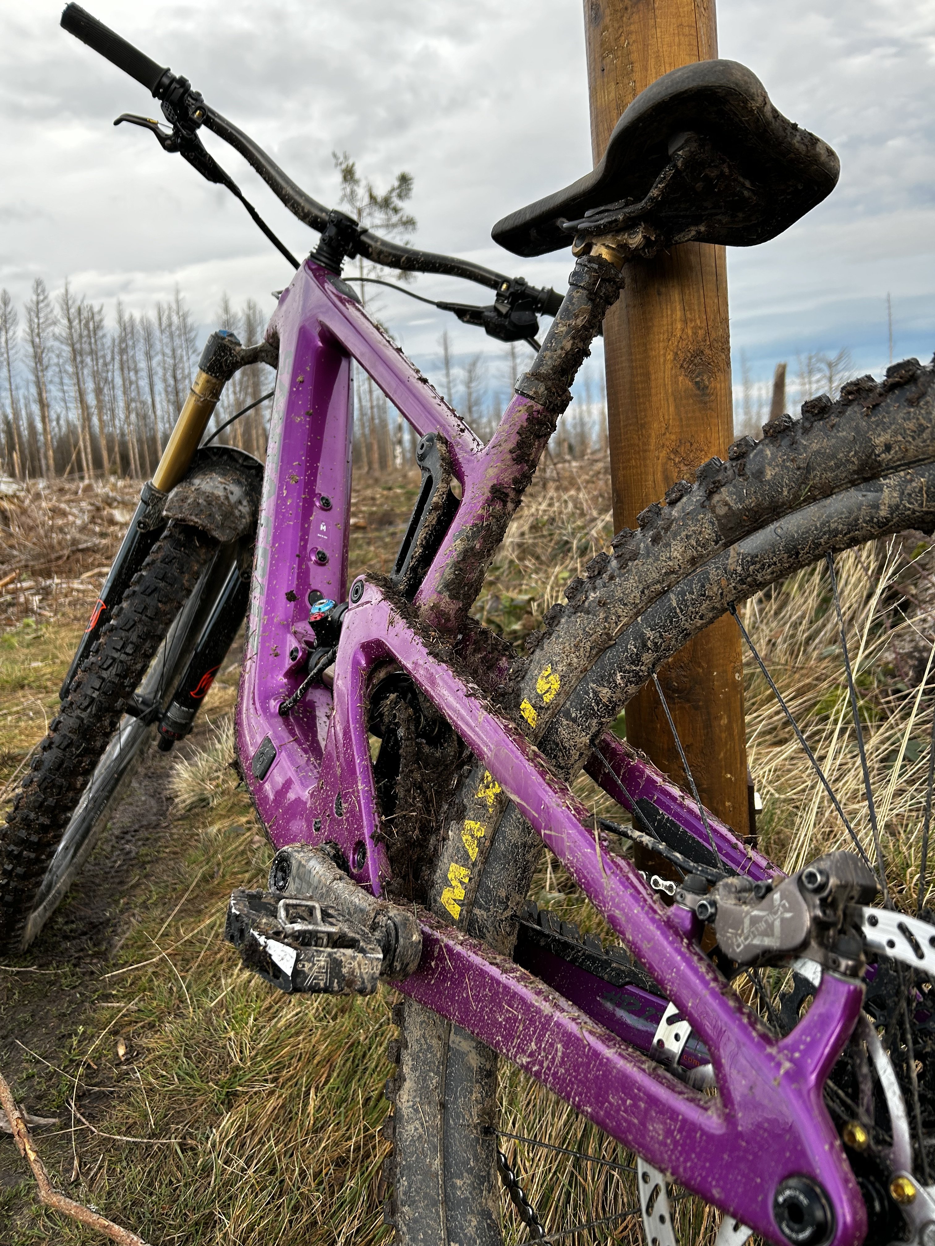

Last DirtyRide this Year.
What i miss is a Shuttle Guard, like on my Bronson. I shuttle the Bikes over the Taligate on my midsize (european ;)) Truck with a Evoc Pad. (slightly slanted, because the roll cover shortened the bed/loading area). Btw: i need a RAM :D
After the first rides, the wrap/foil on the down tube was a little squashed. That's why I stuck SlapperTape as a guard, but it's too soft and deforms. A carbon guard would be nice, like the one from "Rockguardz"….
