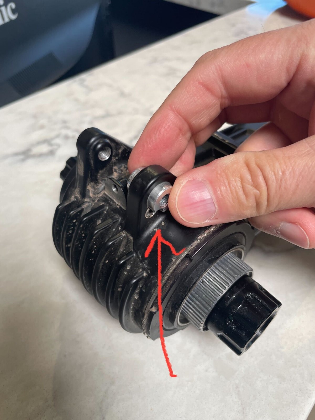

Hey all, I wanted to ask anyone here that’s currently riding the shuttle sl if you are hearing some heaving creaking coming from the cranks when you are out the saddle putting the power down ? When just soft pedaling it’s fine but when you start pedaling hard it sounds really bad with every evolution left and right crank is creaking to the point I can’t handle it anymore . Wanted ask if anyone is encountering this with their bike . It’s definitely from the motor/ cranks. It’s a creaking with clicking sound 😂. Damnit haha I can’t deal with it . I thought I could just let it go but I can’t .
Hey @Just in time does is sound like this:
Yes that’s it ! Now I’m curious how many others are like this! Also if It can be fixed or not . You know like the Shimano ep8 rattle. This motor is just gonna have this noise . Troubling because I can’t ride the bike anymore it’s bugging the shit outta me now. Thank you for sharing . Have you related this to your lbs? I haven’t yet but I might bring it in tomorrow. Honestly I’m just worried they won’t or cant do anything and that will raise my blood pressure super high 🤣
I talked to HQ and It's probably a bushing issue in the Fuzua motor. I would talk to your dealer, let the know this bushing is not supposed to have any play (allowing flex). That can cause the creaking sound when you pedal.
Hey Crucible thanks for the follow up . That makes sense to me. I was thinking some bushing or motor mount issue. Or at least I was hoping it would be that. I’ll relate this over to my shop to help them by pass any troubleshooting. Thanks again !
