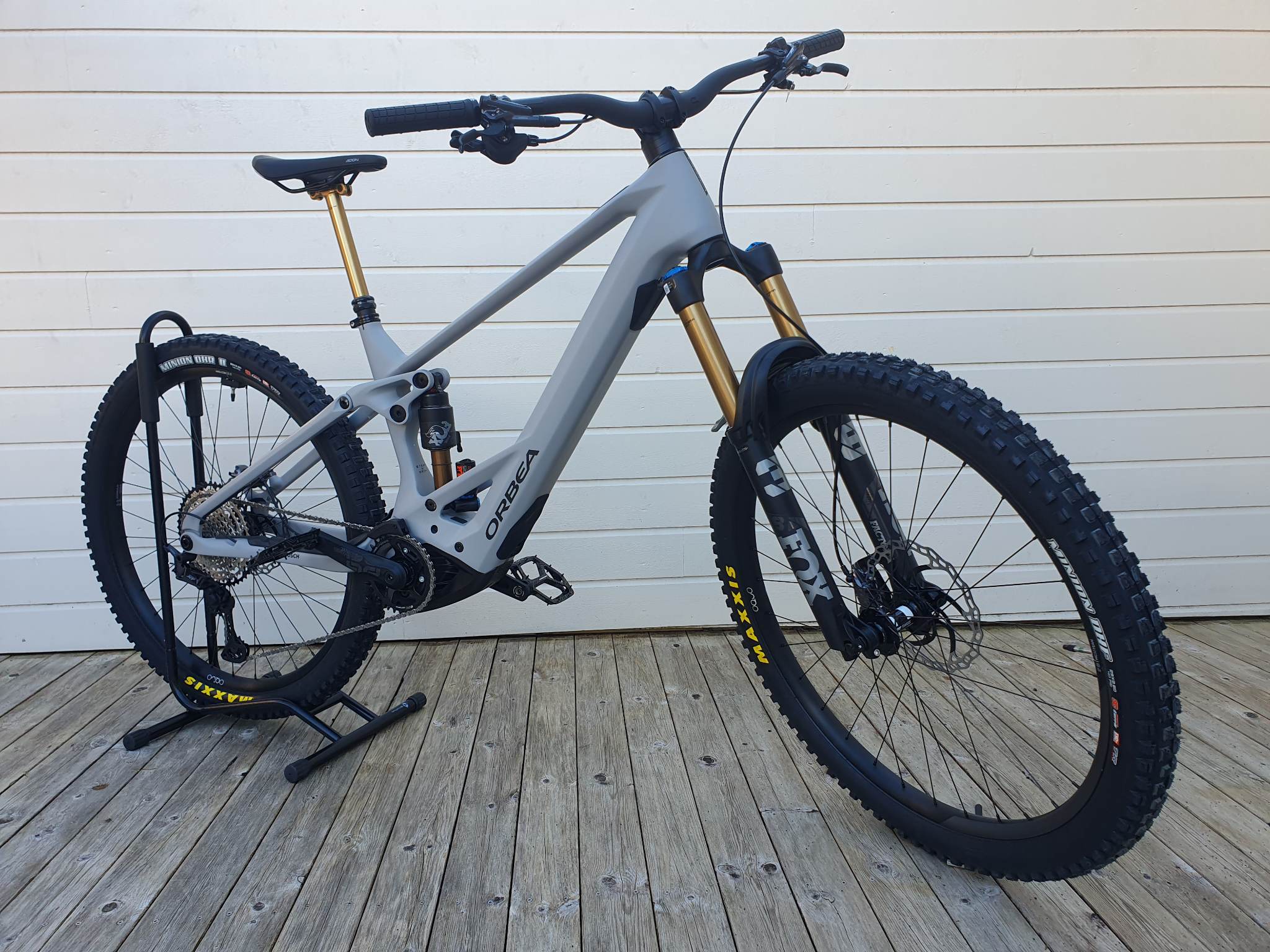

My M-Team was finally delivered today. My "local" distributor took 20 days before they sent it to me(!)
All components were supposed to be XT (standard for M-team), but I got SLX cassette, SLX shifter and deore chain.
Not the end of the world, but still annoying! (n)
A quick follow-up to my mini-rant:
Just got a message from the store where I bought the bike that they have sent me the correct XT-parts.
Pics to add some color:

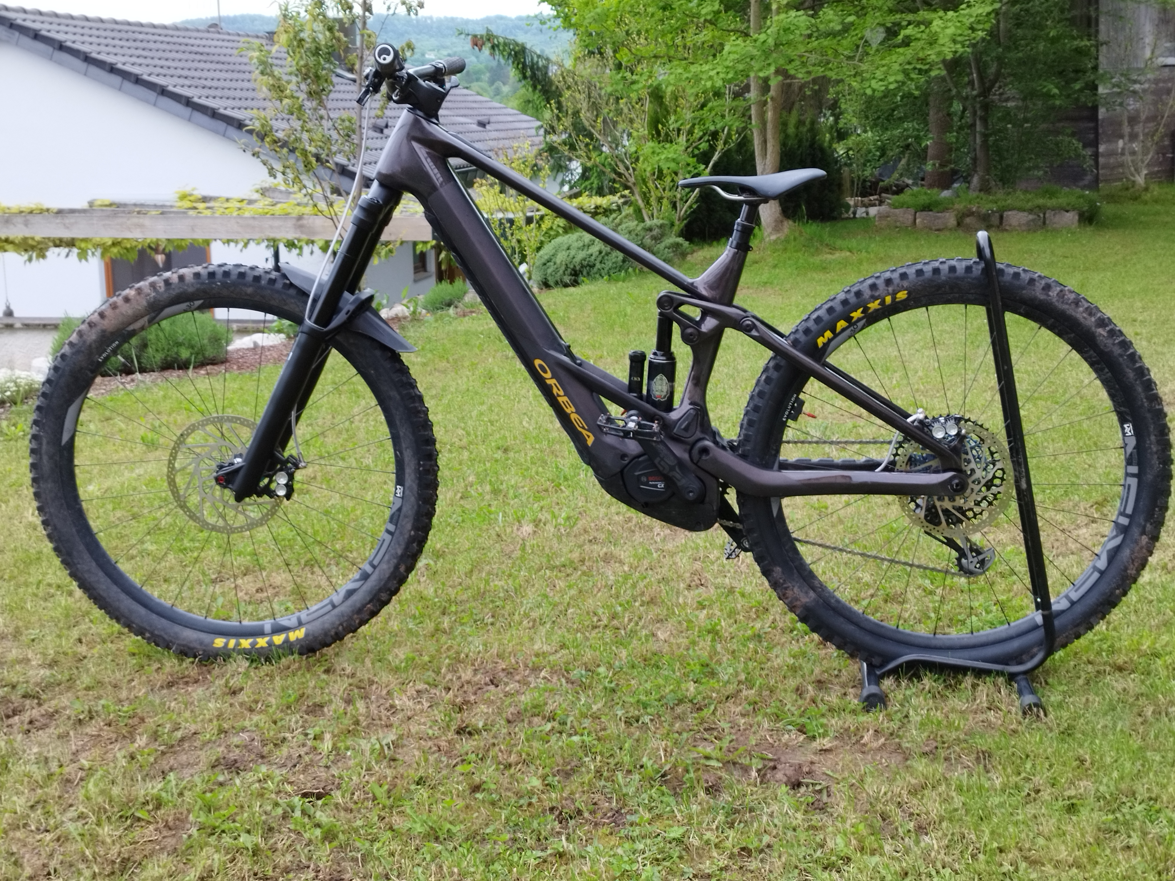

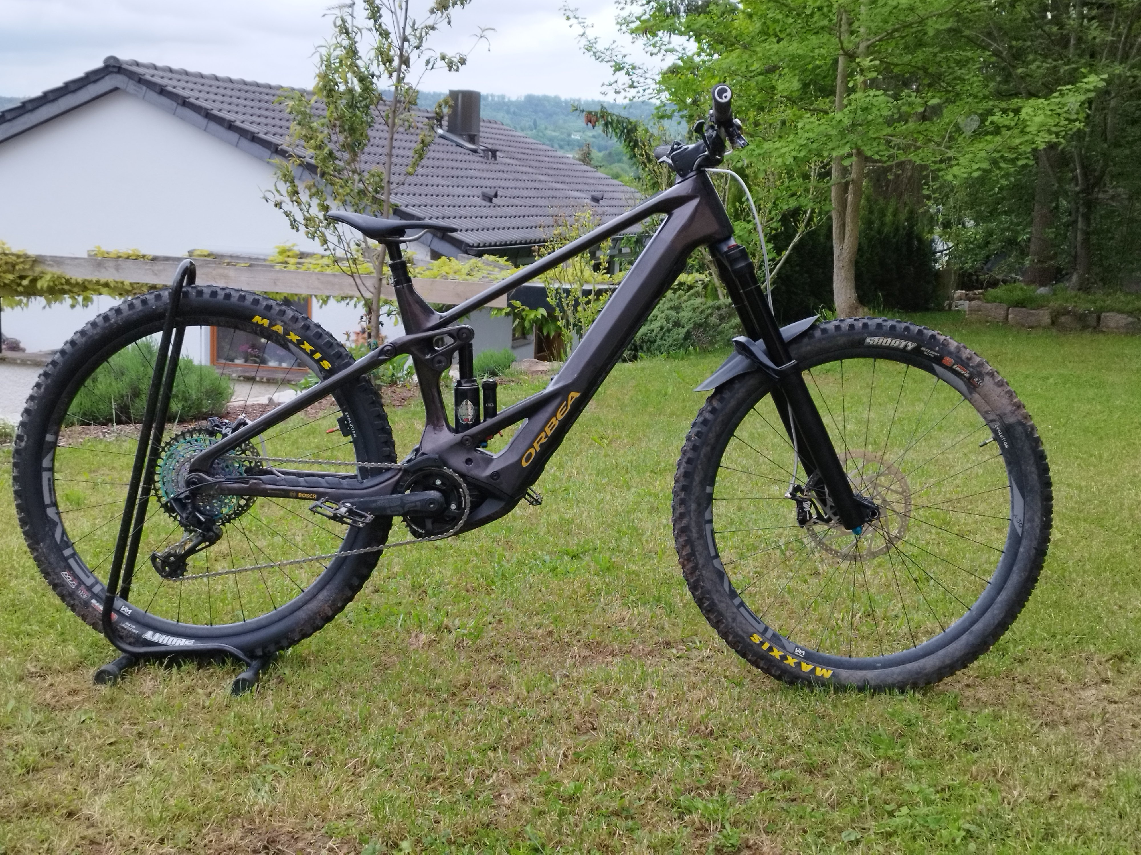

22,6 KG / L 184cm 83cm
Mezzer 180mm
One up 240mm
The damper selection is very limited.
DVO Jade fits in but compression not accessible.
Rock Shox Air RC2T 2023 rebound and air valve accessibility modest, compression adjustment probably hits the frame when compressing.
CC Kitsuma Coil / Air no assembly possible.
Öhlins ttx 22m coil with normal AGB fits.
Manitou Mara Pro Accessibility of all adjusters and valve is good. Adjusting the pressure level is difficult, I will disassemble it.
Brake disc magnet prepared, cost me 1 hour of my life to pull this through the chainstay together with a Hope steel flex.
The routing of the lines through the headset 🙈🤮 this means that if you remove the seat post, you have to remove the motor for installation because the outer shell cannot be pushed far enough.

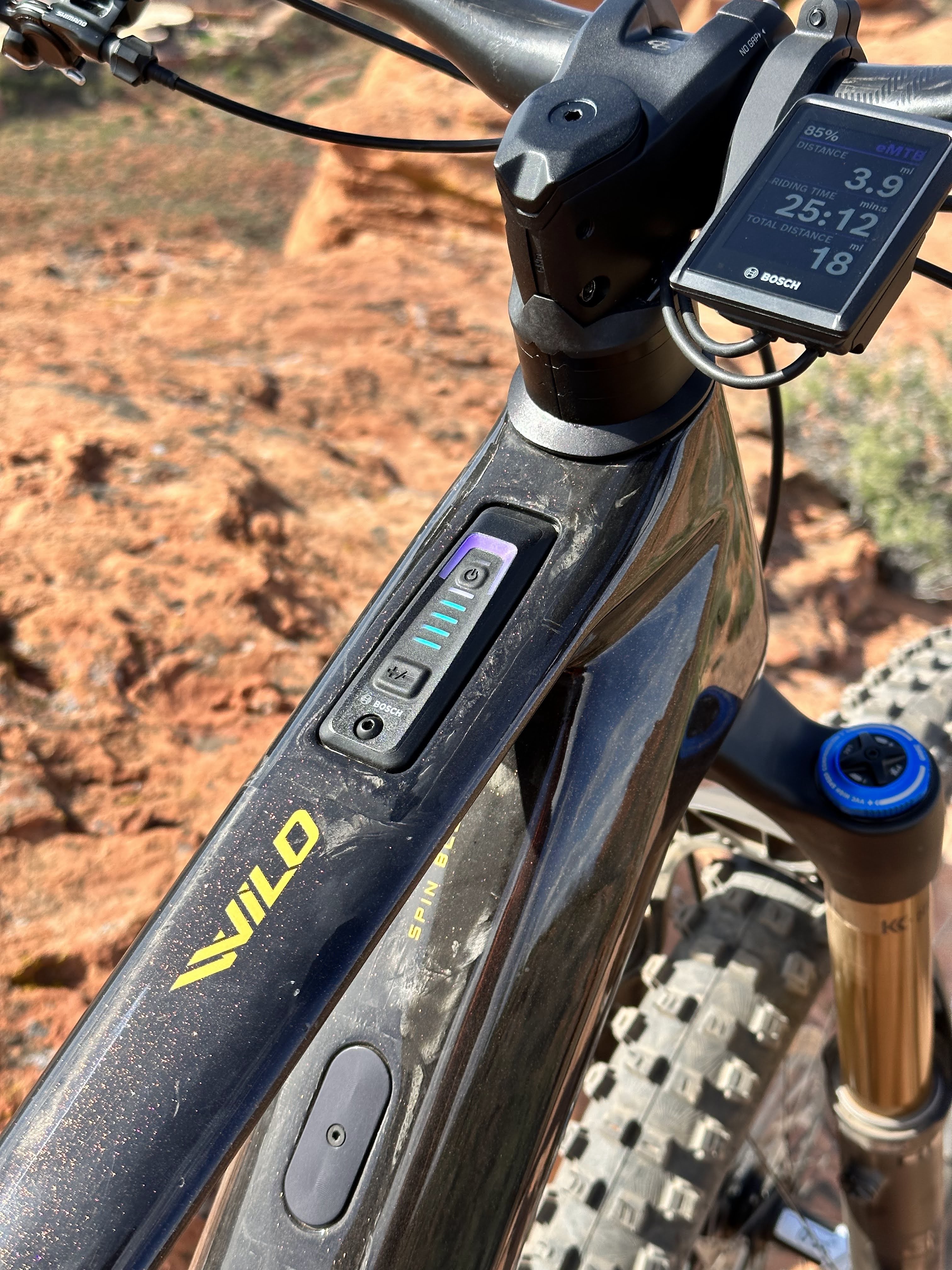

I’ve found the Wild checks ALL the boxes. If you’re ready to up your trail game the Wild is the next step. 12-16 MPH on a XC trail is mind melting . Eats rocks and roots like they aren’t even there.
I second that, an animal of a shredding machine nothing stands in its way. Ride last night 31 mls 3550 ft climbing and got back with 62% bat.

That's a really low stack with no stem spacers, do you prefer to have it setup like that or did the bike ship like that?
