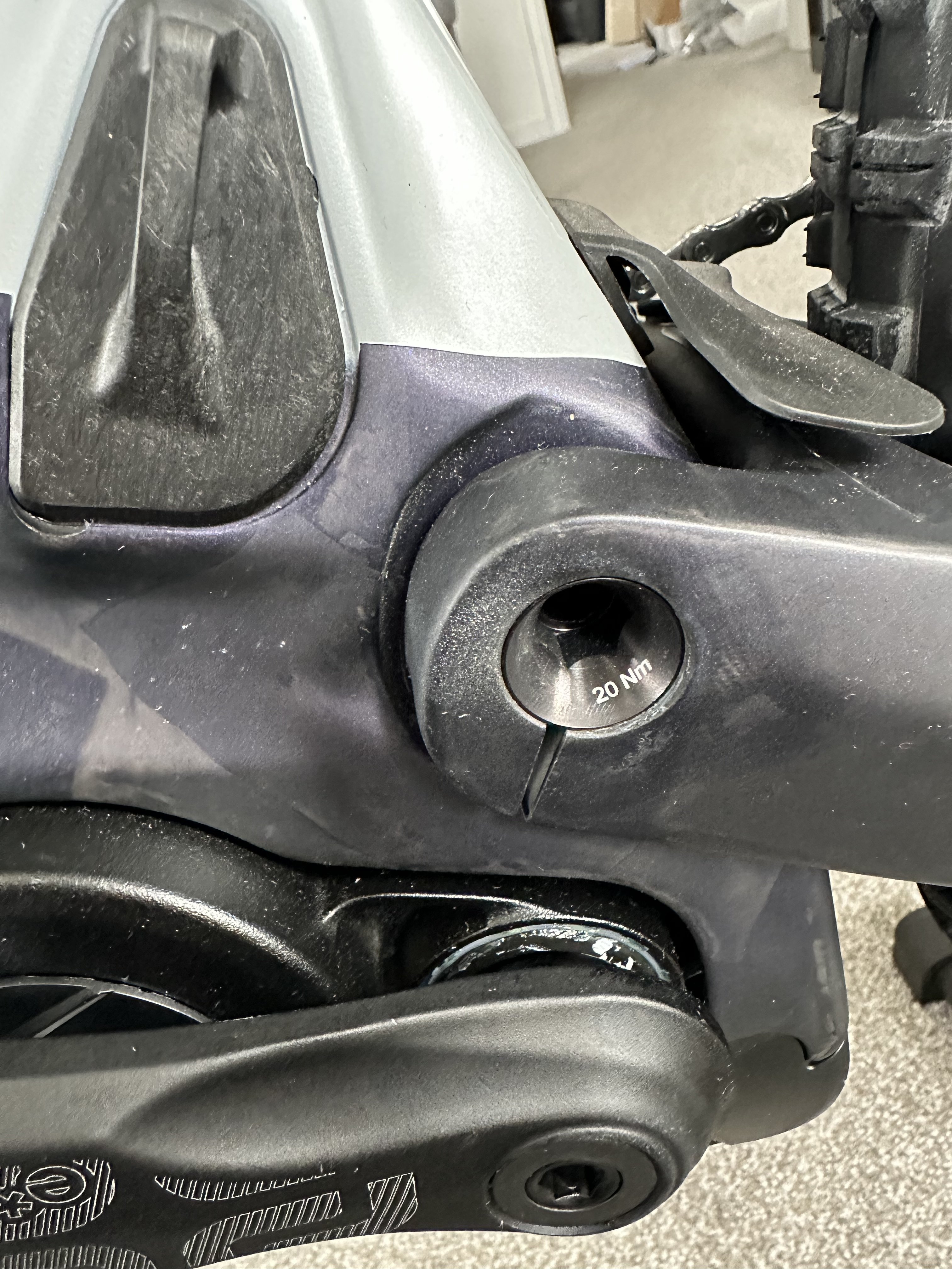

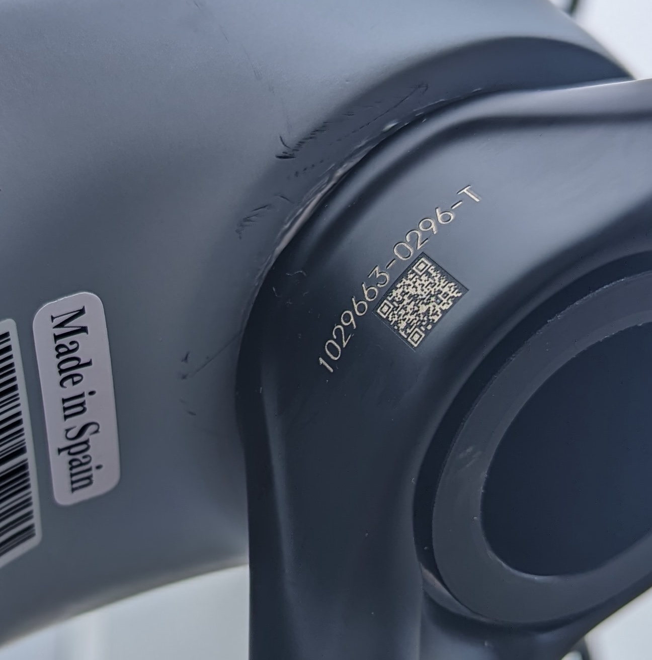

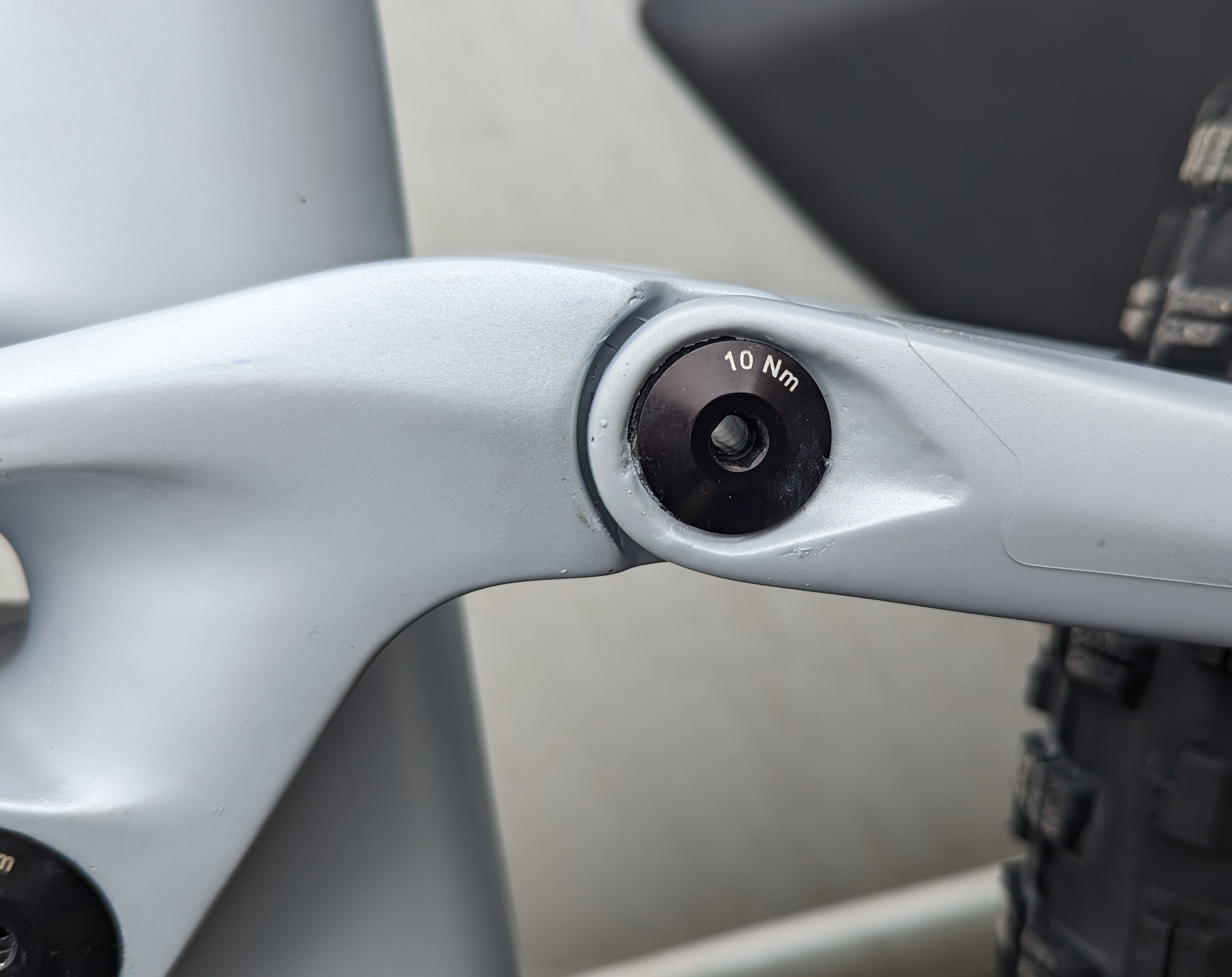

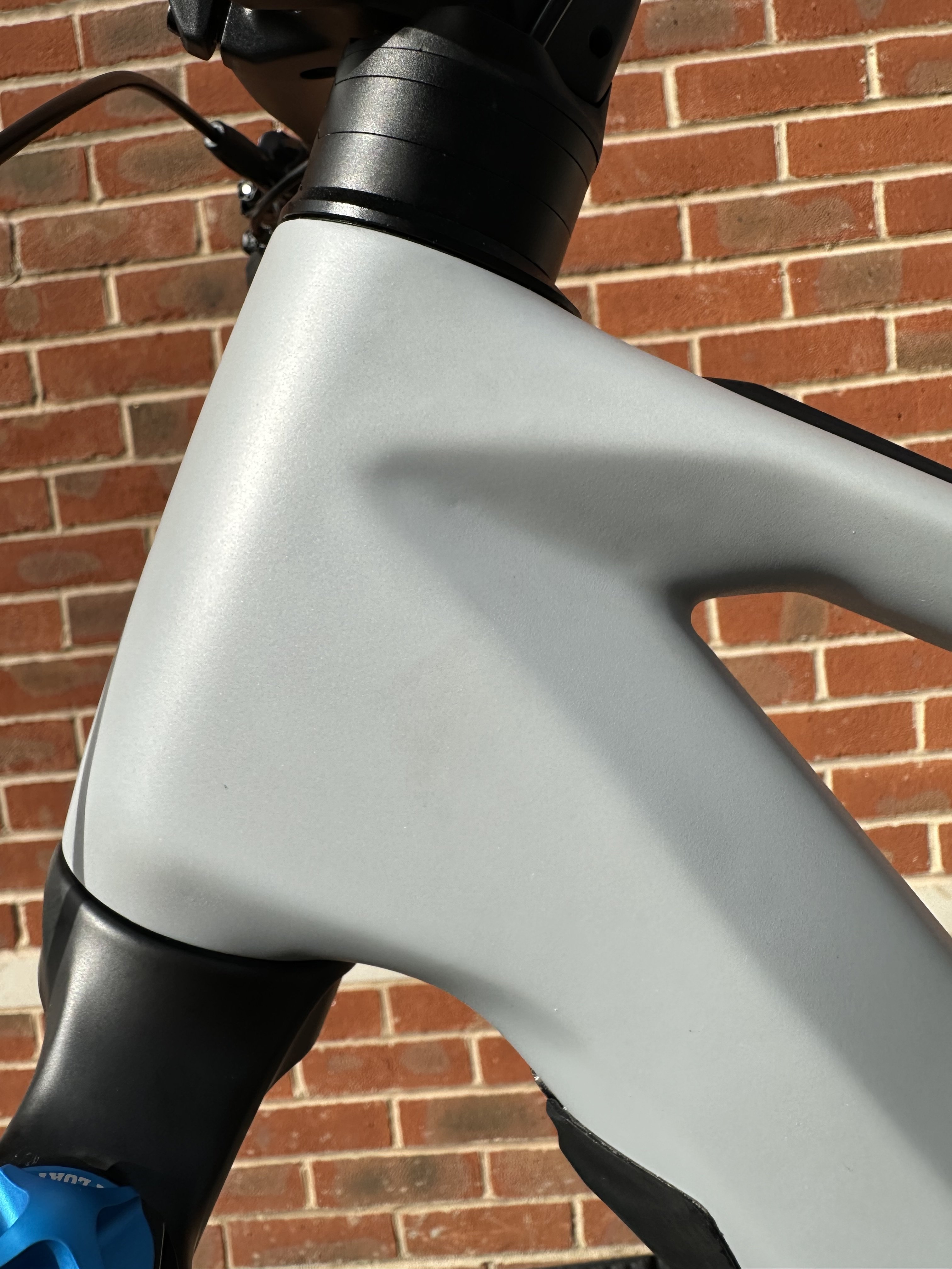

I can see a few people have posted quality issues with the 2023 Wild in the All New 2023 Orbea Wild tread so wanted to start a separate thread just focusing on paint and quality issues people are having.
Not looking to make this an Orbea witch hunt (I know this can happen on forums) just genuinely interested to see how many bad bikes have been shipped so I have also included a poll for owners who have a Wild but not had any quality issues.
Having personally now had dealings with two Wild M10s that were both in a very poor condition I've experienced a bad bike rate of 100% which is pretty shocking and I'll include photos of both bikes below.

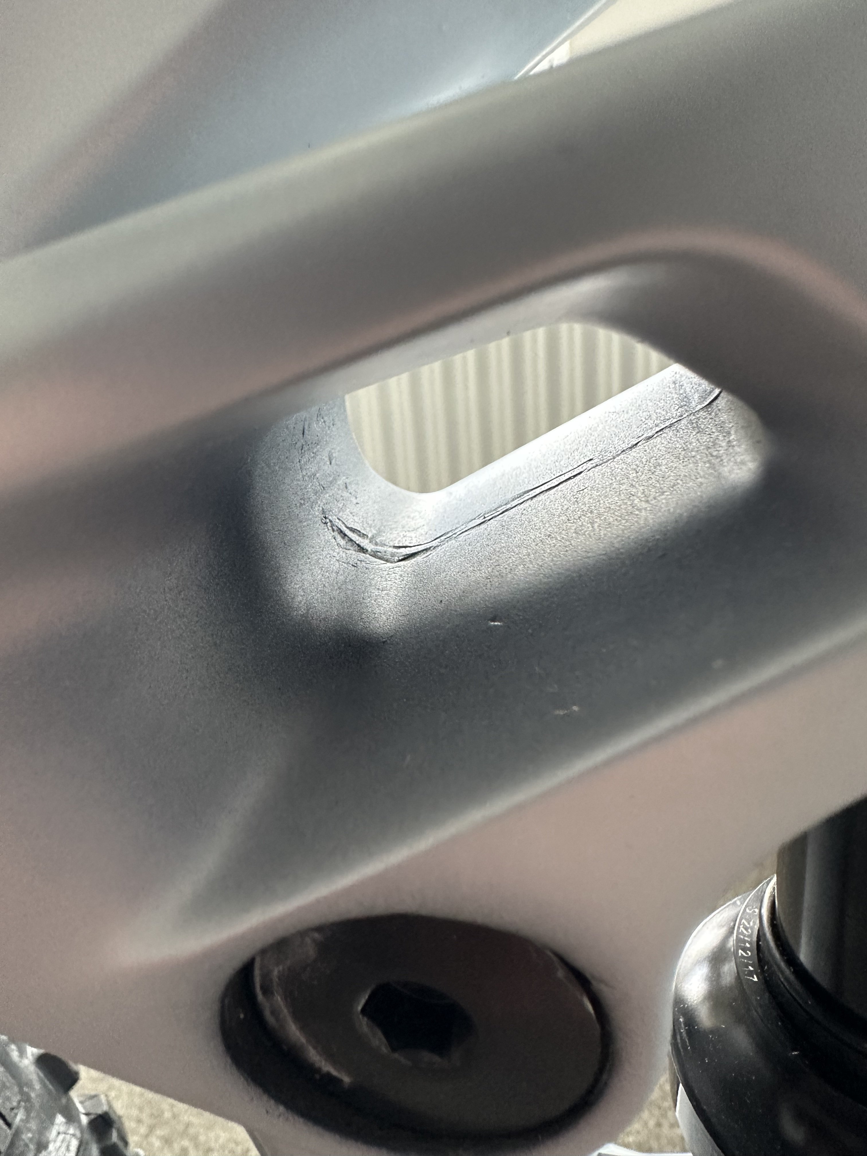

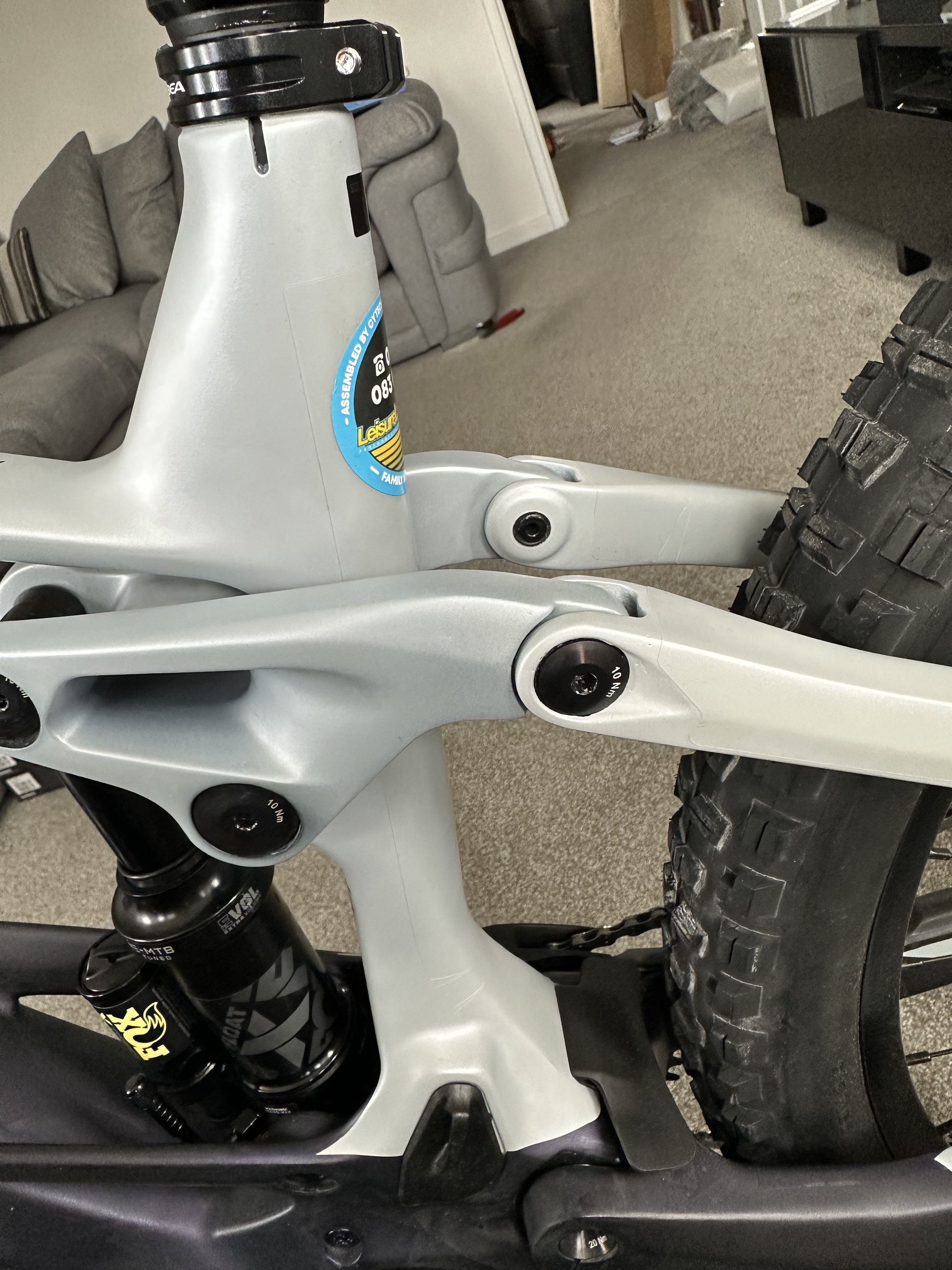

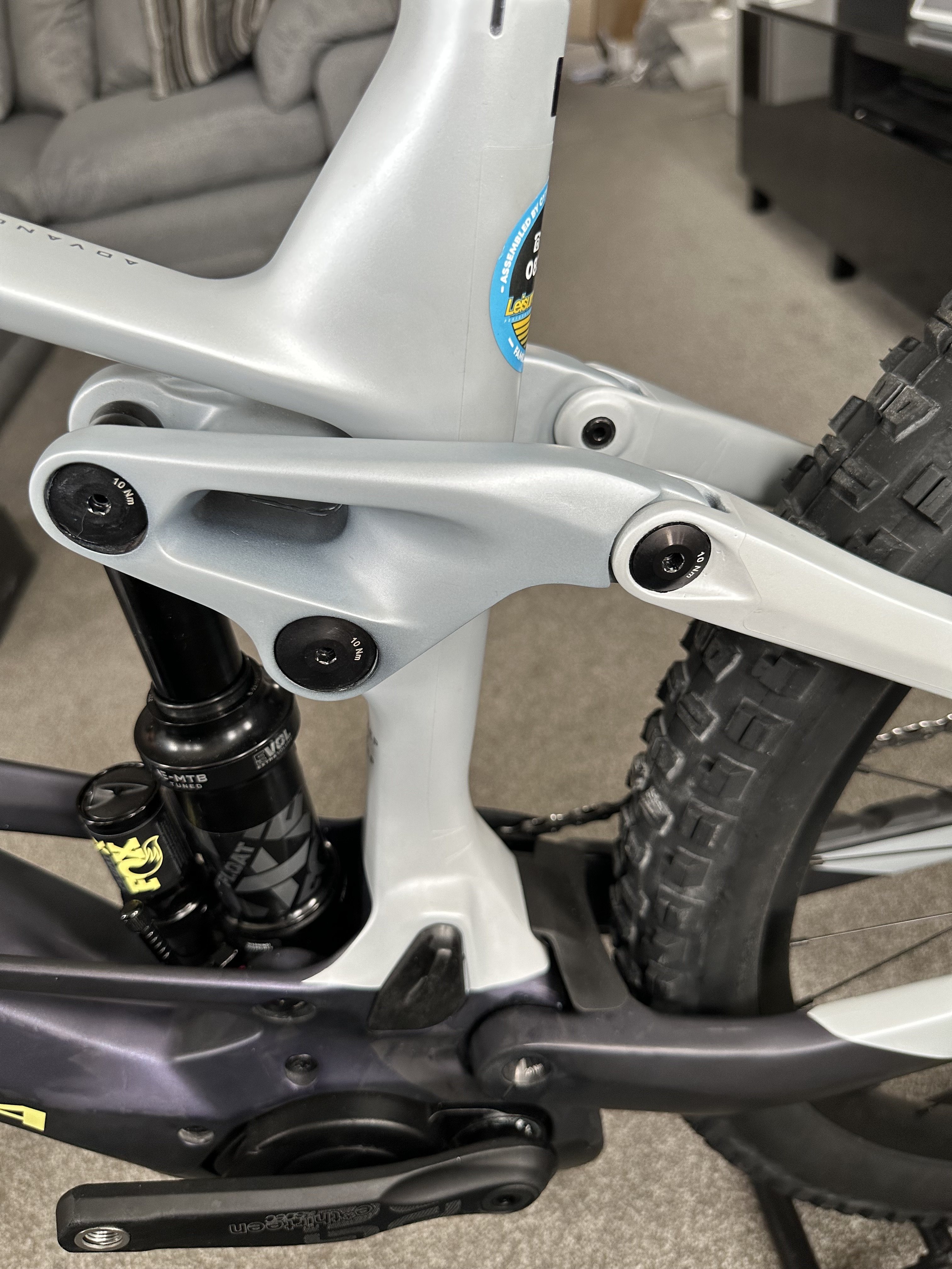

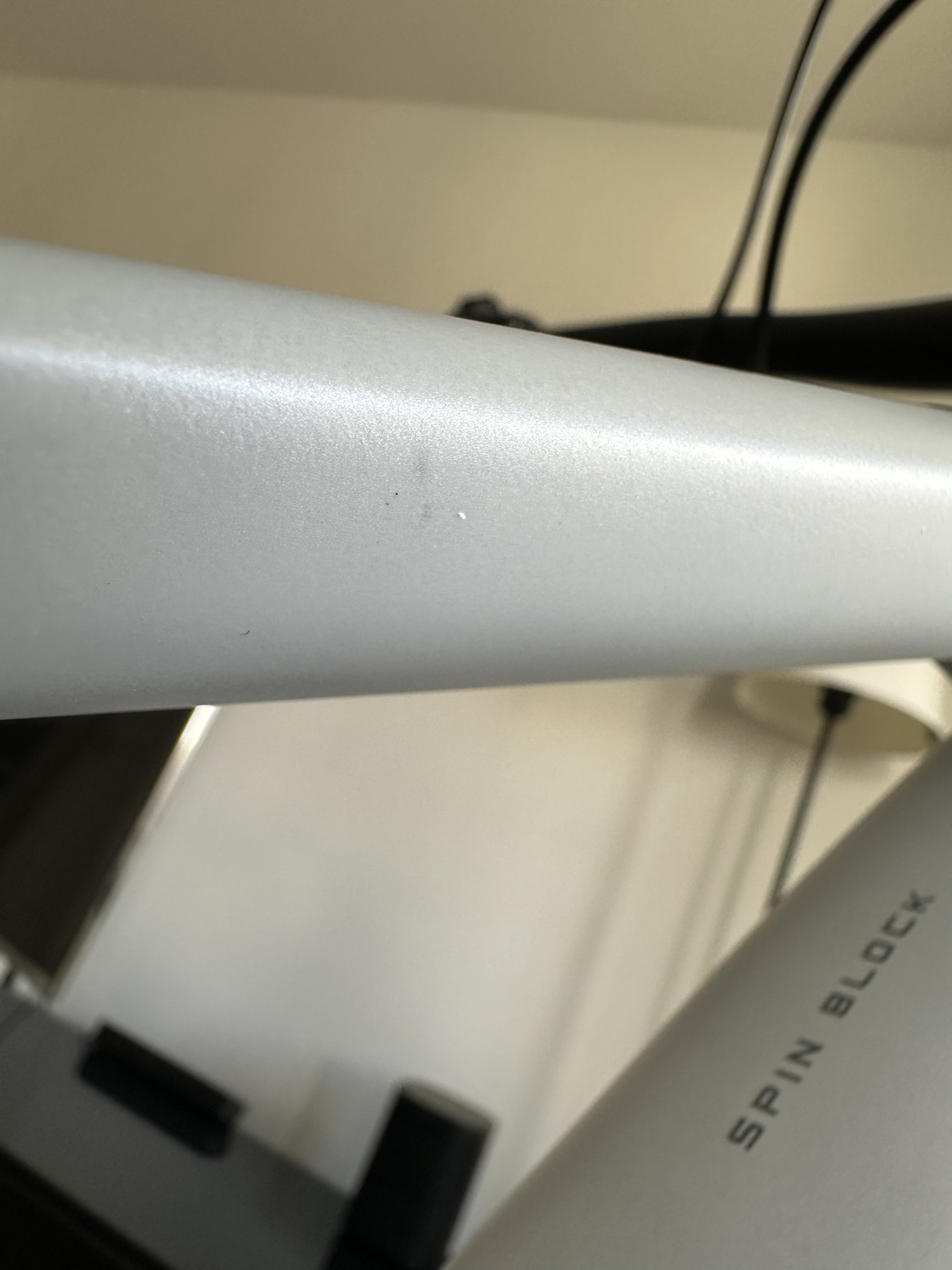

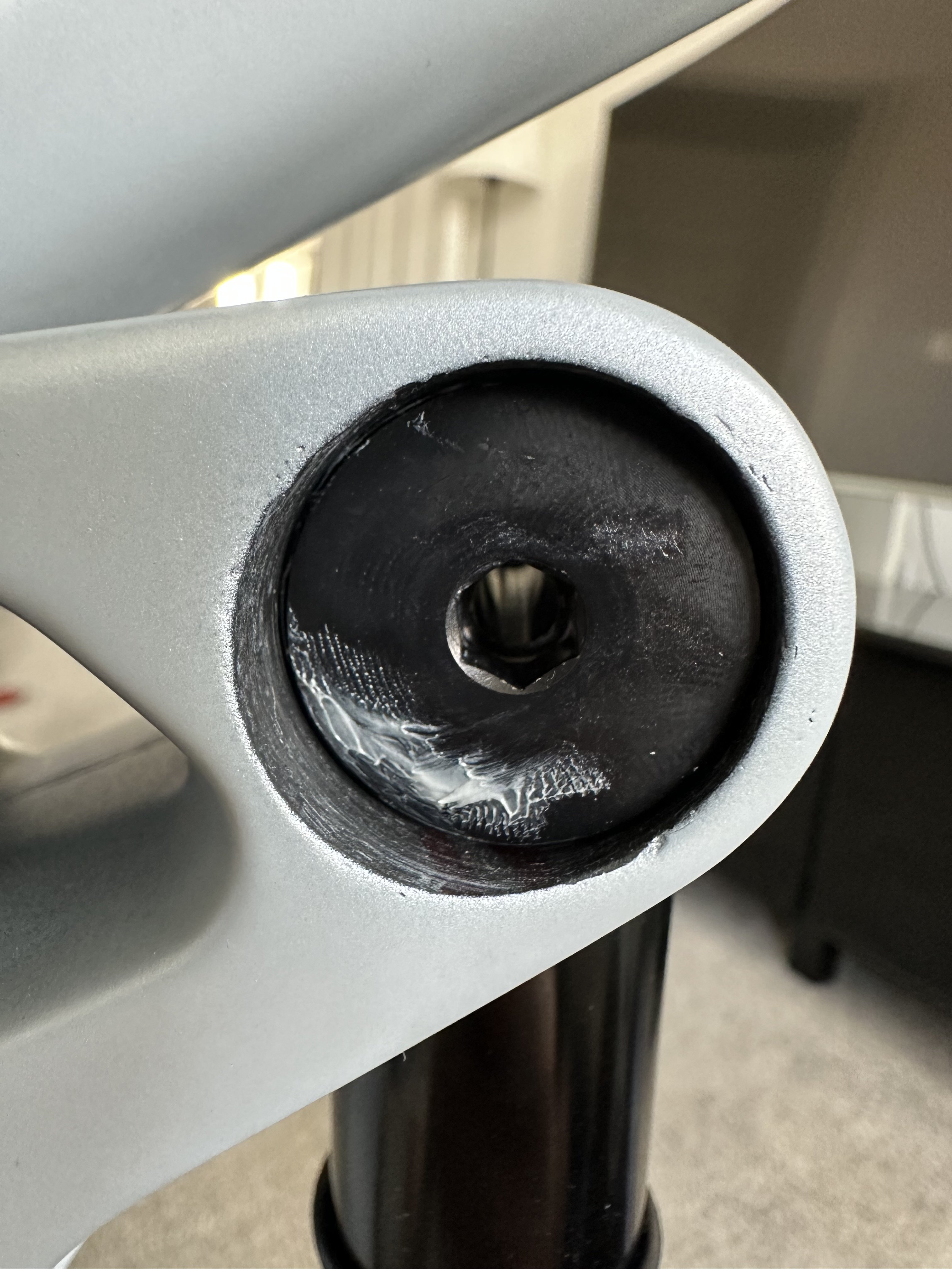

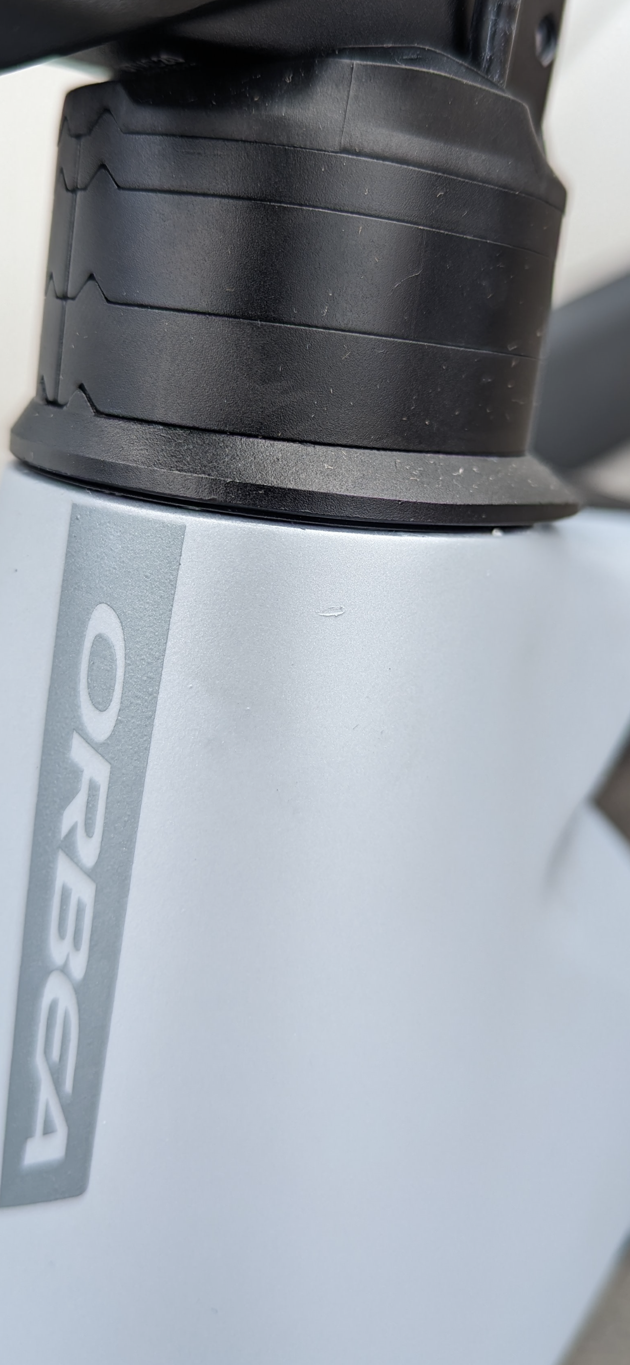

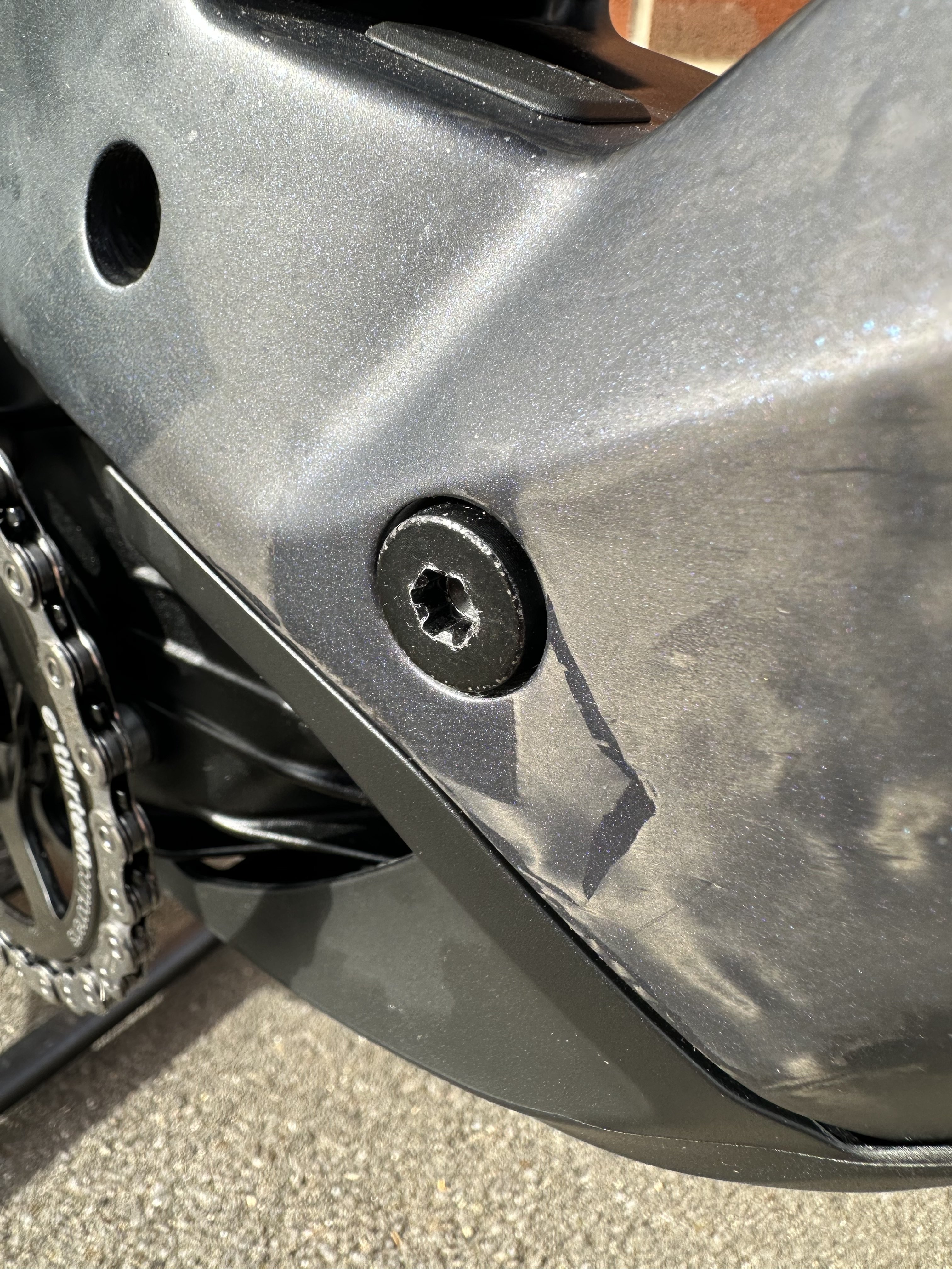

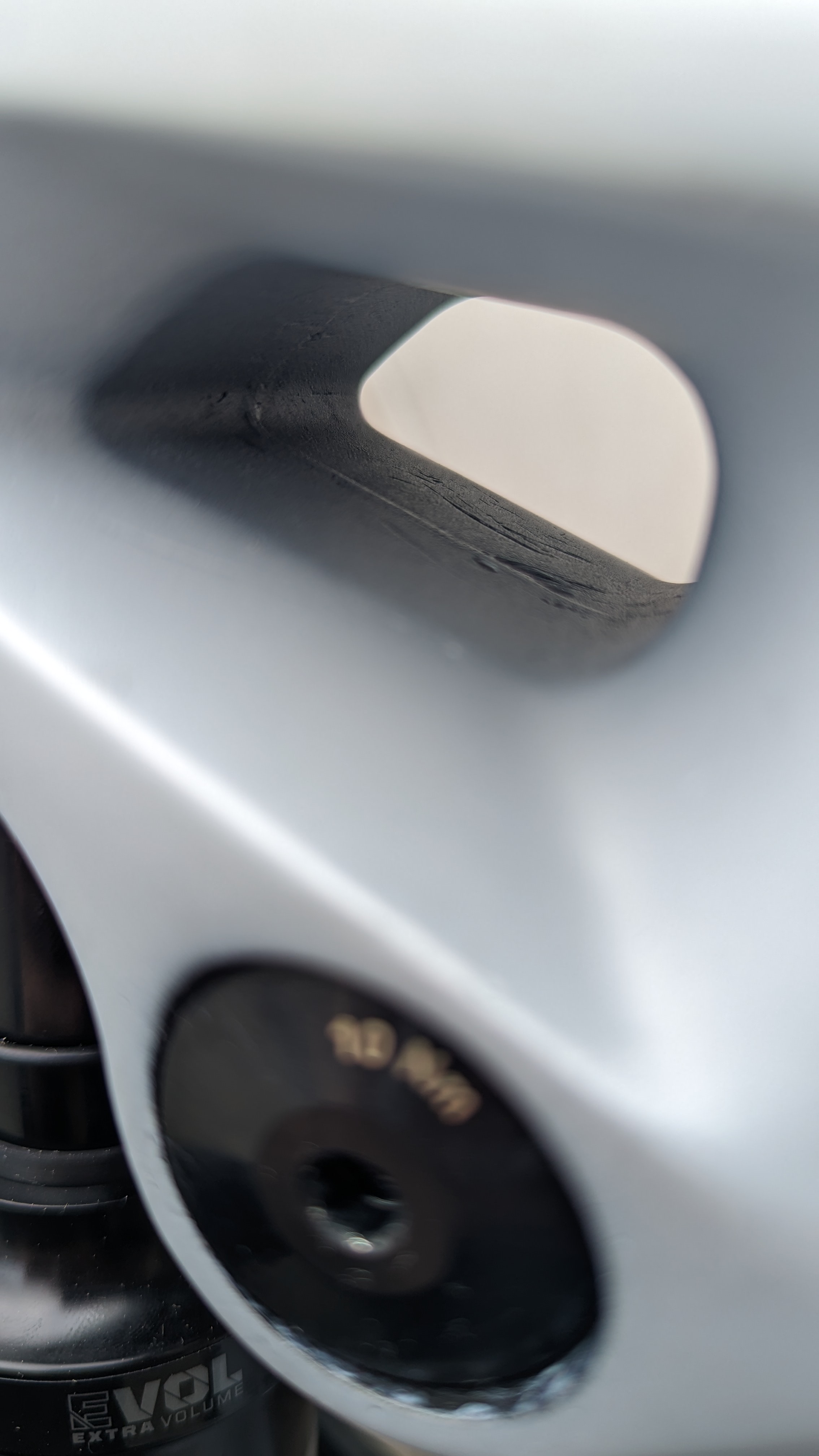

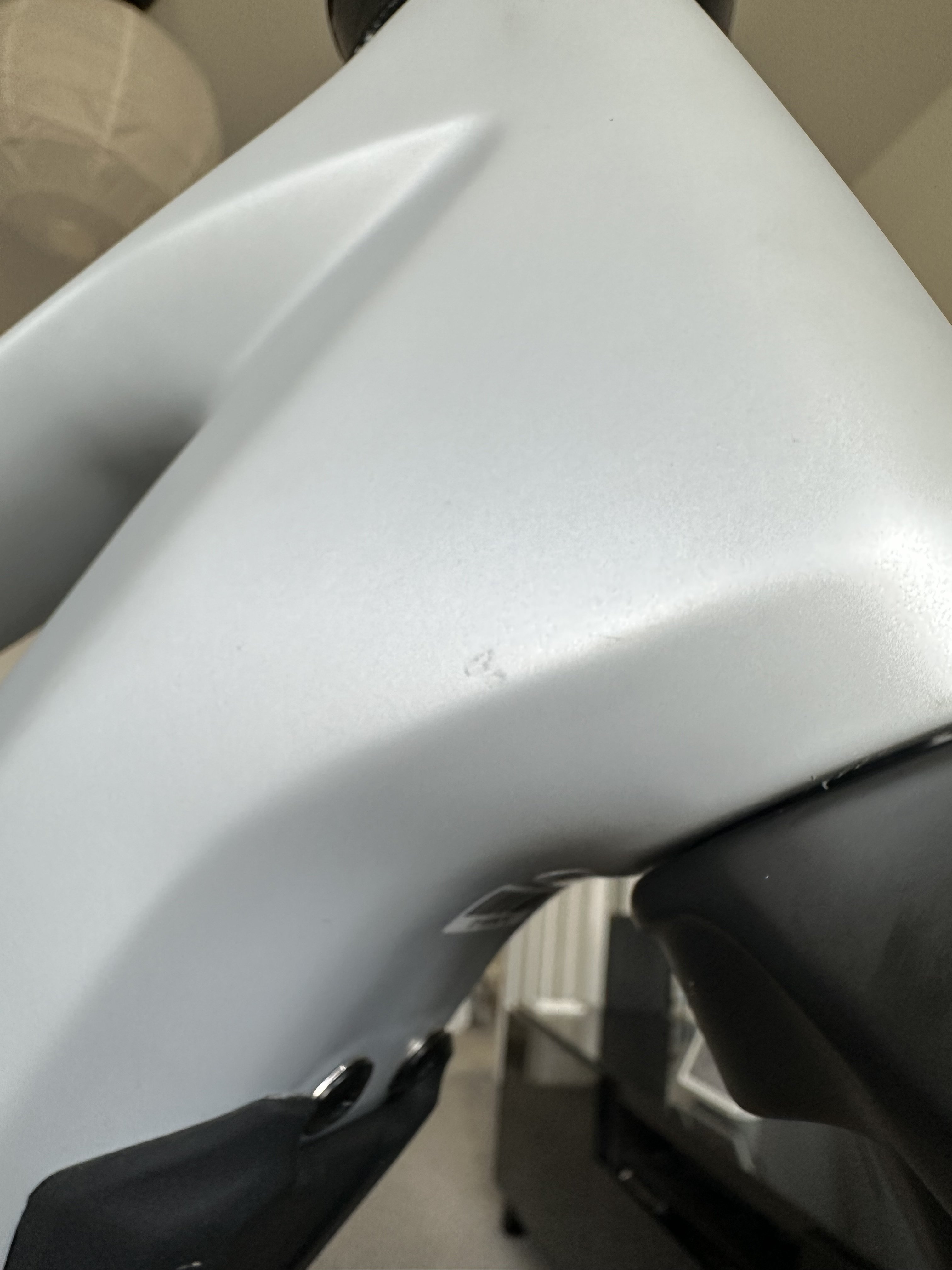

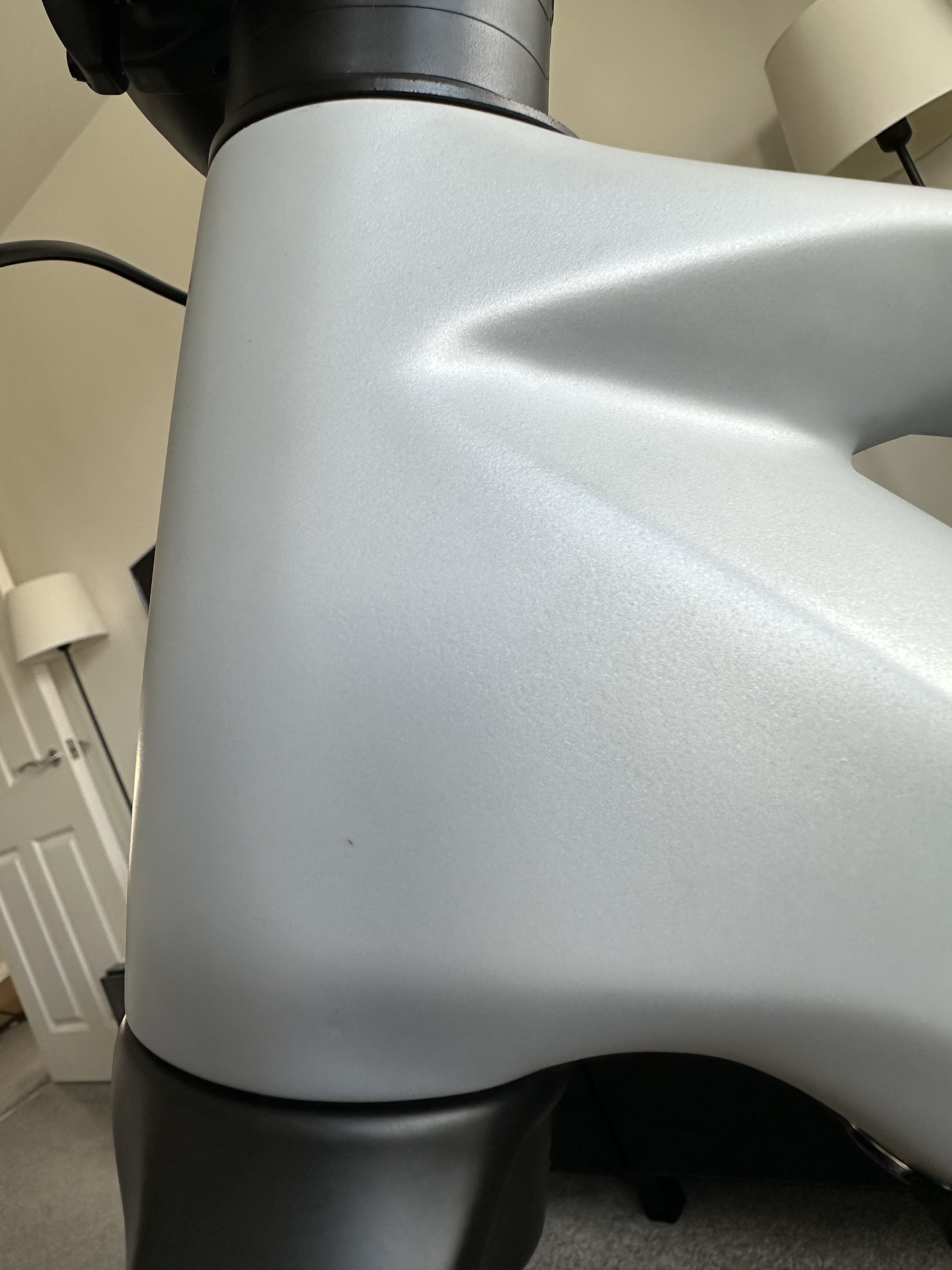

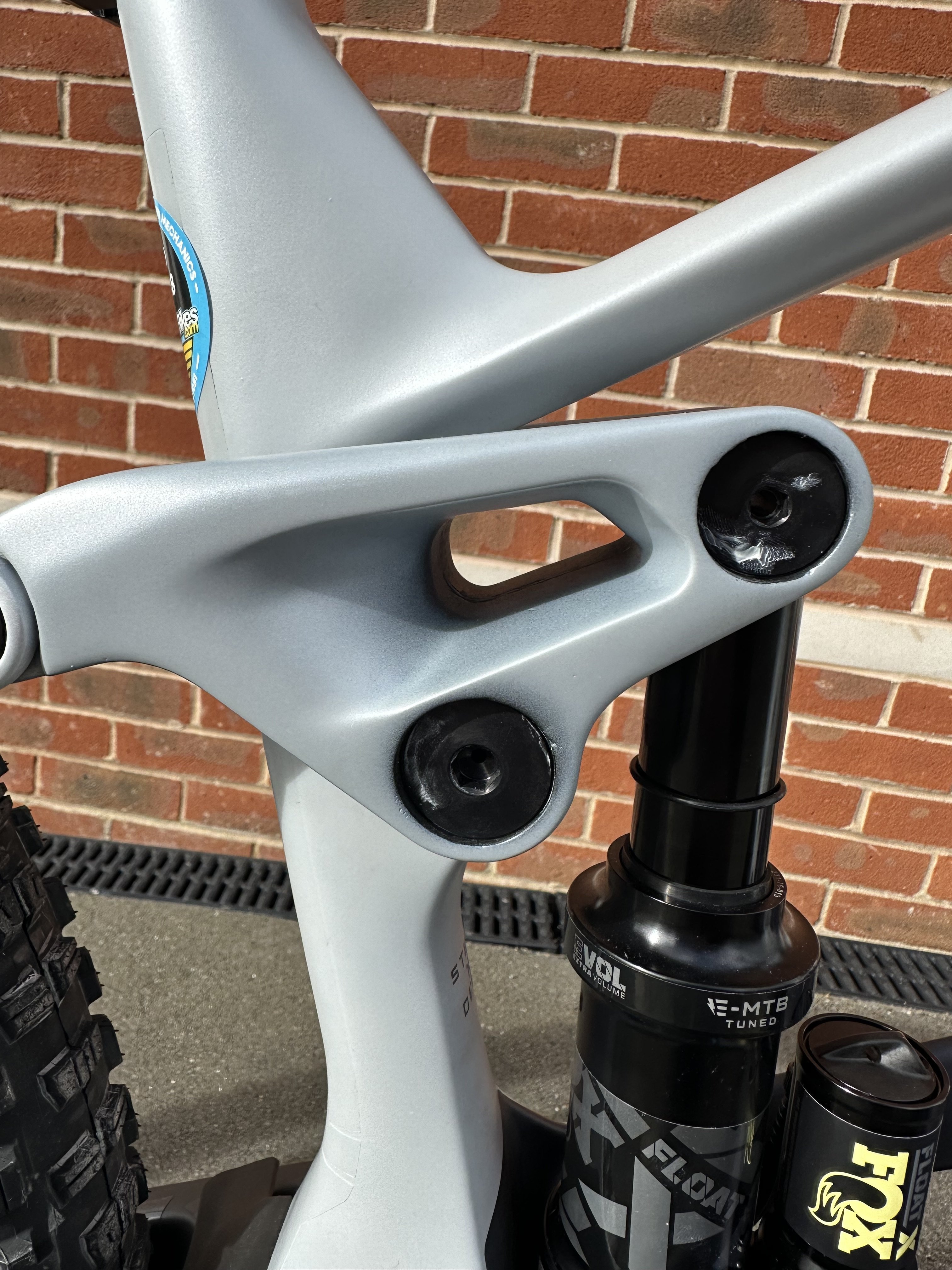

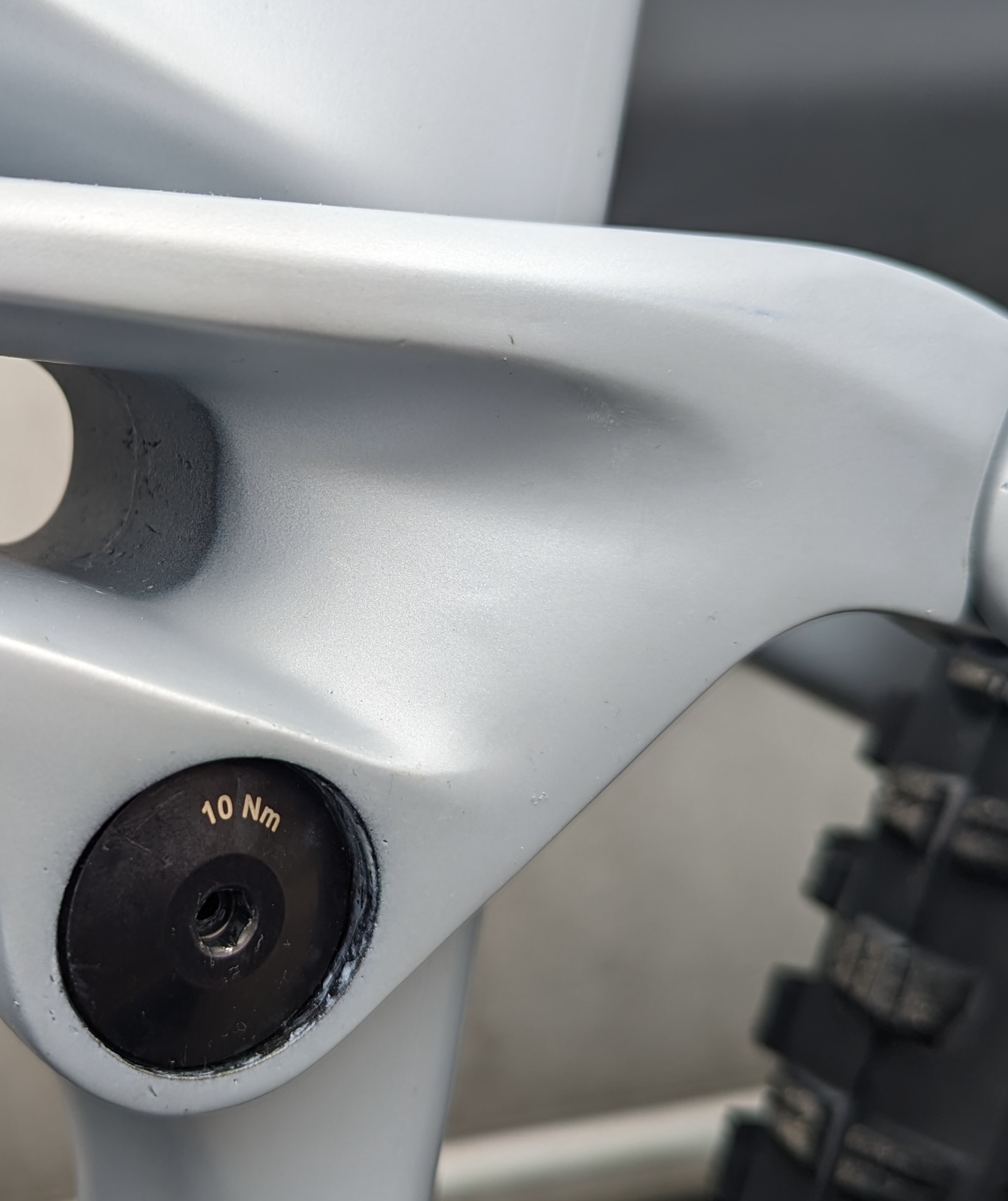

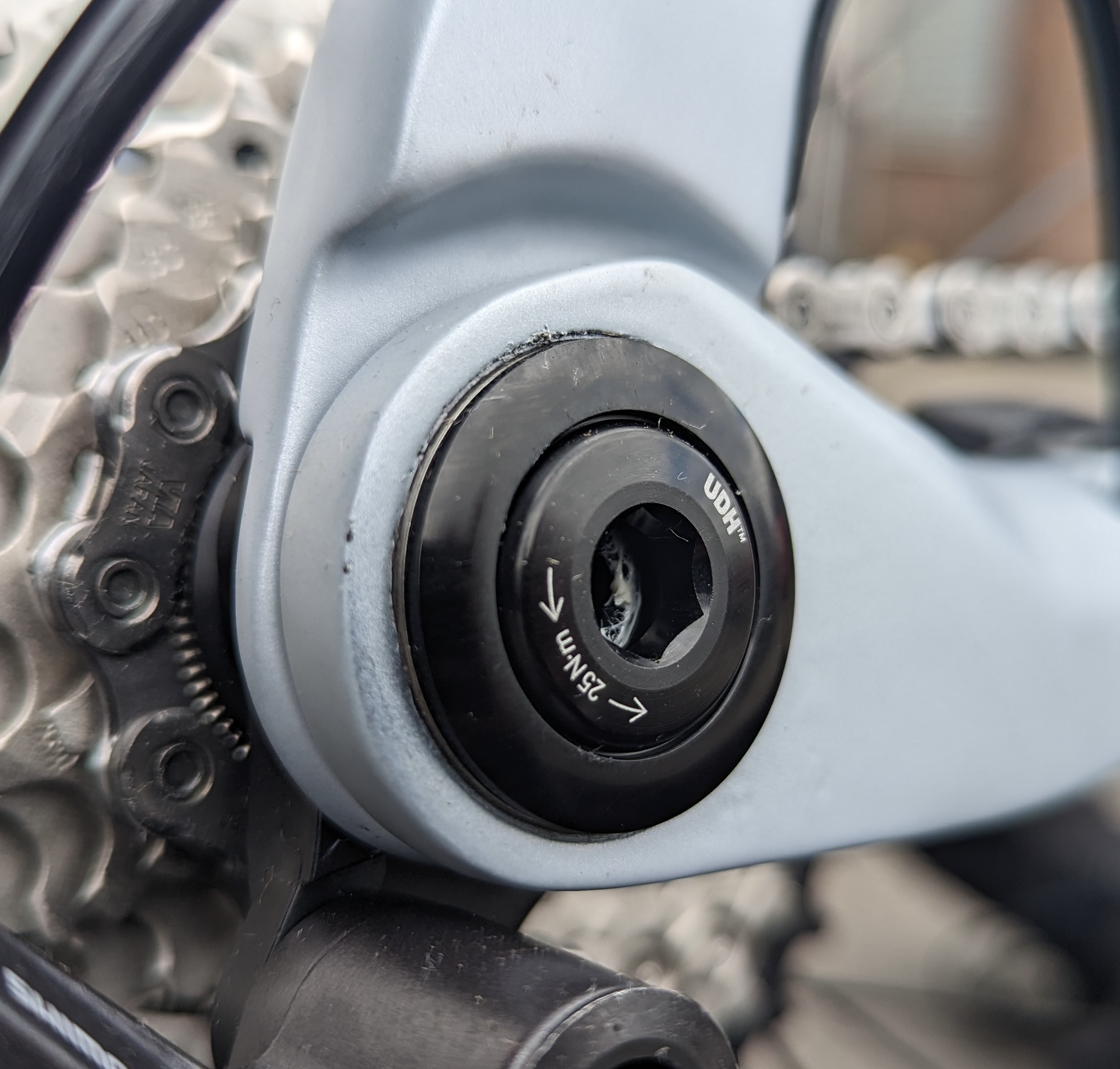

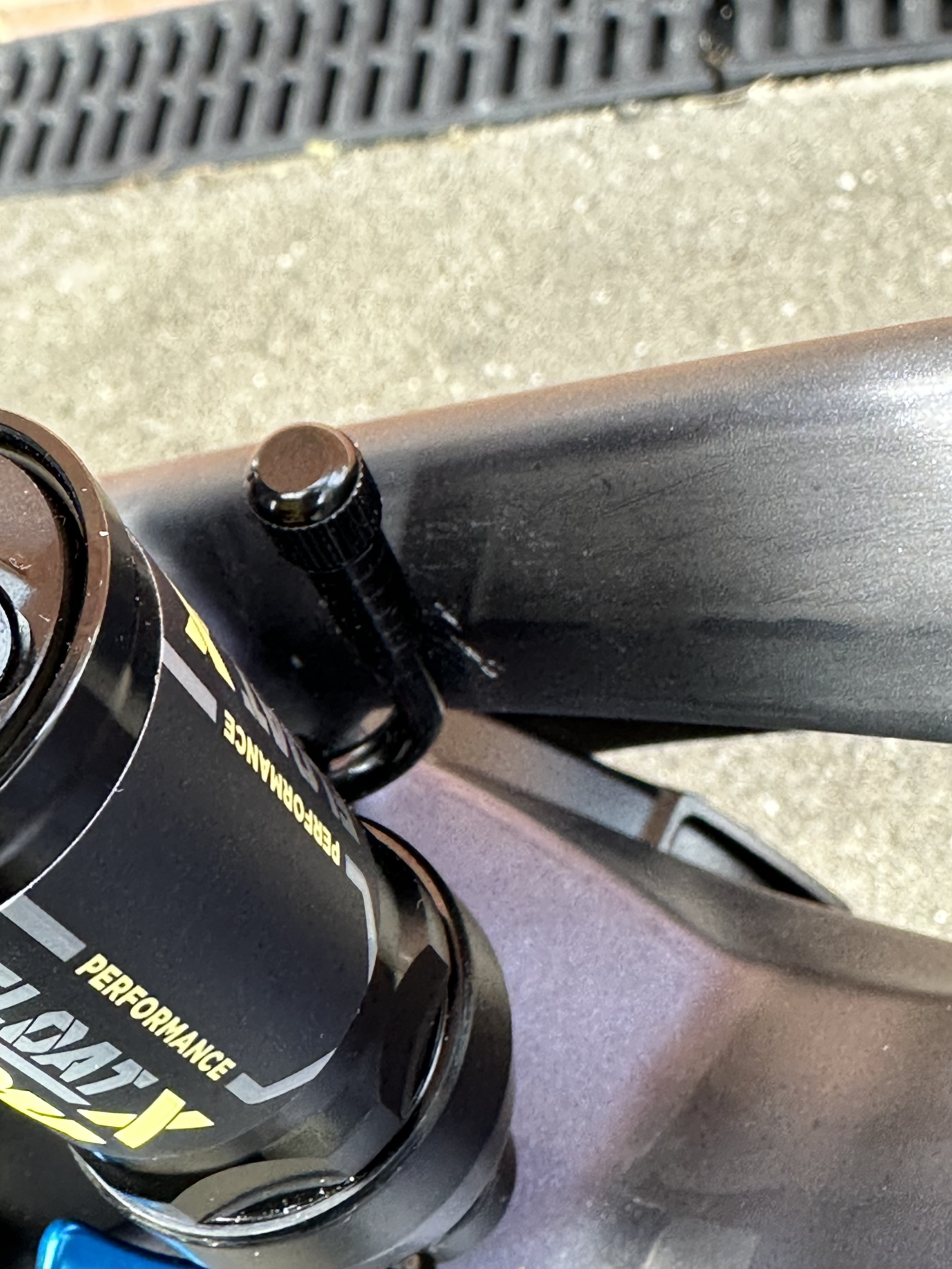

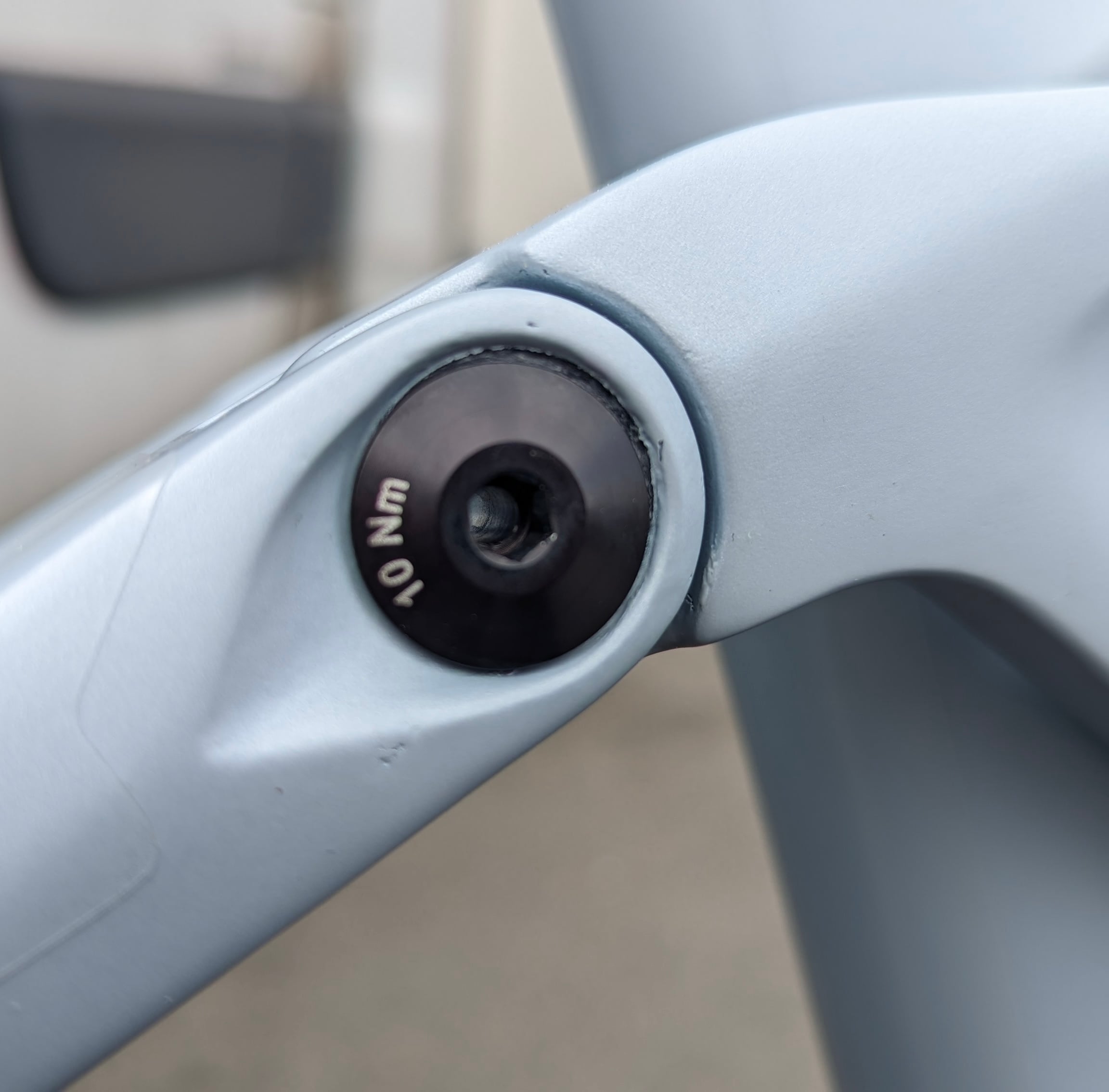

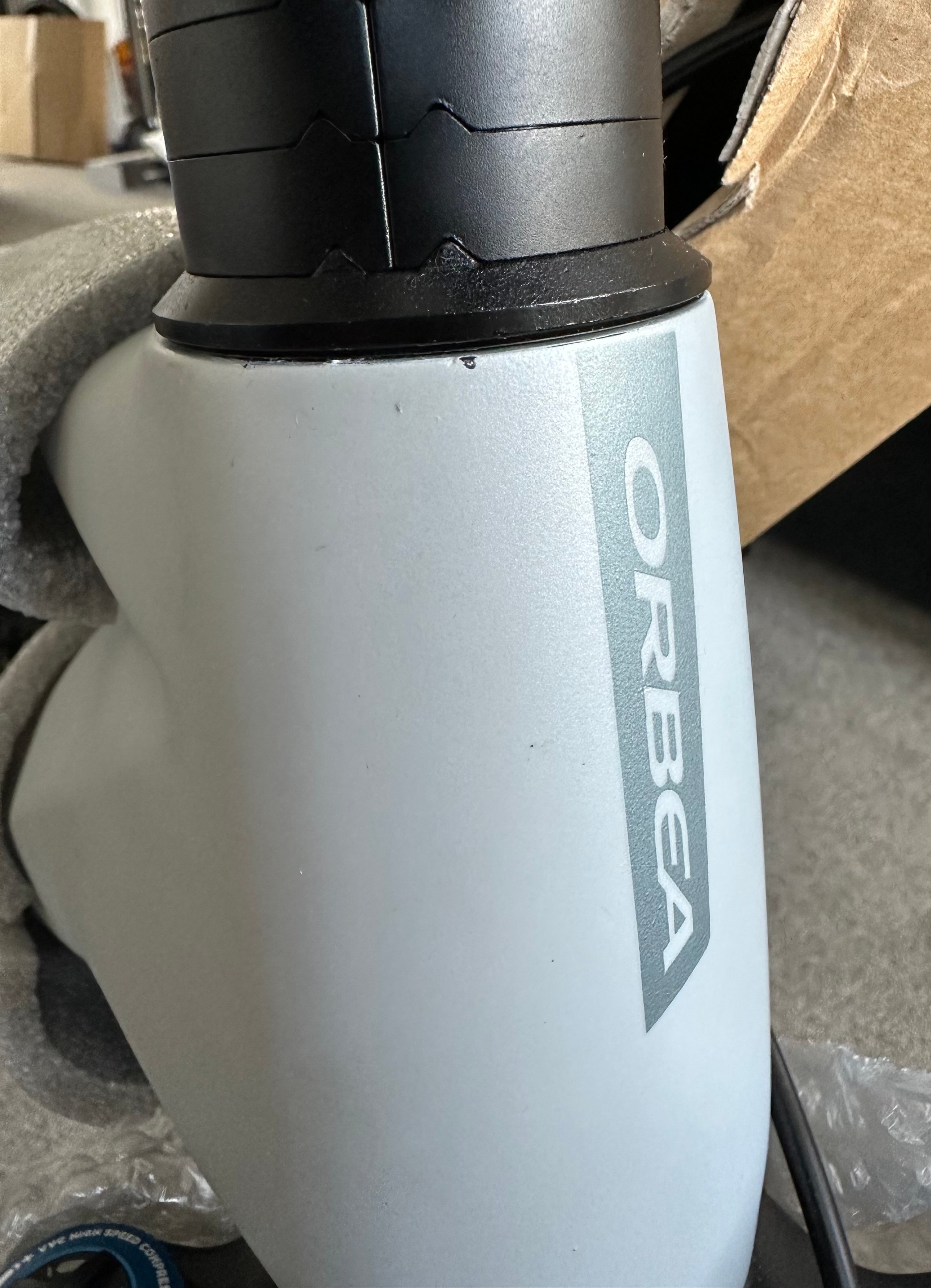

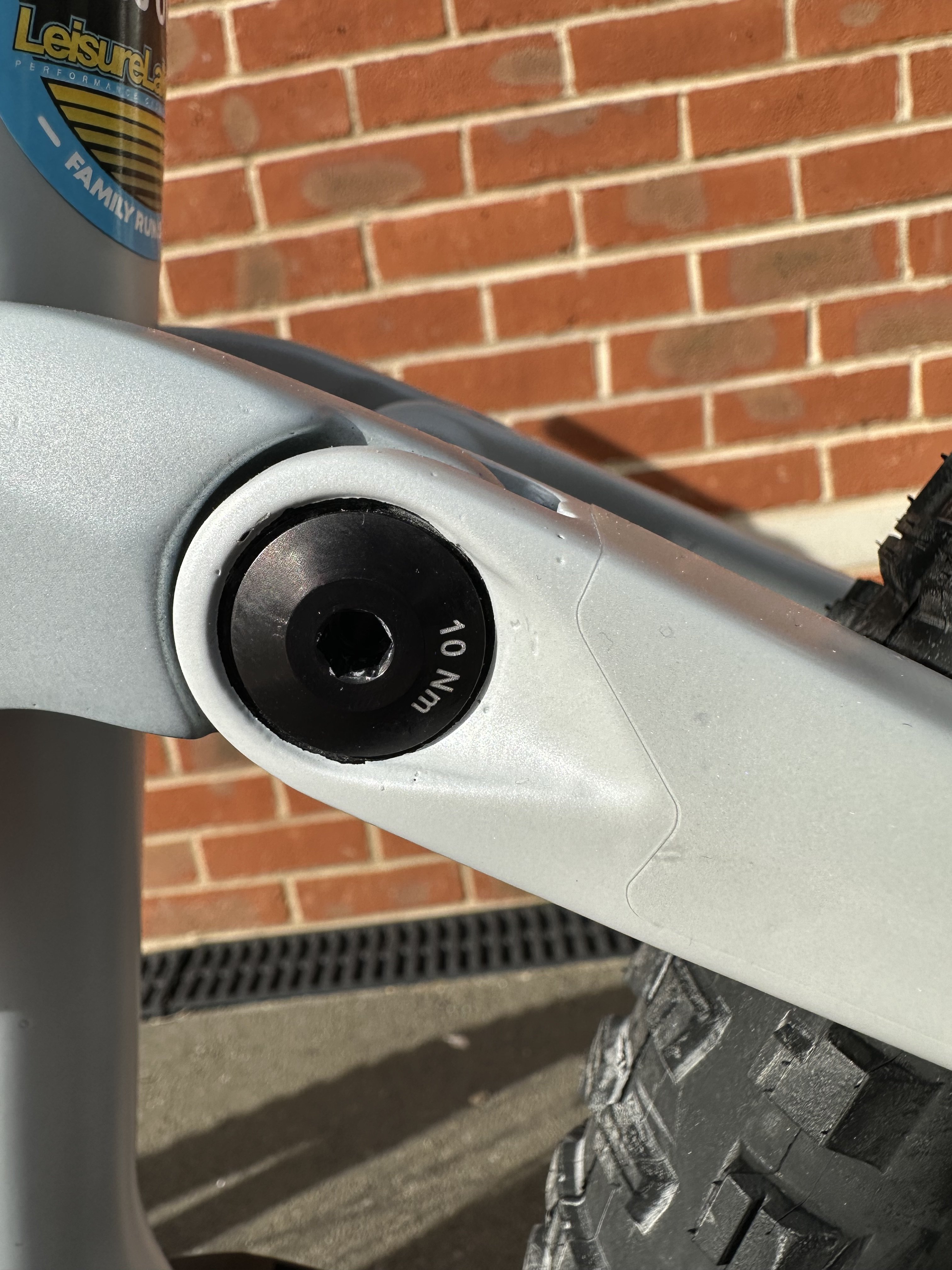

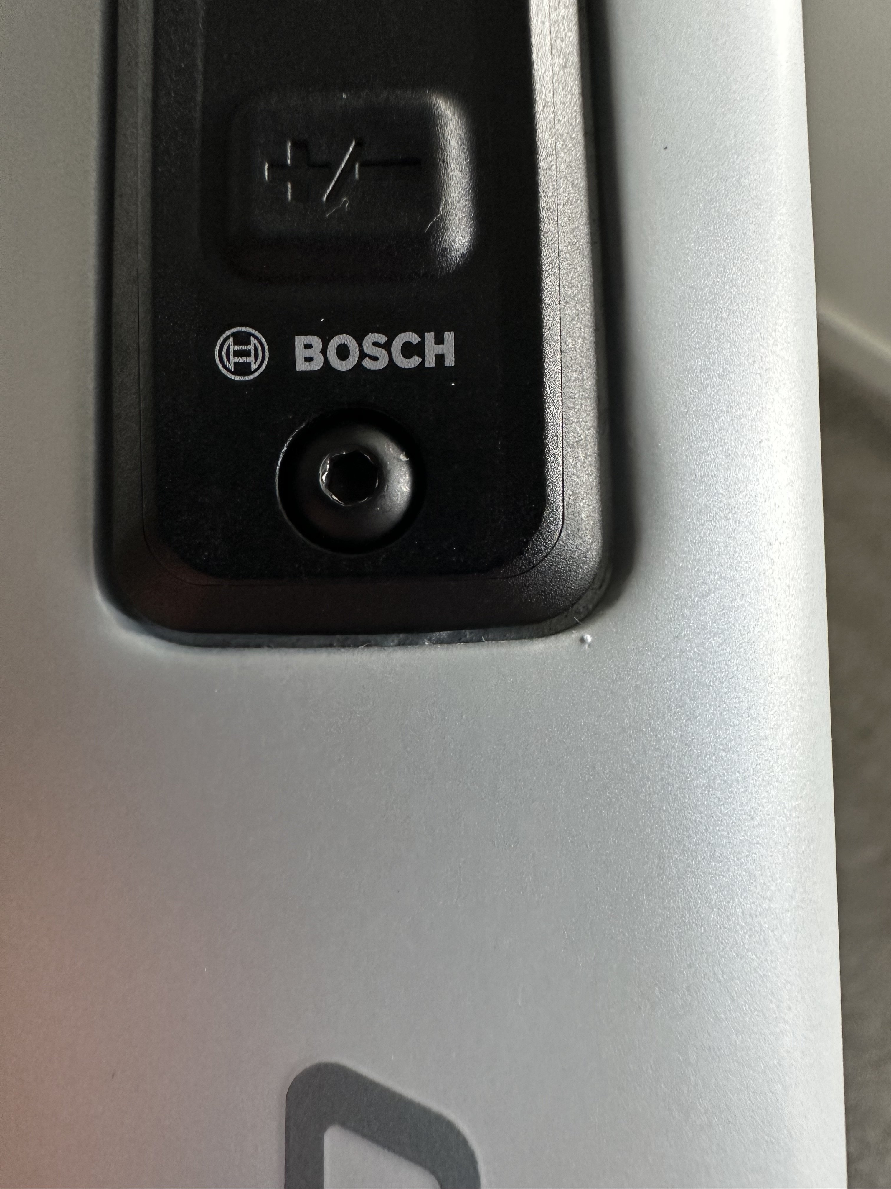

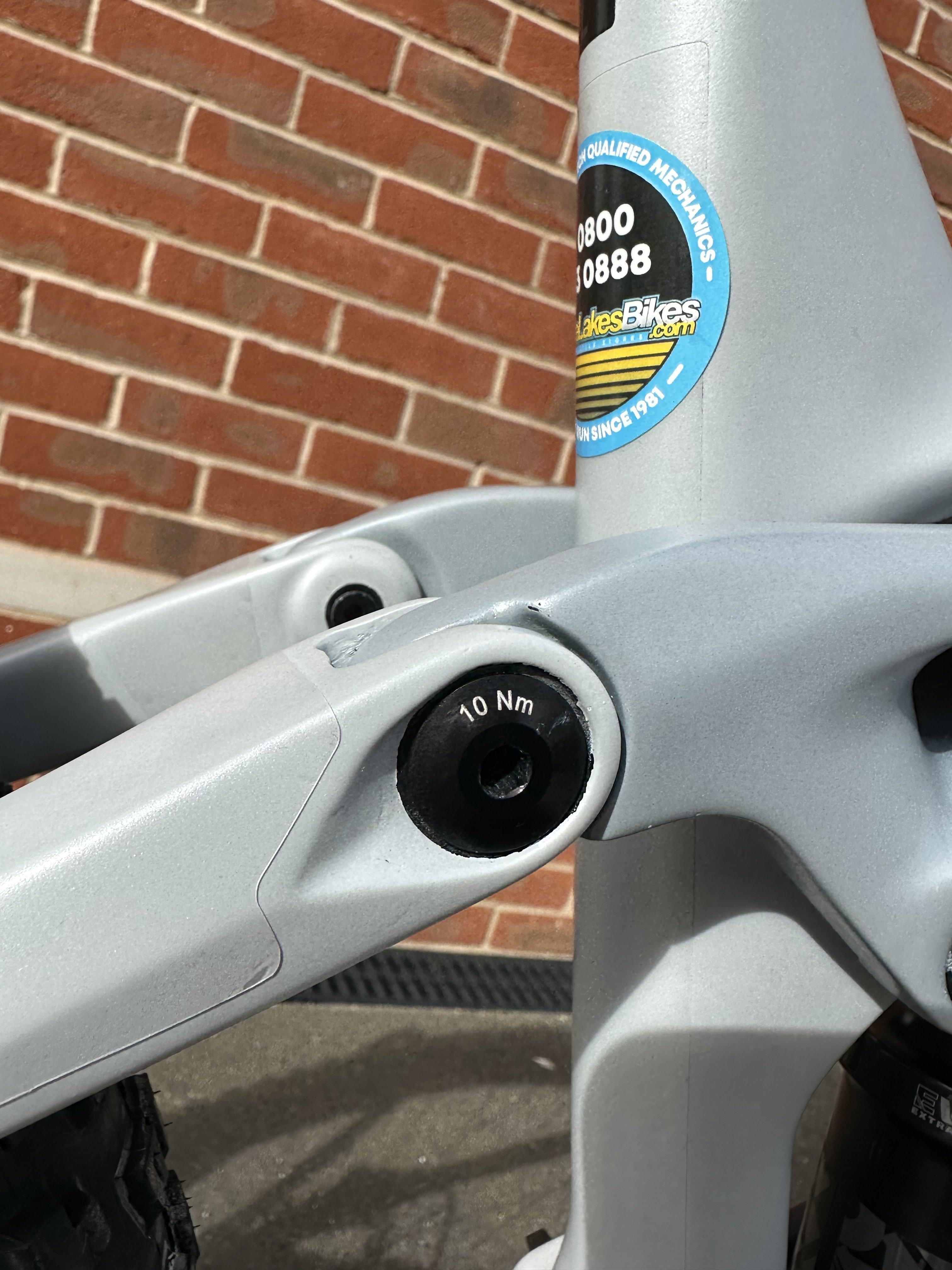

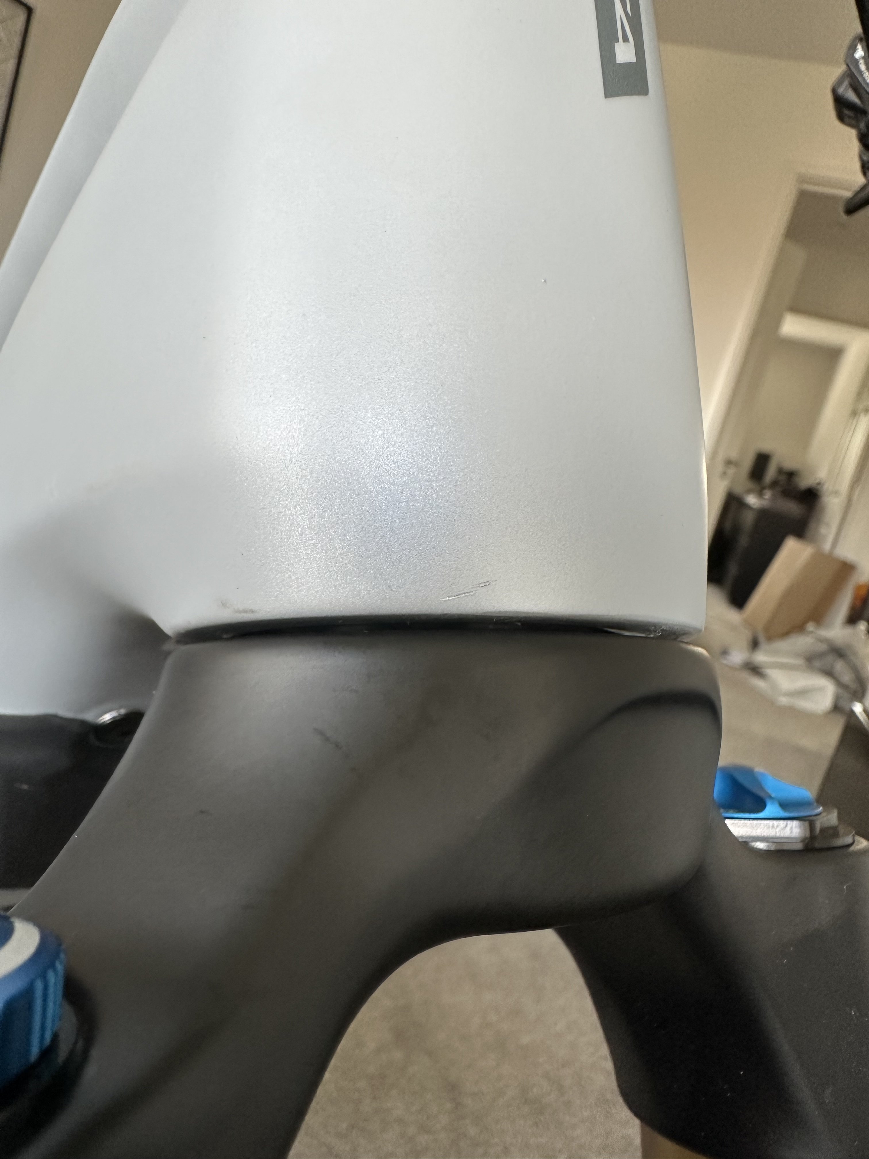

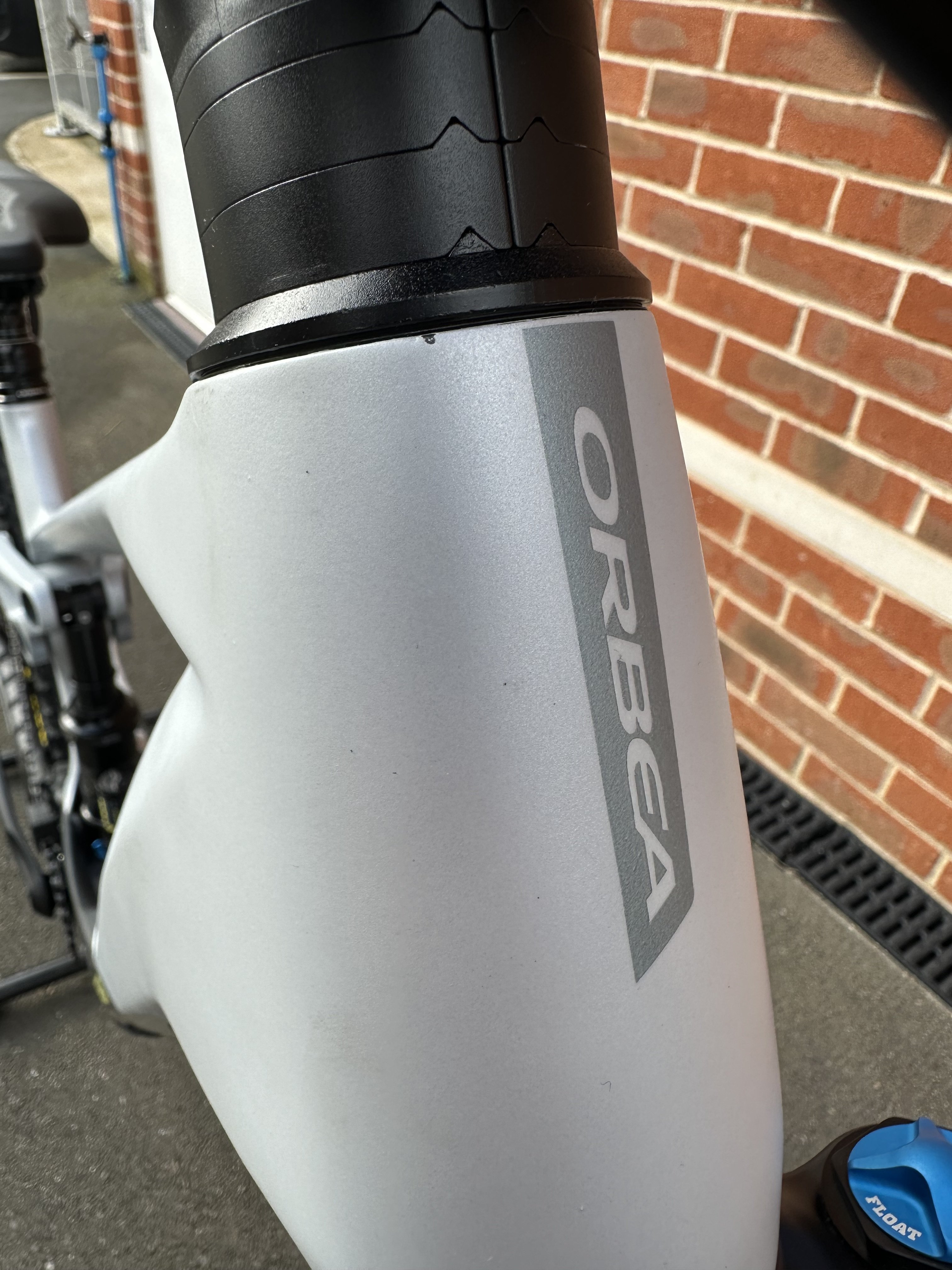

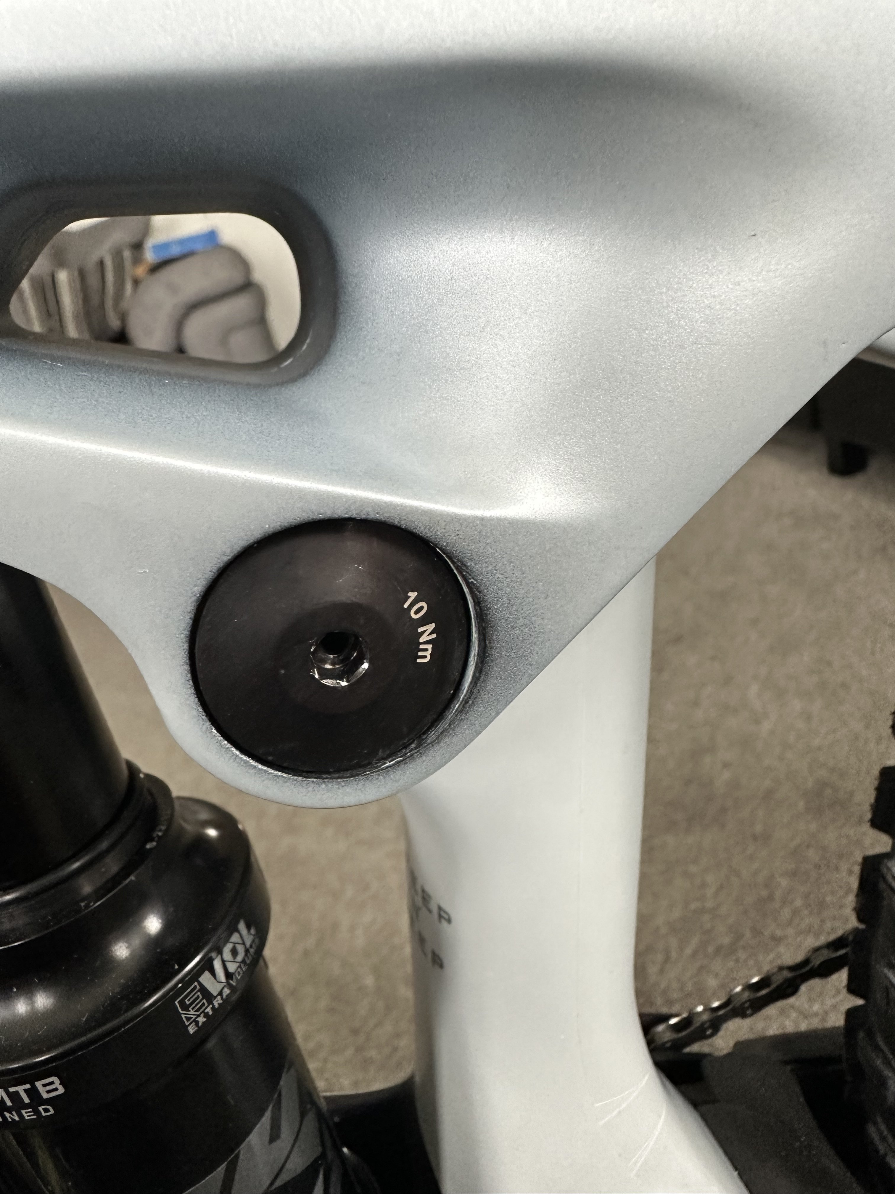

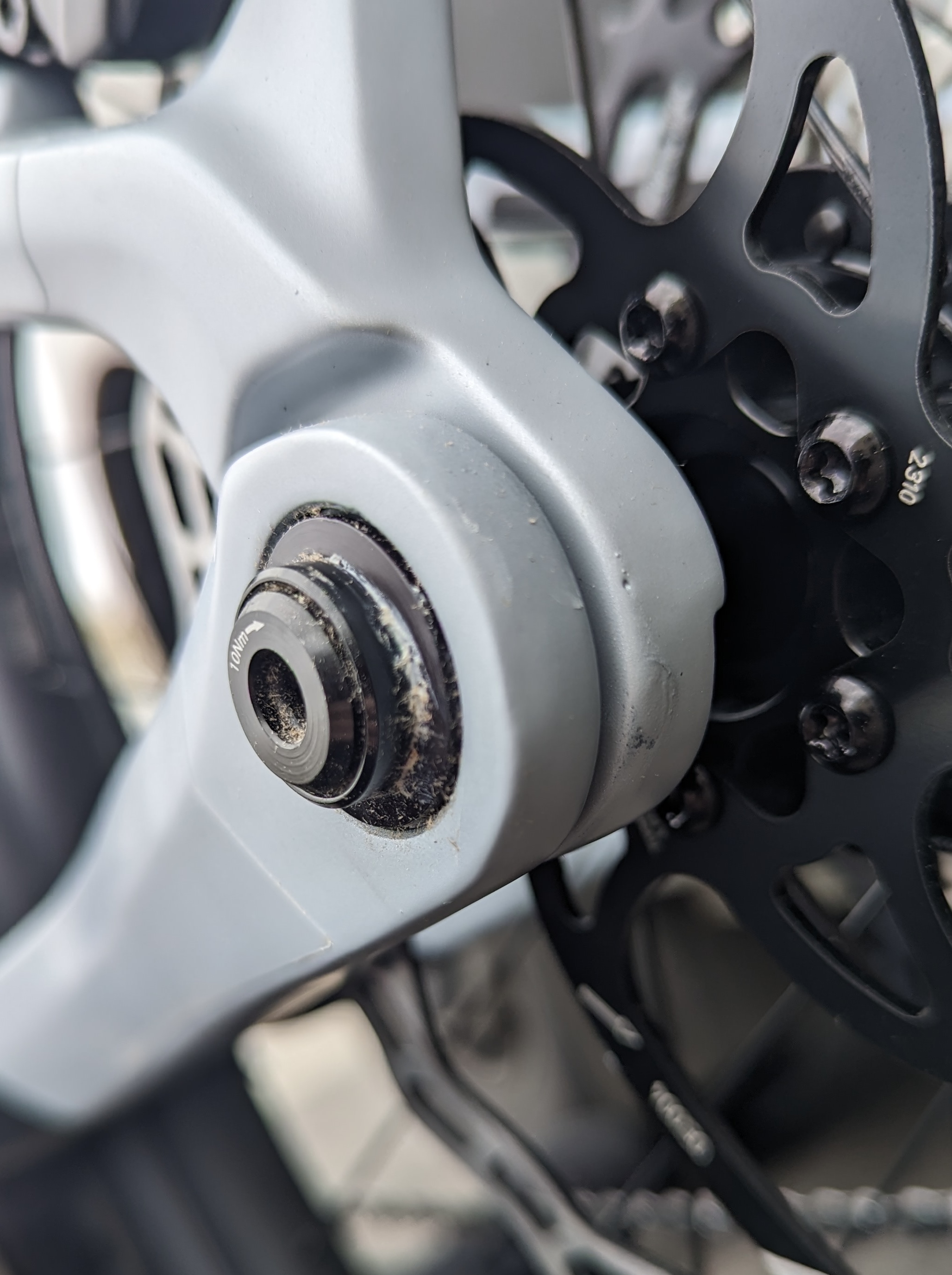

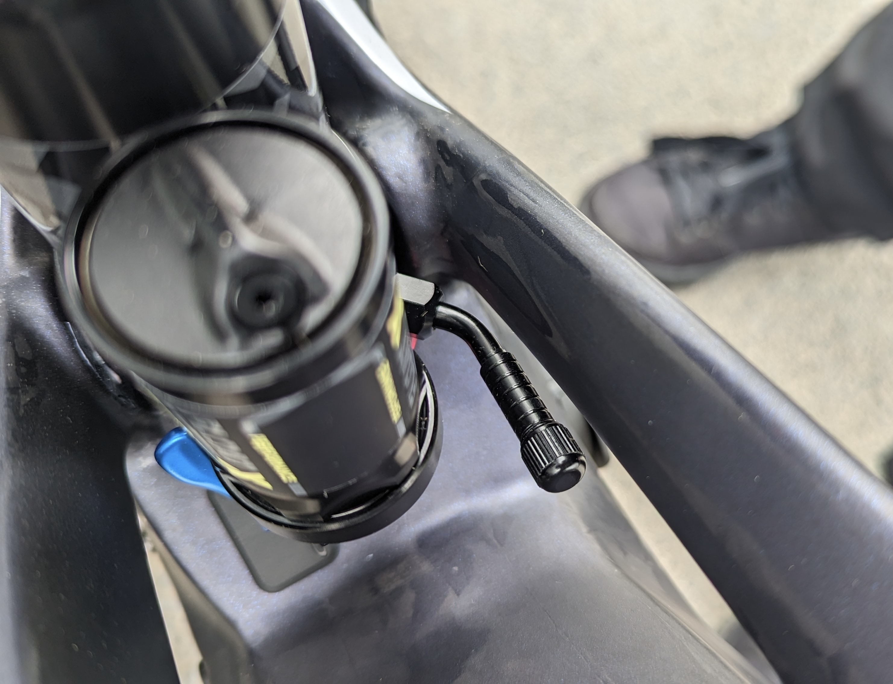

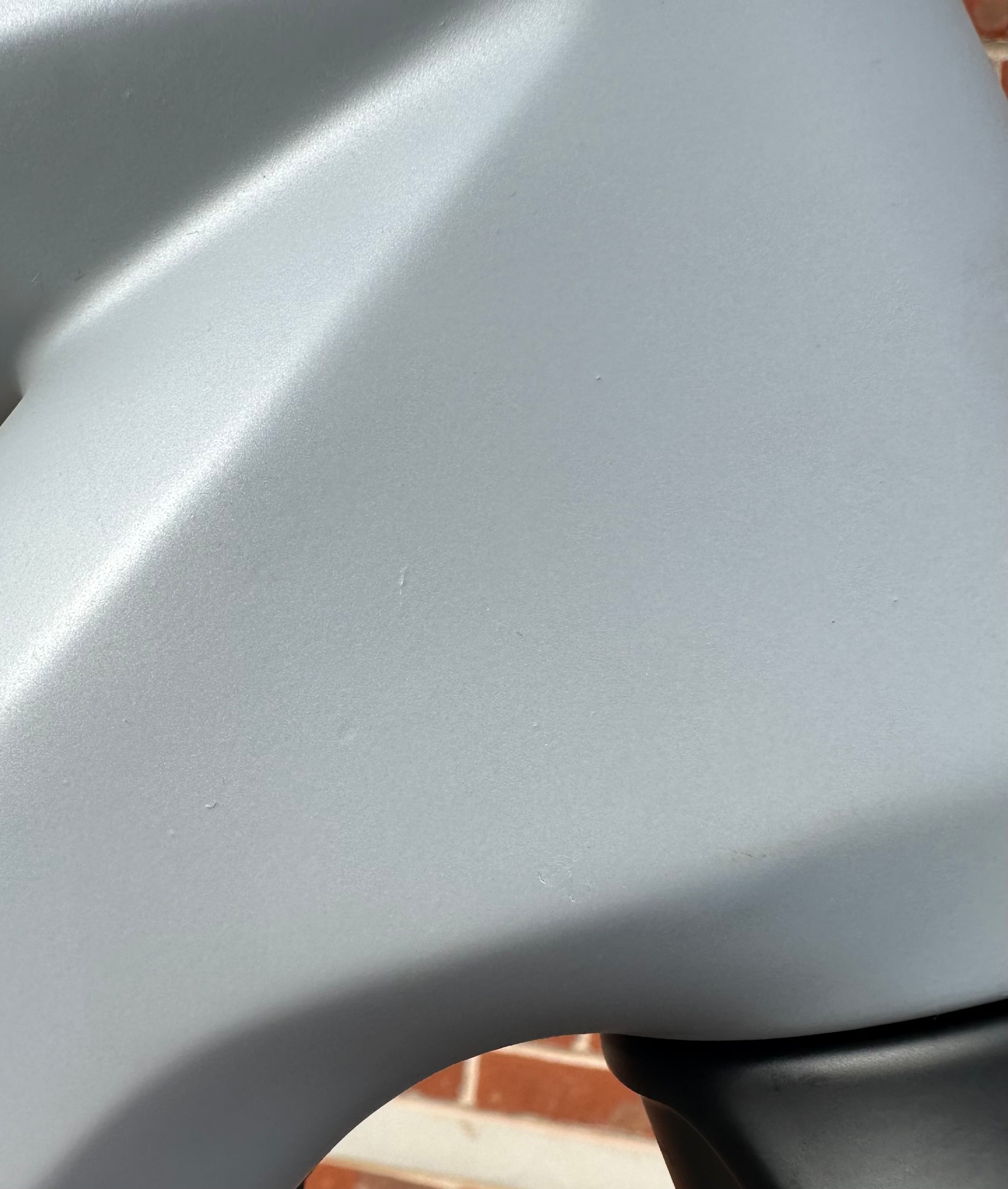

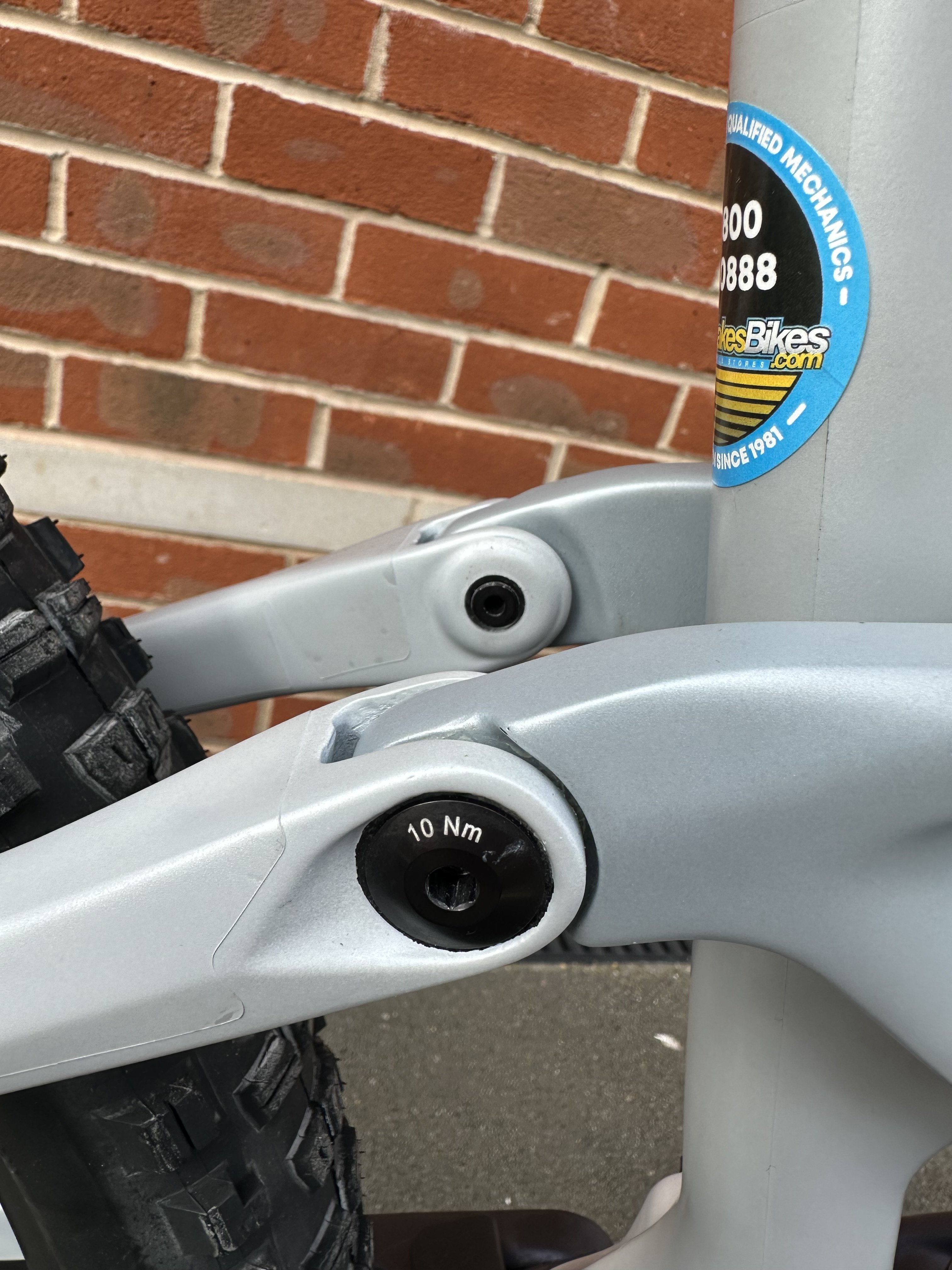

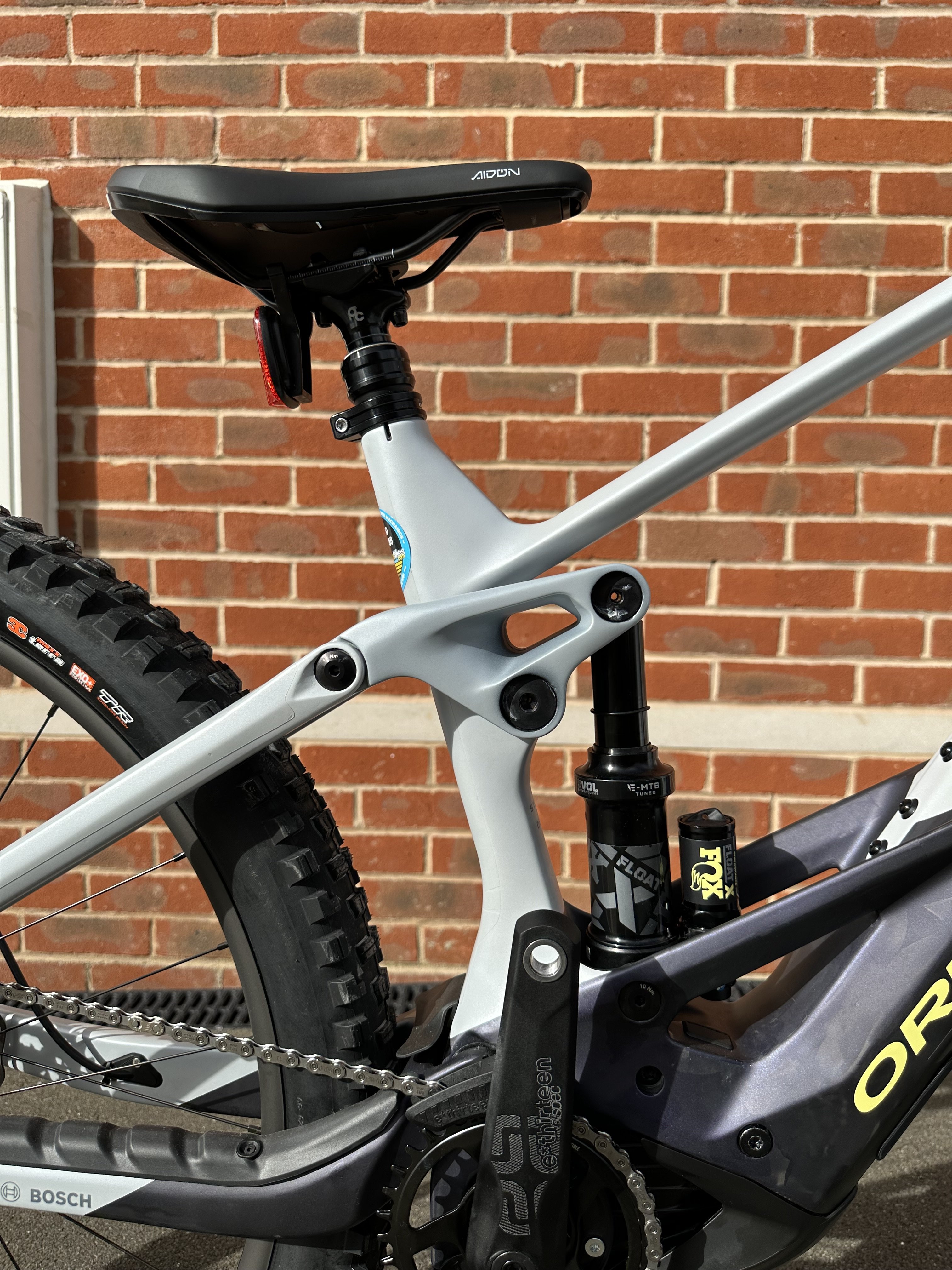

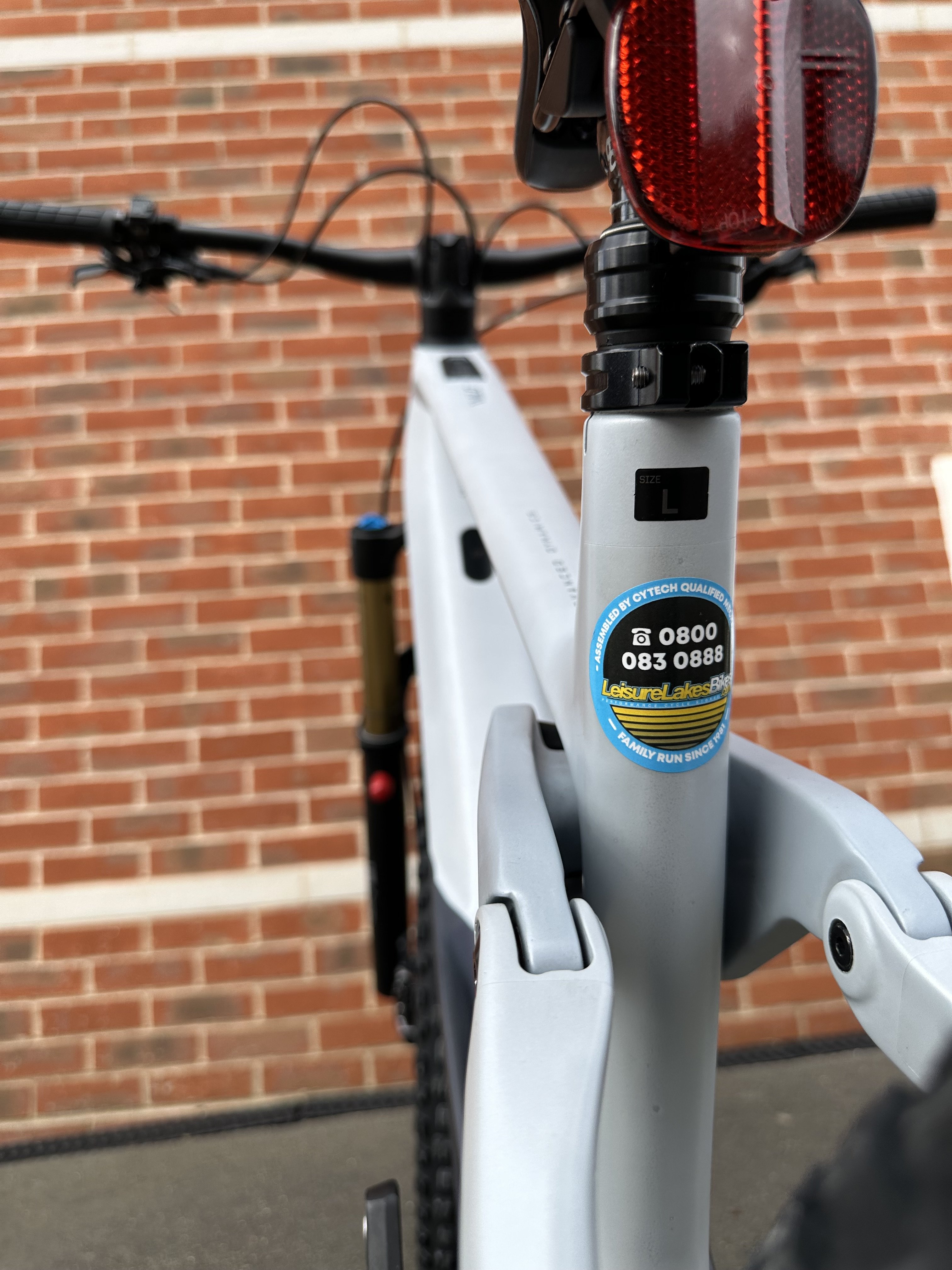

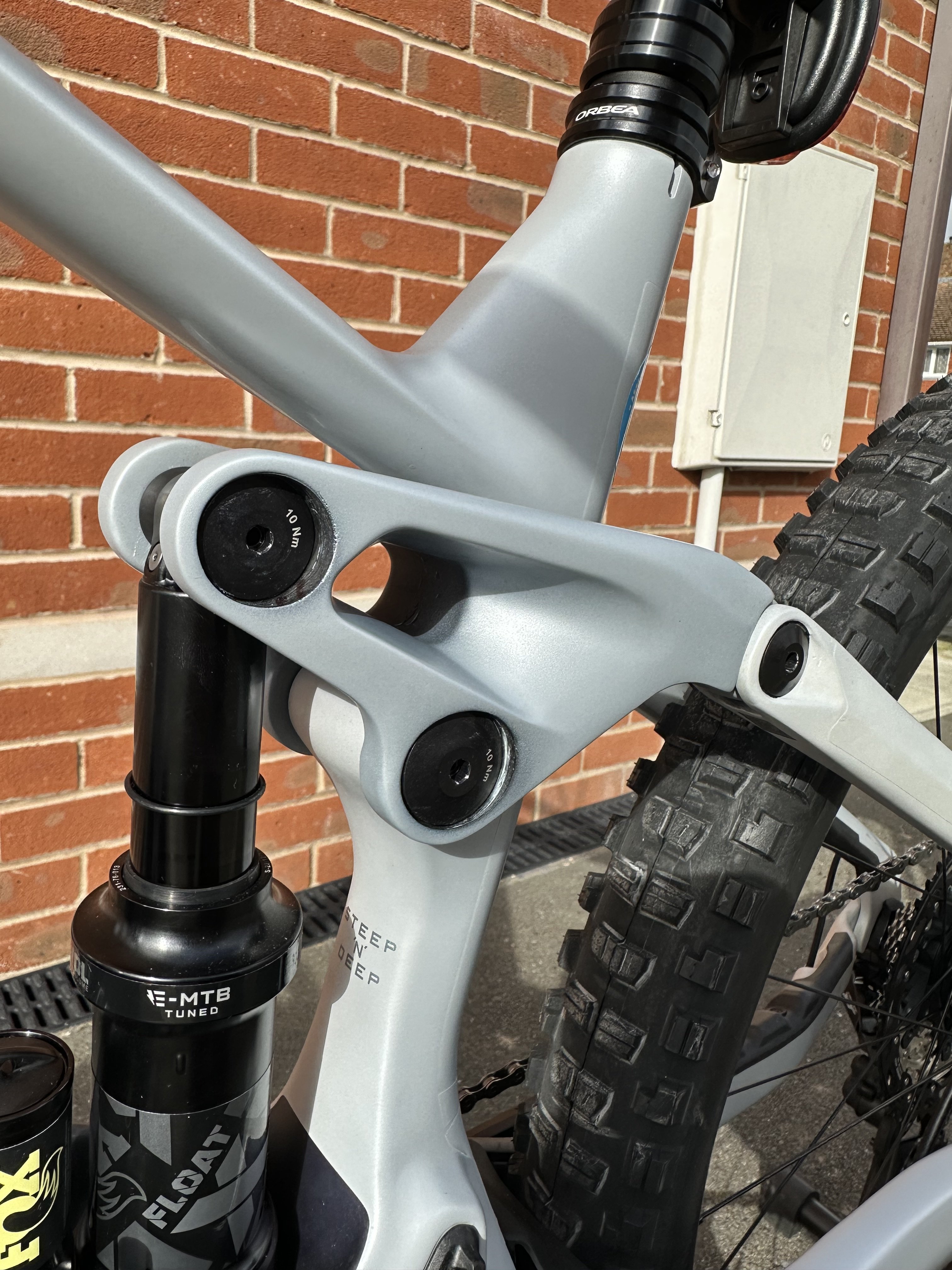

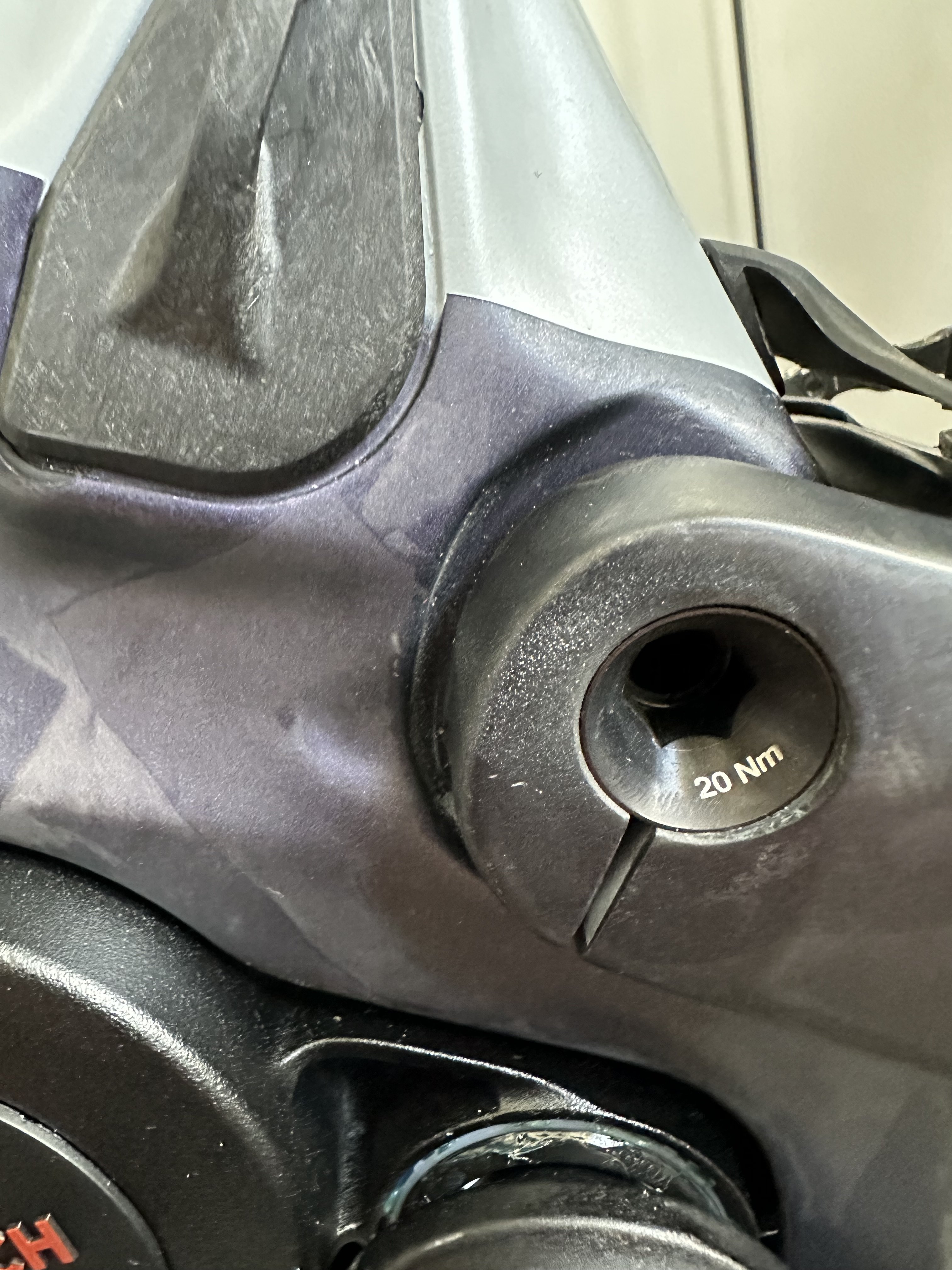

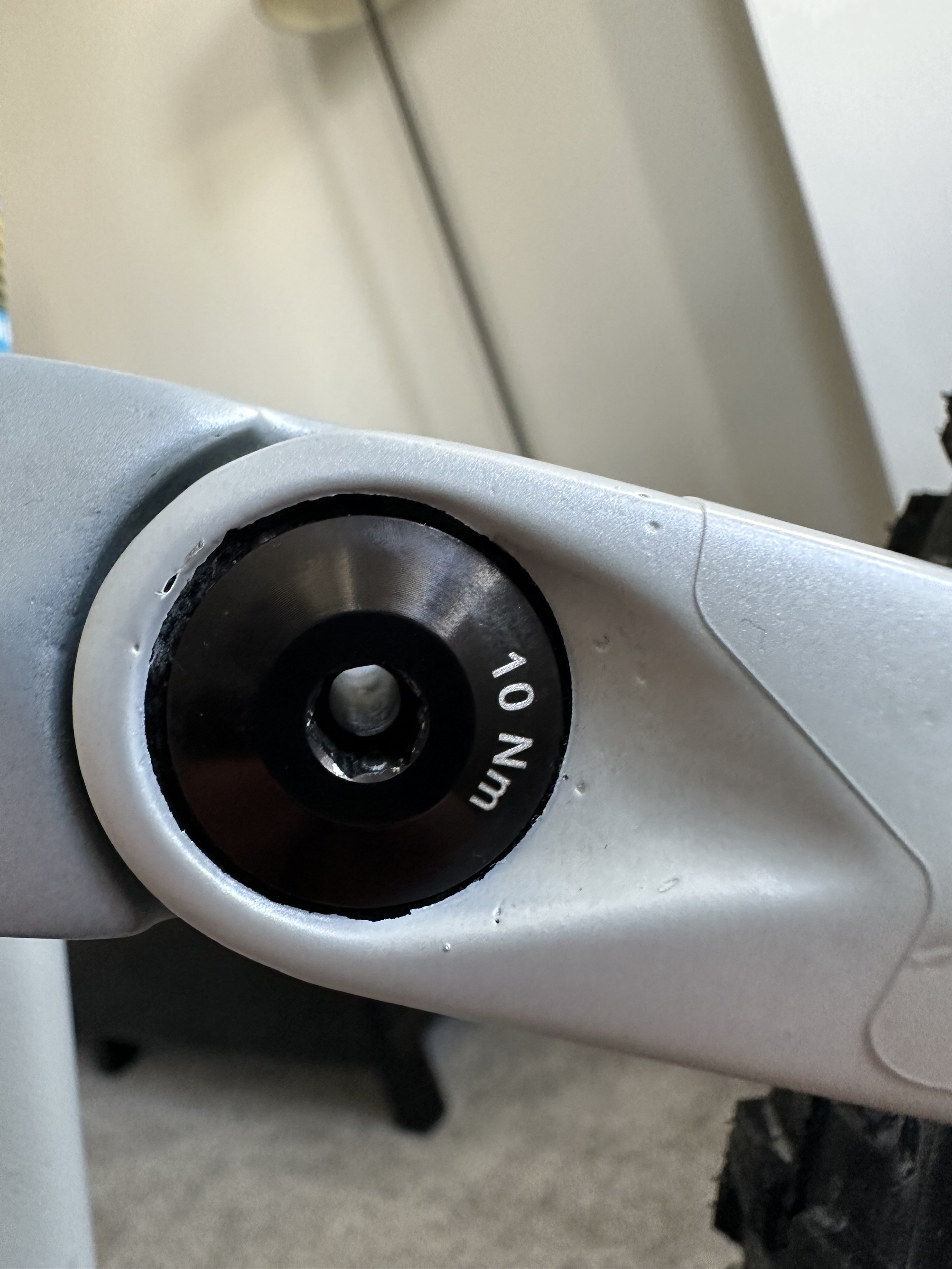

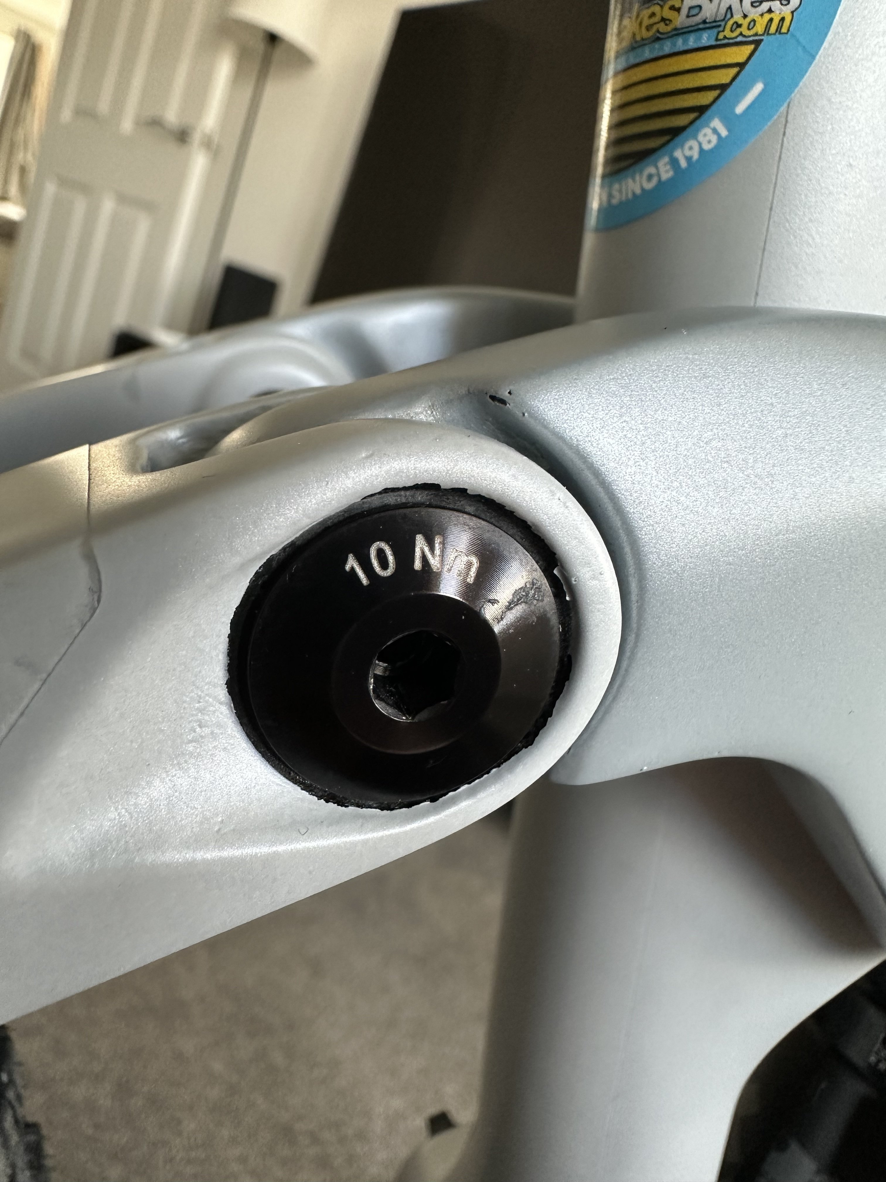

Bike one:
IMG_4040.jpeg IMG_4069.jpeg IMG_4070.jpeg IMG_4071.jpeg IMG_4073.jpeg IMG_4077.jpeg IMG_4169.jpeg IMG_4166.jpeg IMG_4163.jpeg IMG_4170.jpeg IMG_4172.jpeg IMG_4173.jpeg IMG_4174.jpeg IMG_4176.jpeg IMG_4180.jpeg IMG_4181.jpeg IMG_4111.jpeg IMG_4114.jpeg IMG_4115.jpeg IMG_4118.jpeg IMG_4120.jpeg IMG_4124.jpeg IMG_4127.jpeg IMG_4128.jpeg IMG_4129.jpeg IMG_4131.jpeg IMG_4133.jpeg IMG_4135.jpeg IMG_4136.jpeg IMG_4112.jpeg
Orbea QC
Jun 4, 2019
261
333
Surrey, UK

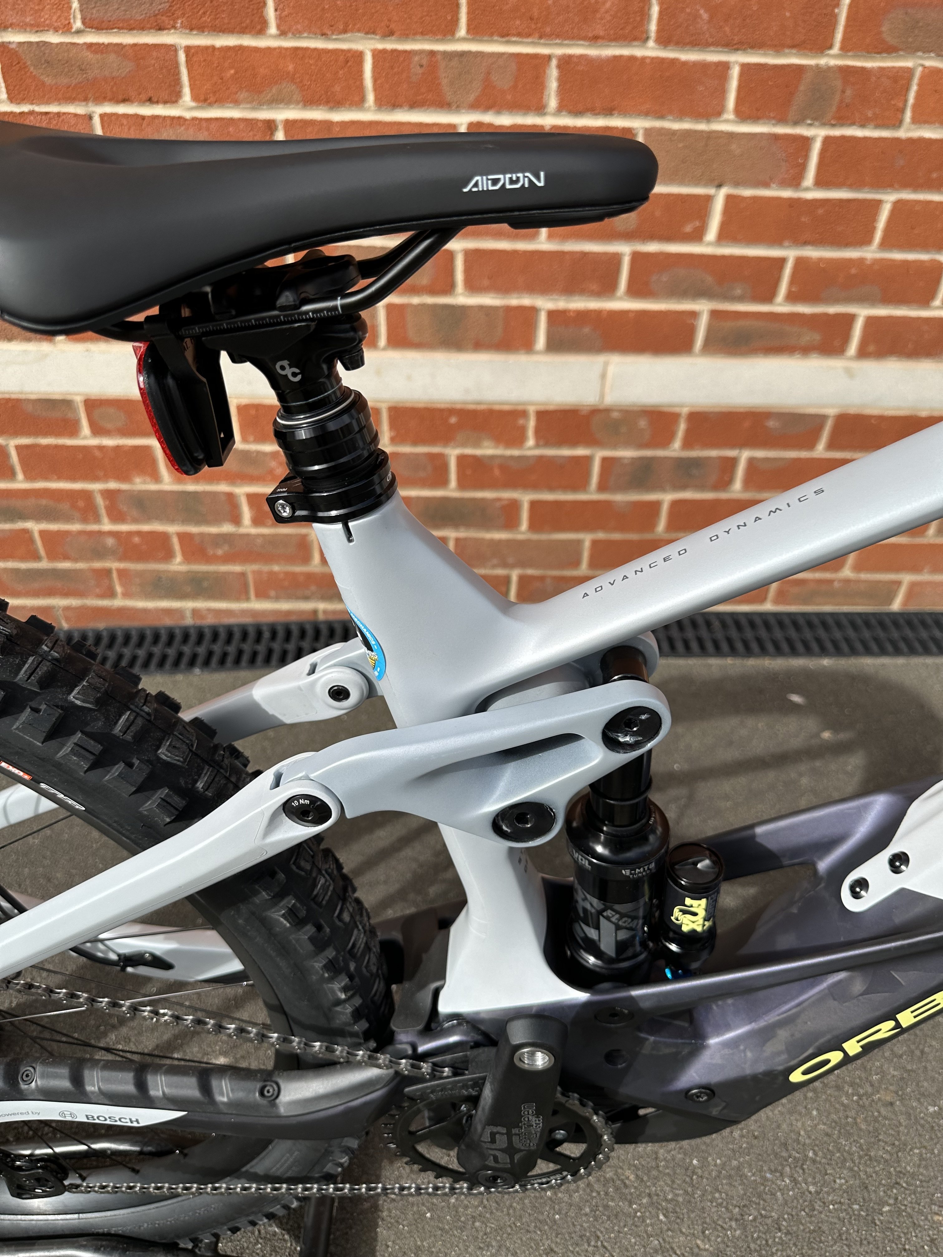

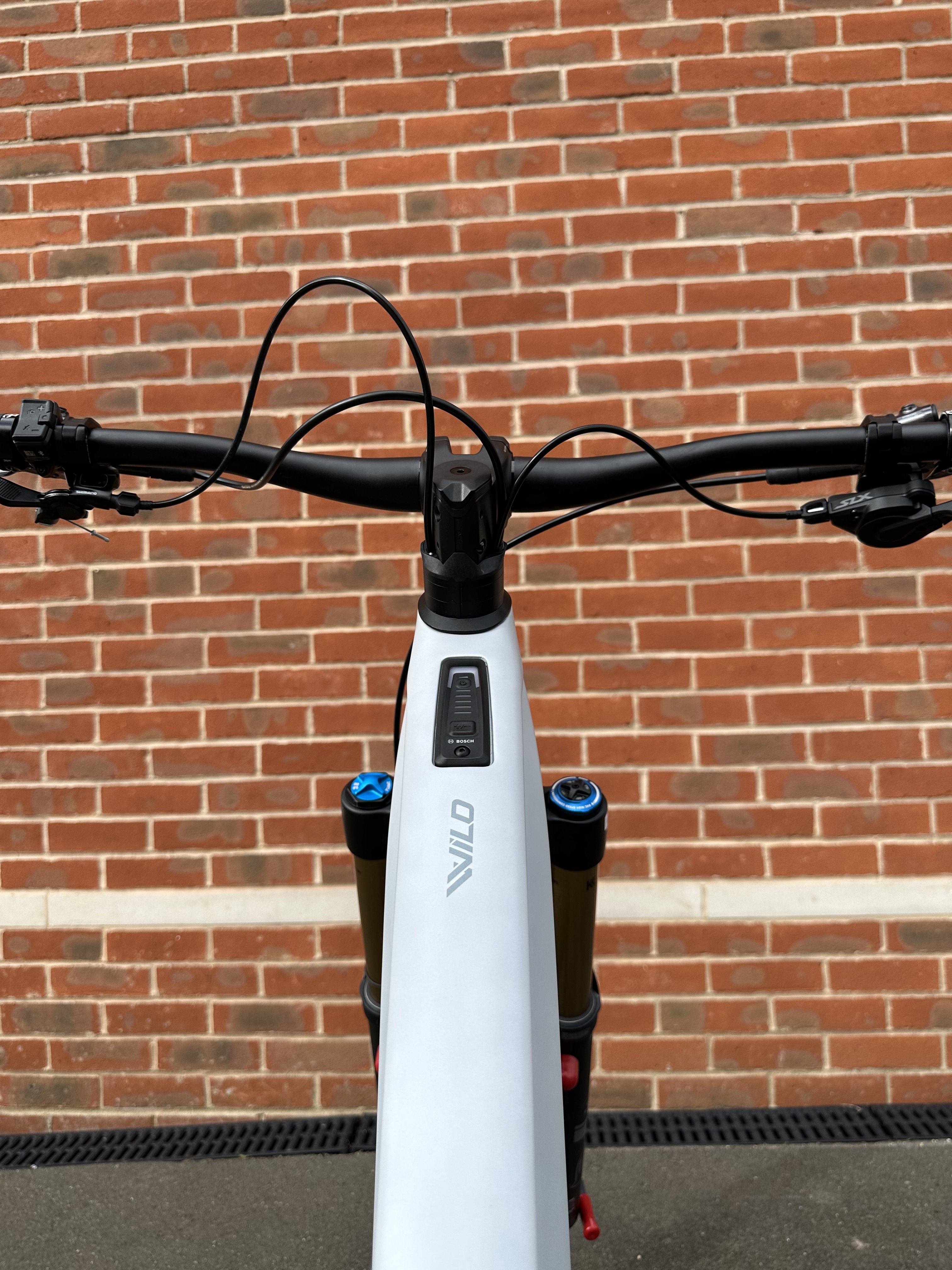

Both of these bikes were from Leisure Lake Bikes who I must say are absolutely useless and I highly recommend NOT buying a bike from them. When I sent the first bike back they actually listed it on their website as ex display:
I’m shocked that Orbea quality control allowed this to be shipped twice and I’d have real concerns about buying a 2023 Wild right now.
Just as shocking is the state Leisure lake bikes shipped it to me, just look at the cable routing 🤯.

It's like they took your first bike back, stared at it, shrugged their shoulders, boxed it up and sent it straight back to you!
My frame is on the way back to the dealer from Orbea so should be built up and ready for me soon. I too have used Leisurelakesbikes but unlike you, my service so far has been decent... Will update once the bike arrives and I get a chance to look at the frame!

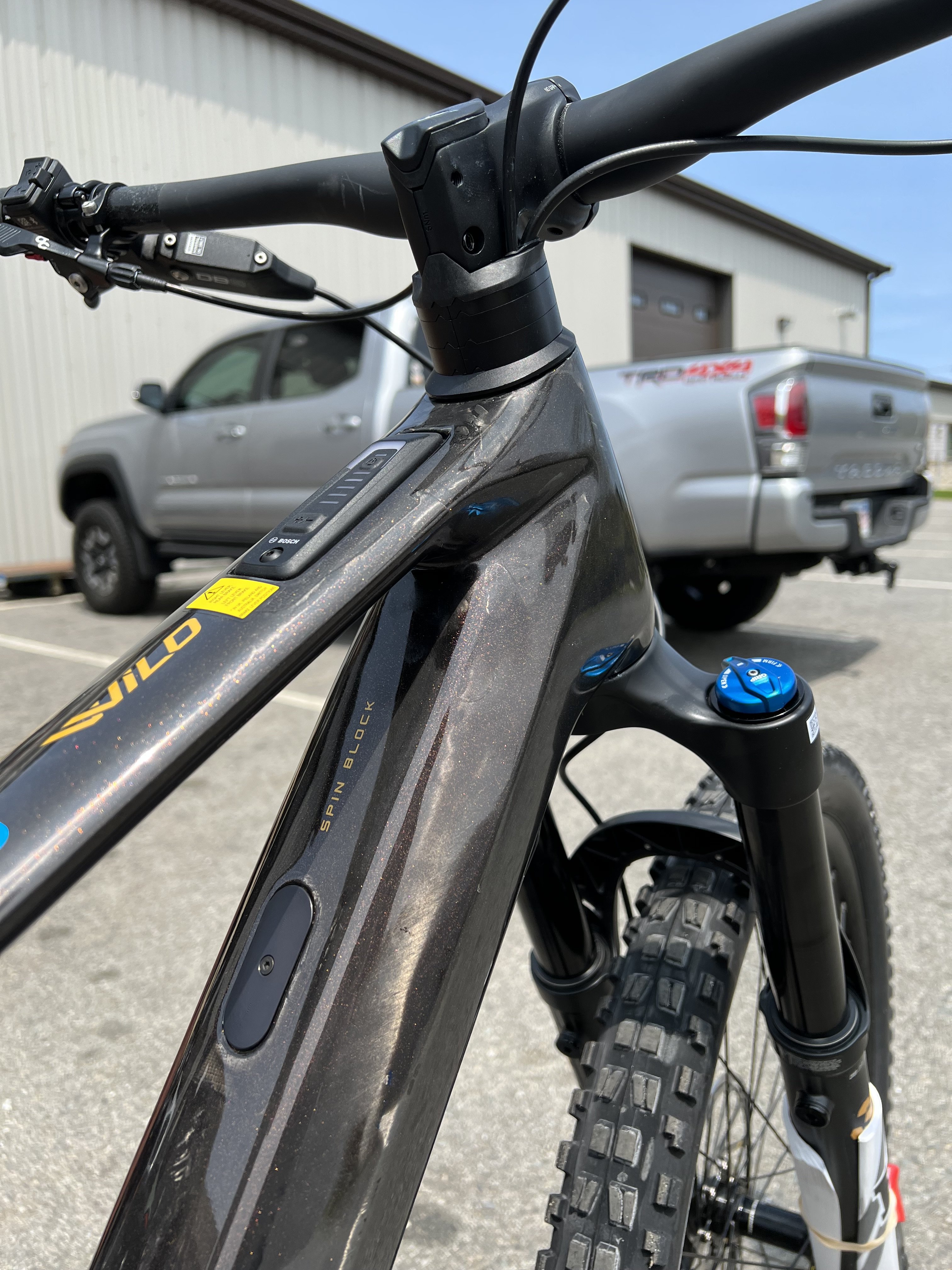

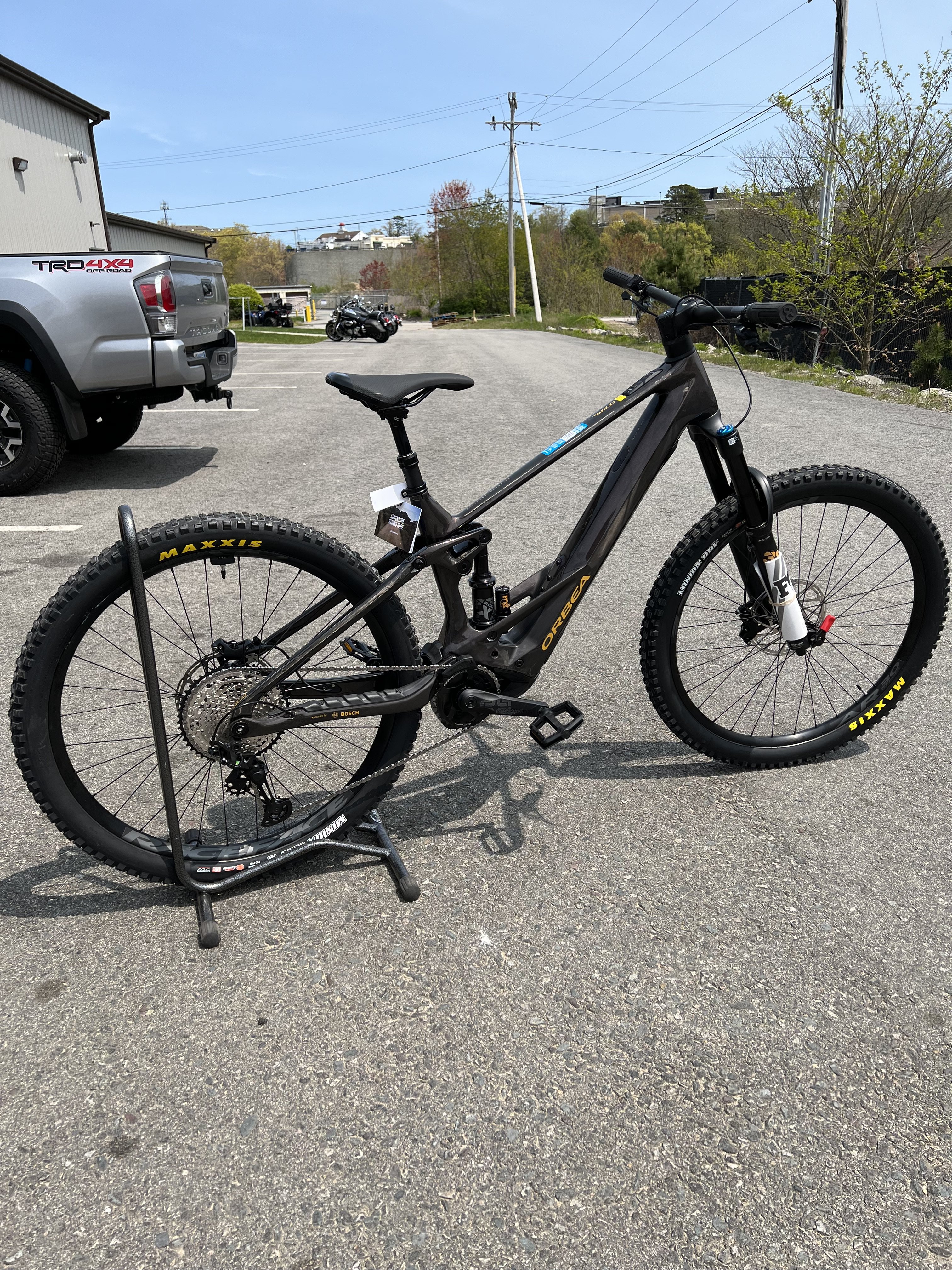

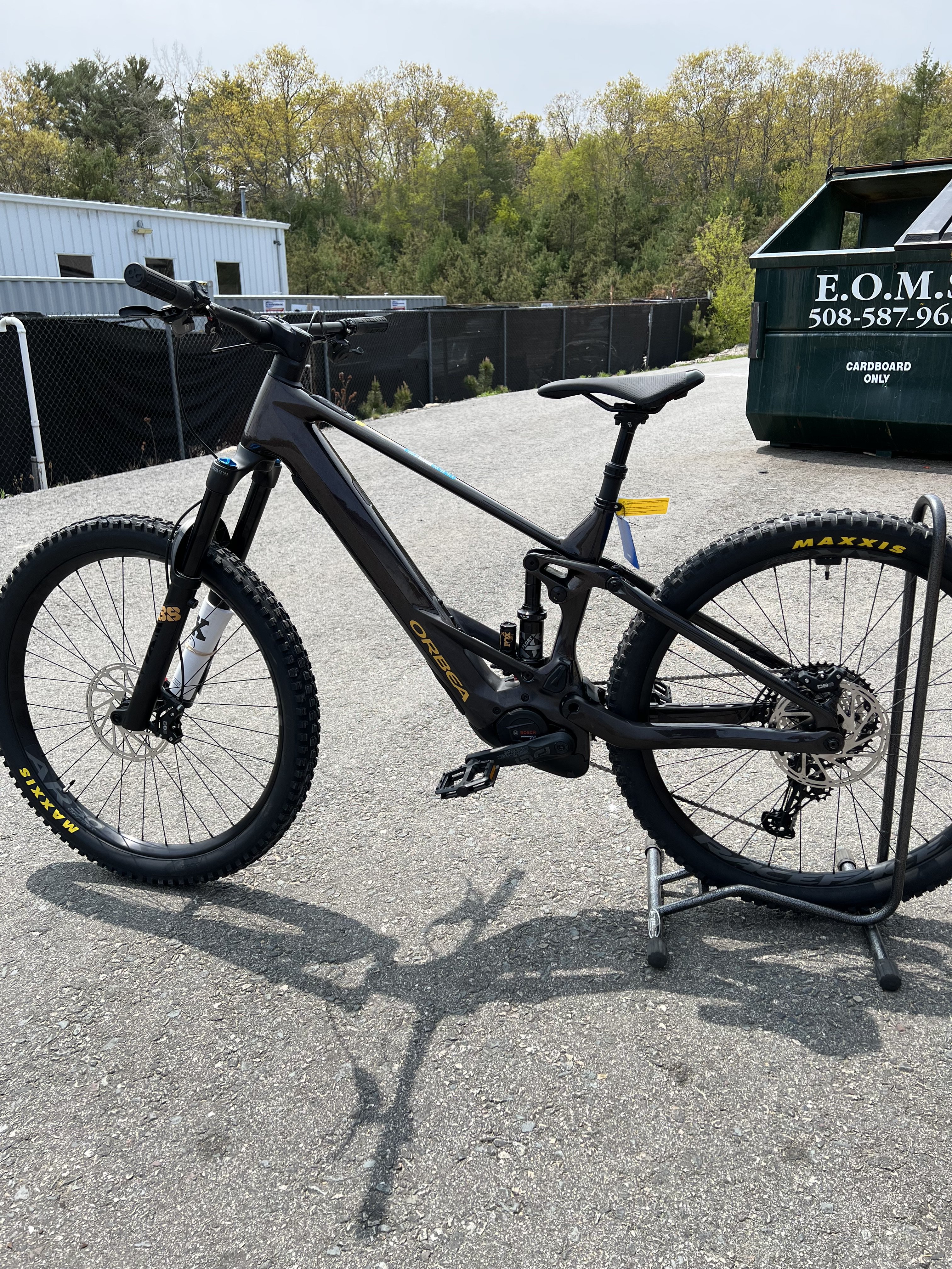

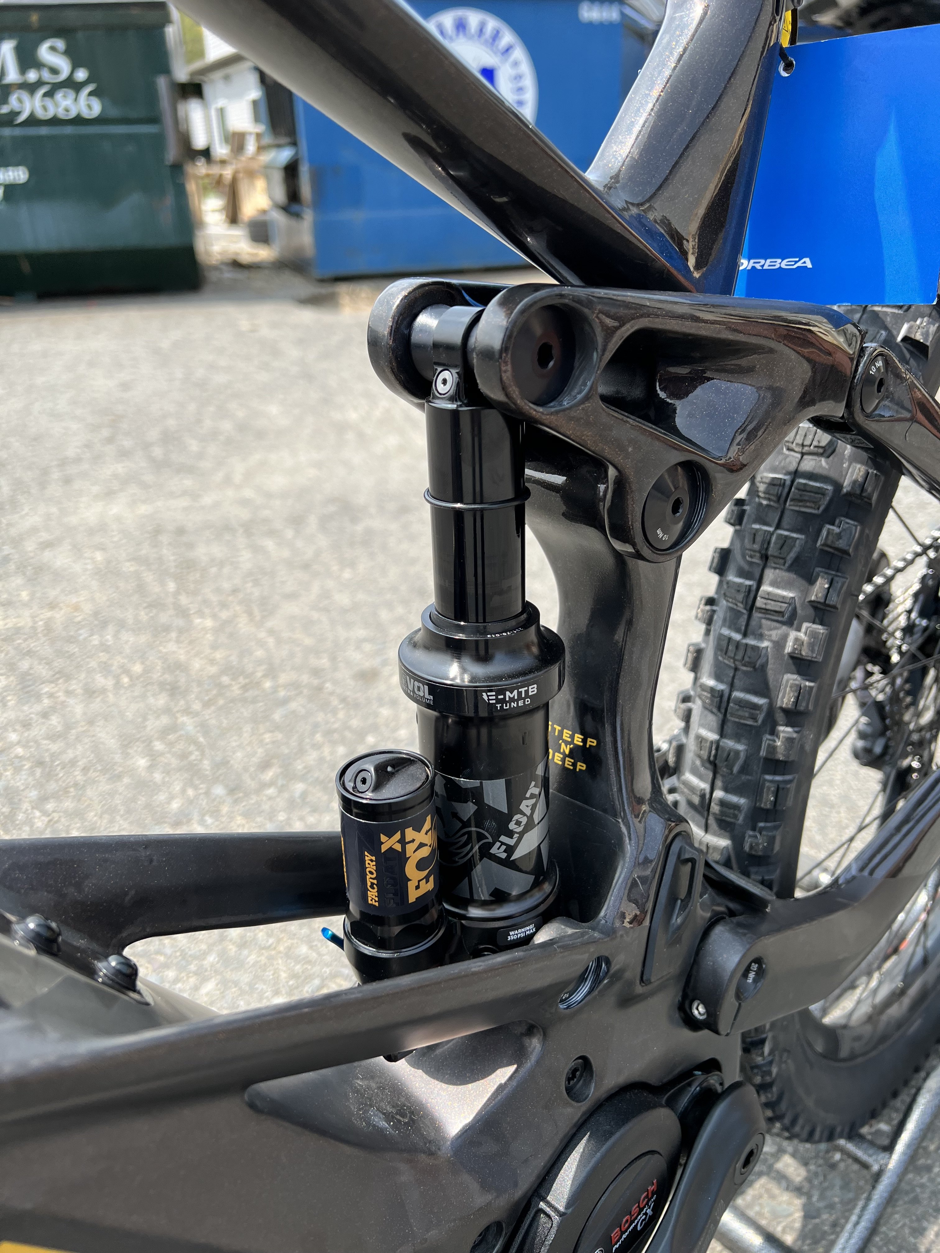

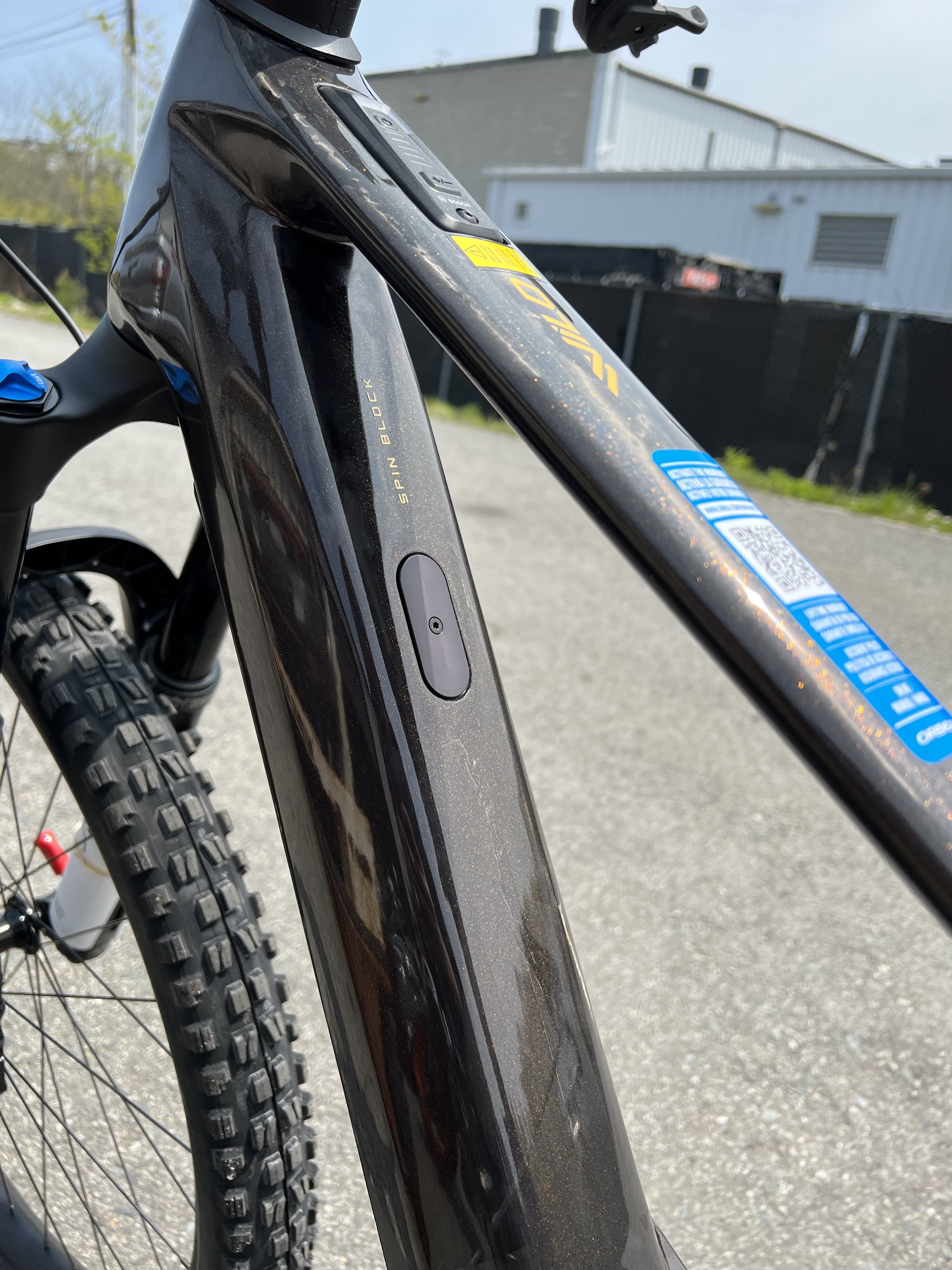

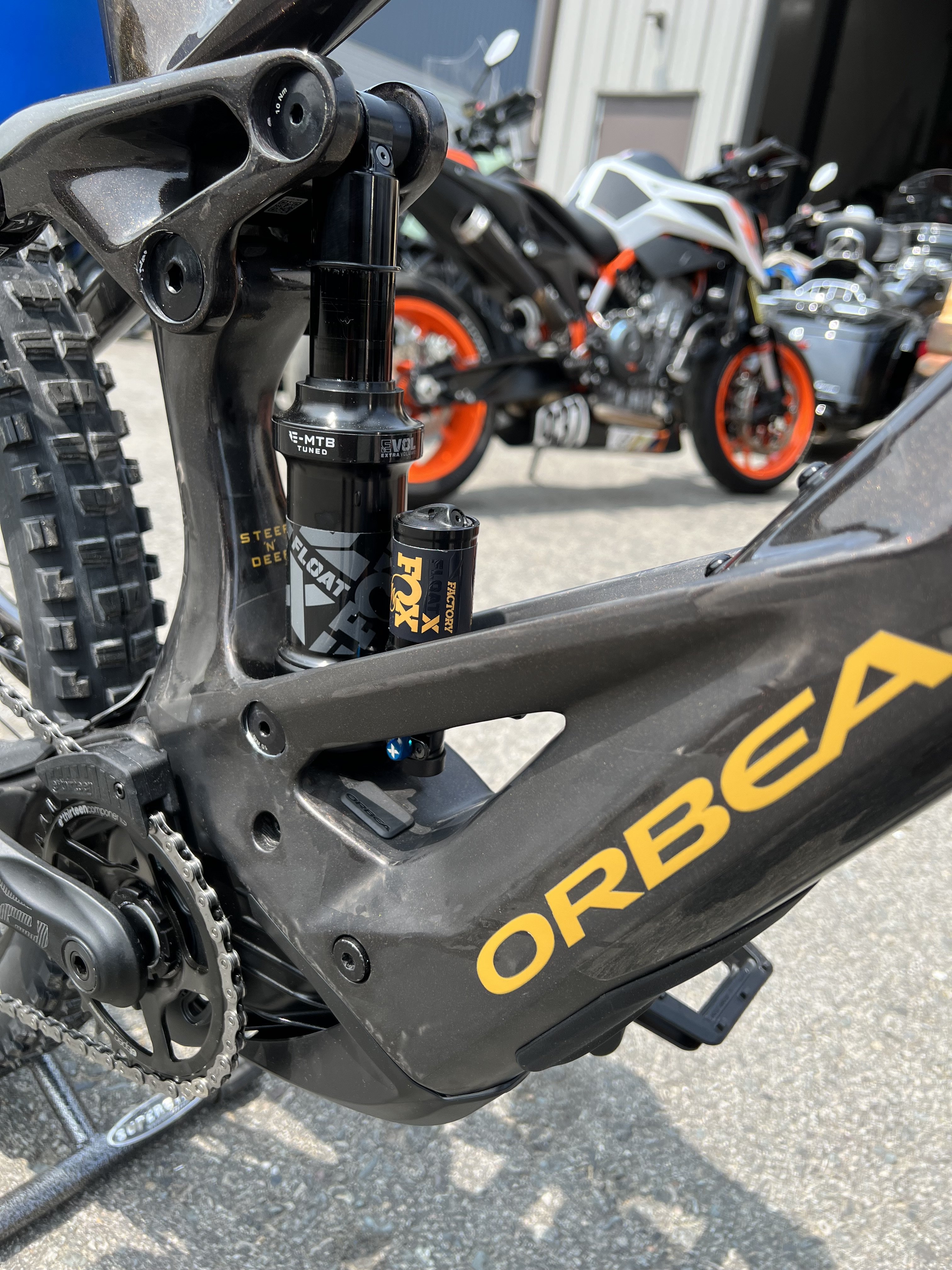

Wow what a piece of junk. On the bright side a couple rides and crashes you'd never know it had so many issues .
I didn't check my Rise H15 that carefully as I'm a perfectionist and anything I saw would bug me. Luckily I've already wrecked it and scratched the lower arm a little. Nothing a sharpie can't fix
maynard
I couldn't even see anything In alot of the photos . Just ride the bike . I saw photos of the black carbon parts. It's supposed to look like that , raw carbon looks sexy and unique. I feel sorry for that bike . And your shop . A few tiny blemishes , I suppose would be disappointing but oh well it's gonna get scratched anyway.
You are right, a bike most probably get scratched anyway. As well as a car gets rock chips after some time on the streets.
But that doesn't mean someone should accept this bad of a quality when they buy an expensive new product.
It hurts way less when your bike gets scratches because you are shredding than if it comes from manufacturarer with scratches and paint chips.
In my opinion some of these images look really bad, and I would either want a proper discount or a new bike.

Remarkable how a finish like that can pass a QC, would be interesting to see how the finish is on the ones who not pass it.

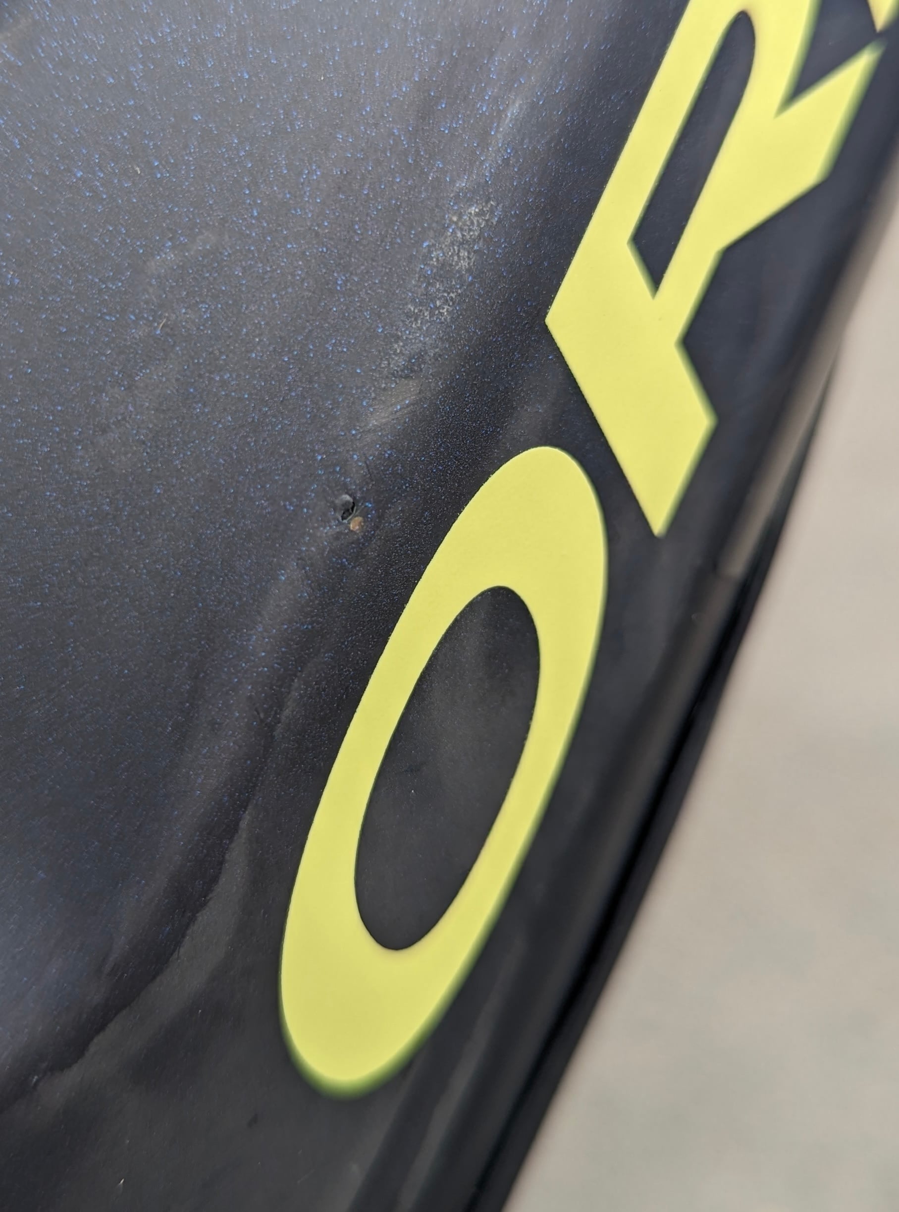

I assume you're talking about the photo's of the black Wild? if so I am not sure the user said there were any issues. I personally wish my bikes had that quality. I do get your point that it's a bike and it'll get scratched but still there must be standards for new bikes given the prices being paid (£8449). I also choose to wrap my bikes which would have been completely pointless given the standard and it would have hammered an already bad resale value.
I must confess the photo's just don't do the same justice as the human eye because the bike really did look to have been sprayed by a rattle can in a sand storm. There were over 20 paint imperfections, the suspension linkage is completely different colour, loose bolts and the cable routing was borderline dangerous. I'd also note both the bike shop and Orbea agreed the bike wasn't good enough.
To put it in perspective, my 2 year old Trek Rail with 1600 miles on it was in better condition and I've seen and owned second hand bikes in better condition.

The paint on my rise is not the greatest quality job, but it is no where near that bad. I've had plenty of bikes with mediocre factory paint jobs over the years. I'm the kind of person that as long as i don't start seeing imperfections when looking at it from standing height (eyes 50-75cm away +/-), I'll tolerate it. As mentioned above, it's a mountain bike, it's going to get dropped, crashed, scratched while shuttling and moving around the garage etc.
That being said, those wild frames are a bridge too far for me to accept with the current cost of bikes. The combination of un-even and substandard paint coverage, color matching issues, poor masking and surface finish are all adding up to a substandard overall product. I'd tolerate all of the little dings and flakes around the pivots and bearing recesses... those are the issues my rise has along with paint that's overall, too thin and fragile.
I wouldn't give up on orbea fwiw. I think that maybe their gloss painted bikes are better quality overall. I've had that opinion before after looking at a few, but no reason to outwardly avoid their matte finish frames (i do now). The thing about Orbea is that you are getting one solid notch less quality with regards to frame finishing, design details etc. They are certainly not the worst, but it's not quite the level of Santacruz, Pivot or some of the other botique brands. For the price delta between them and some of the uber expensive brands, I'll tolerate some of the overall quality issues... that is, until their prices creep up.
The truth is, many of the other brands also have paint issues, Giant, yeti, specialized, kona to name a few. Typically though, it's with adhesion and or color fade that's the issue. Not typically initial application thickness, masking, color matching issues.

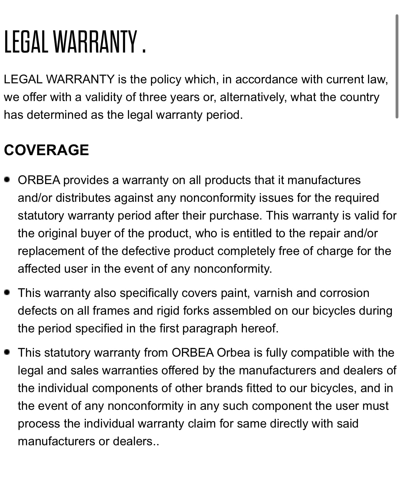

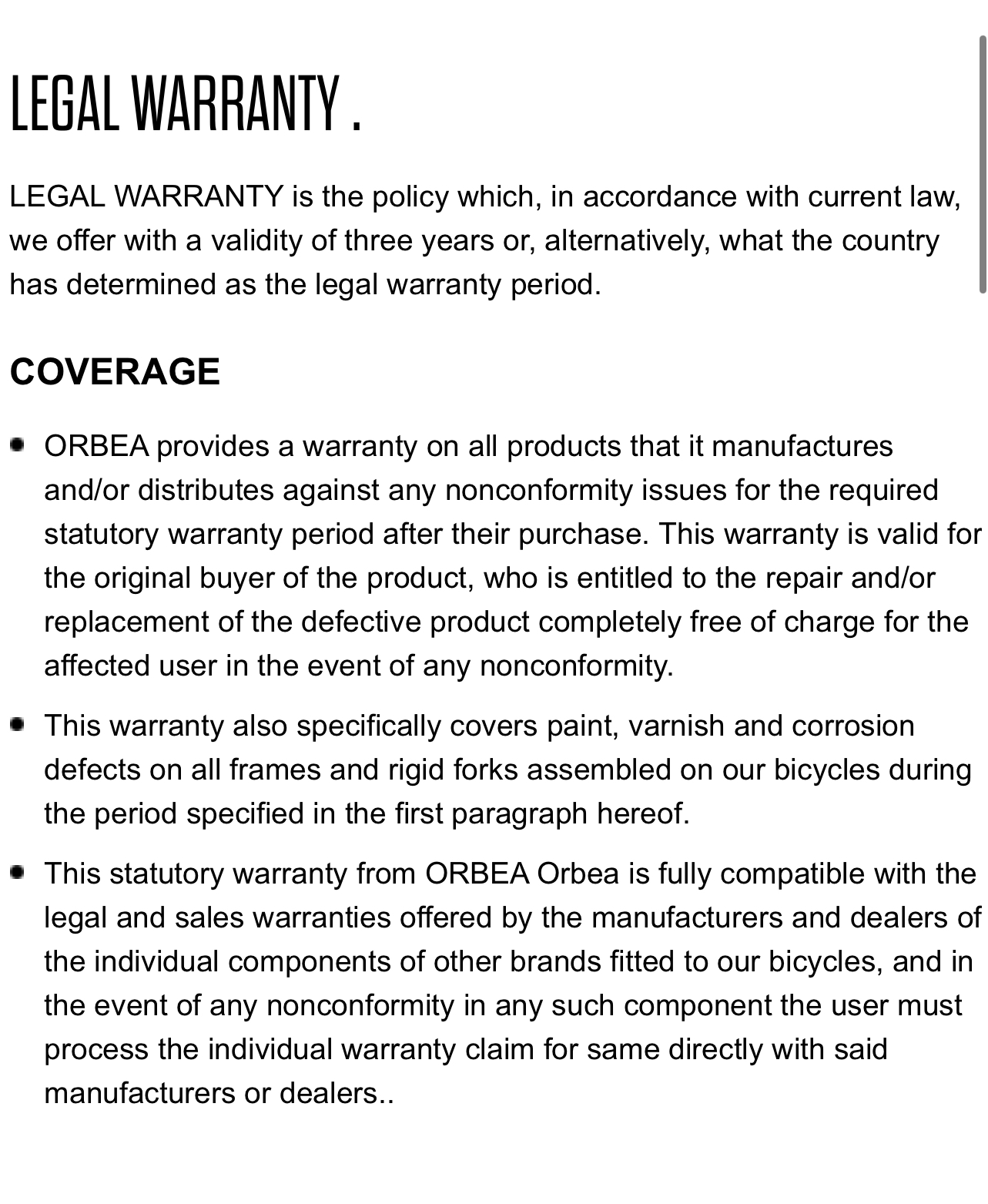

And void any warranty you have...
Sandblasting a carbon frame wouldn't be a good idea.
not all of them are carbon though.
and it doesn't necessarily void your warranty.
you think every term and condition is legally binding or what? also even specialised have authorised places where you can get your frame repainted without voiding anything

I did think about having it resprayed but it absolutely does void your warranty not to mention I was quoted £1500 to do this so it’s not a valid option.
Also spraying a brand new 8k+ bike just doesn’t sit right with me.

Completely agree with you here, my riding group has a 2021 H10 (alloy) in red/black and a 2022 M-Team in red wine carbon and both are mint, I also have a friend on a non eeb Occam that’s mint so I know Orbea are more than capable of top quality finishes, I’d say their alloy welds are up there with the best too.
There’s a serious quality issue with the 2023 Wild for both carbon and paint.
