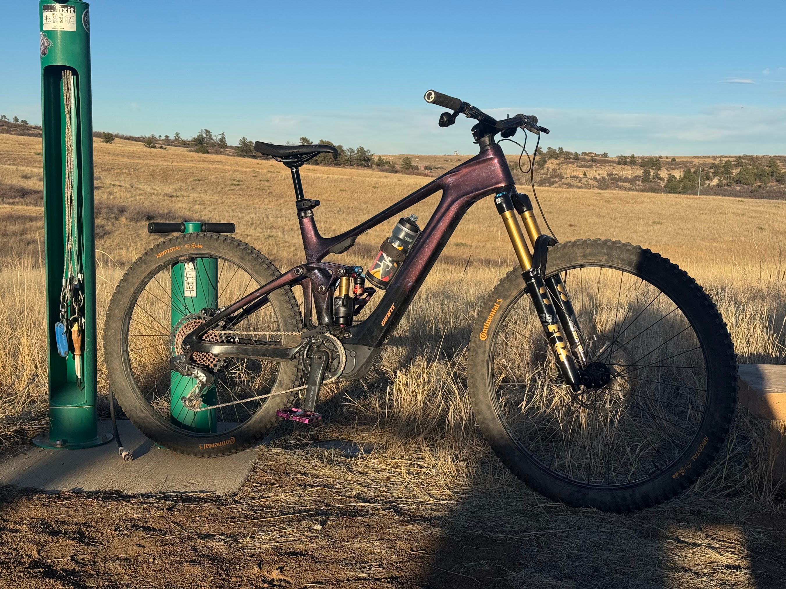

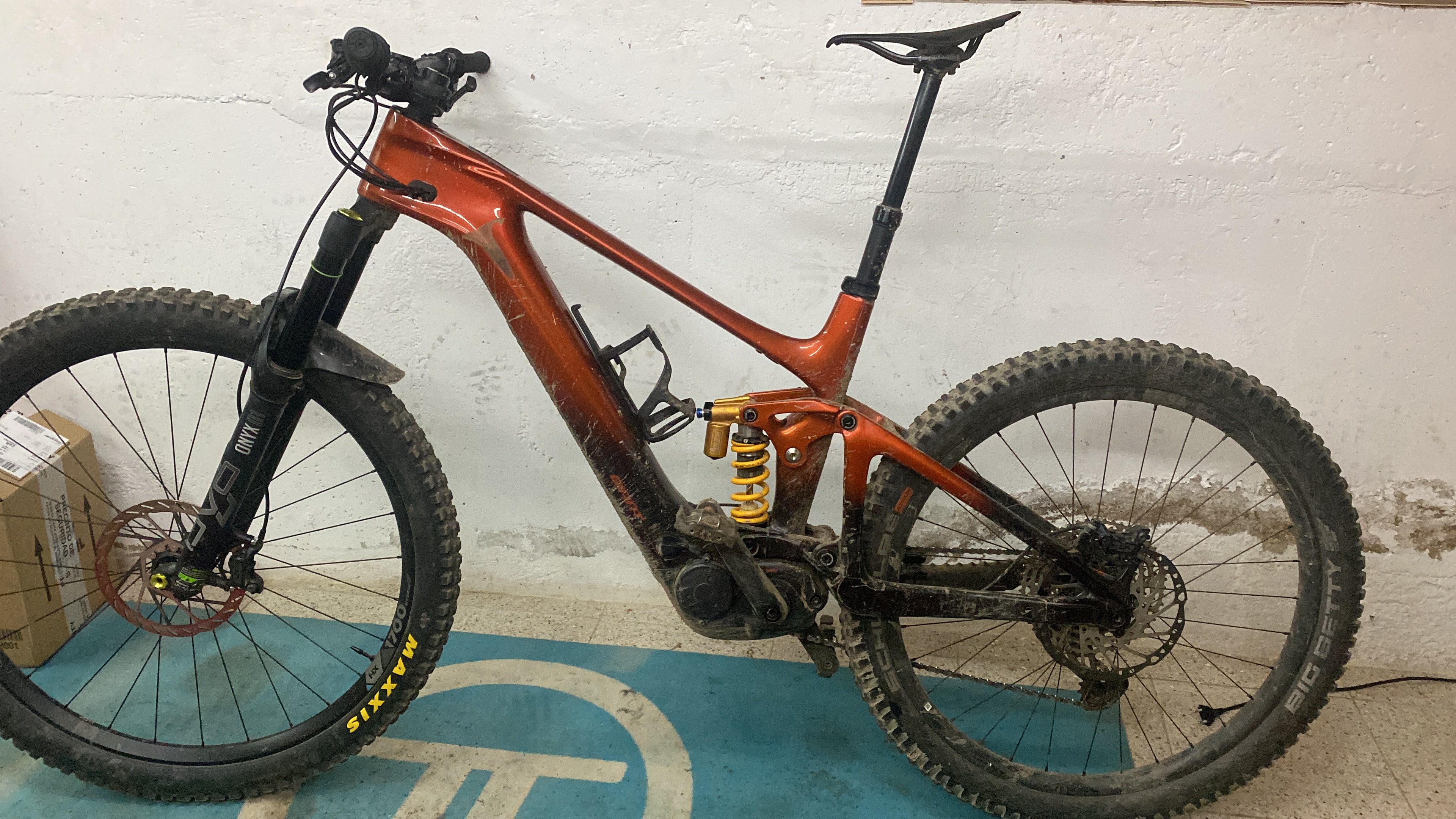

Hi,
I’ve riding with -1,5 degrees on the headset, 160 on the fork and 55mm of travel on the rear shock (+/-148 mm on the rear wheel).
The bike feels amazing on a speedy singletrails and rockgardens compared with the stock geometry/travel.

@kimizzz that looks sick! Any other feedback on the changes? Does it feel tucky or understeery? How's the long stroke shock? Any cons?
The headset routed cables are so dumb! They look goofy and are a pointless faff.
On vertical trails, you feel much more confident, and on slow and technical trails, you may lose some agility, but it isn’t comparable with the benefits you gain. Uphill, there's no difference.
Regarding the shock travel…140 feels not enough. The increase isn’t too much, but if you are thinking about upgrade the shock…it’s the moment. Coil shock is an other level 😉
Oh really, coil? Did you find the LR published somewhere?

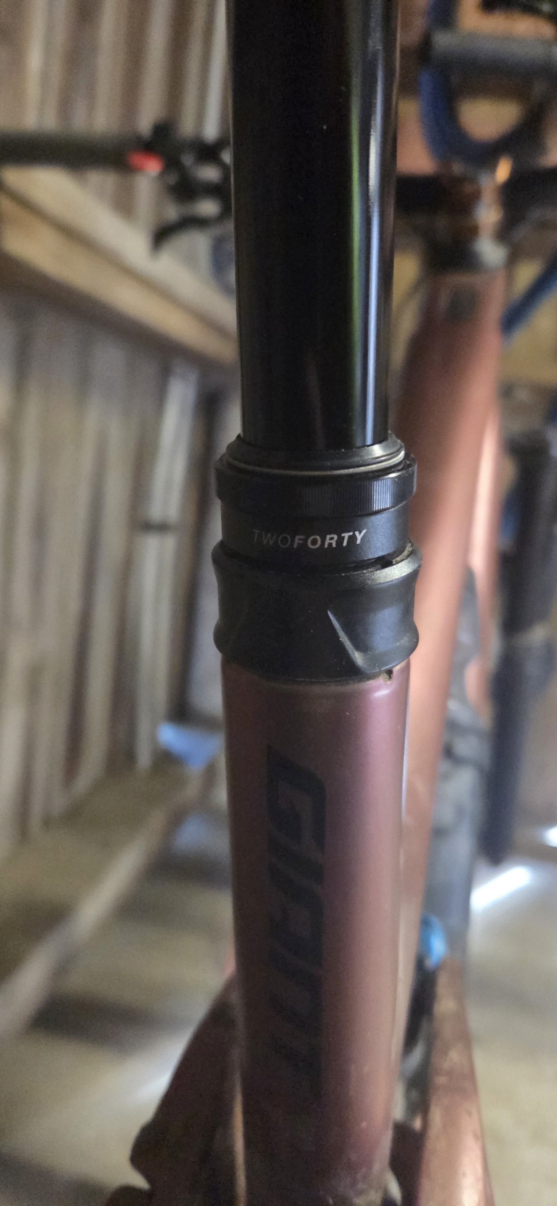

You can also completely replace the headset with a conventional one to eliminate the annoying creaking/looseness. See photos of a mate's bike I did ( use the cable port cover with 3 holes affectionately known as the 'cock and balls' - you know why). Or go something like the Sixpack Millennium ICR stem, and an ICR headset with a metal compression ring - which I intend to do...
View attachment 157331View attachment 157332View attachment 157334
What kind of upper headset did you used? Looks neat.
Anyone experiencing consistent issues with the headset coming loose? Other than changing the cable routing and headset what have others done to fix it?
There's nothing you can do other than replace the headset (other than keep it tight and clean/greased every couple of rides?) Otherwise you'll quickly see wear on the headset cups etc. It's a poor quality headset with plastic parts.
Replaced mine with an Acros version with an aluminium compression ring but the downside is the upper bearing is thinner as it's 42mm ID instead of the original 40. You can do this or go to a conventional headset in a better quality like Hope, Cane Creek et al, and run the hose/cables through the frame.
I also replaced my stem with a Six Pack Racing stem with tidier cable routing.
Ex mechanic so worked on a lot of these.

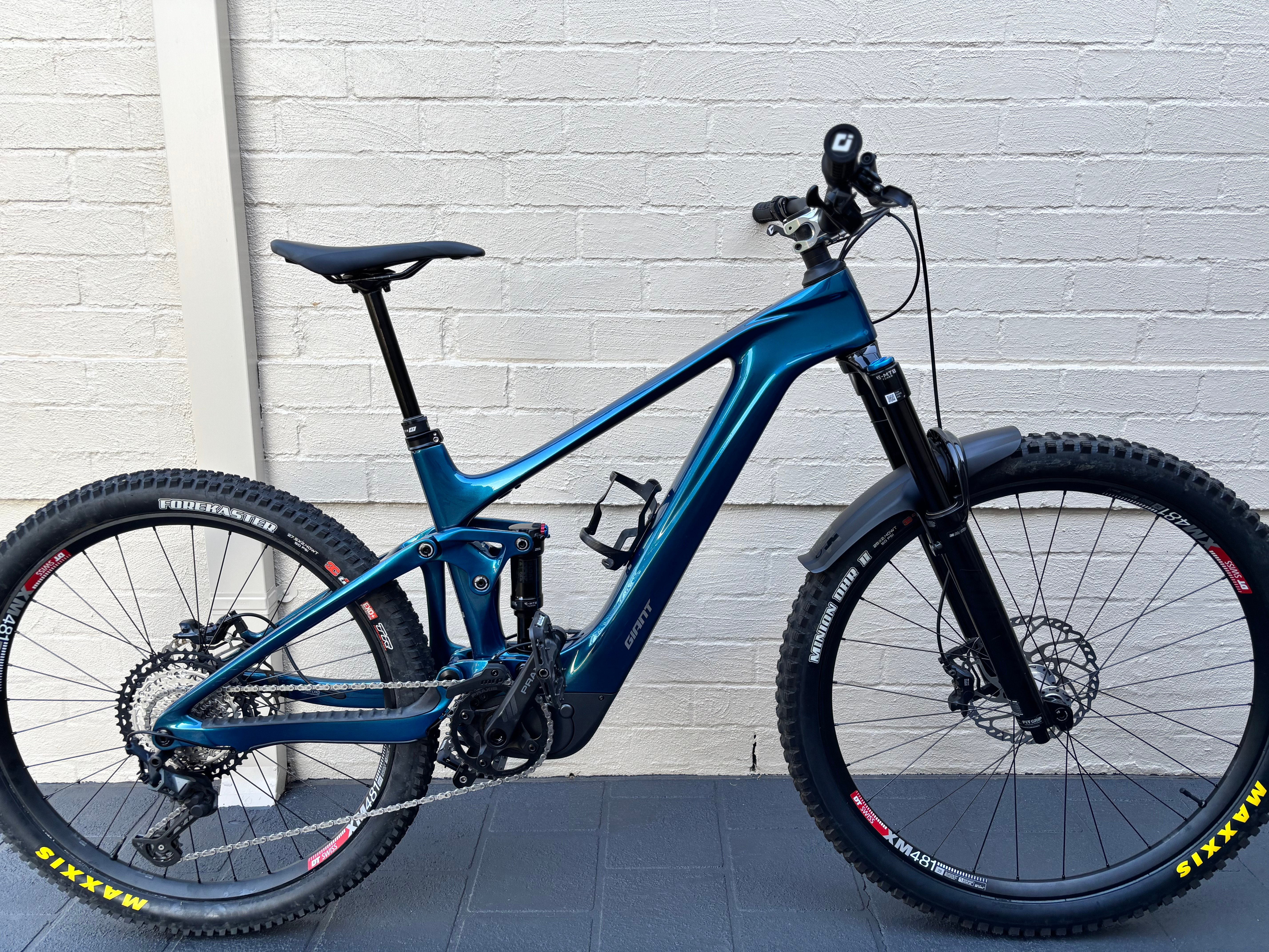

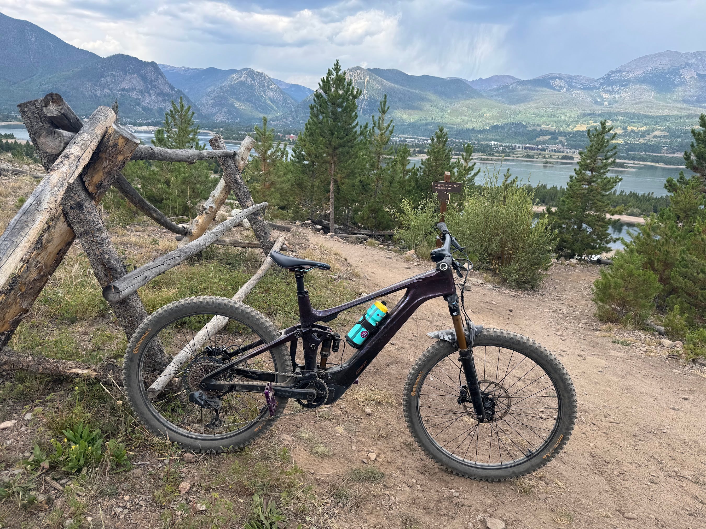

I bought this a couple of weeks ago… it’s a medium Trance Elite. Stock it weighted 20.7kg
I’ve upgraded a few bits and pieces with the aim of getting as much weight off the front as possible and with a goal of getting the weight to under 20kg.
Here as it sits in the photo it’s 20.17kg. The wheels were a little heavier than I was hoping.
I’ve only had one ride on it, and I’m very happy with it so far. My aim was to get an ebike that was playful on the trail like a normal bike, and with the smaller battery and lower weight this bike does just that.
The internal routing of the headset and cable rattle are the only negatives so far

Looks nice, mate! If you ever have to fiddle with a dropper cable (or want to practice dropping the motor) it's a good idea to run some foam cable sleeve the full length of the brake hose and gear cable - I found this made a big difference (otherwise could get a bit of rattle where they run on top of/beside the battery). Enjoy.
Thanks for the tip. I was planning to order some foam cable sleeve, so it's encouraging to hear it will make a difference.

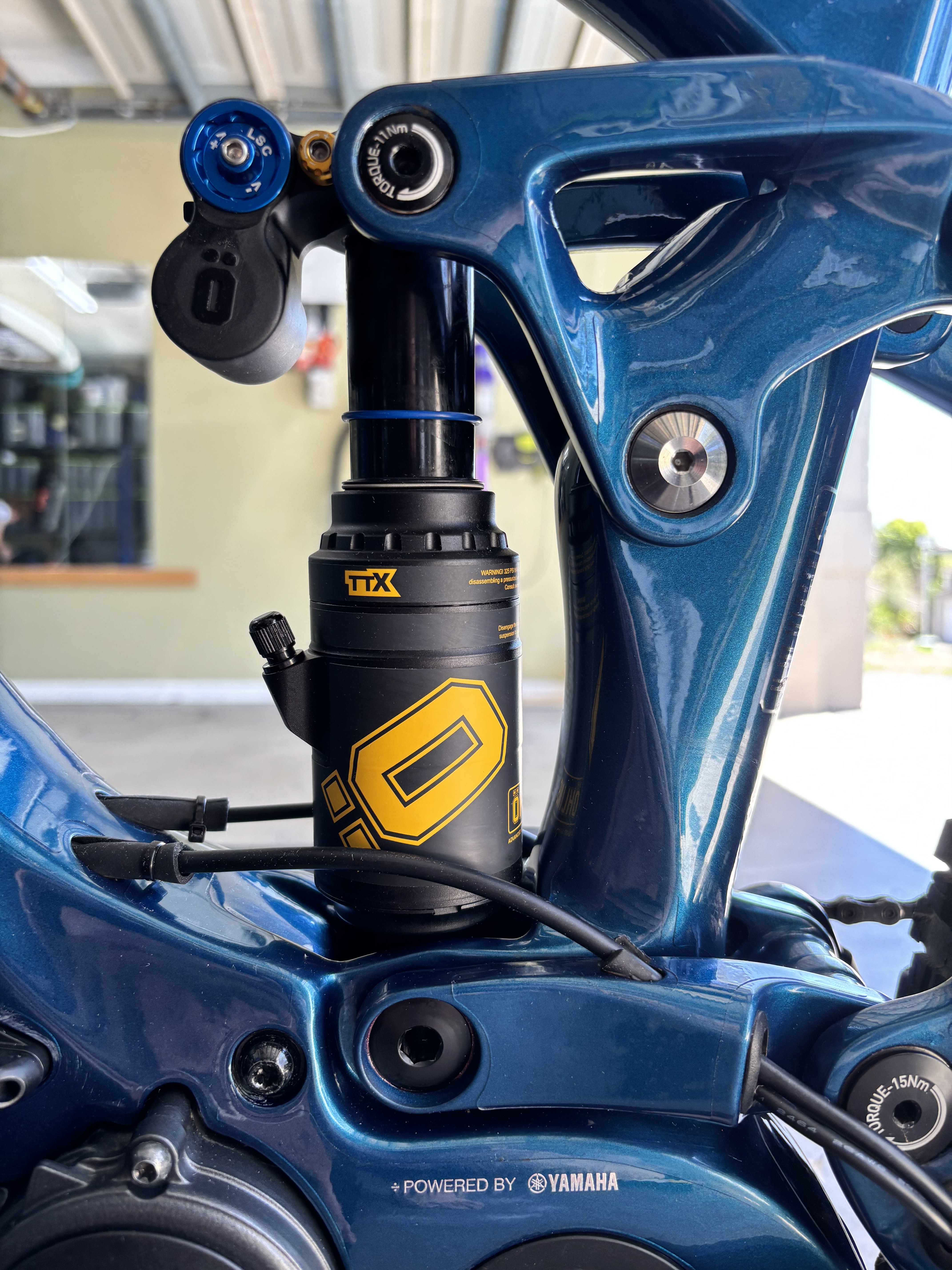

Does anyone know if a large can air shock like the Ohlins TTX2 Air will clear the frame at the bottom on an Elite? I can't find measurements anywhere.
They're no larger than an X2 yeah? If so there should be plenty of space. I'd be more concerned about a coil shock where there can be issues with the bottom edge of the spring/spring perch (my current shock a 2025 DHX2 with SLS 650LB coil almost contacts the seat tube at rest)... See photos pg10 for the X2...
In which case if you want to consider a Factory X2 let me know ;)

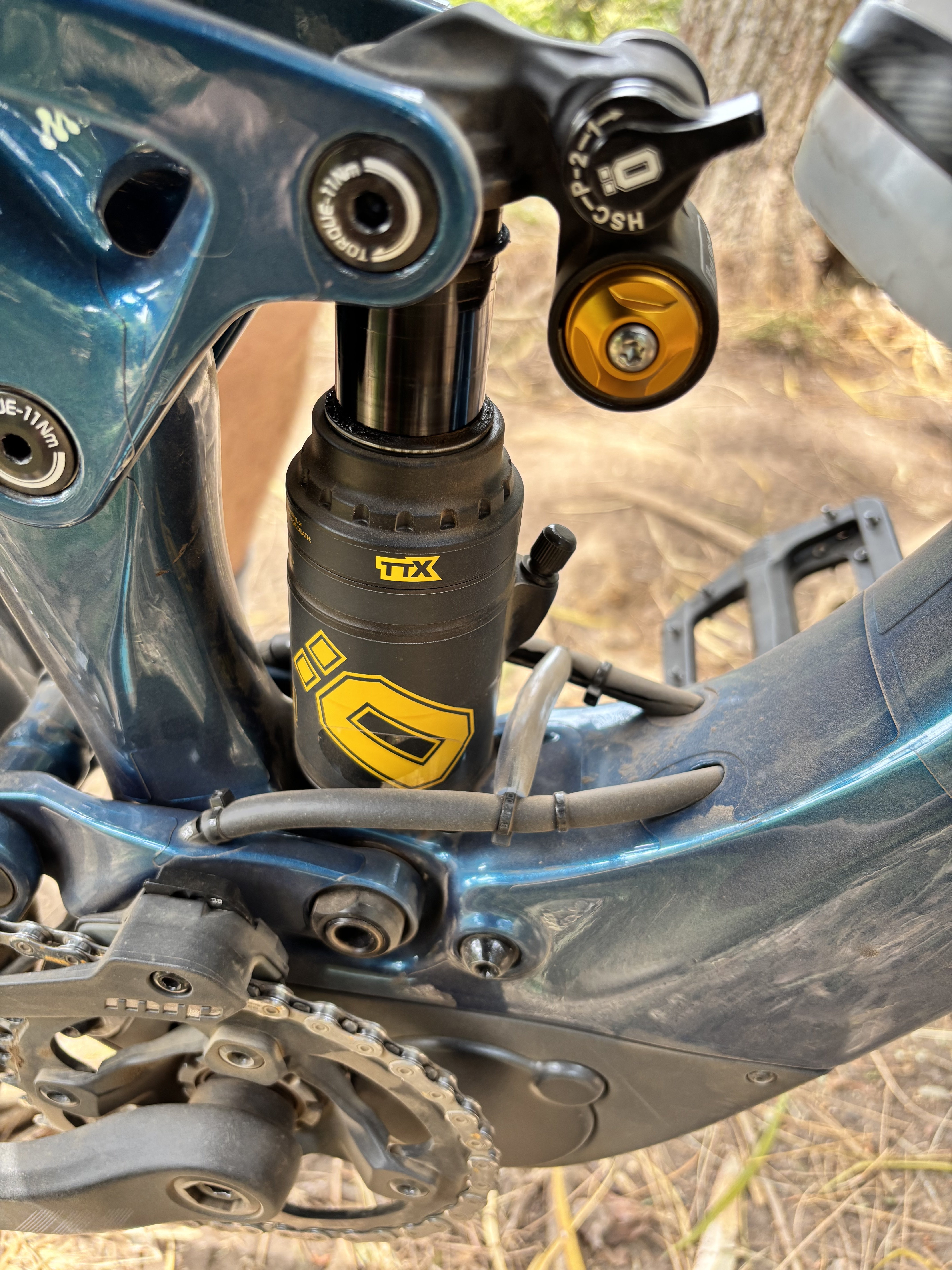

Nice one, looks great! Let us know how it feels?

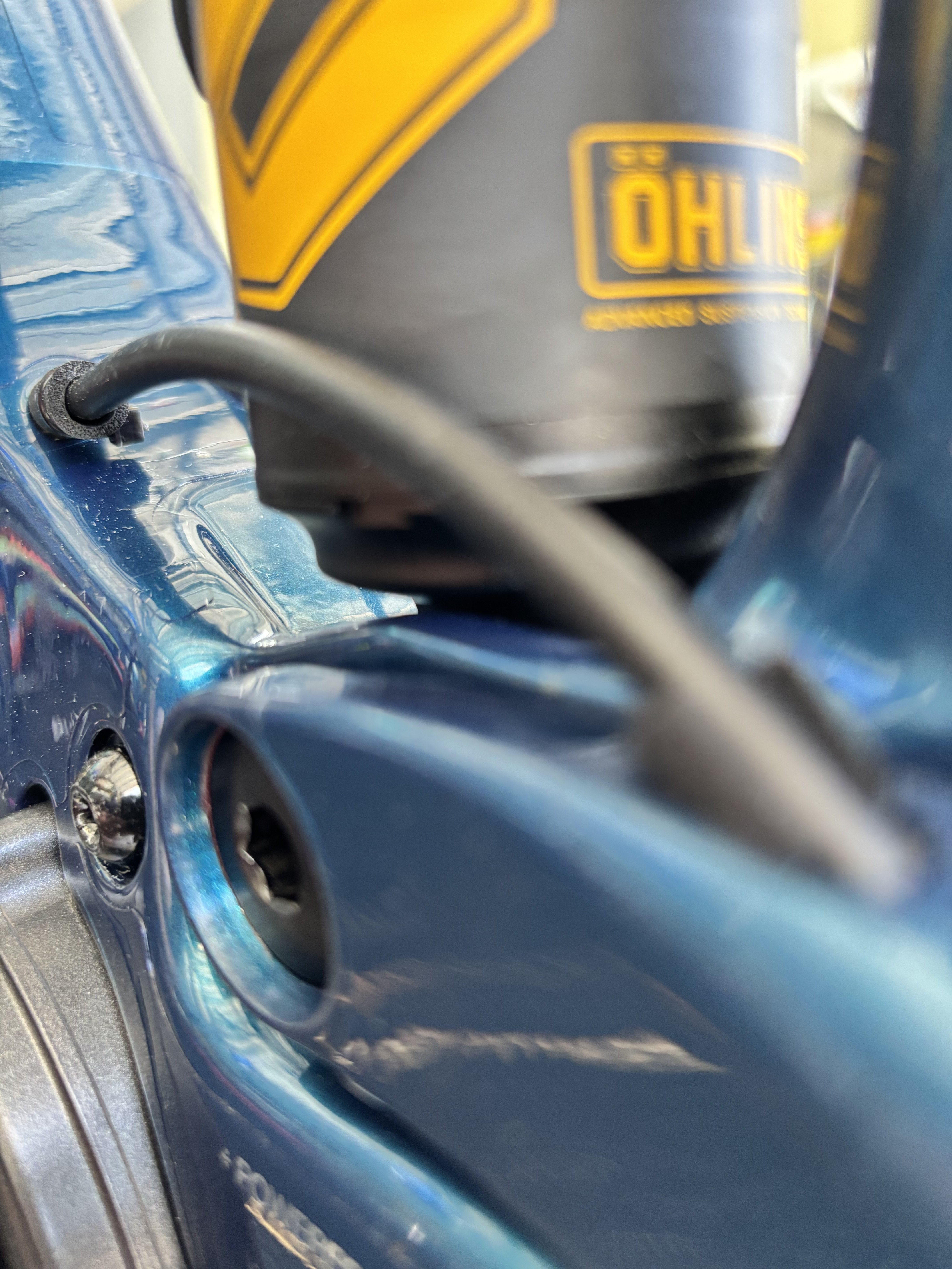

First ride done and very happy. The small bump sensitivity is better than the standard shock. Also, I started with the rebound and LSC in the middle of the range and really didn’t feel a need to adjust them. Everything seemed well damped and predictable including jumps.
I would definitely like to find a better way to keep the cables from rubbing on the shock though. I used the old trick of a piece of pvc tube and zip ties to keep them separated but it’s a bit ugly
I used some self-adhesive round black felt pads. Placed them there where the cables touching the shock. It also helped that I replaced the derailleur for a wireless one😉
I might try something like this instead.

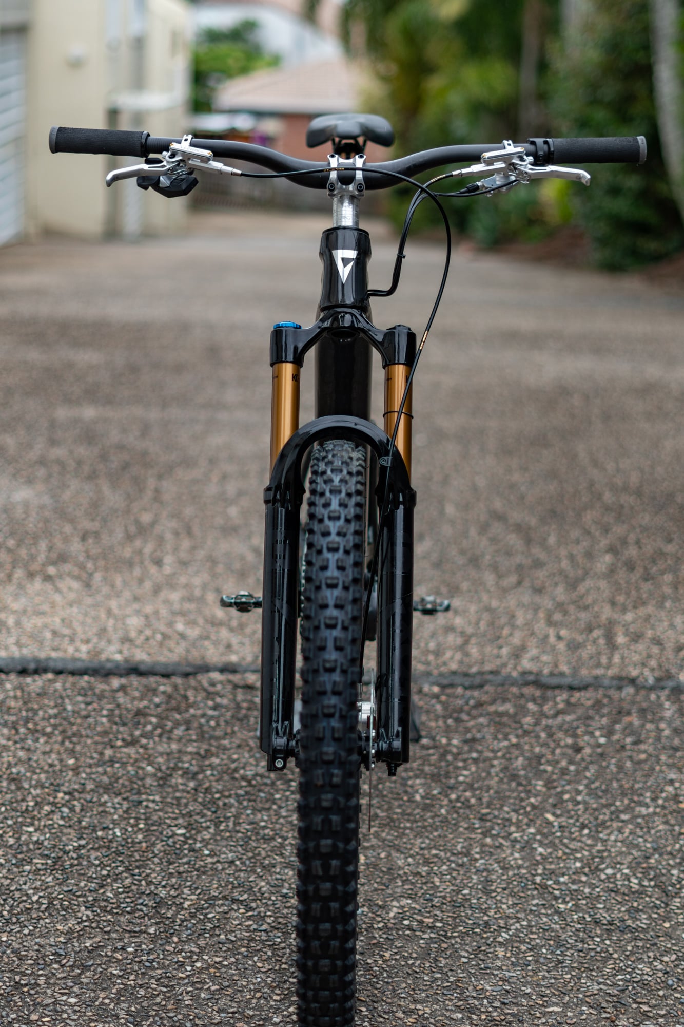

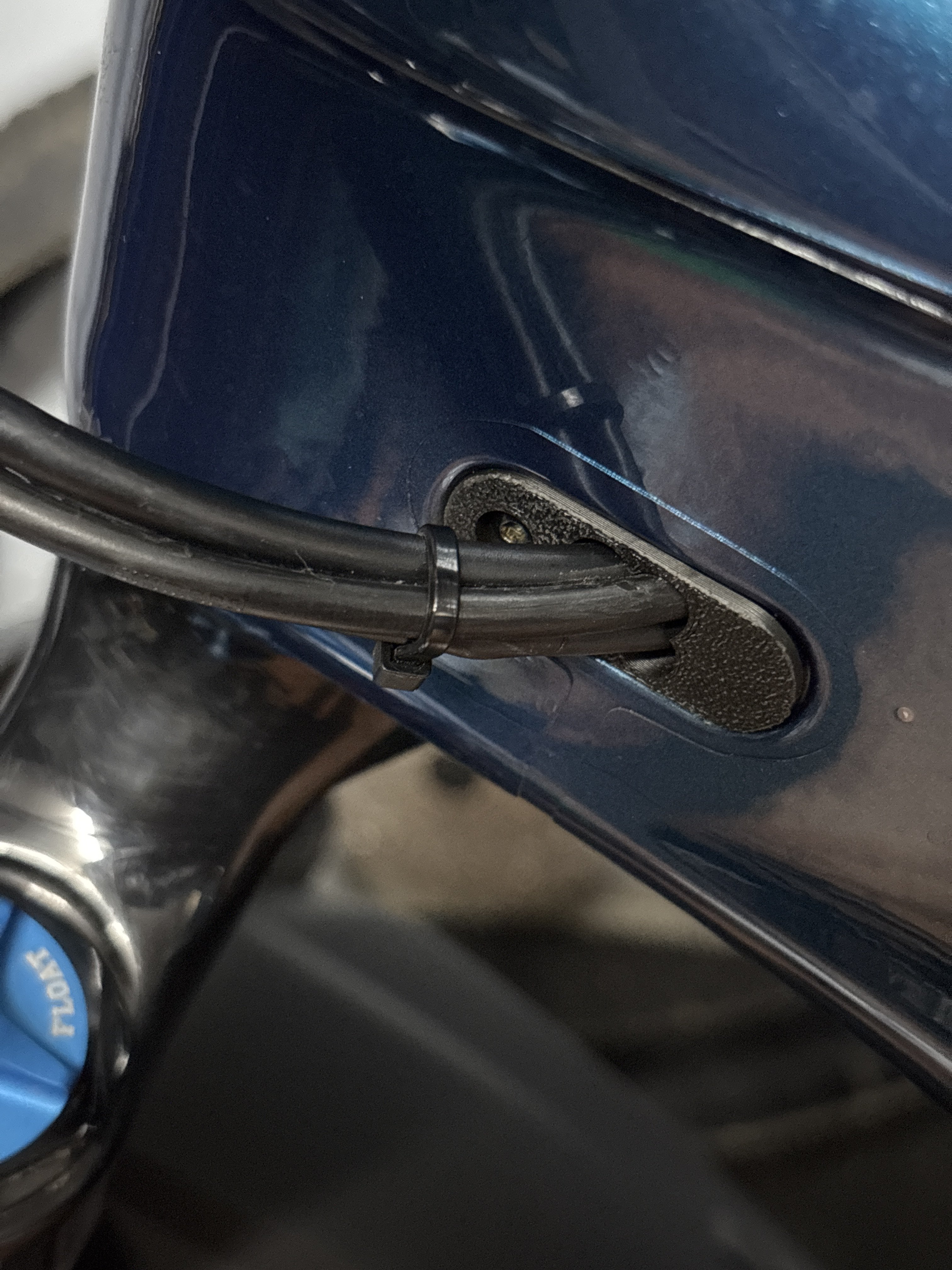

I can't quite work it out on your photograph. Did you manage to feed all 4 cables through the frame port? I'm thinking of replacing my headset as well.
You can. I have also done it. I printed a 4 port cable guide to make it tidy, but I think you could easily mod one of the stock guides to work
Nice, thank you. Just ordered a Works 1.0 deg headset. Good idea to print a 4 hole guide. I'll set one up in 3D, just need to find someone locally who can print it for me. It'll be nice to finally tidy up the cable routing after owning the bike for two years.
