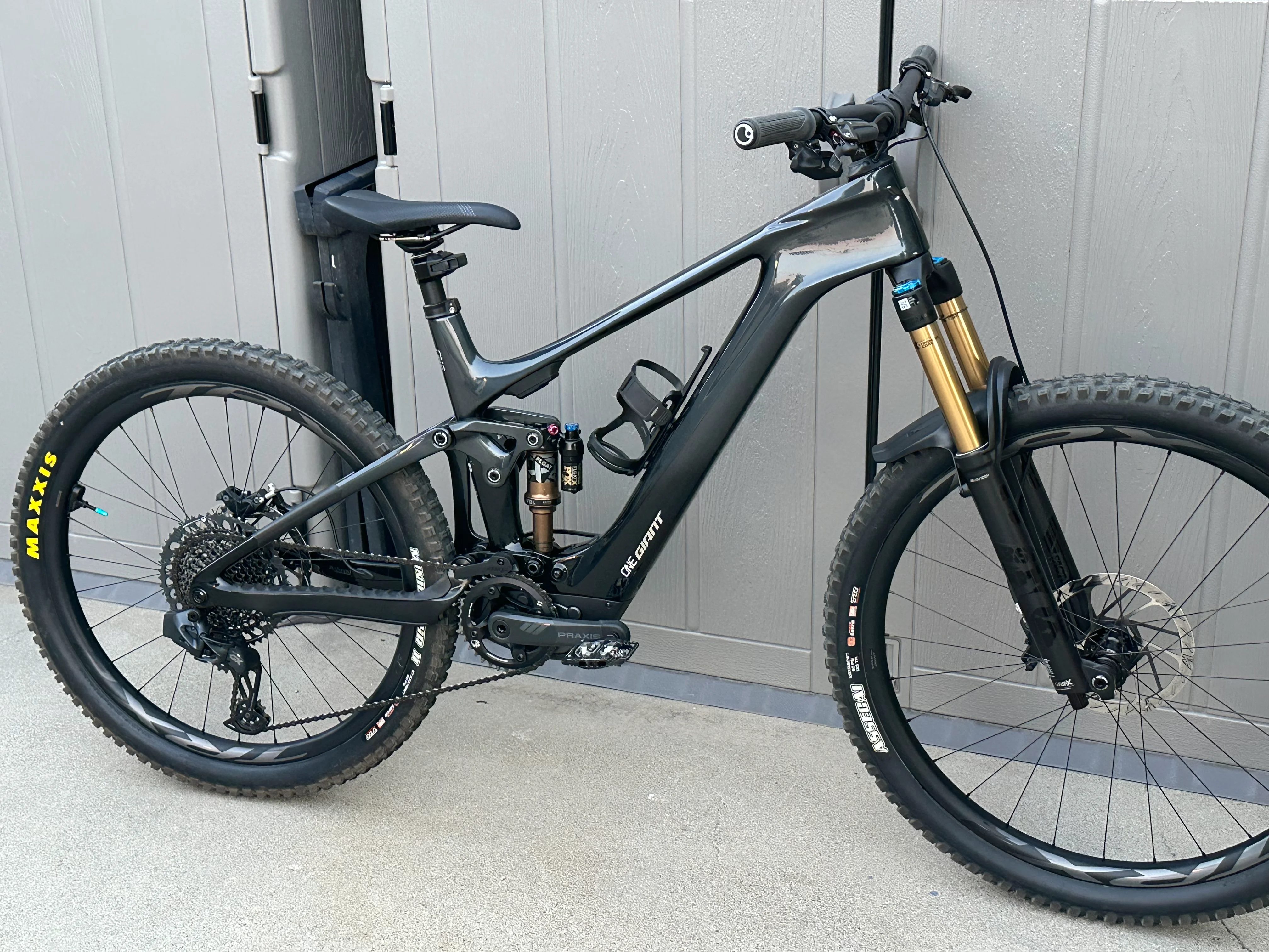

I like to see everyones setups so here is my ride.
2023. Live Valve removed. Fox 36 Grip x 160. Float x 185x55.
