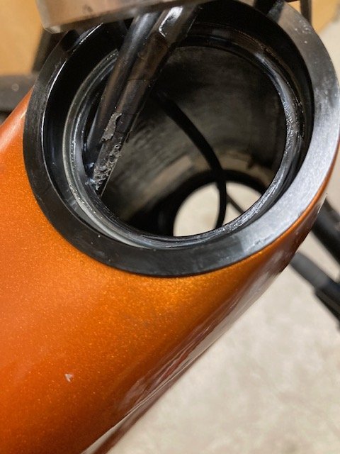

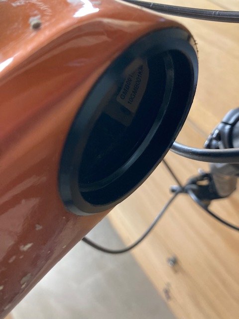

I just measured it, the bearings are both 52 mm. I've attached images of what it looks like as I'm not an expert with these things, not sure if I measured correctly. There seem to be two cups pressed into the frame, do these need to come out to get to the 56mm diameter?
The power mode switch will need to be redone, there's no easy way of disconnecting the cable.
Correct, currently there would be one cable too many for the side ports. Either remote dropper or AXS.
And I agree, the head tube angle adjustment is not really needed, certainly not at this cost.
The bike feels slacker than it is.

Yeah you would need to remove the pressed in cups. Looks like Works Components makes a 56/56 1 deg head set.
Does look like its more work than its worth especially if you have to go to AXS dropper or shifting. I'm still gonna install my 160mm Lyrik as I already have it and it should be a good upgrade over the stock 35.

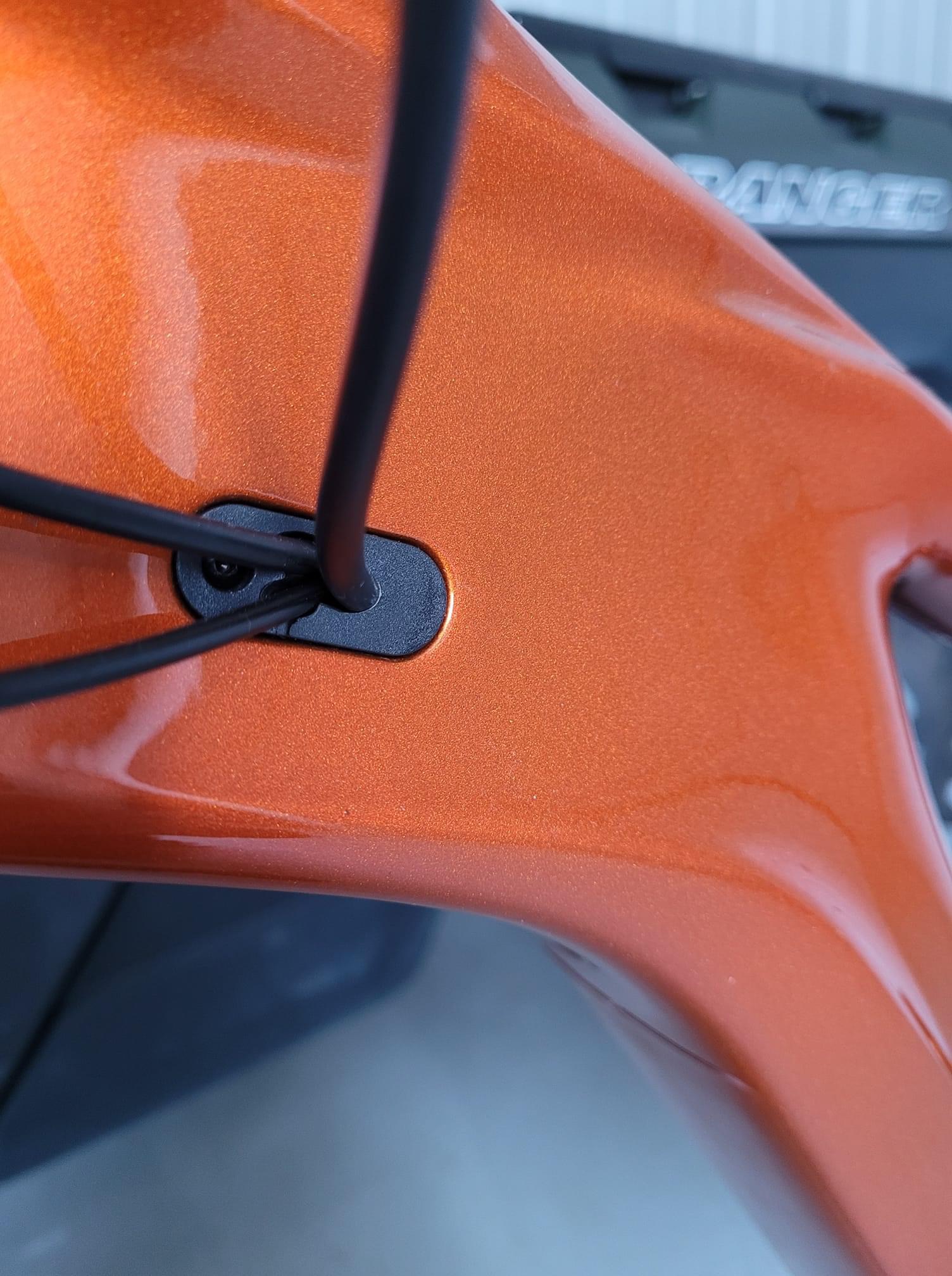

Can anyone chuck up a photo of the frame cable entry port? Will it accept 3 x cables? Brake, dropper and shifting? I'm really not sold on the thru headset routing.
The port on the bike has a blanking plate on it. The bike should have come with a plastic bag with reflectors and bits in it. In there you’ll find a selection of port covers and one of them has 3 holes. I hate the headset routing and changing it is on the to-do list
