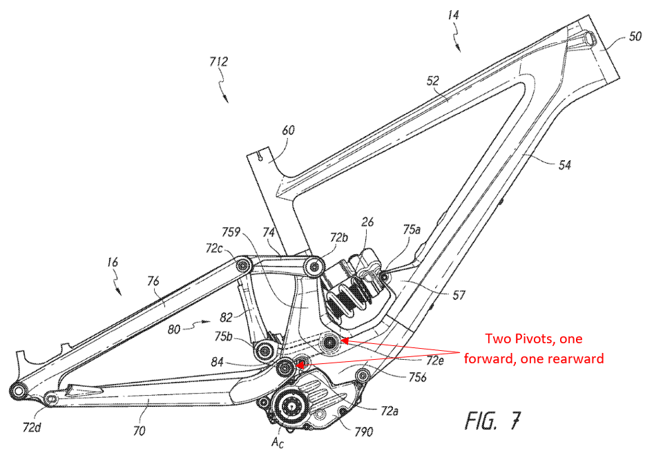

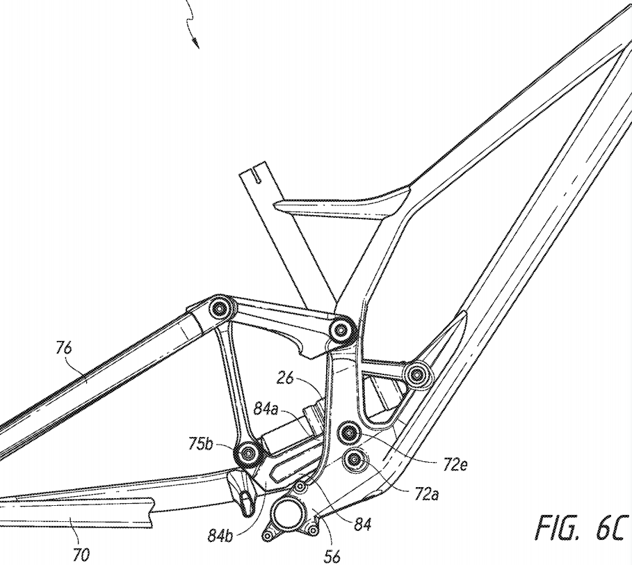

Given the patent release.. seems like this should happen soon! Who knows if that patent covers this, but I would love to see the next SL have the enduro linkage and resultant kinematics.
No that’s just a Levo SL expert with an push 11-6 shock an a MRP ribbon fork.

I had a few minutes earlier to look at the suspension kinematics for this and compare it with a few things. This is all pretty new for me so ignore most of what I say as it's probably bollox. Or baubles as it's xmas.

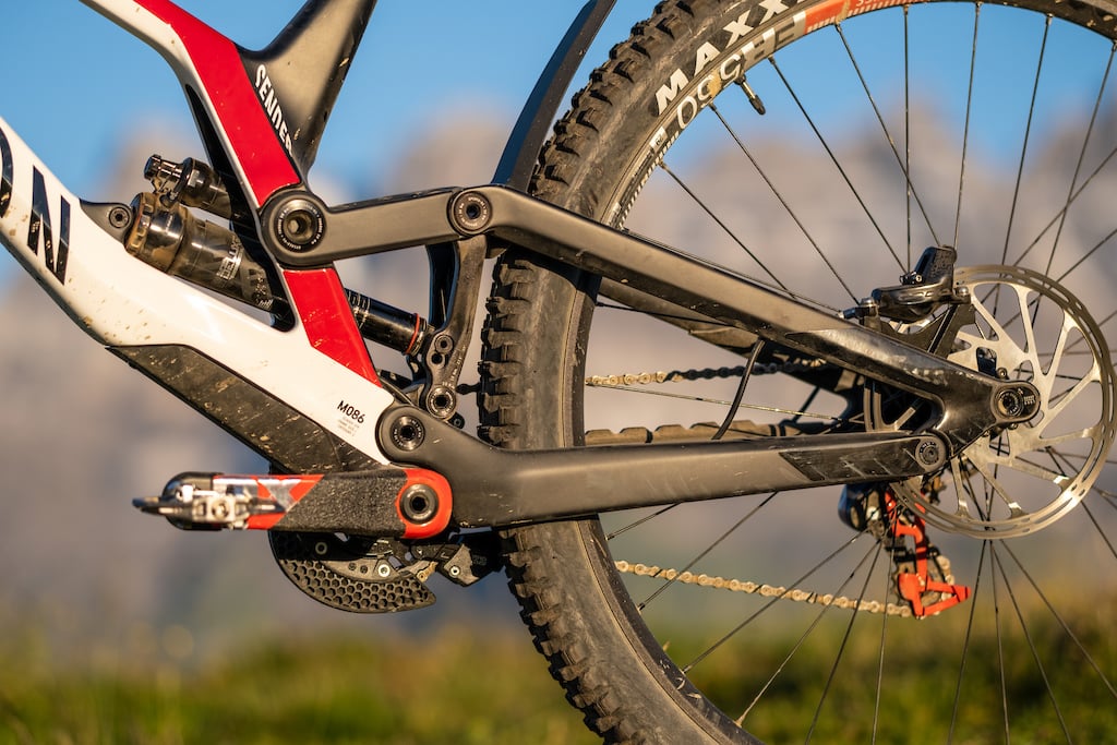

First off, the 2020 Demo of this design was incredibly similar to the Canyon Sender CF in it's execution, even if visually, they were slightly different.
At the time the main differences were that Spesh mounted the shock to the downtube rather than the top tube, and to much positive acclaim, used the same pivot for the shock link and the chainstay - unlike the Canyon, which had a separate pivot for the shock link - which made things a lot simpler on the 2020 Demo. With the latest 2021 demo design and the emtb version, the shock link and chain stay pivots are now separate - like the Canyon. Also, the connecting link on the demo was a lot longer than the connecting link on the Canyon.
On the latest 2021 Canyon Sender CF, the connecting link is now longer, like the Demo and the shock now mounts to to downtube rather than the top tube. The Canyon has retained it's separate pivots for the shock linkage and chainstay, though the shock linkage pivot has moved down to be much closer to the chainstay pivot, effectively mounting off the downtube, rather than the seat tube.
2021 Canyon Sender CFR :
Note that the Canyon has two different shock mount positions to give different linkage ratios depending on if you're running 27.5 or 29.
So that's the basics of those two out of the way as I see it. Onto the Stock Demo 2021 frame and the Kenevo SL 2021 Frame... or Demo SL, or whatever they decide to call it .. They might want to keep the Kenevo as meaning "Bulldozer Suicide Tractor" or broadsword and this new bike to be more a light sabre - light .. see .. .get it ... ?
For the EMTB version of the Demo frame , compared to the Normal version of the Demo frame, the Chainstay link is moved quite a way further back to accommodate the motor/battery housing. One advantage of this should be that there will be less chain growth through the suspension movement due to the less vertical rise of the wheel, which should also give less pedal kickback compared to the stock 2021 Demo. The downside, is I think it will be slightly less progressive than the stock 2021 Demo and anti-squat might also not be quite as good... but as I say, I'm new to all this crap so I could be completely working that out wrong.
At the time the main differences were that Spesh mounted the shock to the downtube rather than the top tube, and to much positive acclaim, used the same pivot for the shock link and the chainstay - unlike the Canyon, which had a separate pivot for the shock link - which made things a lot simpler on the 2020 Demo. With the latest 2021 demo design and the emtb version, the shock link and chain stay pivots are now separate - like the Canyon, except even more complicated as it now has twin shock link pivots ! Also, the connecting link on the demo was a lot longer than the connecting link on the Canyon.

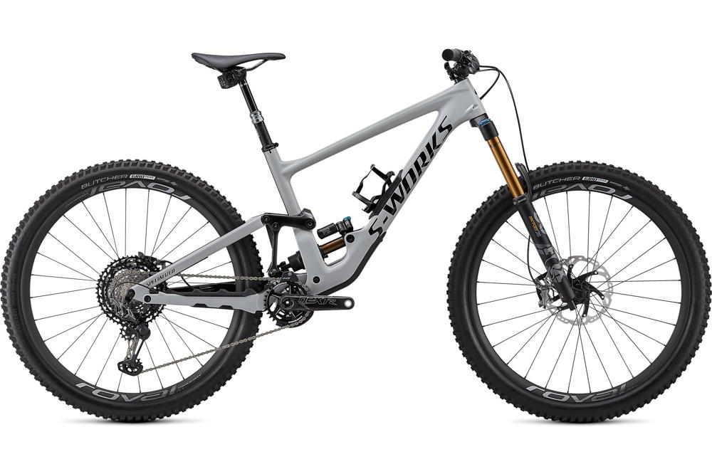

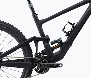

To me the frame definitely looks like its based off of the Enduro more so than the Demo. It literally looks like an Enduro with the motor integrated into the bottom bracket when compared to each other.
The 2021 Lightweight Enduro, Light Sabre, dEmo, Keneno SL ... is a real mix of design features. Primarily it looks like they've tried to take the advancements of the 2021 Demo suspension over the 2020, but try to work that around the requirements for motor, battery and blend it into something maybe slightly less focused than the Demo ?
I suspect there was much head scratching, swearing, slapping of lederhosen and no doubt many 1000's of litres of schnapps were consumed.

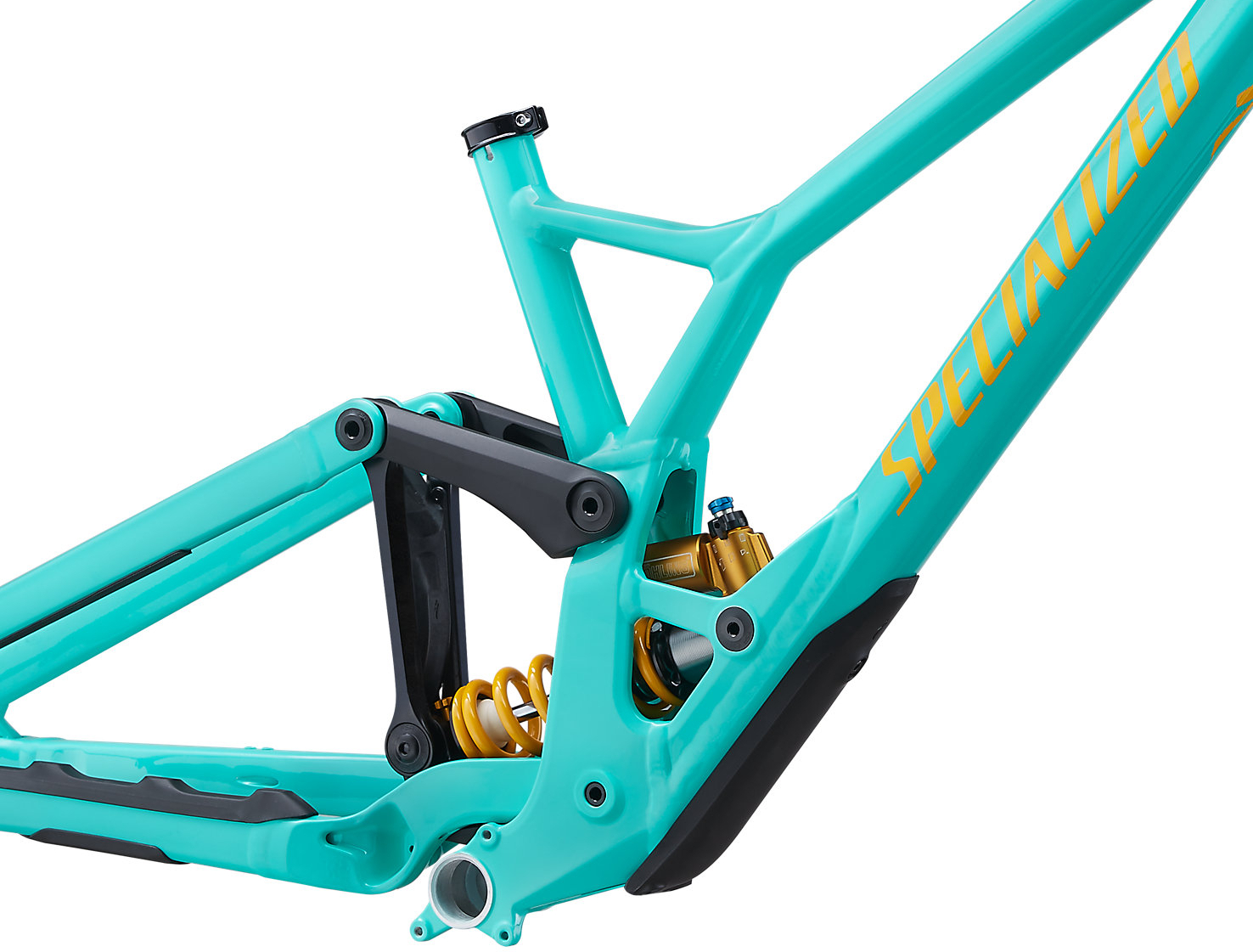

The 2020 Enduro and below, the 2020 Demo. Both utilising the shared pivot for chainstay and shock pivot, but lots of other diferences.

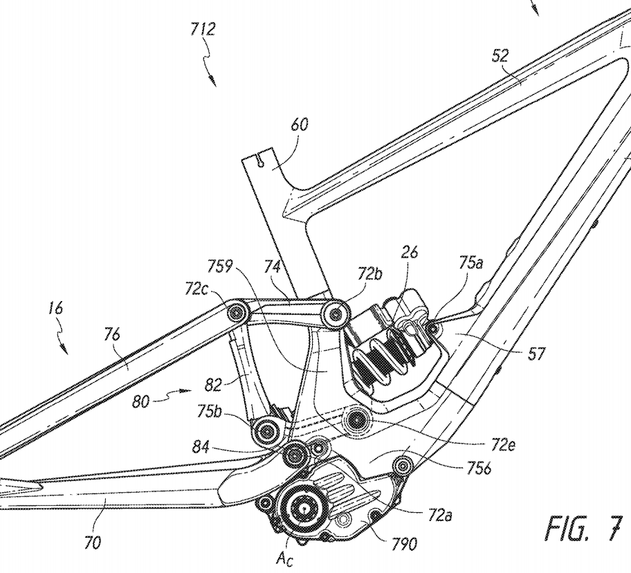

There are VAST differences between the 2021 Demo and the 2021 dEmo SL. I know a lot of us (me included) were doubtful they'd manage to make that configuration work with an emtb, but it looks like they have something. Importantly, it has space for a watter bottle/bottle battery.
It's also interesting that on the patent images, the dEmo is shown with a coil shock - something like a Fox DHX2 derivative ?

As the owner of a 2020 Kenevo modified with 29 wheels, a 2020 Enduro and 2021 SJ Evo the main advantage of the Enduro 6 bar link is for pedaling efficiency. In terms of how the bikes ride, they are very similar. I am actually faster descending on my Kenevo setup even though my Enduro has a 38/Ohlins TTX setup.
