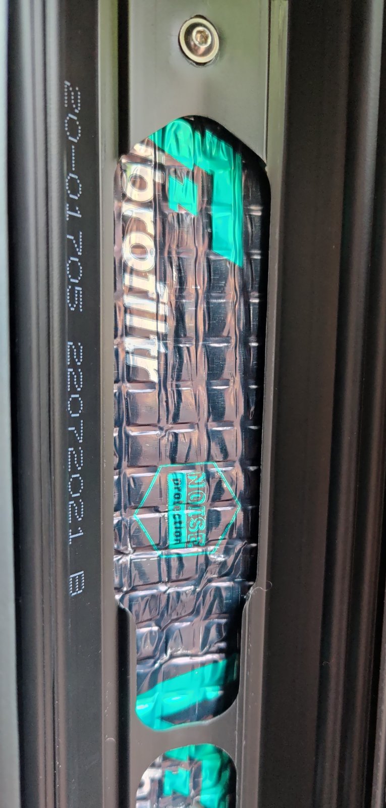

On my 160 TM I only had to adjust the bottom srew, now the battery cover sits perfectly tight (y)

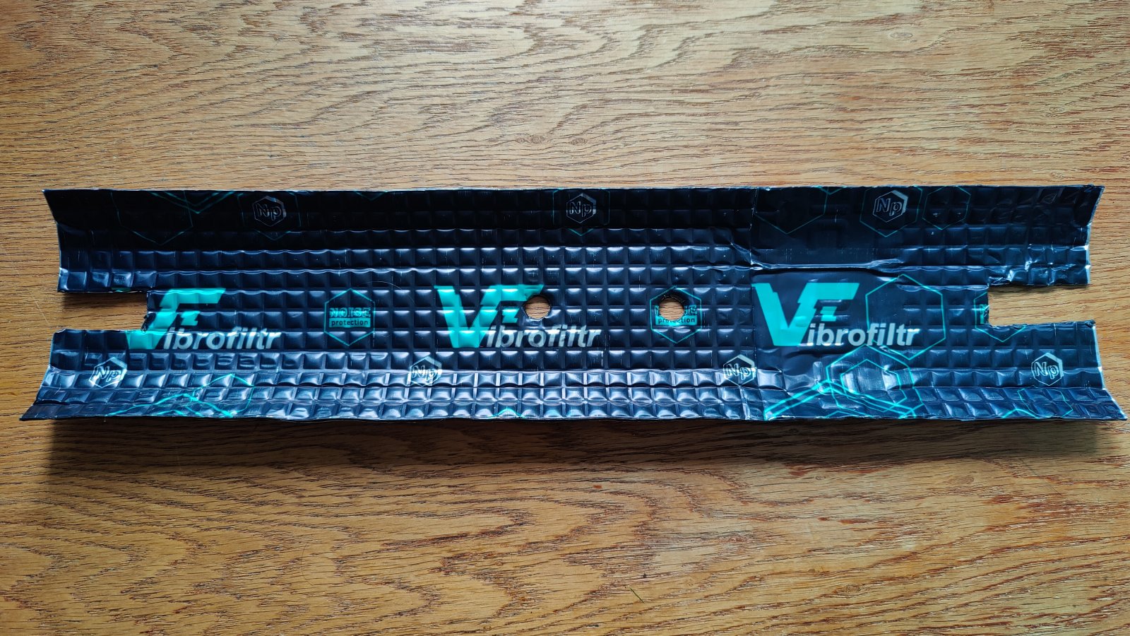

As for frame noise/ vibrancy, I stuck some damping material behind the batterymount/ cablehousing, helped a lot IMO 😗 IMG20220620175359.jpg IMG20220611125015~3.jpg IMG20220611121511.jpg

It sure adds some minor weight (used the 3mm material, there is also 2 & 4 mm), but cant tell how much exactly.
Edit: approximately 200g (I used a slightly narrower piece, than in the picture above!)
