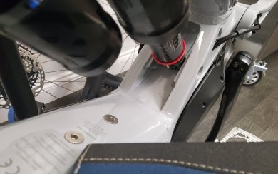

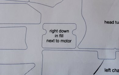

I've just about finished fitting the invisiframe but stuck with one piece.
Does this go under the lower shock mount where the rats nest was on the previous model?

I got left the exact same piece when I did my bike. I'm pretty sure it got left off the bike as I was happy with the coverage anyway.

Hi there. IIRC, this goes at the bottom of the downtube, under the battery cover. The two notches are cut out for the allen bolts for the cover. It protects the gap between the cover and motor. It's an area with a high chance of stone-chipping so use it if you can. (y)
