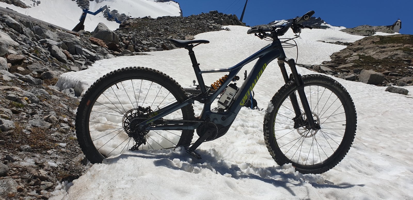

What does it mean people say they have a coil?
Does that mean the remove the factory gas/oil shock and replace it with a spring? Do you have a photo of this "coil"?
Vilt
Feb 13, 2019
186
117
Berg en Terblijt, The Netherlands
13,805
20,498
Generally, an air shock is far easier to setup correctly. You can effectively adjust the "spring" by changing the air pressure. With a coil shock you have to buy the correct coil for your weight/riding requirements. What your describing sounds more like the front suspension just needs setting up correctly for you..... and then probably the rear too, but I'd start with the front. You don't hear every single hard tail rider complaining that there's too much vibration.
