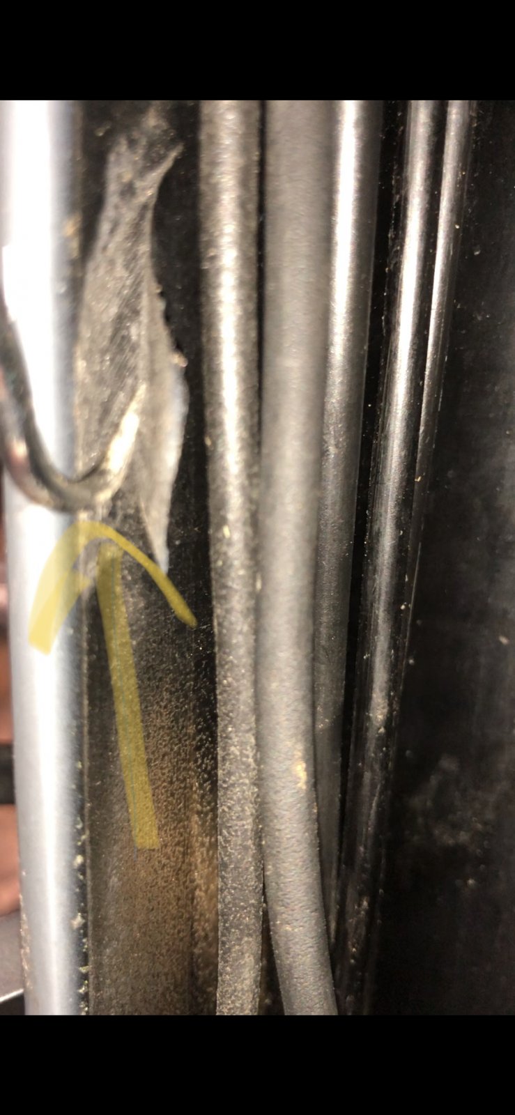

I have called Trek, spoken with the service techs, I’ve spent multiple hours trying to fix this issue. If you hit any bump the whole system will shut off or the motor will cut out for 5-10 seconds and then turn back on. I’ve done the RIB alignment. Anyone else having this issue or have had this issue?

Others have had a similar problem, but that was caused by the bottom battery mount moving, which can't be your issue since you've already done the battery alignment. Maybe the wiring is being pinched between the motor and the frame? Or possibly a loose connection at the motor?

Yep I have this issue with my carbon 9.7, my LBS ended up replacing all Bosch parts and I still have the issue. Trek are now sending out a new frame as we think the frame is faulty and over flexing. Take the battery out and check the layups of carbon to see if any of it is peeling away. I suspect Trek will want to rule out lower cost problems before you get to this stage though.

FYI mine is an XL and I’m 16 stone so probably max torsional stress. I used to crack ali frames at the welds for fun ?
I’m hoping there is a faulty batch of frames and not a design flaw.
