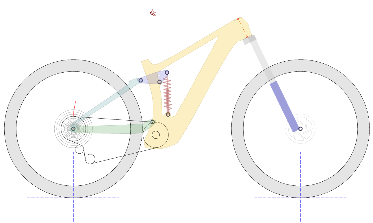

I liked it a lot. So much I ordered one for myself.
I was also curious to the geometry and linkage, the suitability for a coil shock and other stats. I contacted Andre XTR who provided the following data on the suspension analysis on the 2022 Trek Rail. I have attached it below with his permission.
==== ANDREXTR Data (close approximation, since the schematic drawings were not available in this case) ====
Trek Rail 9.9 2022 – low position
Travel: 150mm with the 230 x 57.5mm shock
LEVERAGE RATIO
Trek Rail 9.9 2022 has a moderately progressive suspension curve. Considering the amplitude and the shape of the leverage ratio curve, the final progressivity is 30%, meaning that it takes more 30% force to bottom-out comparing to any fully linear bike equipped with the same shock and SAG% (example of linear bike is for instance, Orange Stage). For more info about these calculations check my video HERE. Another interesting point is that the curve is almost a straight line, without fancy shapes, so the progression builds in a very constant and predictable way across the travel. This makes the Rail suitable for both coil and air shocks.
The Rail leverage ratio continues decreasing with the same shape and slope even if you increase the shock stroke up to 65mm (on low setting in the flip chip). However, with a 65mm stroke (at low) this will almost certain create a problem of the seatstay bridge hitting the seat tube at bottom-out. You have to run the bike in the high mode (even though you need to check very carefully for clearance).
On higher mode, you lift the rear end of the bike by basically creating and adding more ~9-10mm of wheel travel at the beginning (when compared with the 0mm position of the low setting). So, on the high setting if you compress the rear suspension by 9-10mm you end up with the same geometry of a fully extended low-setting bike. Its seems that the overall travel also increases by around 5-6mm on the high setting (so you end up with around 155 mm with standard shock).
Using a 65mm stroke might boost the travel to around 175mm, which is a bit too much in my opinion. Keep in mind that a 57.5mm stroke is usually a 65mm shock restricted with a 7.5mm spacer (travel reducer) pre-installed. There are 3 sizes of travel reducers: 2.5mm, 5mm and 7.5mm. In this way manufacturers can cover a wide range of strokes by just producing a 55, 65 or 75mm shocks for instance.
Considering that the average progressivity for most 150-160mm enduro bikes on the market is around 20-30%, and for DH bikes is around 40%, we can consider the Rail as a moderately progressive trail/enduro bike, and it is within the normal numbers for its segment. This amount of progression will make the Rail a good fit for most of trail/enduro riders (it’s neither too linear, neither too excessively progressive).

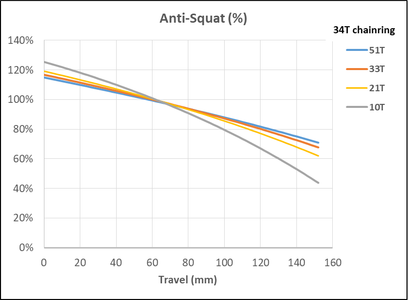

Pedaling efficiency
In simple words, anti-squat is an intrinsic property of the linkage that counteracts the pedal- induced bob and determines the pedaling efficiency. Every time that shock compresses and extends due to pedaling (pedal bob) it means that your energy is being dissipated and wasted by the suspension and not to propel you forward. Most trail and enduro bikes in the market have near 100% anti-squats on average now-a-days. A 100% anti-squat value is defined as the “gold-standard” value in which the rear suspension does not extends neither compress under acceleration.
While this is true for motorcycles and cars where you only have horizontal acceleration forces (from wheel torque), on mountain-bikes you also have vertical forces during pedaling from the body and legs movement (up and down), which inevitably cause some sort of pedal bob even with 100% anti-squats. On E-bikes the pedal bob problem is attenuated because the motor helps keeping a smoother a more constant acceleration.
For a 30% SAG and for a stock 34T chainring, the Anti-squats of the Trek Rail 9.9 are very well optimized with numbers very close to 100% across all rear cogs on SAG zone (the pedaling zone). This result is because Trek works as a single pivot regarding anti-squat (the wheel is mounted on chainstay which is directly connected to the main frame by one pivot) and they placed the main pivot crossing with the chainline at the top of chainring height. If they placed the pivot lower the anti-squats would be lower, and if they placed the pivot higher, the anti- squats would be also higher.
LEVERAGE RATIO

Pedaling efficiency
