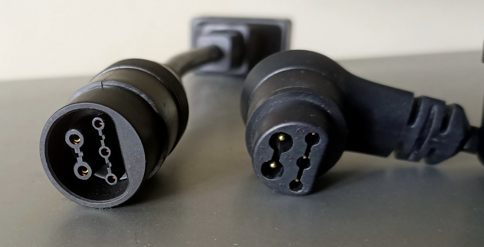

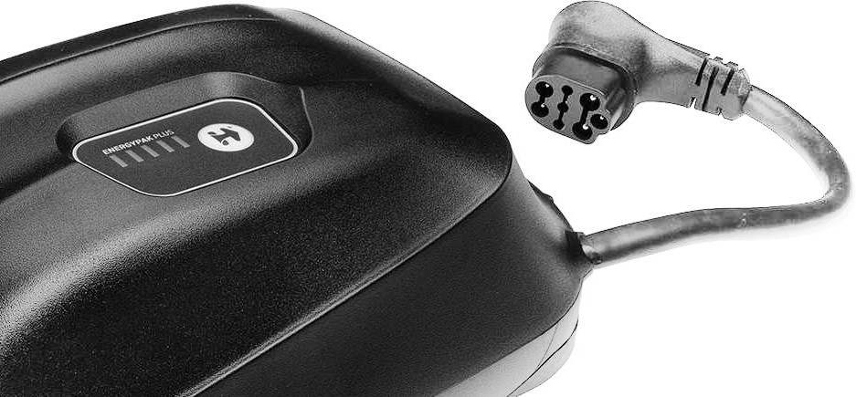

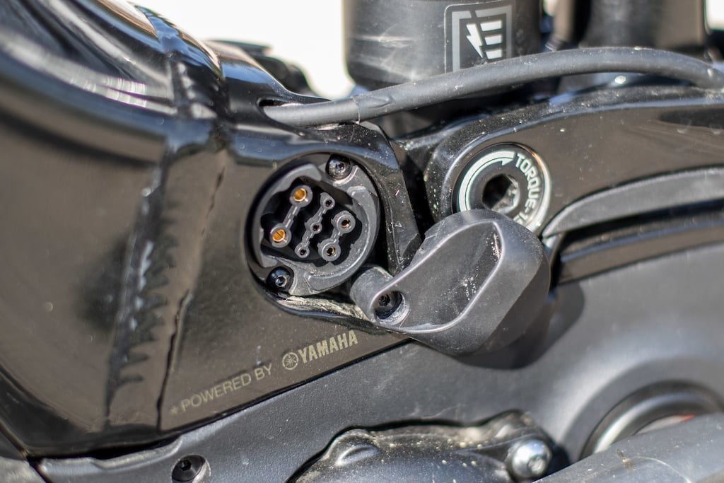

Hi Andy,
Thanks for the reply. You are quite right, the extender plug would foul the crank arm but also the connectors are different. It appears that on a 2020 Reign and on the Energy Pak Plus they are a 7 pin arrangement whereas the Trance is a 5pin. I had already considered (should have mentioned it) your suggested course of action but what to do with the extra wires? Are they necessary to the functioning of the extender, the
main battery and/or the complete system? I don't know... but then it seems, neither does anybody else or if they do, no one is saying. My other thought was to swap the entire wiring harness for a Reign one but that would probably open up another can of worms and would add to the price of the Energy Pak Plus which is close enough to $1000 AUD anyway. Also availability of EPP in Oz is the same as the 625WH battery....there's none around. . The 625Wh battery would have been a better, neater, cost efficient option. I'm resigned to the fact that whatever option I end up going with there will be some re-wiring and re-routing required.
I have included some pics to show the differences in the plugs.
Trance connectors.

Energy Pak Plus
