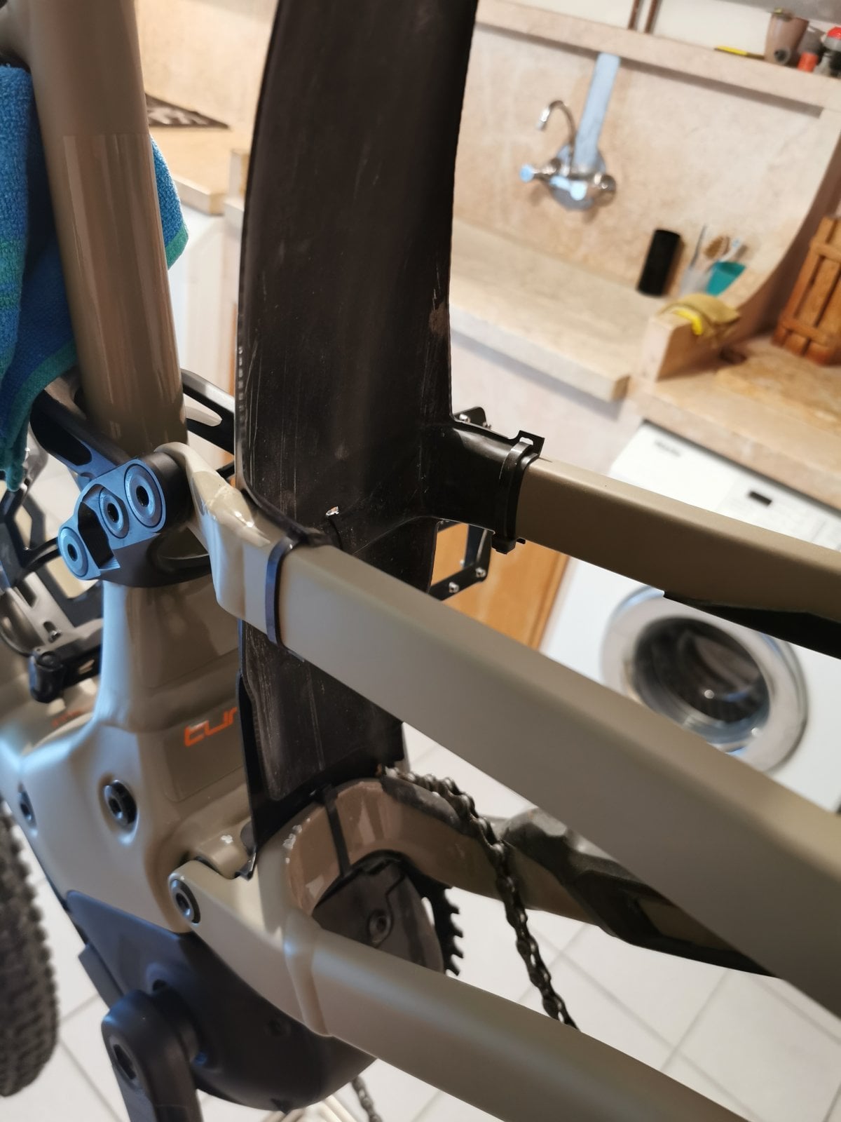

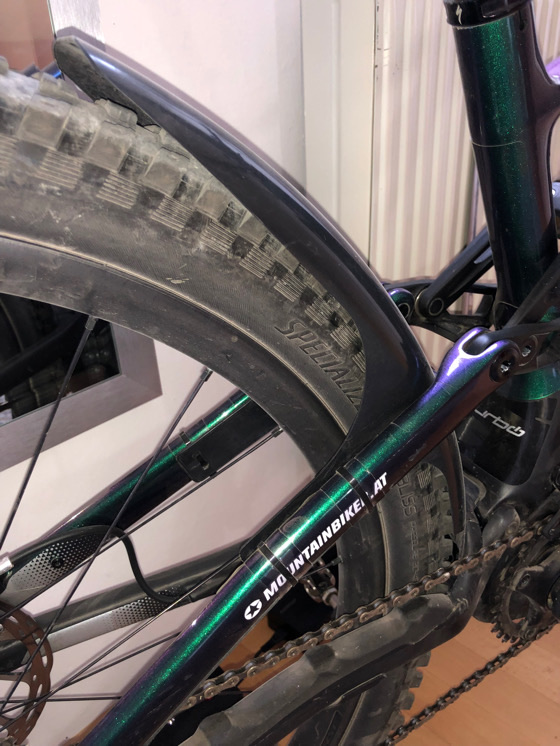

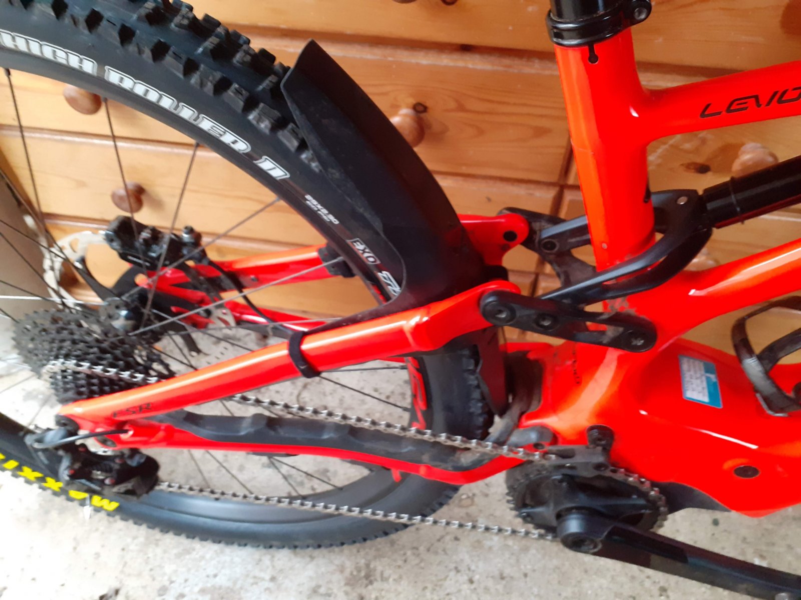

Binned the huge hugger,I hated it,so decided to sort a solution.
First off I got some smaller tyres, pair of high rollers in 2.3 as they were on offer and ideal for muddy wet conditions.
Lots of clearance now front and rear.
Used a fork mudguard and then cut some tube and attached that to the 2 small bolts on the motor casing.
Fitted my fork splash shield which I prefer to a huge mudguard.
View attachment 26011View attachment 26012View attachment 26013

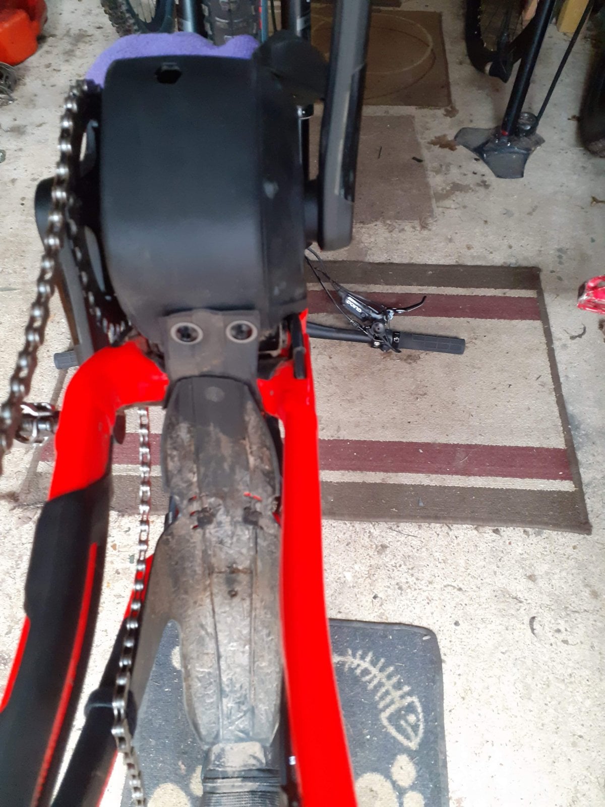

Little update on this rear guard.
It didn't work as it jams on the frame after a large hit, so the lower section needs to be longer..
Now modded with an extension , worked fine on way home from work
If you have enough space due to smaller tires - use only one front mudhugger - without an additional part fixed by motor-screws.
The lower section must be long enough to ensure that it is not free when the shock is fully compressed.
Works for me since many month.

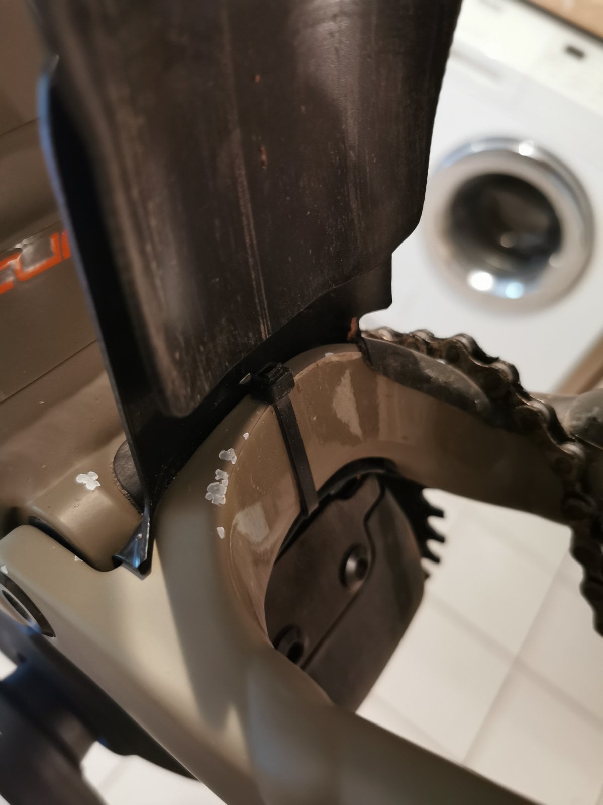

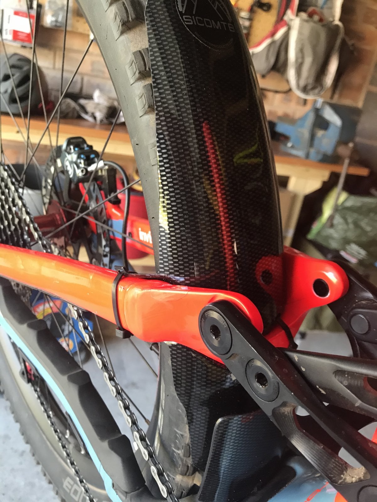

Fitted the new V2 version of sicomtb mudguards now that 3D rendered it so you take out the plastic bit completely and it's an absolute gem. After buying it last week everything would go in there which annoyed me so the hunt was on, came across this and today not a spec of mud in there and easy to fit

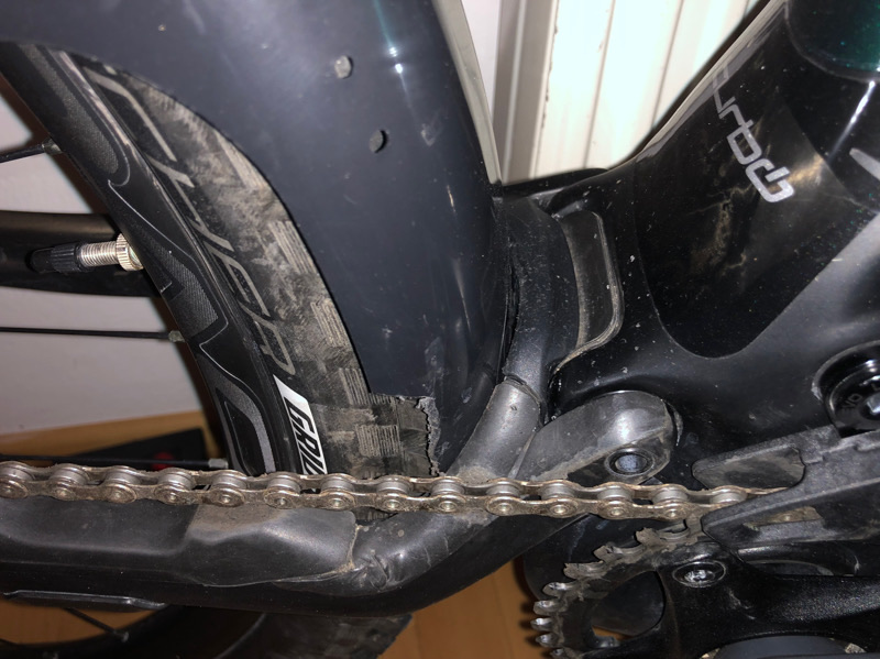

I need a bit of help here, I've mounted a SICOMTB Mudguard V2 on my Levo Comp 2020. However, its getting worse, the gravel is bombarding the lower swing, see attached pictures. I am not impressed with the Mudguard so far...any help or suggestions to mitigate this issue?
Cheers Greg
Cheers GregView attachment 30808
That's not great for a product designed to protect the bike.
Have you informed @SicoMTB ?
I'd think about either using thick helicopter/gorilla tape like the stuff you get with Mudhugger guards, or perhaps putting back the plastic guard and fitting a trimmed down Central Coast guard instead of the bottom section of the SicoMTB V2.

Thanks for recommendation. Still not sure it will fit 2020 with 2.6 rear
View attachment 19111less than 5mm clearance without mud n crud
After looking at a few options for the Levo 2020 with 2.6 tyre and found that it was not that easy to fit a mud guard and one that have good coverage I installed the Carbon effect sicomtb rear mud guard.
The fit looks tight but I have had no problems. Occasionally a small rock will will stick to the tyre and you can hear it hit the mud guard but it will come off. I have done around 70 miles. No damage to the mud guard.
I have not yet tried in very muddy conditions as it has not been raining that much in in Scotland. The bike comes back from the ride much cleaner.
Installation was easy.
The mud guard looks much better than I thought. it is expensive but it seems to do the job especially protecting the motor housing.

Yes, Slapper Tape might work here. However, I am a bit disappointed by the Mudguard. I know the paint is crap on Spech Bikes but this is looking s**t.

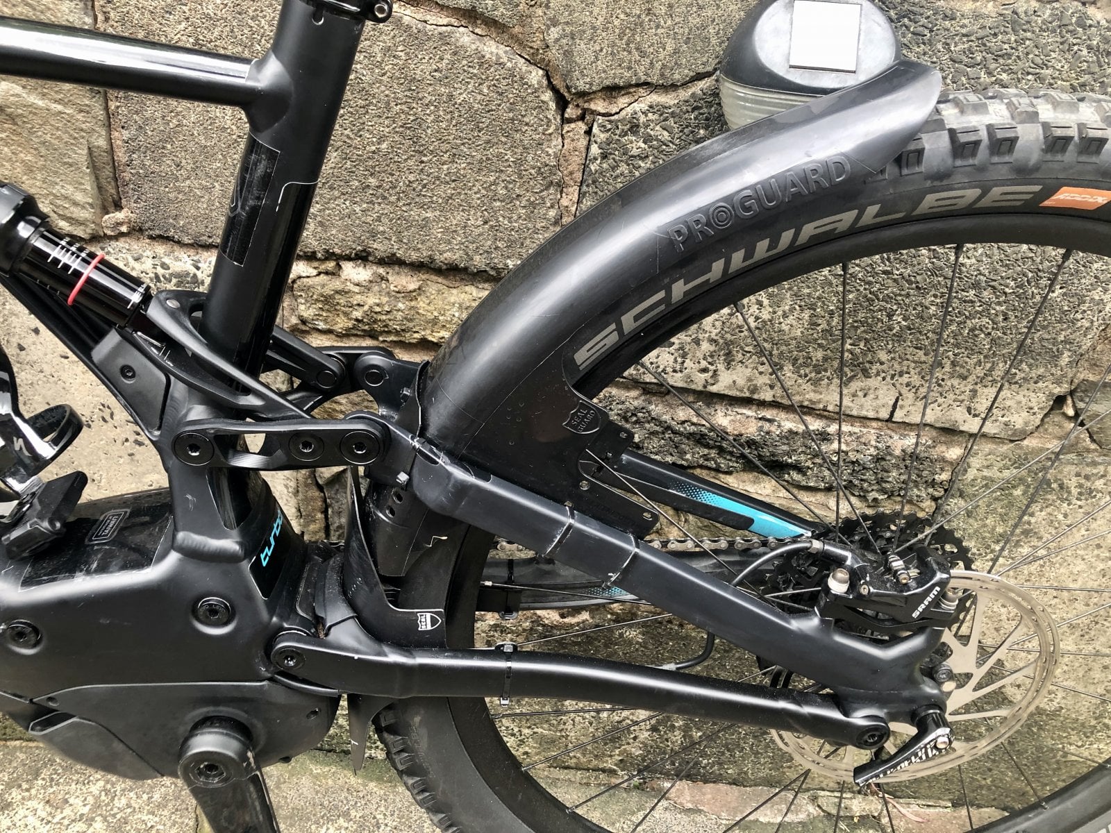

I have a RRP pro front mud guard fitted to the rear, it took some fettling but managed to get it snugly in.
Underneath I have a small enduro which has been trimmed to avoid the chain rubbing but protects a build up on the pivots.

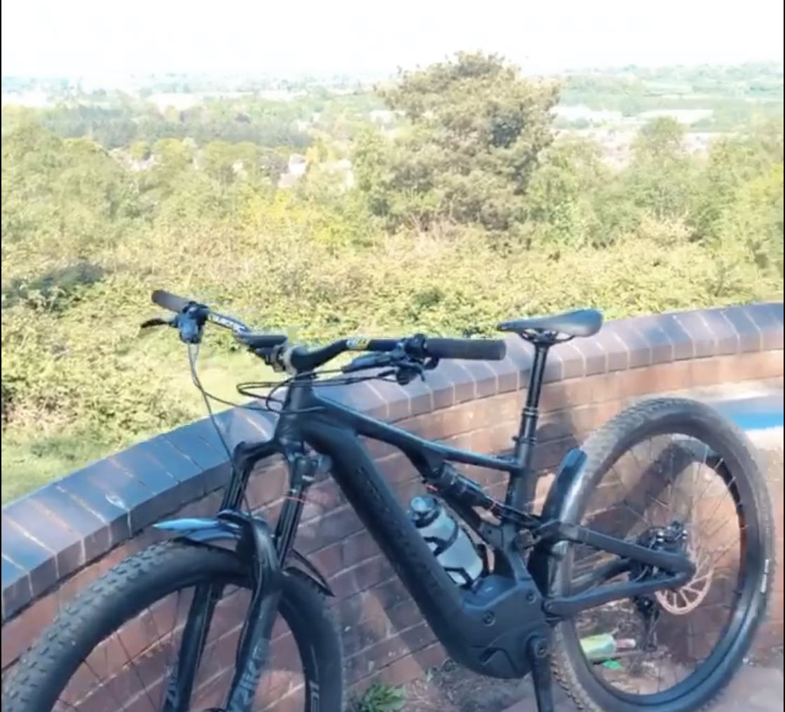

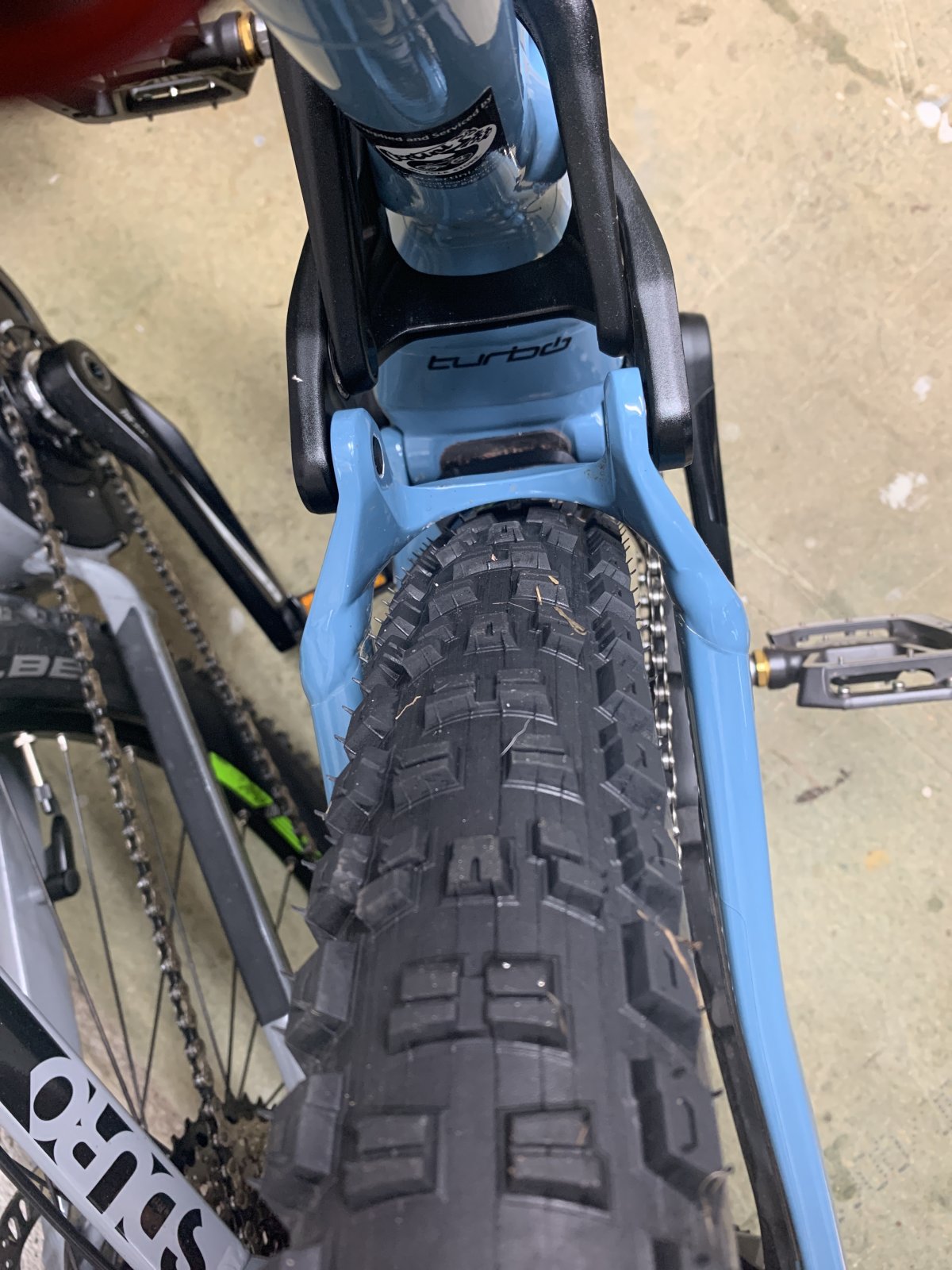

Just fit a smaller tyre , you'll have loads of room then.
Mine with a high roller 2.3

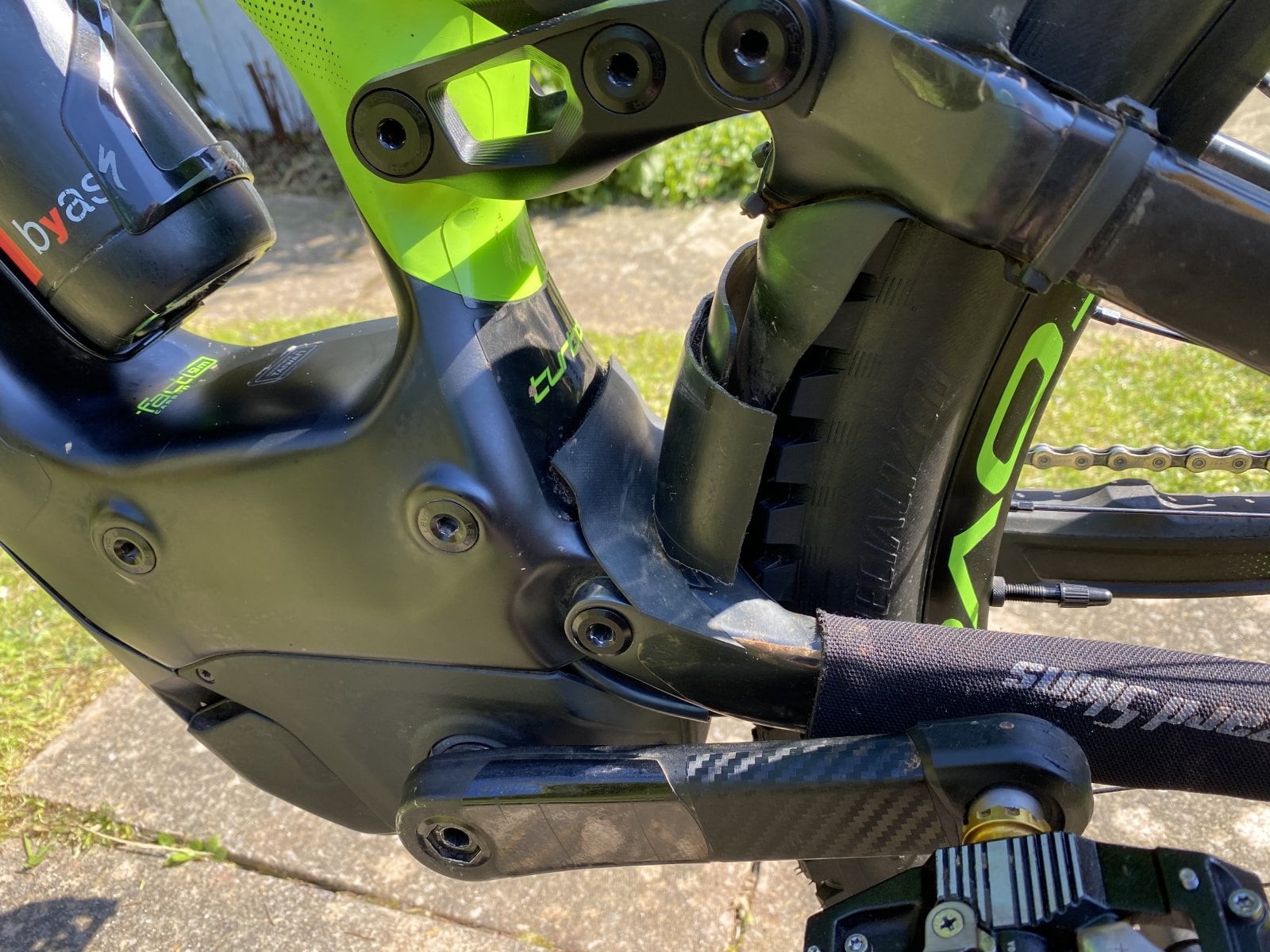

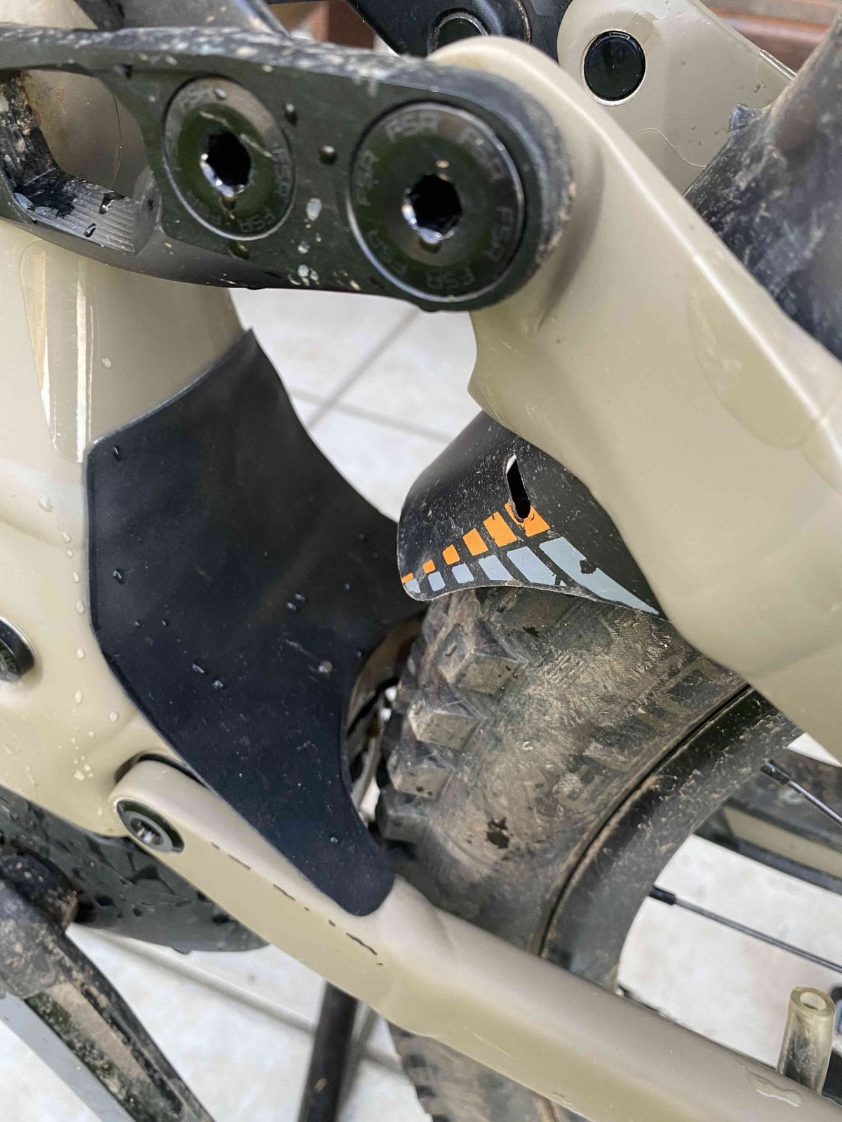

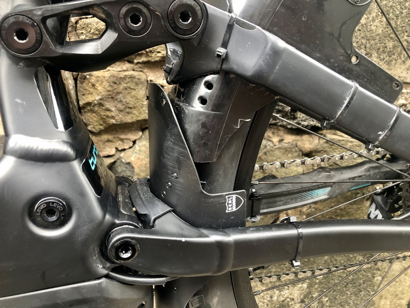

MY first attempt ...
1 muddy ride and 1 loam ride and it has worked a charm... nothing got in under the flap . Rather pleased with the result.
Got the idea off this forum, can't remember who but thank you in nonetheless.
I did something similar mainly as a test after I got a small rock stuck in the pivot point. I used a piece cut out of an old tire with a strip of Gorilla tape at the top. It doesn't look near as clean as your design, but it had the same result of nothing getting under the flap. IMO this is a great approach. Now I'm going to have to do another version that looks even half as good as yours. ;)
found a A4 sheet of 2mm rubber... cut it out to fit .. only problem is finding double sided tape that is strong enough ....
Sticky backed velcro works fine
