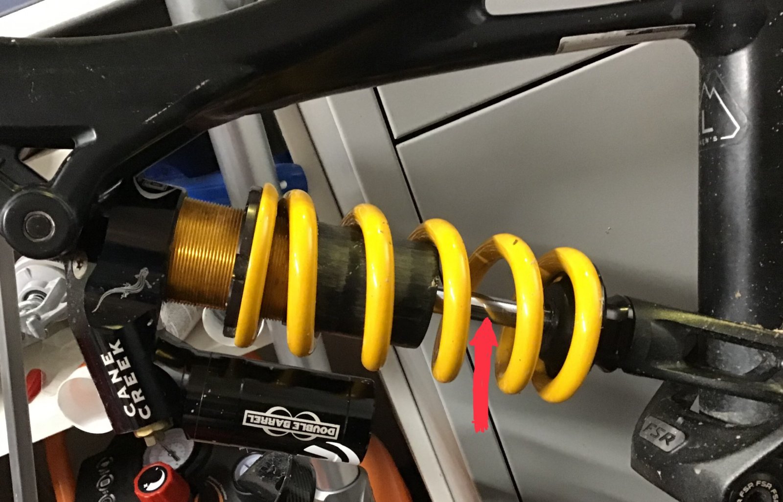

Fitted this the week before Christmas. However....... got a call from TF tuned saying..... Cane Creek have been in touch with them and have said that they do not recommend that you put a DB IL Coil on your 2019 Levo or 2019 Stumpjumper as they are worried the shaft of the shock may snap near the rear eyelet due to the increased leverage force created by the yoke.
So..... I am sending the shock back to TF Tuned who are happy to give me a refund and we are working on 'other' possible options.
It is a real shame as I have been for 3 rides with the new coil shock on and compared to the standard air shock the new coil shock in my opinion is far superior especially on the terrain I ride :cry::cry::cry::cry::cry:
Was this issue only for the DB Coil IL?
Im running the DB Coil CS and wondering if that issue you brought up is the same for my model.
When I talked to CC, they definitely said not the IL, but the CS was ok. That was waay back in November. I literally just received my shock and coil 2 weeks ago or so and haven't ridden it yet due to the fun weather here lately. Thanks.
The Coil CS is fine as long as it has the thicker shock shaft on it.
Please see the photo below of my CC Double Barrel. This has the newer, thicker 9.5mm shaft on it. The older CC DB coil shocks had an 8mm shaft. When I say older, I mean 2 to 3 or possibly 4 years ago.
The CC Inline has an 8mm shaft which is why CC are nervous as they believe the leverage action of the Levo and Stumpjumper suspension will be too much for the 8mm shaft to handle. I suspect they may have had a recent a failure or two :eek:.
Thank you sir! Got the newer one as it was just received...took like 90 days to get it. Im running the VALT Spring at 600lbs. First real test will be this week I hope.
Thanks for the quick response. Thought I was going to have to find an alternative. Been away from the forums for a while and was just catching up on a few reads last night.
Did CC give you the ok on that one? I think it would be fine either way but nice if they actually said it was, they were pretty cagey with me on the phone a few months back. With the weight of the bike did you go up in weight with the spring?
Any chance you’d post the specifications you used so those of us interested could order?
